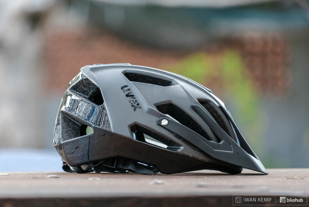

The Quatro is uvex’s top of the line helmet aimed at trail, all-mountain, and enduro riders. It offers a good amount of coverage around the back of the helmet and several other great features.

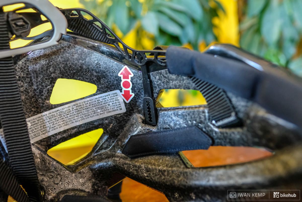

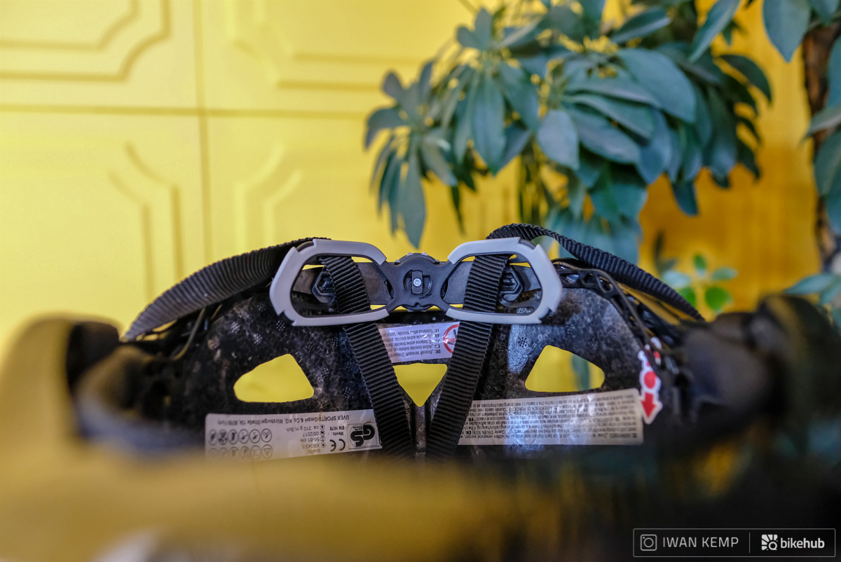

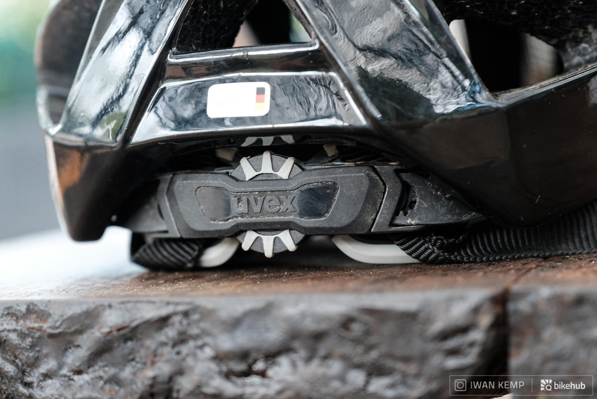

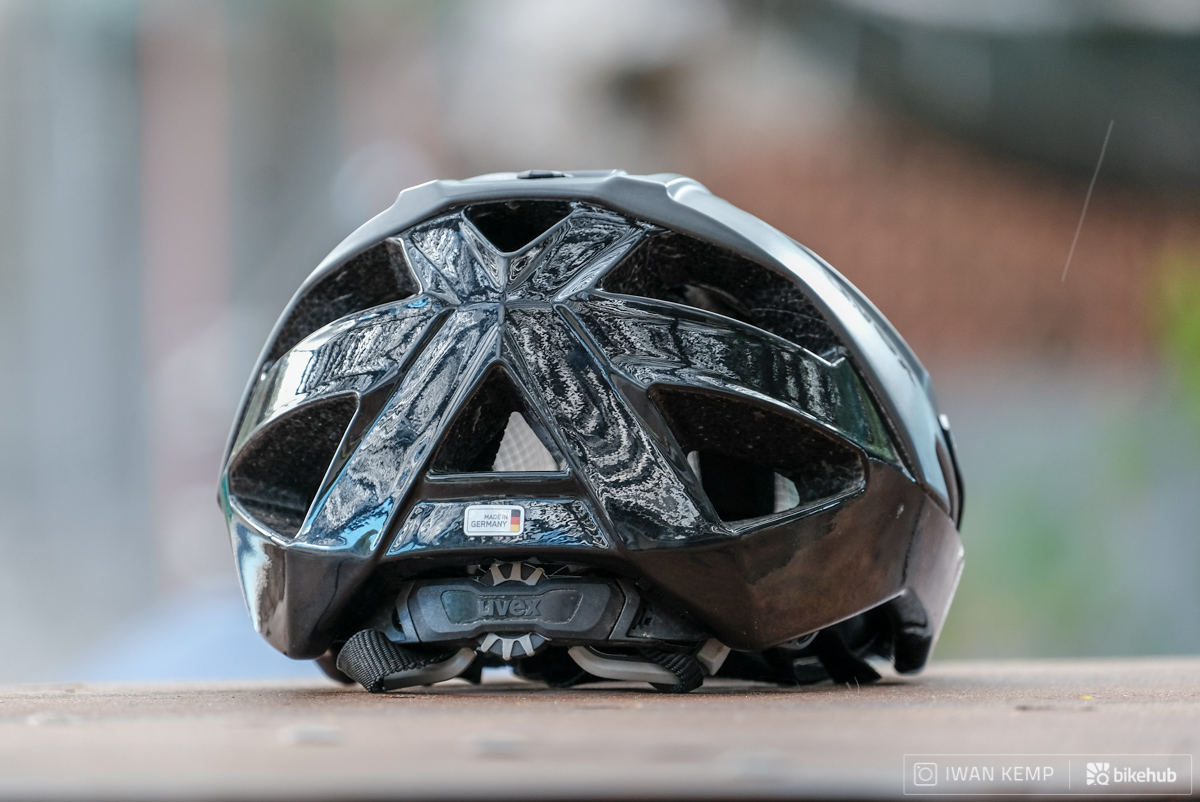

The first of which is uvex’s unique retention system dubbed “anatomic IAS”. It features a 360-degree adjustment system with a familiar dial at the back that picks up the slack for a snug fit. To further adjust fit over the head, there are vertical clips above the ear that provide seven different height positions. The inner lining is made from anti-allergenic, antibacterial, fast drying material that can be both removed and washed.

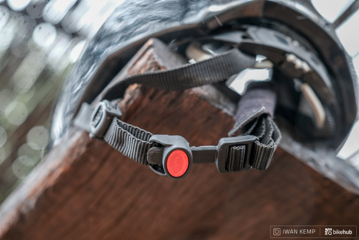

The chin strap is secured using a ratchet system that is super easy to open and close. It offers a perfect fit without the need to fiddle with adjusting nylon straps in the hope that you get it right. There’s even a felt strip to increase comfort around your chin.

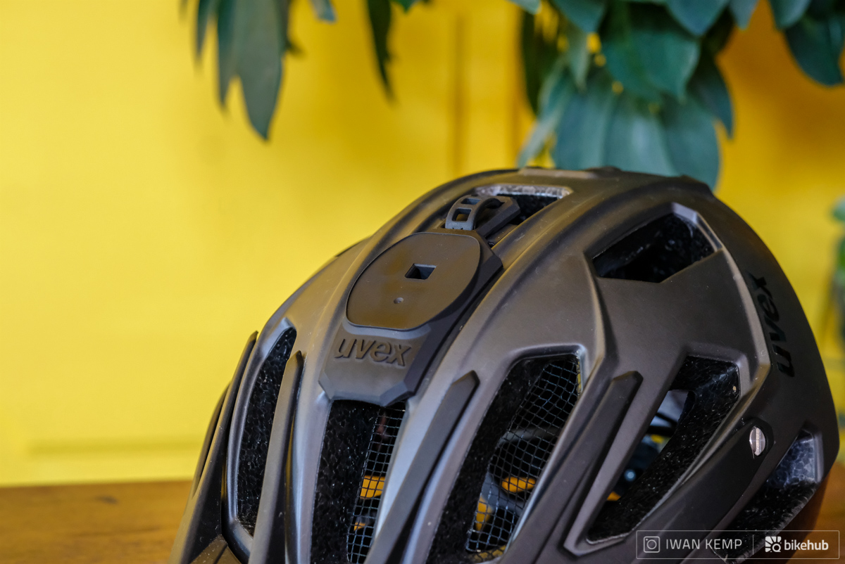

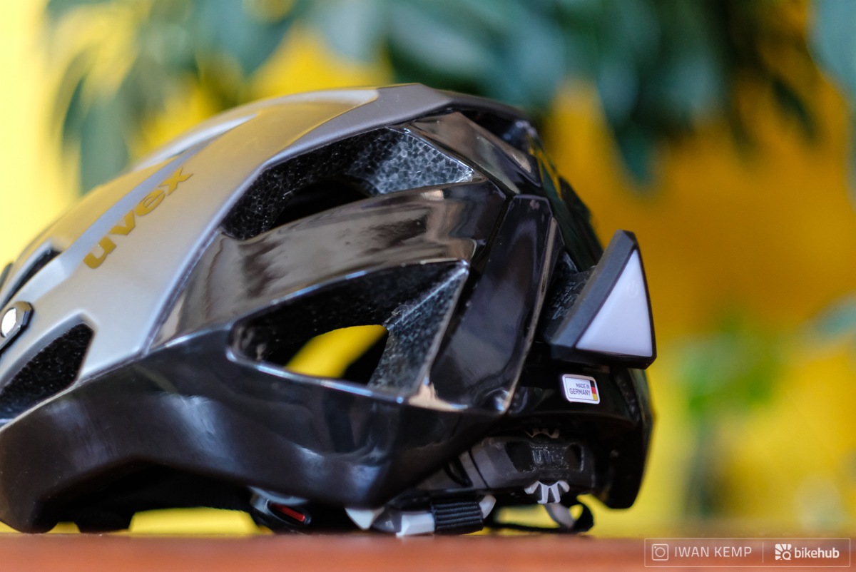

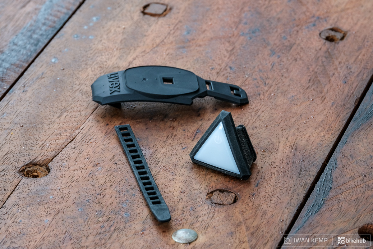

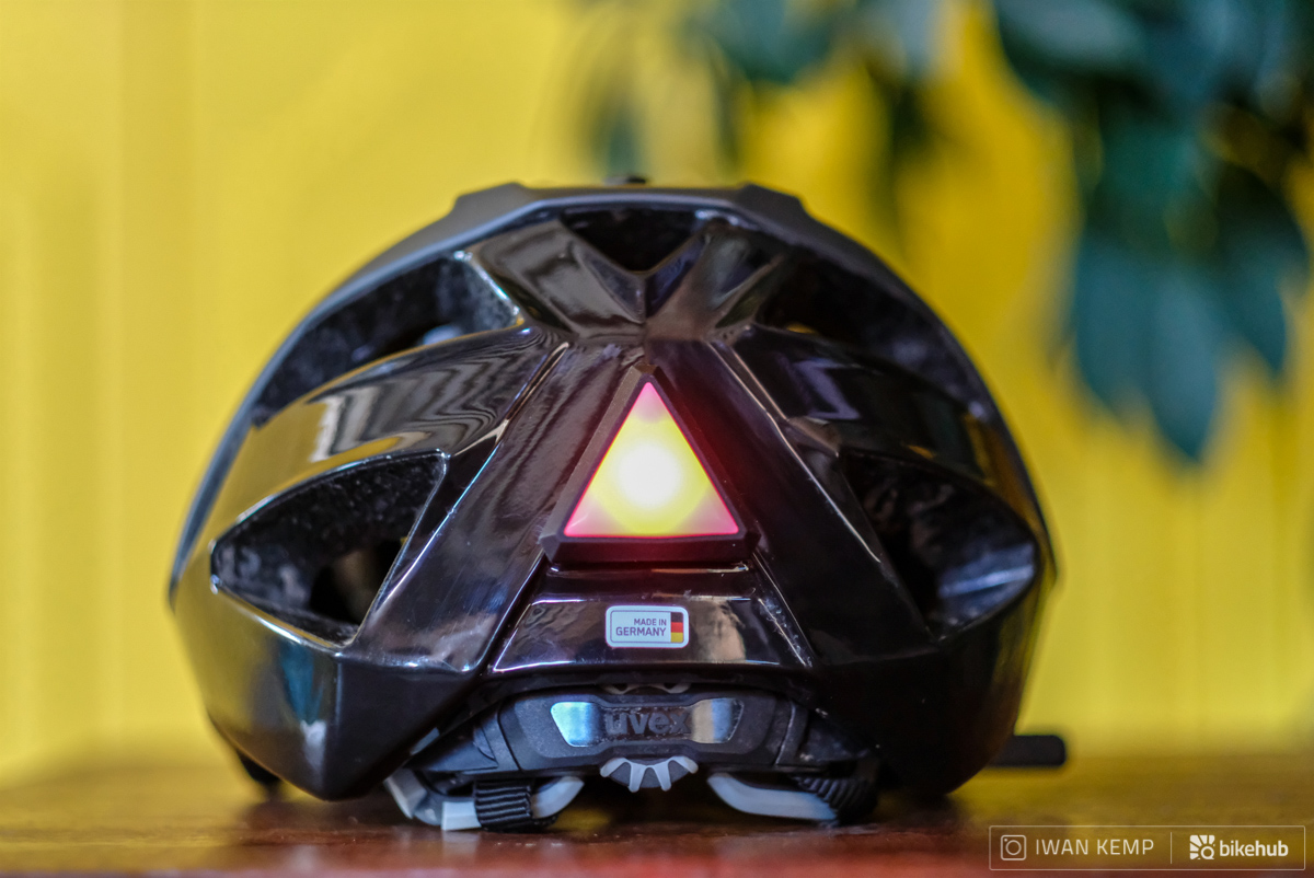

There is a universal mount on top and it comes with optional adapters for a light or action camera. At the back, there’s a triangular gap that a rear facing light can be clipped into. These accessories are well made and fit securely to the Quatro.

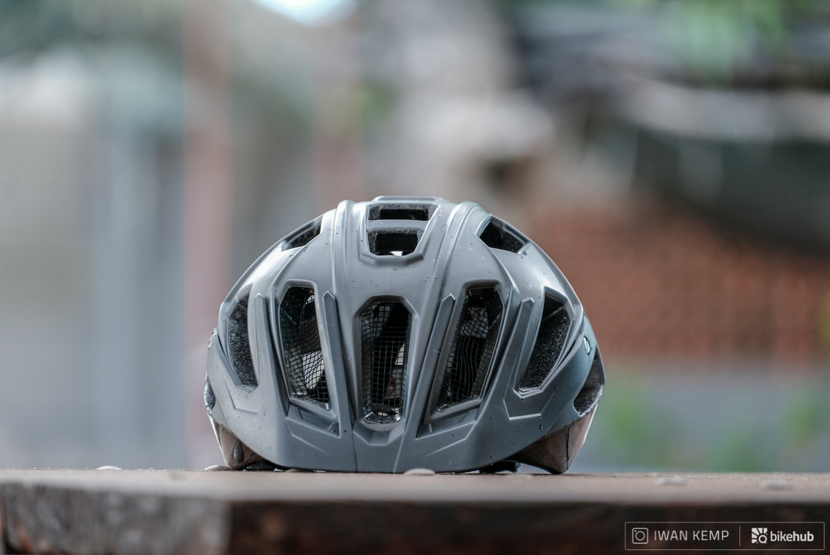

The generously sized ventilation channels all around the helmet mean that the ventilation is superb. Not once did I feel that the helmet suffers from heat build-up. It was noticeably better at keeping my noggin cool than the Fox Metah that the uvex has replaced. Another plus compared to the Fox is the adjustable visor – especially on steep descents where the Fox could do with a centimetre or so chopped off for a better field of view.
I used my GoPro on the optional action camera mount and the footage was good with no evidence of the mount shifting during filming. I made use of the rear light on every ride. I found it comforting knowing that I was out riding with a high-mounted rear facing light. Think of it as the third brake light that comes standard with vehicles.
