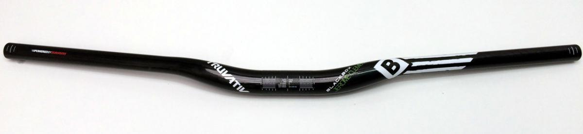

The Clementz (named after racing legend Jerome Clementz who won the maiden Enduro World Series in 2013) checks in with the following statistics:
  • Width: 750mm
  • Rise: 20mm
  • Upsweep: 5deg
  • Backsweep: 7deg
  • Weight: 240g

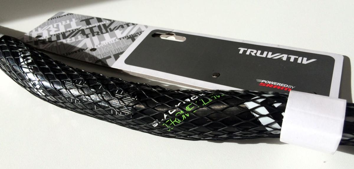

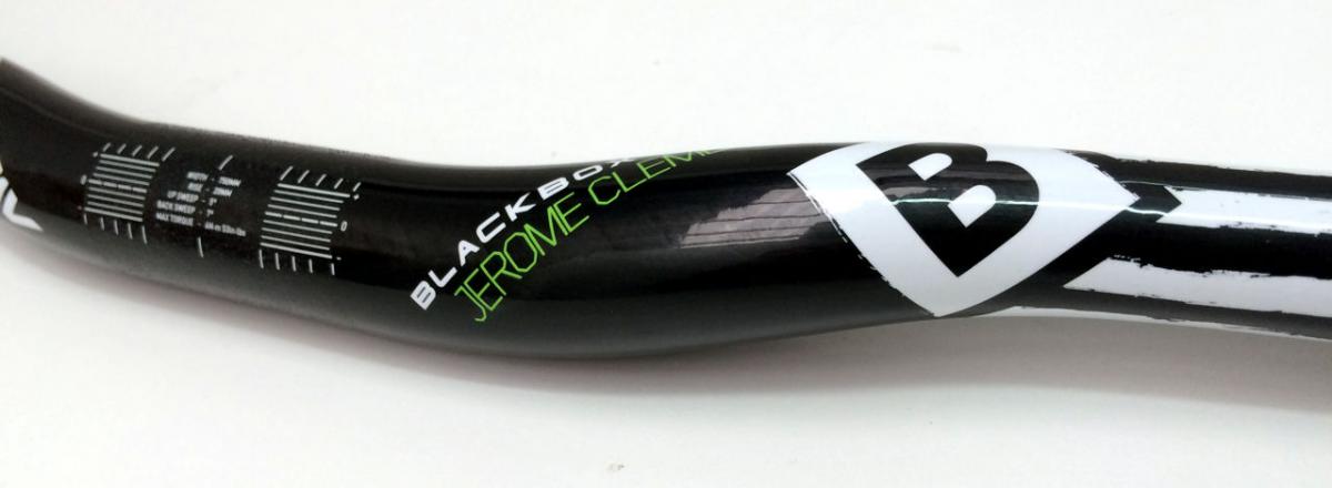

Unwrapping it reveals an extremely well constructed piece of carbon, with a beautiful unidirectional finish.
The BlackBox decals are sublimated into the clear coat and give the Clementz an extremely high-quality feel.
From a shape perspective, both the up and back sweep figures are in the middle of the spectrum. From the front, the bar looks perfectly proportioned for some serious action. As has been mentioned, my opinion is that exaggerated width does not benefit most riders. What works for a World Cup downhiller won’t necessarily work for us mere mortals. That being said, it’s a little-known fact that Jared Graves rides with a 740mm bar, and of course this BlackBox model is the exact bar used by Jerome Clementz himself…

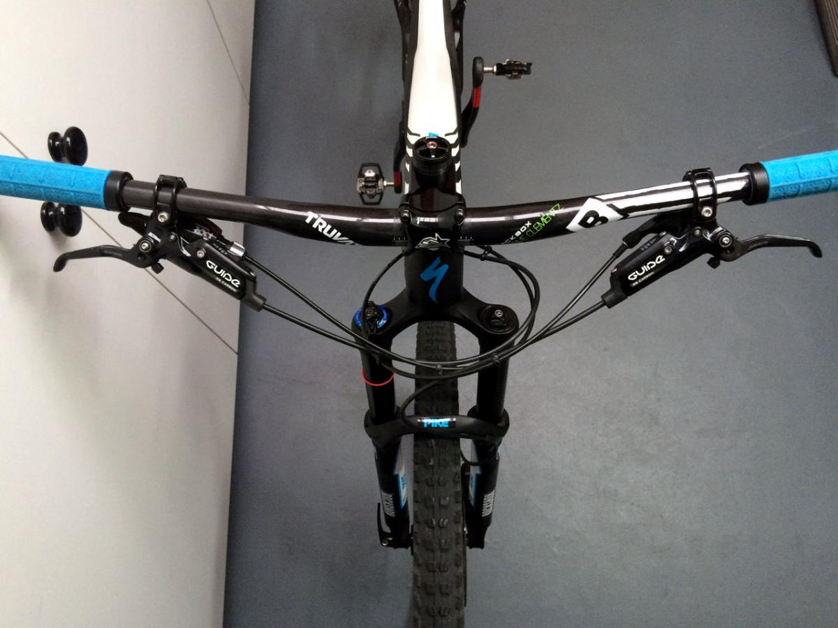

Setting up

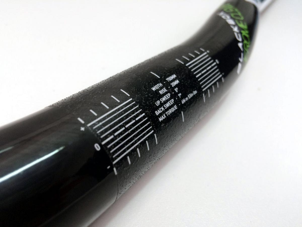

For setup purposes, alignment markings are well positioned. Like most carbon bars, the Clementz has a knurled surface coating to help with stem grip.
My ride is a Specialized Enduro 29er running a 65mm Spank Oozy Stem. I set it up with a single spacer underneath to get the front end at my preferred height, with the steerer on the RockShox Pike having recently been cut slightly longer than necessary. Nothing fiddly with sliding the Clementz through the stem clamp or fitting Guide clamps over it, it’s gradually shaped and easy to work with.
The finish in the lever clamp area is unfortunately very shiny, so it can be tricky to get some levers to sit solidly enough to prevent them from moving with hard riding. On a carbon bar, levers should be able to rotate in a crash anyway to prevent damage to the bar, so this an observation more than direct criticism. It does make careful setup very important, a factor to take note of.

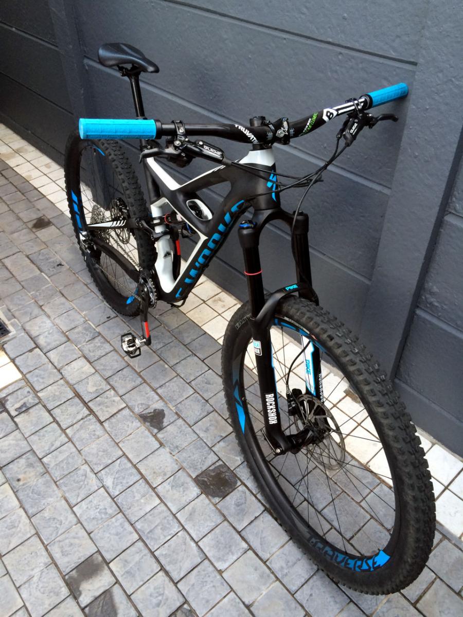

The finished product…
Pretty cool how the carbon on the Guide RS Carbons coordinates perfectly with the finish on the Clementz.
