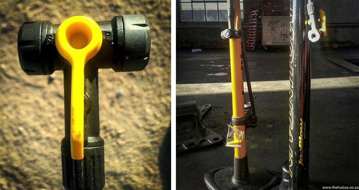

TwinHead switches between Presta and Schrader; the JoeBlow Mountain’s 44mm barrel next to its smaller sibling

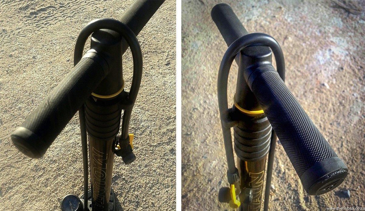

Handle: Oversize Padded

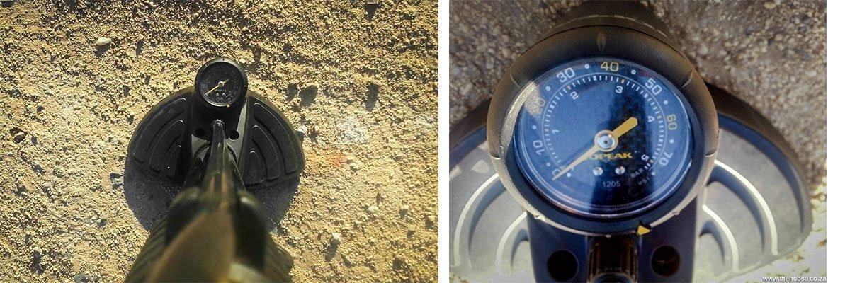

Another stand-out feature is the dedicated mountain bike gage that only reads to 5 bar/75psi compared to the Sport’s 11 bar/160 psi. This saves on valuable display “space” which means you will be able to fine tune your tire pressure better as the increments are smaller and therfor a lot more readible on it. In a world where 5 psi can make all the difference this is a big bonus.
Then there’s the usual Topeak features. The Double-sided TwinHead™ works with Presta or Schrader valves by flipping it over. No need to swop out the inners or carry extra bits around with you. The head has an easy to use leaver that locks the head in place and opens the valve to inflate the tyre. A built-in air release valve makes it easy to fine tune even further.
The pump has a wide composite base to keep it stable trail-side. The hose is extra long and there are guides at the top of the barrel with a hose dock at the bottom to keep it secure. The handle is oversized and padded, mimicking mountain bike grips. The mountain bike parents among us will be glad to hear it also ships with a pin to inflate soccer or rugby balls.

Only criticism I have is that the markings on the dial are difficult to read - unless you're under 40 and have great eyesight.
