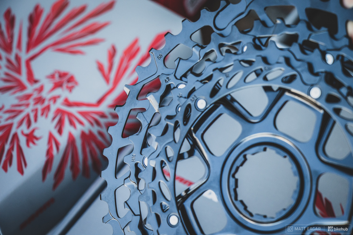

The Cassette

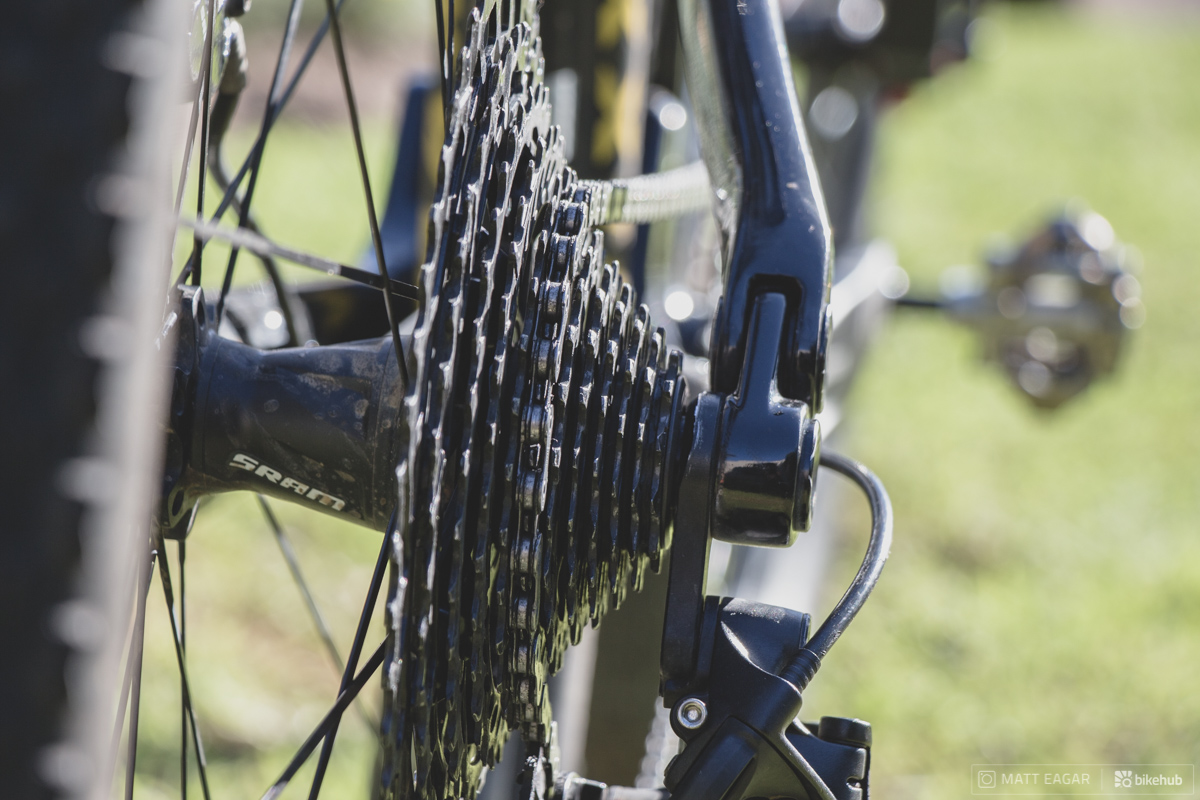

With the demise of the double, or even triple chainring, the cassette is the heart of the groupset. So it is important to note that the NX Eagle cassette (much like the NX 11-speed cassette) differs from the rest of the Eagle family in two ways: 1) the gear range and 2) the freehub body interface.
The Eagle XX1, X01, and GX cassettes all have a a gear spread starting at 10 tooth up to the near dinner plate sized 50 tooth. The NX Eagle cassette has a larger 11 tooth cog while maintaining the large 50 tooth biggest cog. One tooth might not sound like much but the difference is a 454.5% range on the NX Eagle cassette versus a 500% range on the other Eagle cassettes.
A benefit of the larger 11 tooth cog is that the Eagle NX cassette can accommodate a normal spline (Shimano-type) freehub body. All other Eagle cassettes require SRAM’s XD Driver system. This results in additional costs for riders needing to adapt their existing hub from a spline type to an XD Driver. This is one way that NX Eagle helps to reduce the costs of upgrading to 12-speed. As the XD Driver Body is hub brand specific, it cannot be included as a part in the groupset.
The NX Eagle cassette is fairly heavy at 614 grams. That is a result of the materials used and cost effective construction techniques. The NX Eagle cassette is pieced together from 12 stamped steel cogs. The largest four cogs are then riveted to an aluminium spider with the remaining cogs sliding onto the freehub and separated by spacers. A lockring holds all the cogs in place. Because of this bulkier construction and the use of steel for all cogs, the NX Eagle cassette is the only cassette in the Eagle range that SRAM a confident for use on ebikes.

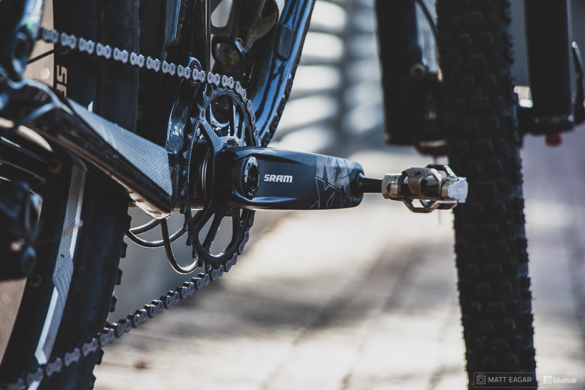

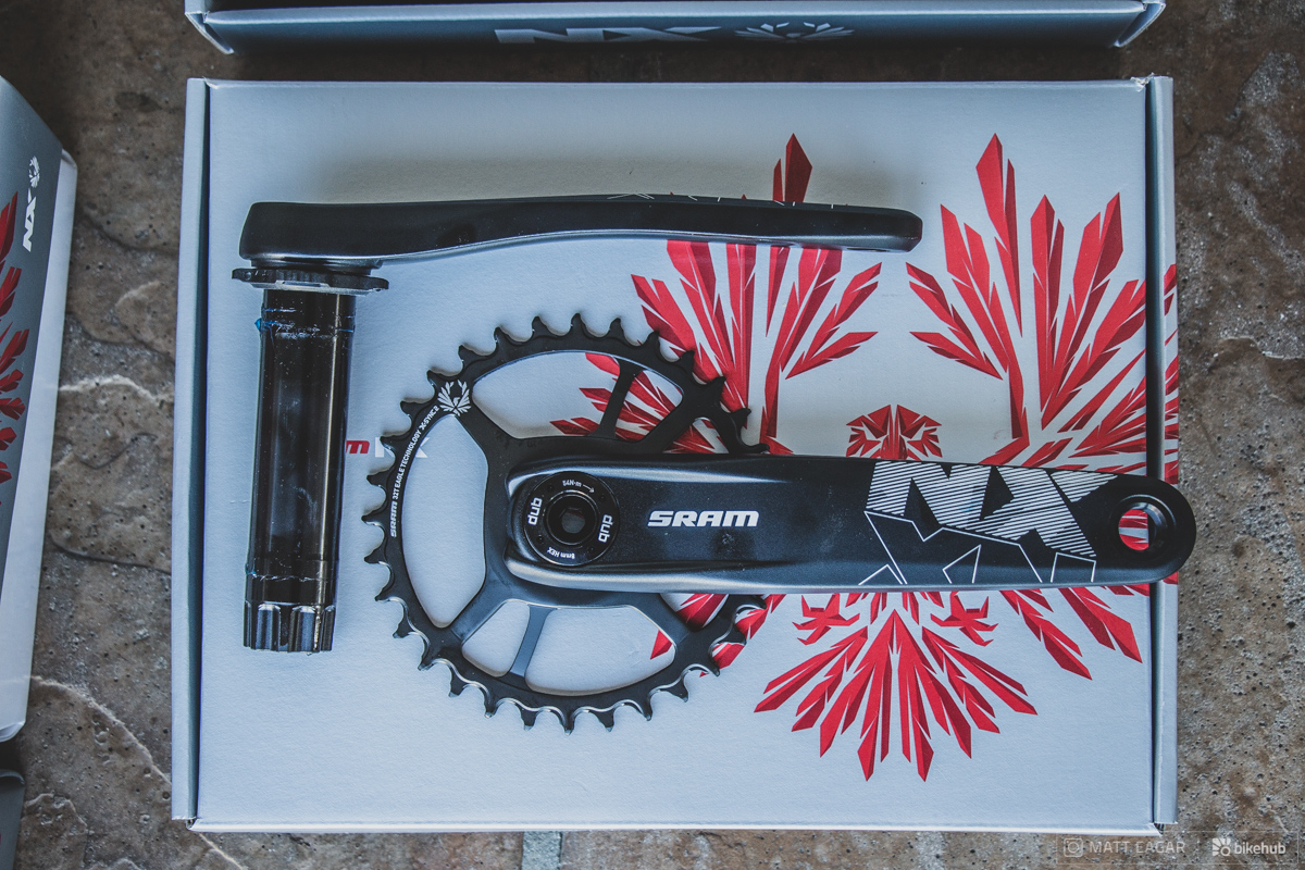

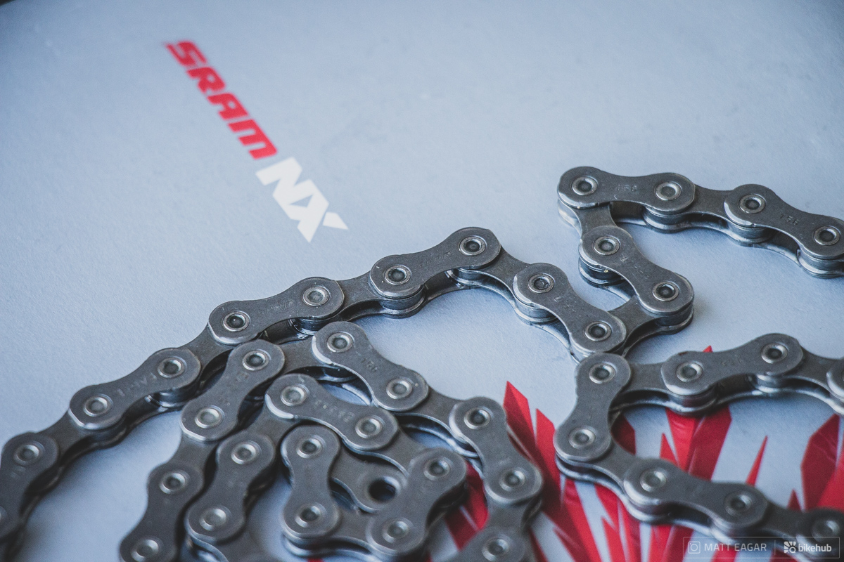

The NX Eagle cranks are shaped from 6000 series aluminium, where GX Eagle uses the higher grade 7000 series. The cranks are designed for direct mounted chainrings, specifically SRAM’s own X-Sync 2 chainring which is held in place by three Torx bolts. The crankset pairs with SRAM’s Dub bottom bracket (generally not included in the groupset bundle) which is compatible with most frames. The chainring is stamped from steel and features all the same Eagle technology including the kinked tooth profile to improve chain retention.

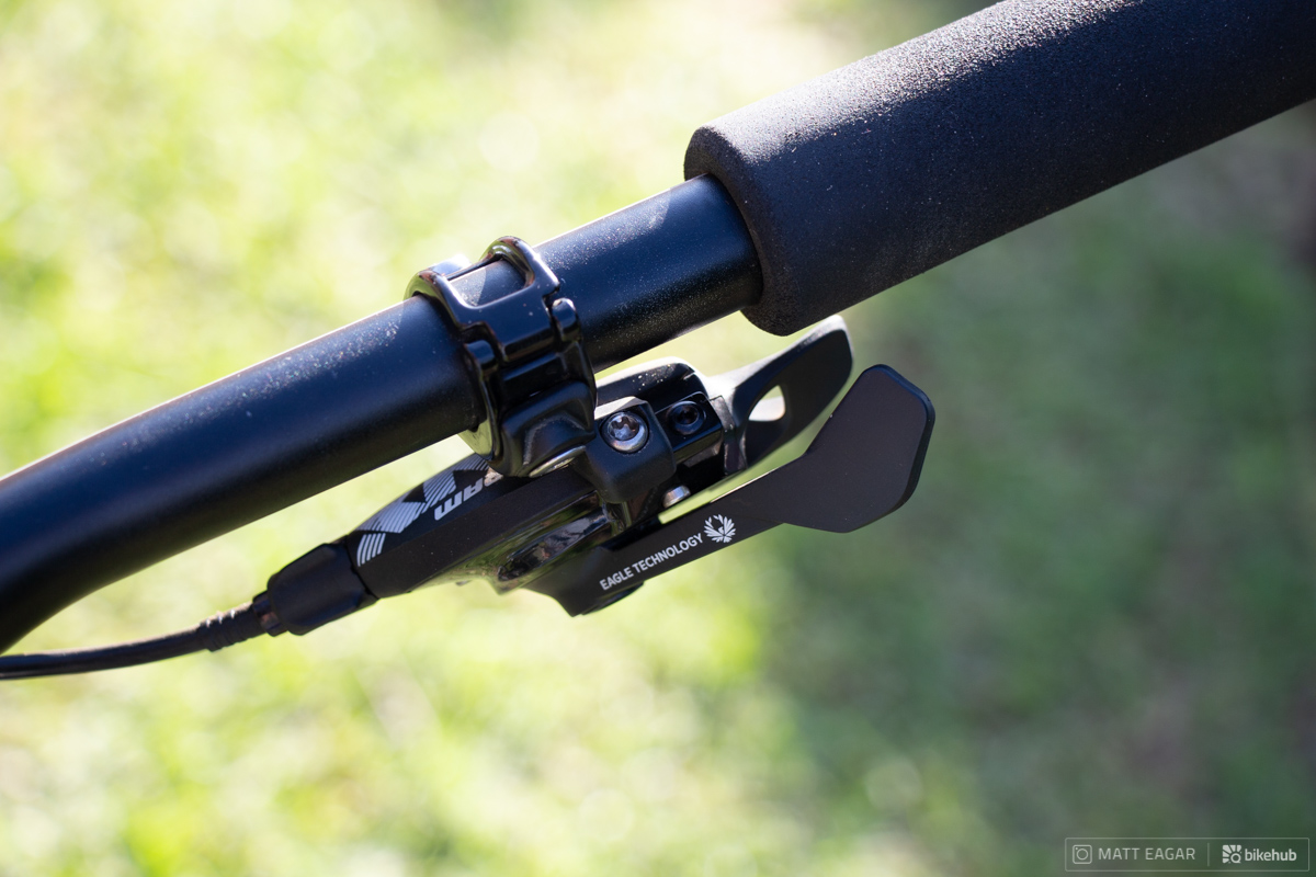

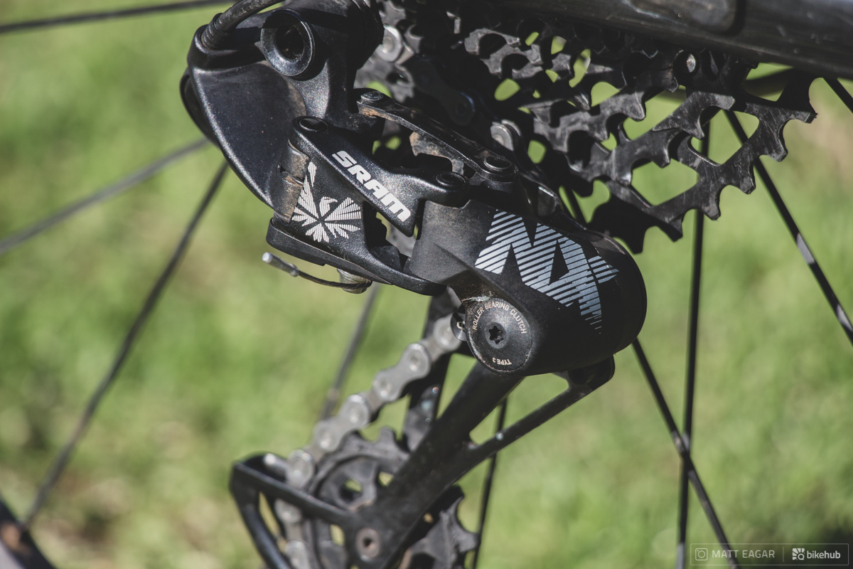

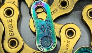

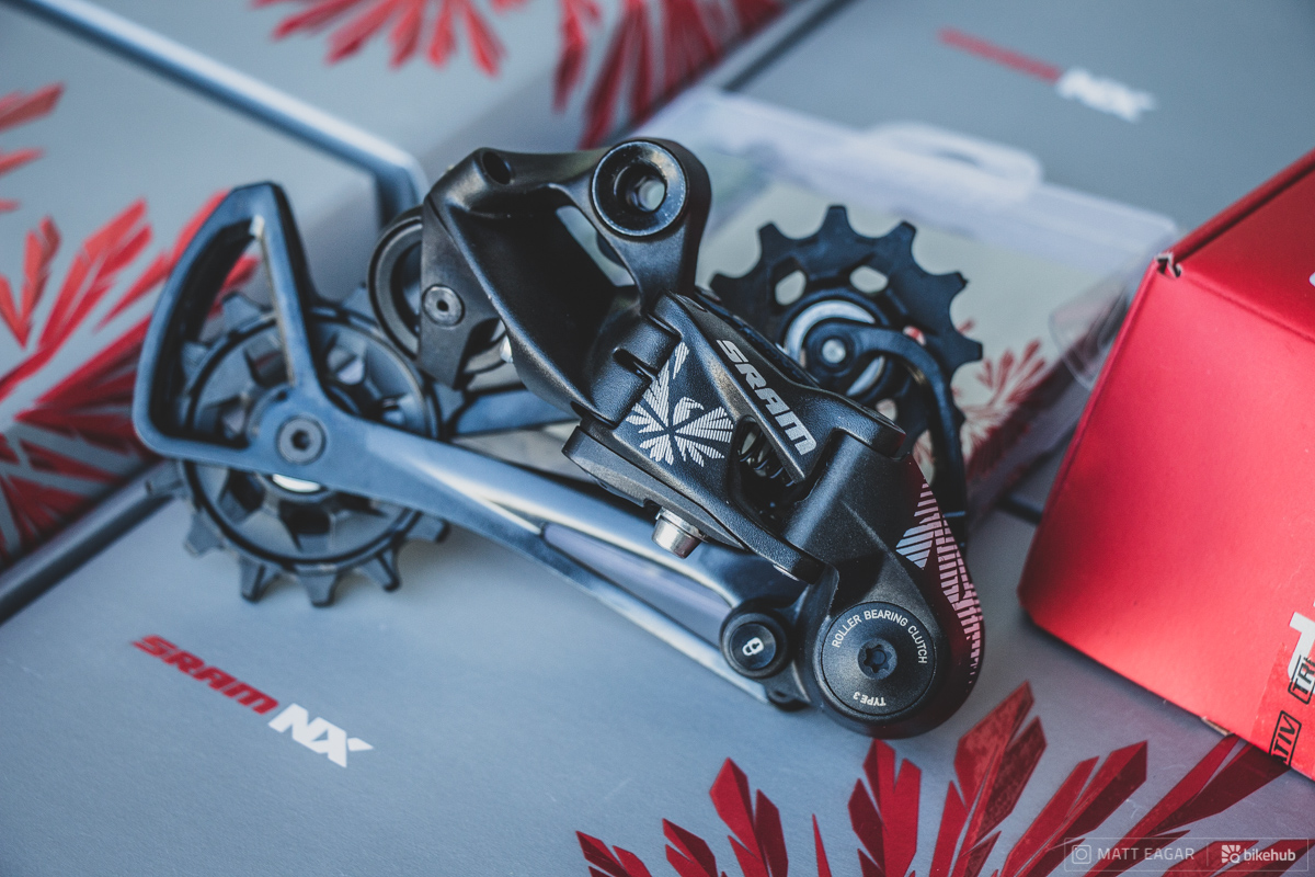

Likewise, the derailleur is packed with all the same features found further up the Eagle range. The same straight parallelogram design featuring a roller bearing clutch to keep the chain tight and the cage lock to hold the derailleur out of harm’s way when removing the back wheel. The Eagle shifter lever is plastic compared to the carbon one found at the top of the range and it rotates on a bushing versus a bearing. Interestingly, the NX Eagle shifter is the lightest shifter in the Eagle range. The NX Eagle chain uses a heavier solid pin construction.

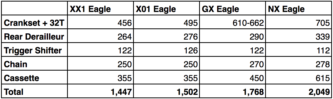

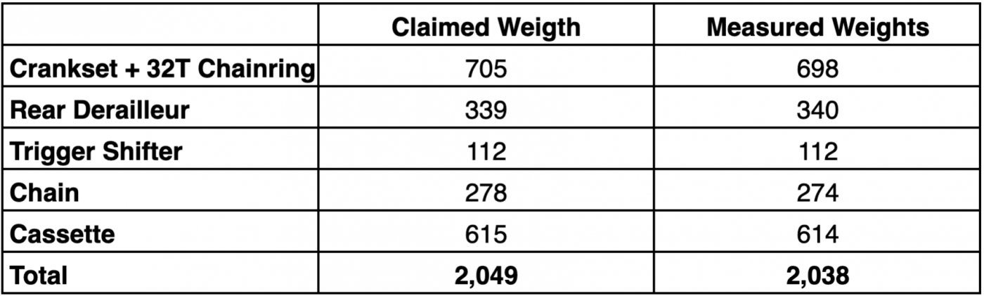

You can see a comparison of the claimed weights of each component across the SRAM Eagle family compared to the NX Eagle groupset, along with the real-life weights from our review parts below:
Weight comparison across the SRAM Eagle family (in grams):
SRAM NX Eagle Claimed Weights vs Our Measurements (in grams):

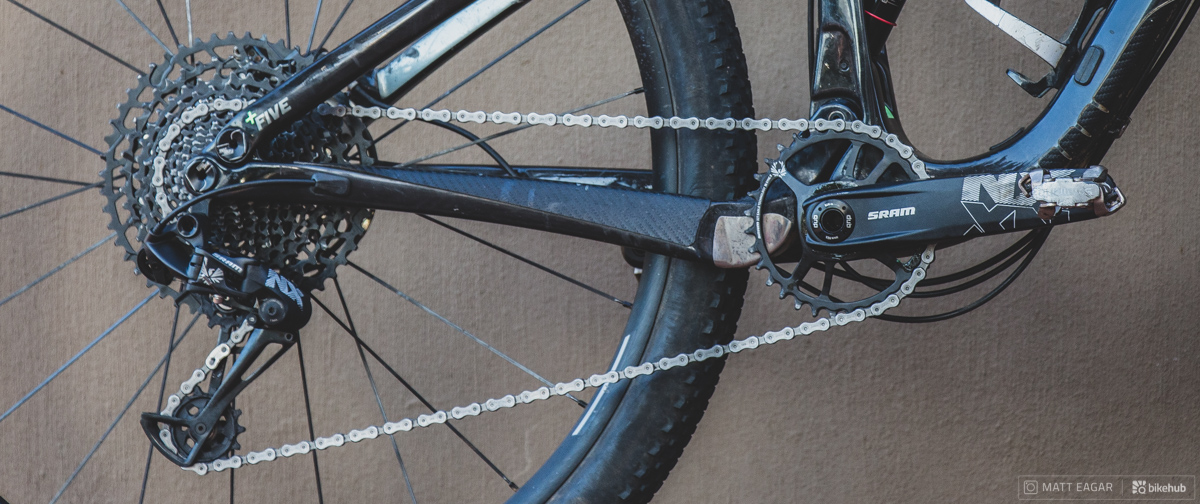

I’ve had the Eagle NX groupset on my Pyga Stage for just over three months. It is the same bike that I tested the GX Eagle system on a few years ago. When not sporting test drivetrains, the bike is dressed in 11-speed GX.
I notice very little difference between the general performance and shifting between NX Eagle and GX Eagle groupsets. From my experience with XX1 and X01 Eagle on other bikes, the feel of the shifter is a little more premium to the touch (the plastic NX Eagle shifter gives it away) but there is little to distinguish them at their main task, changing gears. Weight is really the defining difference between the Eagle families and, of course, the slightly reduced gear range of the NX Eagle cassette.
Over the three months of testing, the NX Eagle groupset has functioned flawlessly. The only maintenance required was a twist or two of the barrel adjuster to accommodate the stretching of the new cable. Otherwise, the shifter developed no play and the derailleur remained crisp and accurate. SRAM’s chain retention is renowned and NX Eagle did not disappoint, with clatter and noise kept mostly underwraps.
The test groupset arrived with a 32 tooth chainring. I understand that for many riders this might be the optimal size but, for me, sizing up to a 34 tooth chainring would better suit my riding. Furthermore, if you consider that NX Eagle lacks the smaller 10 tooth cog on the cassette, you’re going to need some added grunt if you plan to power along dirt road at any considerable speed in the 11 tooth.
