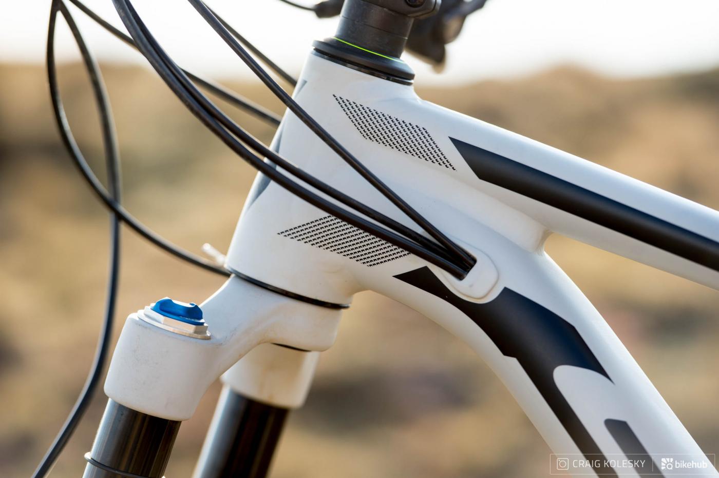

With the new Spark platform, Scott have embraced modern geometry with a longer bike and slacker angles. Riders now have more room in the cockpit allowing for a shorter stem and more direct steering. A slacker head angle improves handling on the descents as the fork is better placed to absorb impacts and is less likely to see the rider topple over the handlebars. Our Large test bike had a 67.2 degree head tube angle with a 460 mm reach and 438 mm chainstays. These figures are firmly in line with most modern trail bikes.
The new Scott Spark also incorporates Boost 148 axle spacing into the frame design with the forks fitted also having the Boost 110 axle spacing. The benefit of this is a stiffer wheel, great clearance for big tyres, and the ability to tweak the wheel position to shorten the chainstay length.

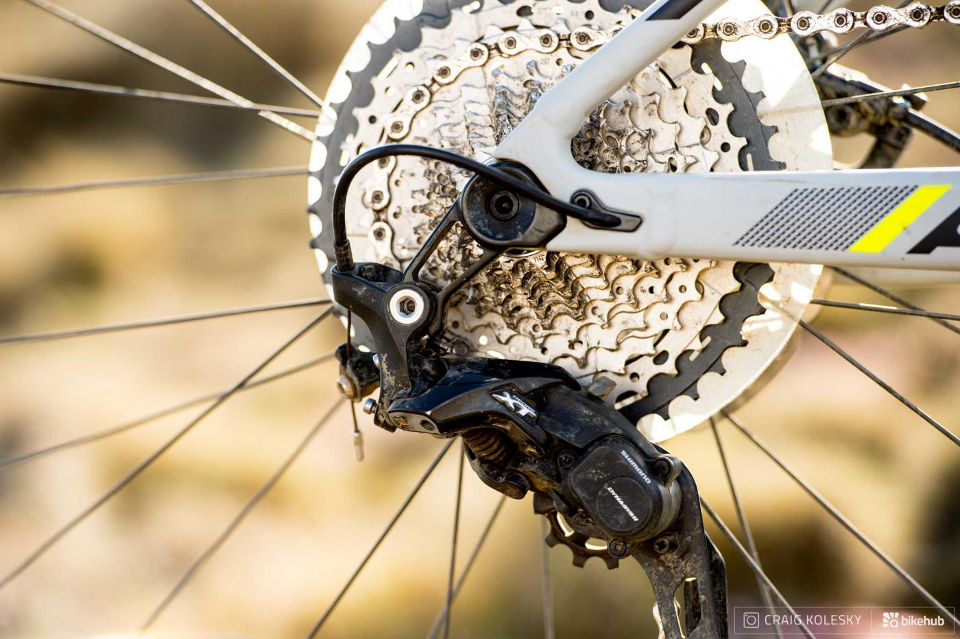

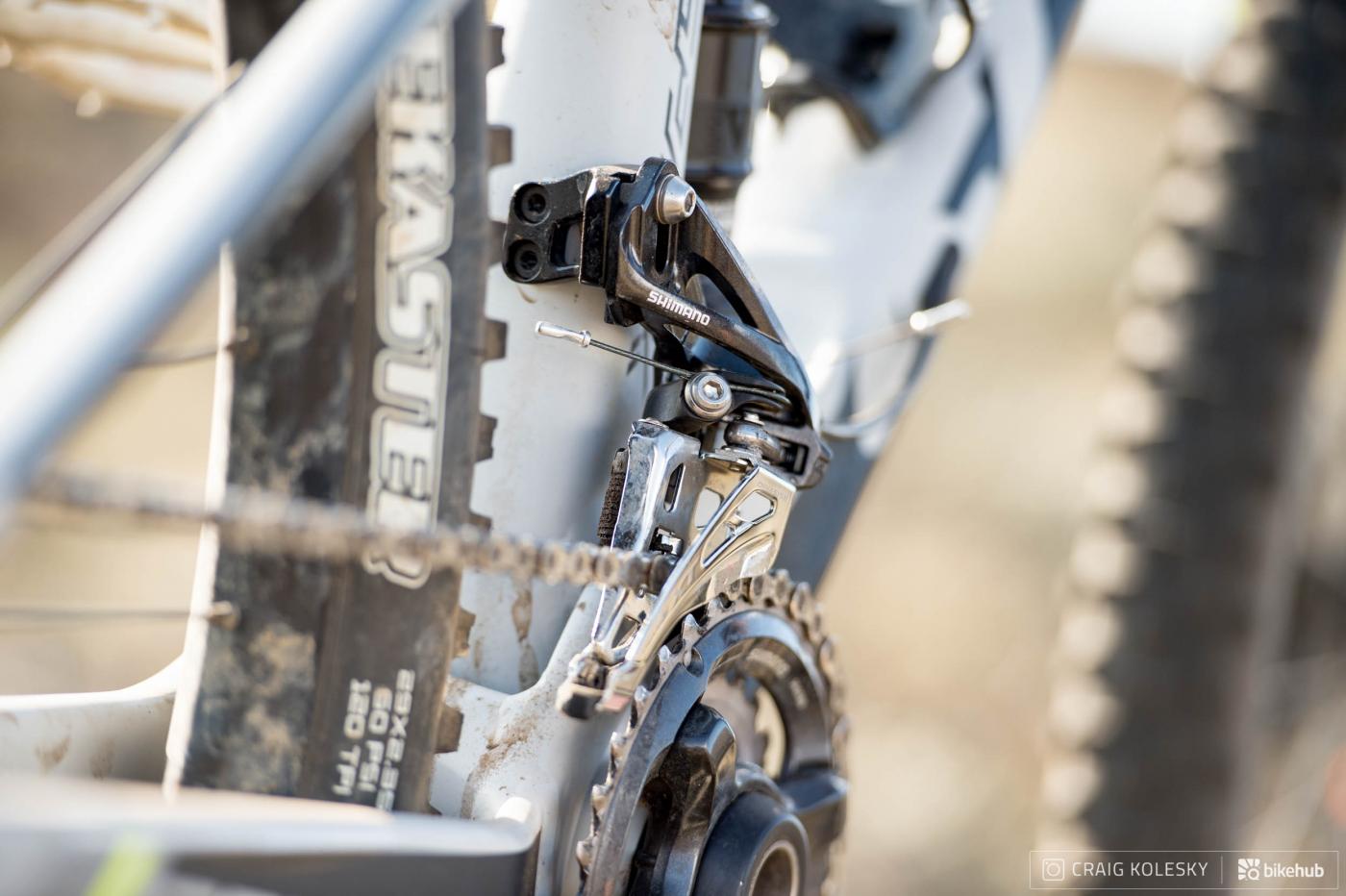

Drivetrain: The Spark 940 is kitted with a Shimano XT 2x drivetrain (with the exception of an SLX cassette). Shimano’s drivetrains are well-proven to be reliable and I had no problems during the testing of the bike.
My only gripe was the 34 tooth big chainring fitted on the 900 series bikes. On my own bike, I often run my 1×11 setup with a 34 tooth so with two chainrings, I would have expected a bit more extension down the range than I have on my single chainring setup. However it is relatively easy and inexpensive to upsize the chainring.

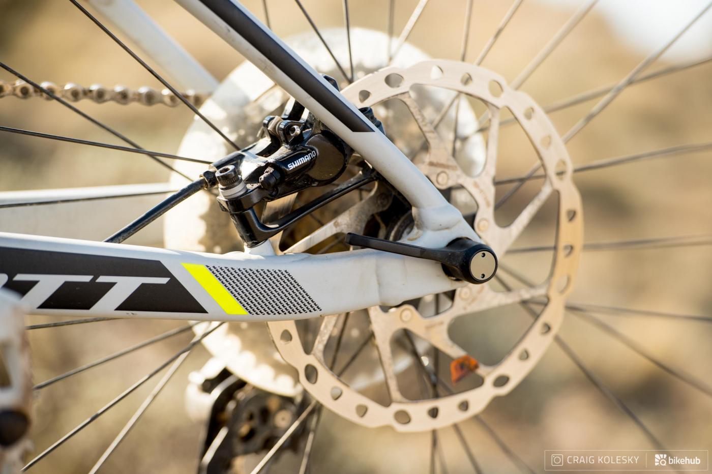

Brakes: The Deore brakes are excellent, especially considering Shimano have three brakes above it in their hierarchy. In fact, when first writing this review, I assumed they matched the XT drivetrain until I checked again.

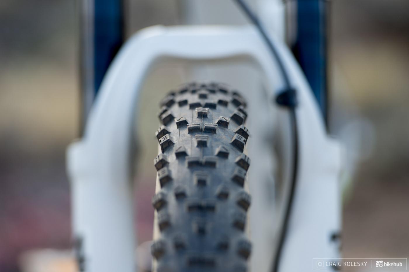

Tyres: The Maxxis Forekaster is a great trail tyre. The grip is excellent and without any change in feel or loss of grip when transferring to the outer knobs. In muddy conditions, the Forekasters shed mud well and provide adequate grip.

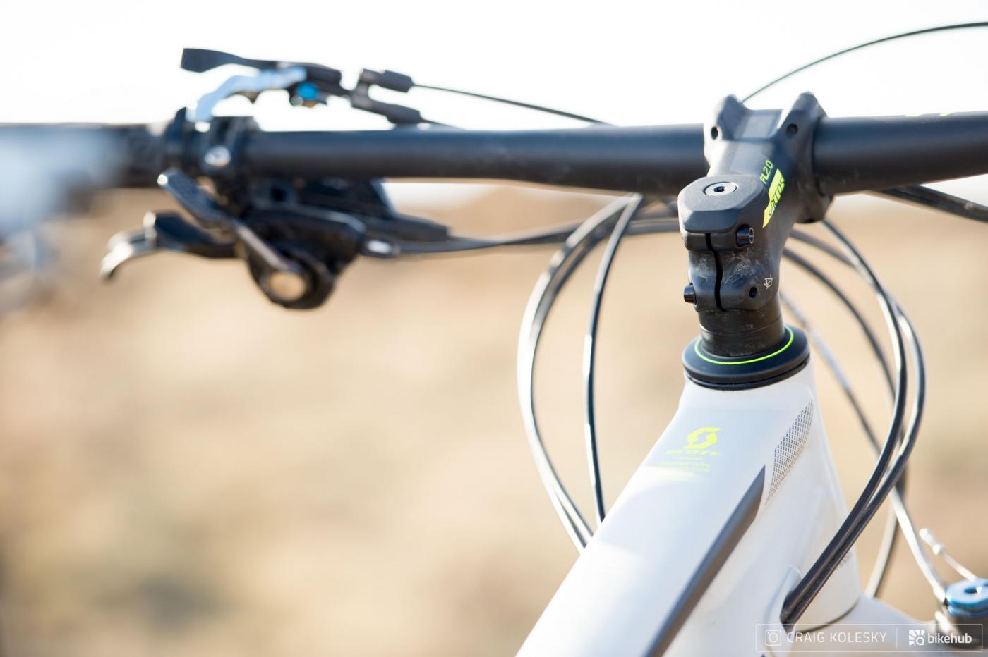

Cockpit: Considering the aggressive frame geometry, I would have expected something a bit wider than the 740 mm handlebars on the large frame, as they can always be cut down to the rider’s preference. The 70 mm stem is a good middle ground and can easily be swapped out to meet the riders preferred length.
The Syncros XR 2.0 saddle and my nether regions did not agree with each other and I had to swap it out for something a bit wider after the first ride. This is not a criticism of the saddle, it was simply a fit issue.
No mention of all those cables and levers?
Must be a pretty busy cockpit with;
L+R brake levers
F+R shifters
Dropper post lever
F+R twin-lockout lever.
I test rode the previous spark 940 which was fine, but it didn't have the extra dropper lever+cable. How's the layout and its operation?
