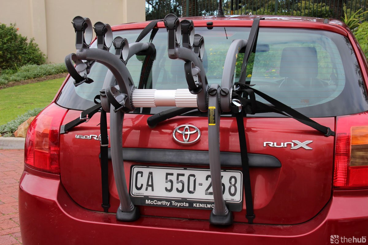

Setting up the Bones 3 to fit my car was a little overwhelming at first but after a few minutes of playing around I managed to get head around the Bones design, which turned out to be pretty smart and straightforward. I had the Bones 3 adjusted for my car and attached in 10 minutes.

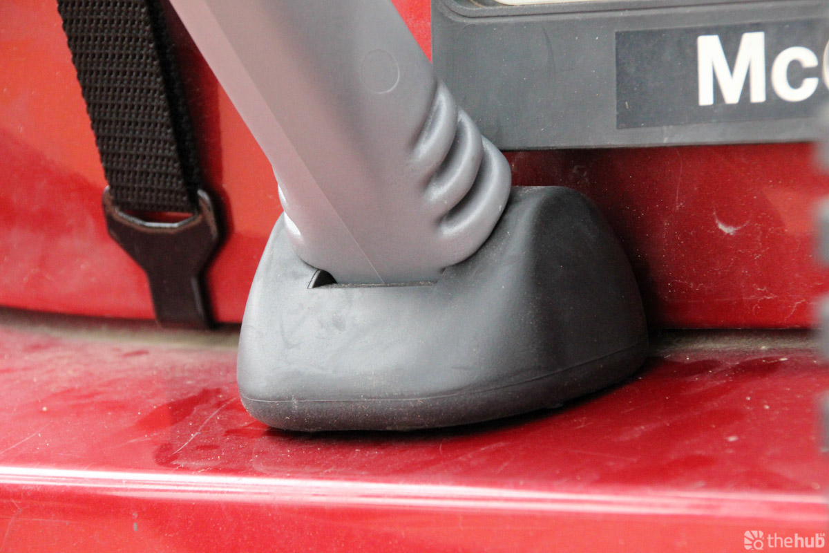

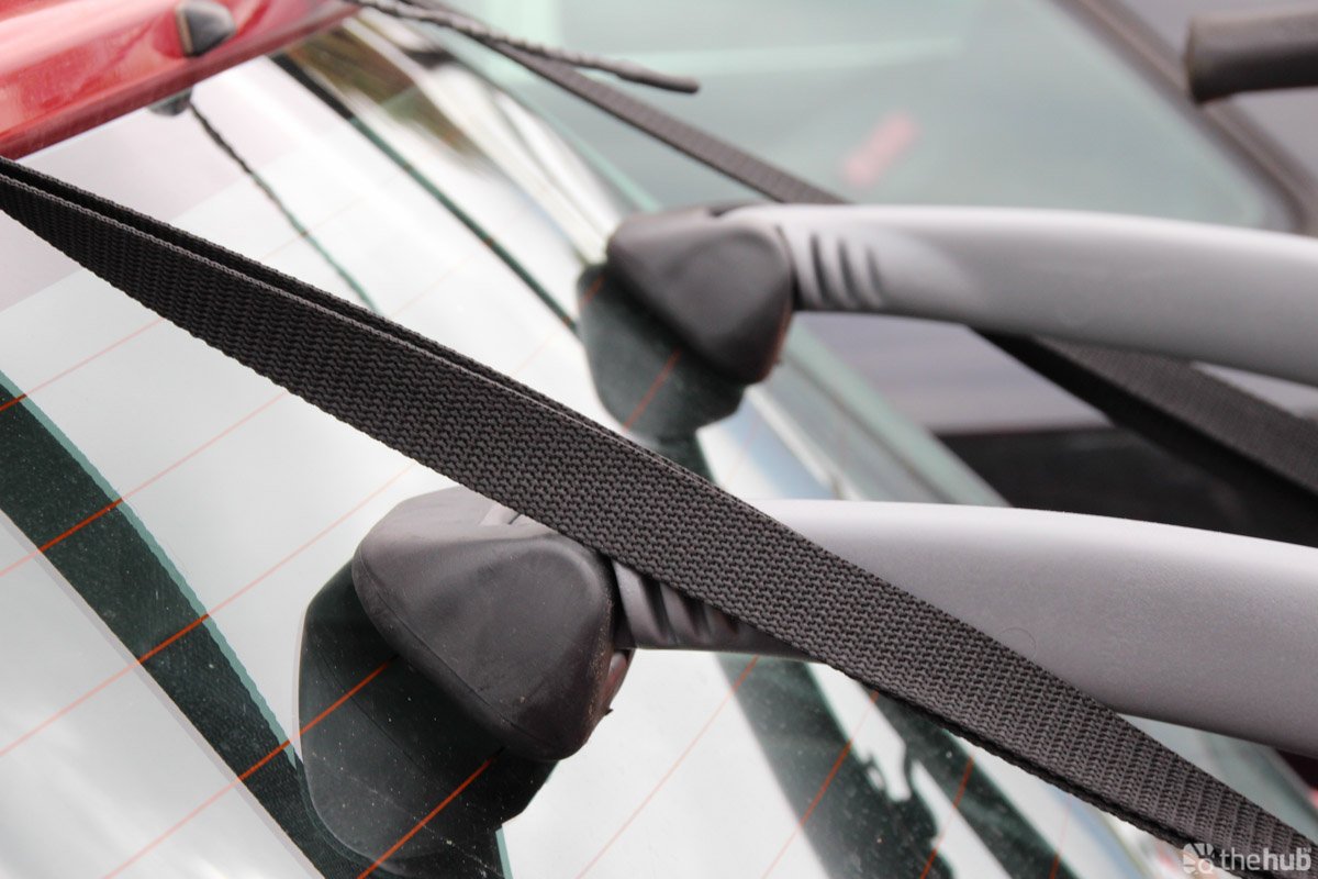

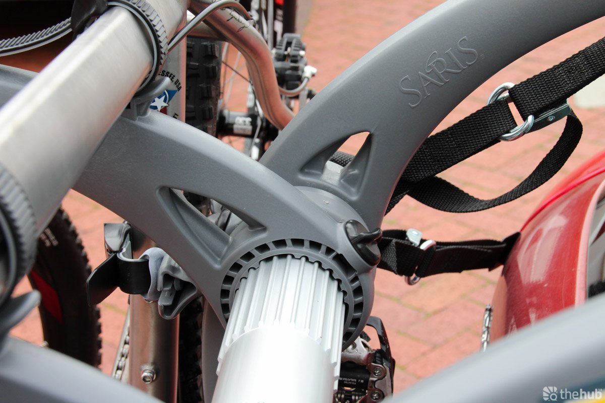

Setup is done by rotating the arms of the Bones 3 around the central shaft. The four arms that connect with car need to be adjusted to fit the shape of your boot while the two arms holding the bikes need to be set to an angle that will hold them level. The feet on the arms contacting the car are made of a soft rubber and shouldn’t cause any scratching or scuffs.

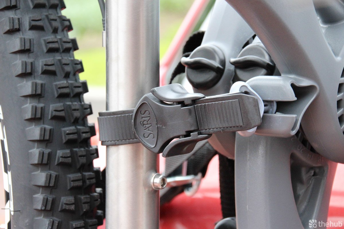

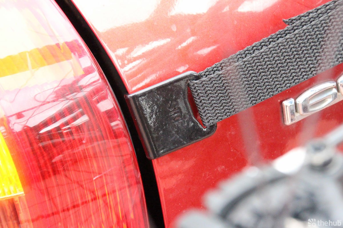

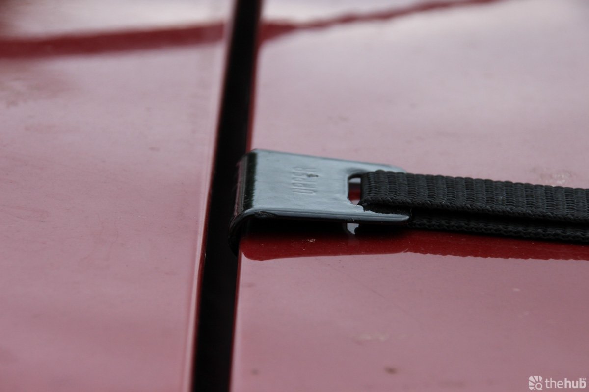

The rack is secured by straps which connect above, to the side and below the rack on the rear door edges or underside of the vehicle. The straps felt strong and the latches are metal with a thick coating of paint to attempt to prevent scratching to the car. The straps are tightened using a familiar ratchet. Once all properly tensioned, trying to dislodge the Bones only resulted in shaking the car.

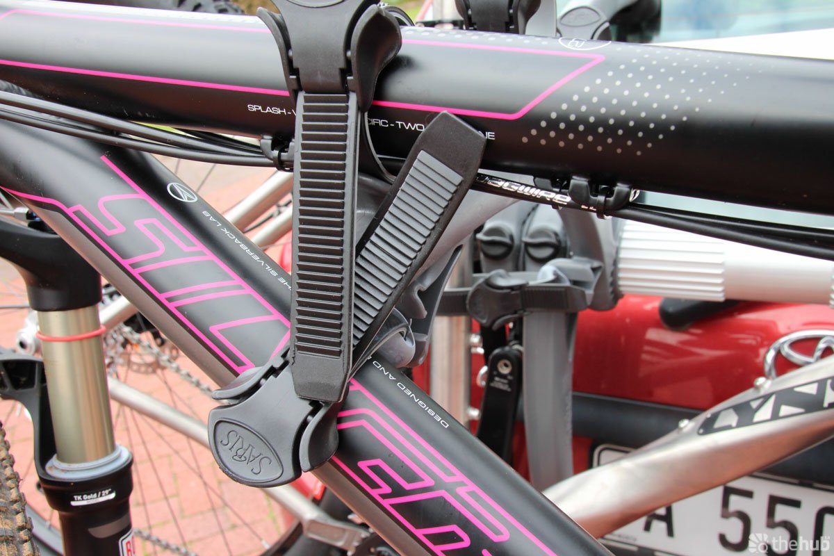

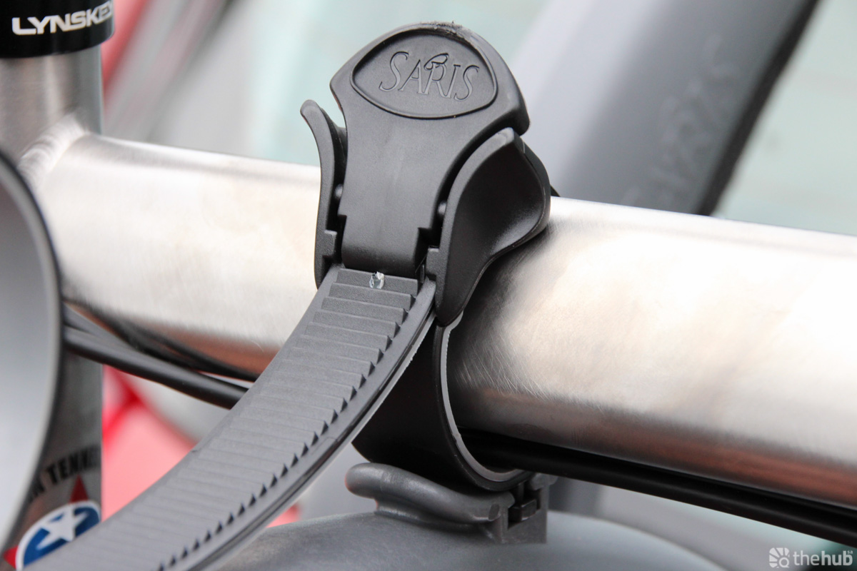

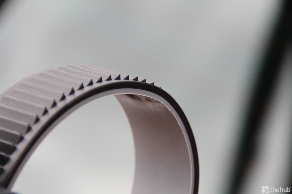

The straps holding the bikes in place are plastic with a ratchet clip to fasten. There is softer inner layer which appears to well suited to protecting the frame.

I found that bikes with small front triangles, either due to frame size or a simply snug design, were a bit of a squeeze. The combination of the top buckle straps and anti-sway straps underneath did leave too much room to work with.
During testing the Bones 3 was mostly used with two bikes and it excelled at this. When testing with 3 bikes it was a very tight fit requiring a fair amount of alignment of pedals, handlebars and saddles was required to get the bikes secured safely. Given the compact design and snug fit with three bikes some additional padding between them would be advised.
