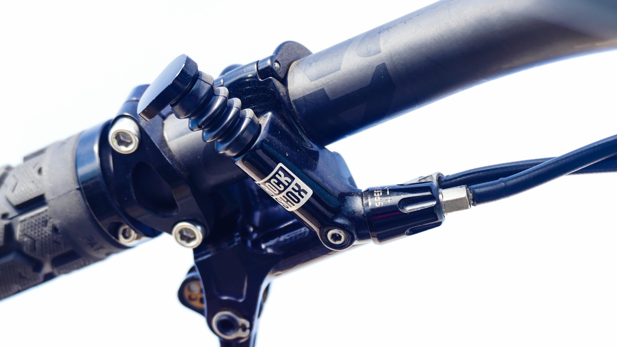

The post is activated using the XLoc remote which pushes 2.5wt hydraulic fluid down the line to open the main oil flow valve. A key design feature is that the hydraulic remote fluid and the seatpost’s oil and air springs are all kept separate from each other. The remote fluid is contained within the XLoc trigger, hose and the Reverb’s head, while the air spring is enclosed at the bottom of the outer tube. The post oil that allows the Reverb to travel up and down, and also holds it firmly in place, flows between the inner and outer tubes, and is backed up with an internal floating piston to keep the Reverb from becoming soft, if the saddle has to be raised by hand.
On the remote side there is an aluminium dial that is used to adjust the return speed. Turning the dial alters the oil volume within the remote system, raising or lowering the height of the main valve within the seatpost. Different heights use more or less of the taper on the valve, dictating the amount of oil flow that is allowed to move between the inner and outer tubes and with it the seatpost’s return speed.
Another convenient design feature is the incorporation of the MatchMaker X-Clamp which allows the mounting of Guide or Level brakes, a Reverb remote and a gear shifter on a single handlebar clamp. This makes for a very neat, uncluttered handlebar. The only downside is that the adjustment of each control is limited and you will have to find a happy medium in how close or far away from your grips you want all your controls.
One thing worth noting is that the levers are right or left hand specific and are designed to mount on top of the handlebar. Going that route means an awkward reach is required to get your thumb to the remote. I have found it better to mount the remote under the handlebar. Mounted upside down the remote is easier to push with a natural gear shifter like movement. With the advent of 1x drivetrains most users mount a right hand top lever on the underside of the handlebar where the left shifter would be.

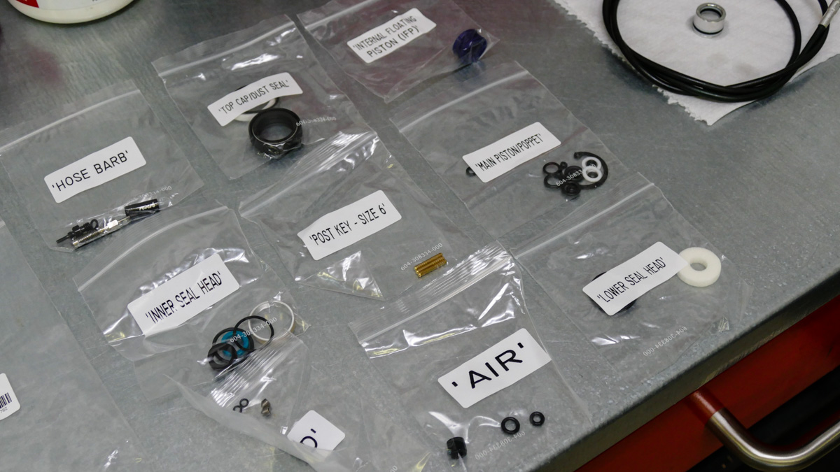

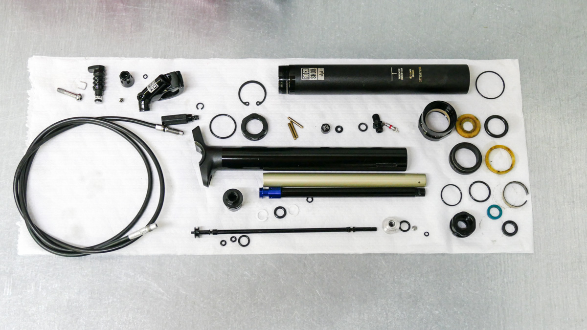

Recently the seatpost started returning to full height slower and slower until it finally refused to move upwards at all. I knew the day was coming and purposely neglected routine internal maintenance to see just how long it would last.
Should your Reverb need some love, the local agents have all the service kits required from basic interval services right up to full rebuild kits. To ensure maximum life, I advise servicing your Reverb at least once a year. I was present when mine was stripped down by the local distributor and it is not something I would leave to the untrained.
ccs-62657-0-94479500-1469542907.jpgOut with the old.
ccs-62657-0-44732500-1469542908.jpgIn with the new.
