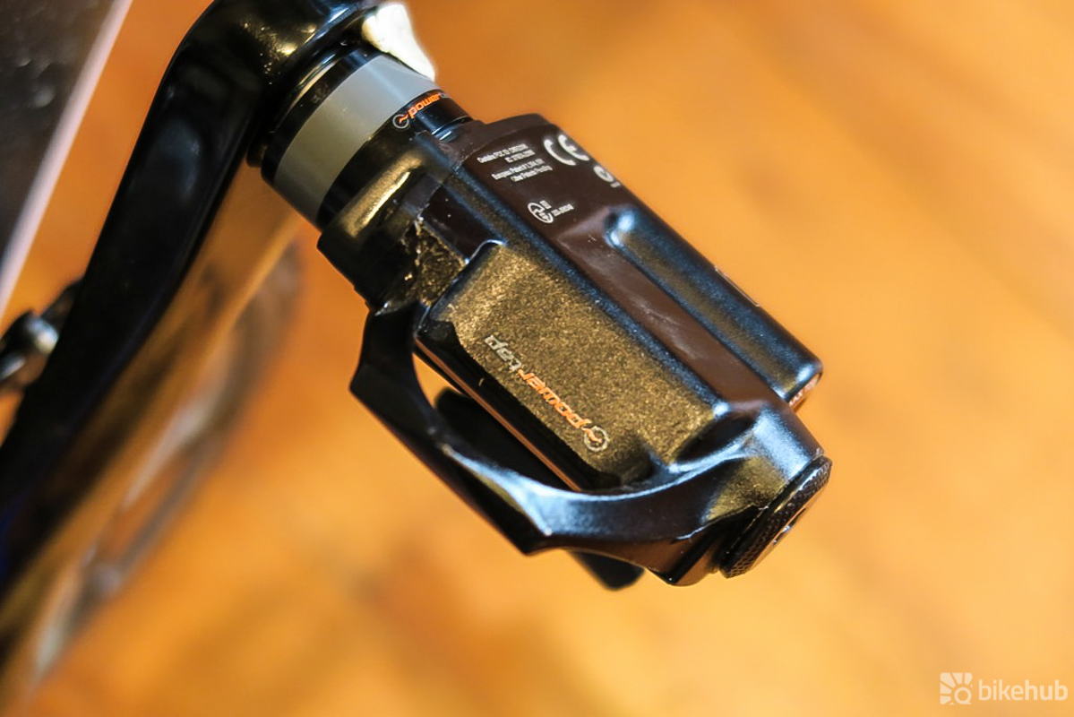

Each pedal houses eight strain gauges in the steel axle, spinning on two needle bearings and one case bearing. According to PowerTap, the bearings should be good for many thousands of miles, but you can’t service them yourself. Serviceability is limited to external wear items like the claw, spring, pedal plate and battery cover o-ring. All other internal wear components must be serviced by PowerTap.
In addition to the strain gauges built into each pedal there is a “Multipole Ring” sensor with 20 magnets positioned around each pedal spindle. This measures the application of force throughout the entire stroke and identifies dead spots and pedal-stroke inefficiencies. To date, PowerTap is yet to find a way to display this data, but they are working on it and it’s certainly exciting to know the tech exists and comes already build in.

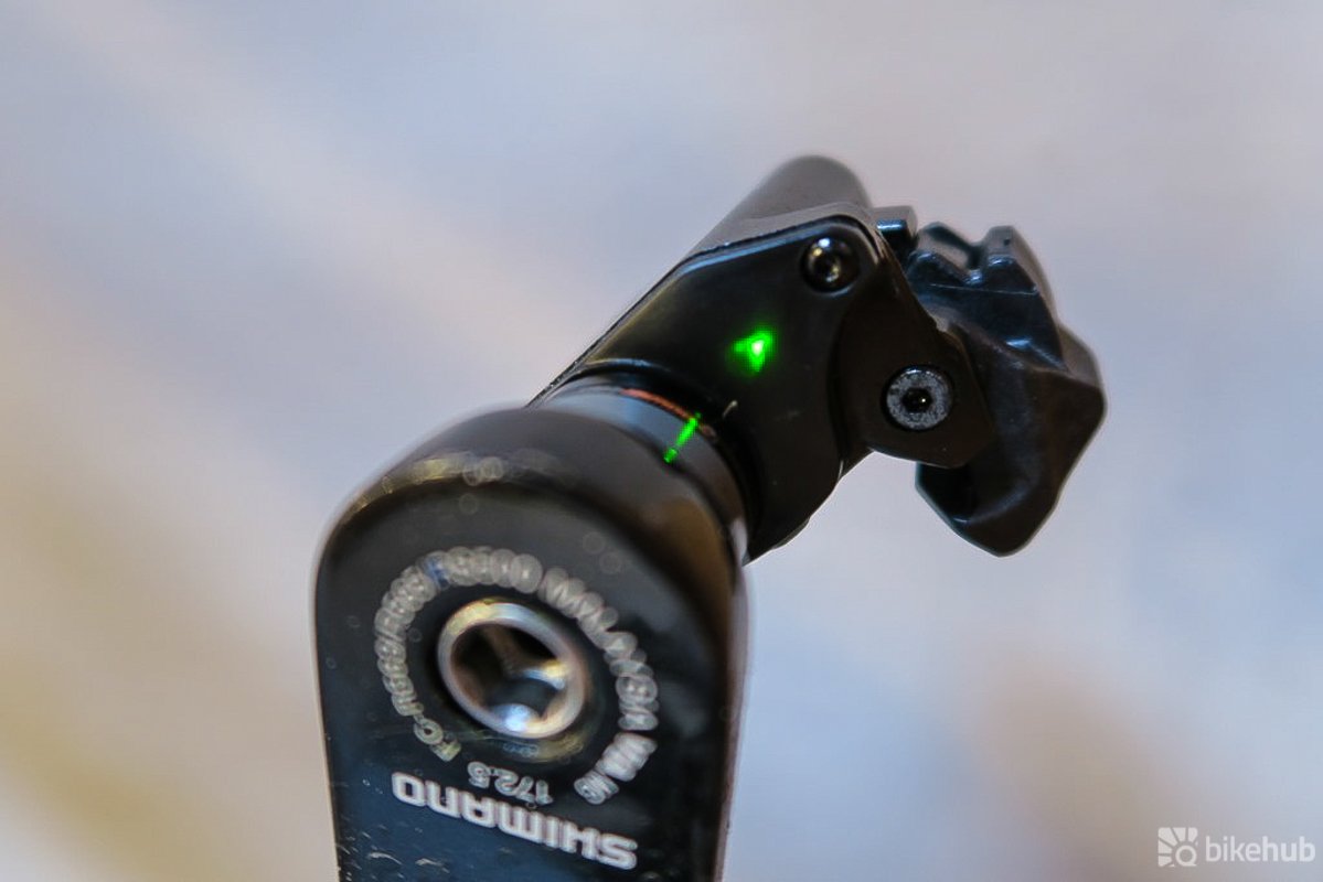

ccs-62657-0-70351800-1444736034.jpgA green LED indicates that the pedals are on and connected. It turns red when there are complications.

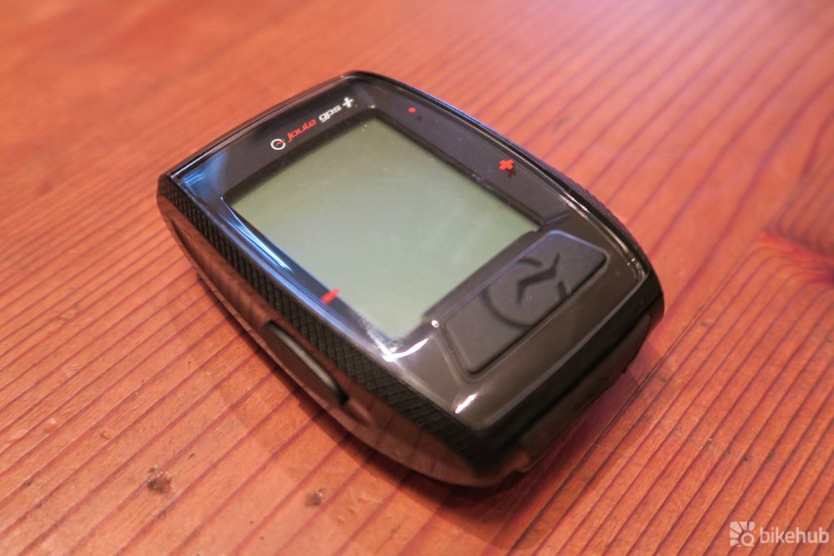

PowerTap Joule GPS+
ANT+ allows the unit to connect with power meters, heart rate straps and other devices and sensors. With Bluetooth, the Joule GPS+ can do a wireless upload to PowerTap’s mobile app, which in turn can be linked to auto-upload to popular training sites like Strava and TrainingPeaks. With about 80 hours of internal memory your rides and info will remain safe until you next make it to your computer to transfer the data.

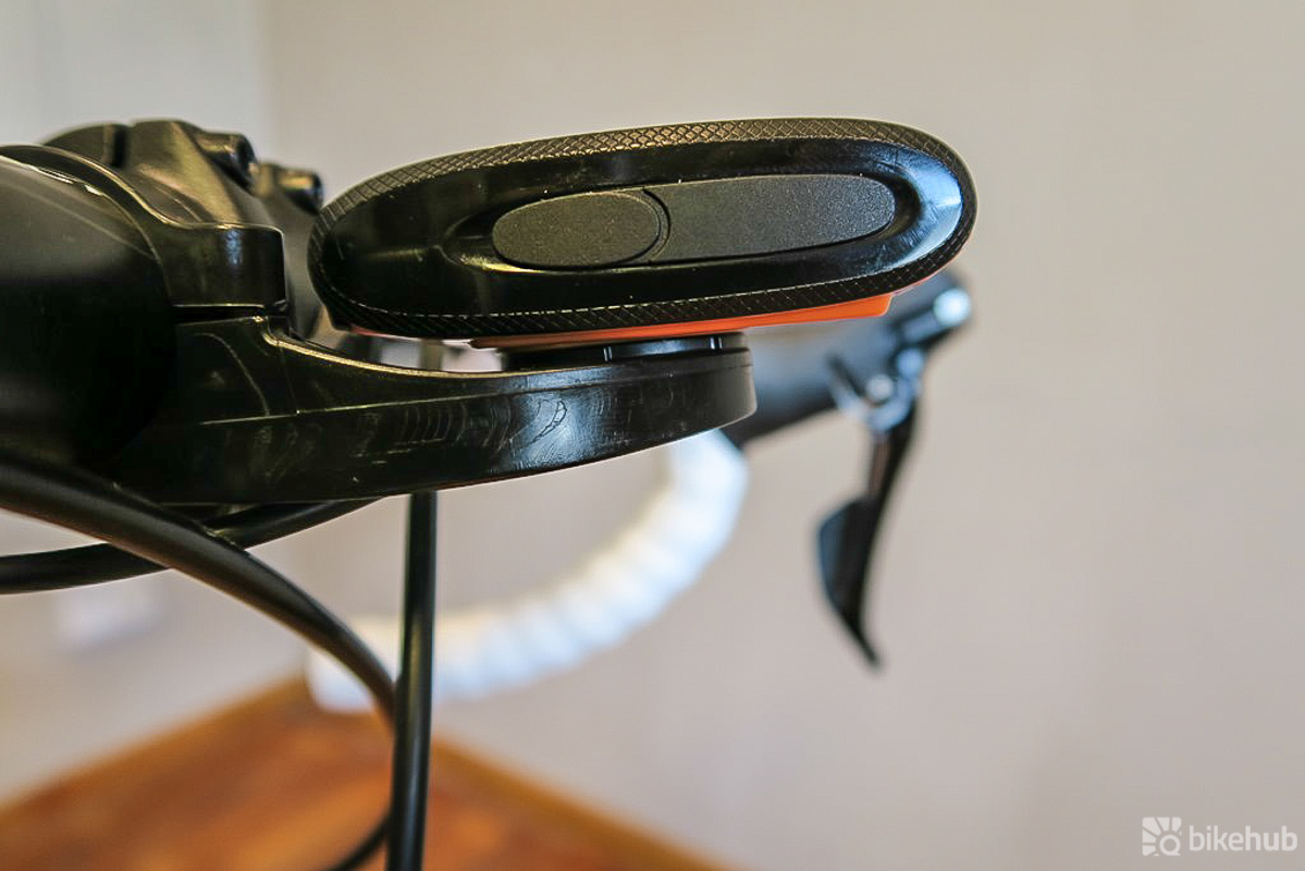

The PowerTap Joule GPS cycling computer allows you to upload routes and receive turn-by-turn directions while riding your bike. To do so, create the route using any popular map creation software or website, export the route in .GPX or .TCX file type, and upload to the Joule GPS using PowerAgent.
The Joule GPS+ was a joy to use. Simple to set up and understand, taking no time away from riding your bike. Pairing devices was quick and painless and once a connection was established it was rock-solid for the duration of my training. I didn’t use the turn-by-turn navigation often, but when I did it was accurate and can be a bonus to riders training a specific route or when out exploring on your bicycle.
The screen and the data views are highly configurable. In direct sunlight it does suffer a bit, but not to the extent where you can’t see the display. It’s route logging is accurate and the GPS signal is solid once acquired.
  • VAM – How quickly the rider is climbing a hill. The rate of ascent in meters/hour. This feature is most effectively used in interval mode. Start an interval at the bottom of a large climb. Stop the interval at the top. See how quickly you’re gaining elevation.
  • Normalized Power (NP) – An estimate of the power the rider could have maintained for the same physiological “cost” if the output power was constant.
  • IF – Comparison (ratio) of a ride’s normalized power to the rider’s threshold value.
  • TSS – Training stress score: an estimation of a ride’s total difficultly based on glycogen burned.
For more definitions and information, you can visit PowerTap’s Glossary.

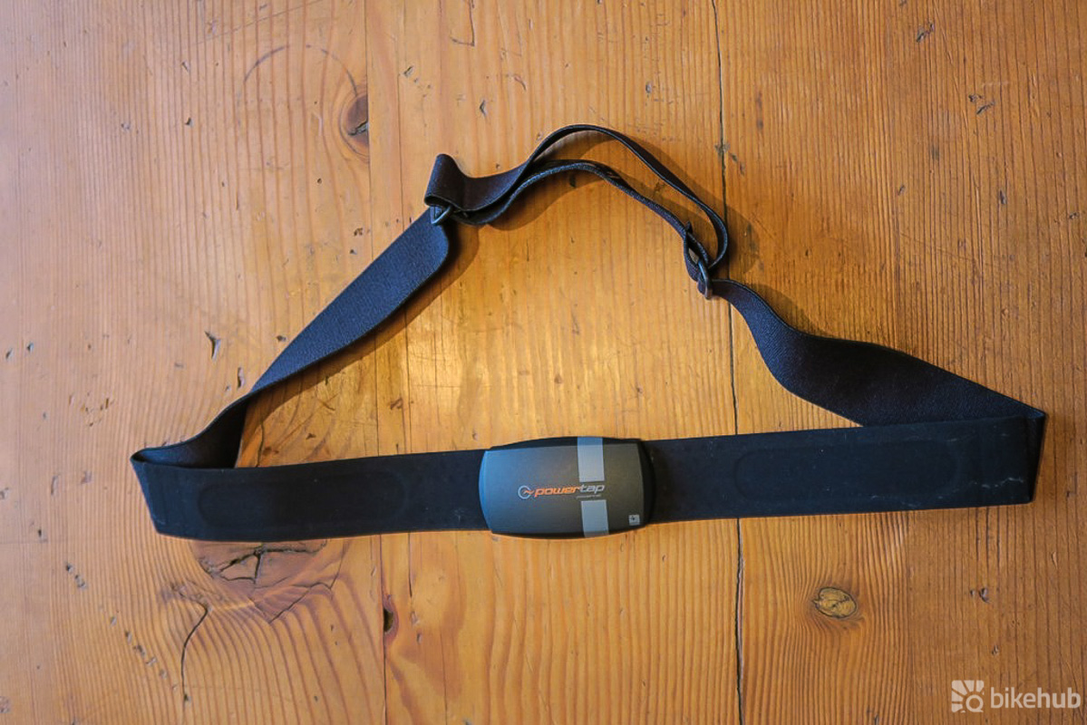

The PowerCal is a chest strap that converts your heart rate into an ANT+ watts signal that can then be displayed on the CycleOps Joule or any other compatible unit. The calculation is done using an algorithm which quantifies your effort on the bike, providing a real-time ‘wattage’ number as you ride.
Specs:
  • Signal Transmission: Bluetooth Smart (Cycling Power Service, Heart Rate Service, Device Info Service) or ANT+ (2.4 GHz)
  • Operational Temperature: 0-40C/32-103F
  • Battery Type: CR2032
  • Battery Life: 400 Operational Hours (Bluetooth); 600 Operational Hours (ANT+)
  • The PowerCal is not a waterproof device and should not be submerged in water
  • PowerCal BLE is compatible exclusively with the PowerTap mobile application on iPhone 4S or higher.
  • PowerCal ANT+ is compatible with android and iPhone/iPad devices with use of appropriate ANT+ adapter key
  • PowerCal ANT+ is not compatible with cervos (little yellow computer) or older grey indoor cycle consoles.
  • Recommended Retail Price: R1,495.00

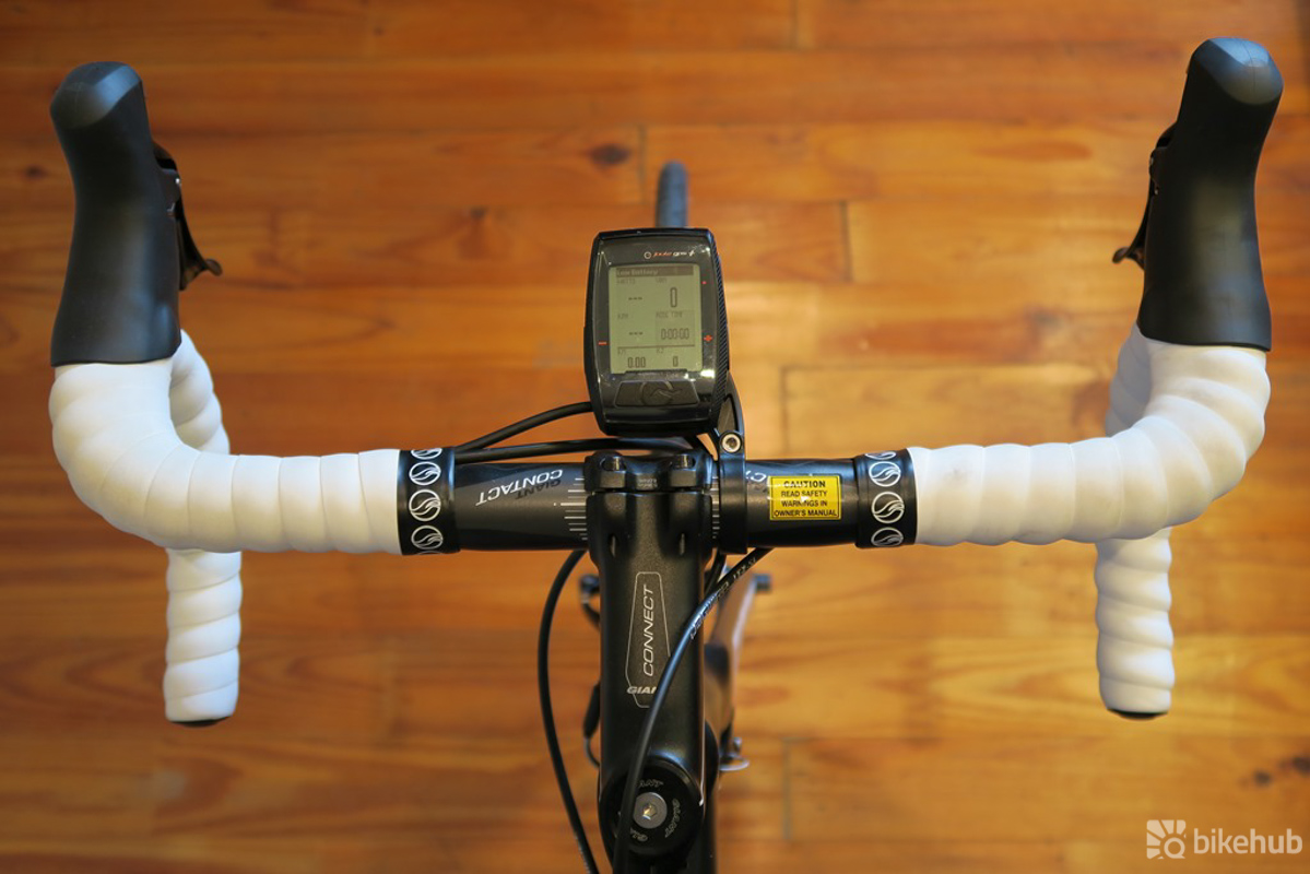

Once you have the Joule’s screen set up to display the fields you would like to view, all you have to do is get going. The Joule GPS+ will start recording your ride as soon as it picks up that you’re moving and, as explained above, the P1’s will pick up crank arm length and exactly where it is in the stroke thanks to it’s host of build-in sensors.
Live left / right analysis while riding is great feature over and above pure power figures and that alone gave me enough to work on during the review period. It was especially interesting to see that one leg drops a greater percentage of power when the fatigue sets in. This information will not only help cyclists improve general strength and endurance, but help athletes recover from injuries and ensure that they do not put unnecessary strain on their legs or knees while recovering.

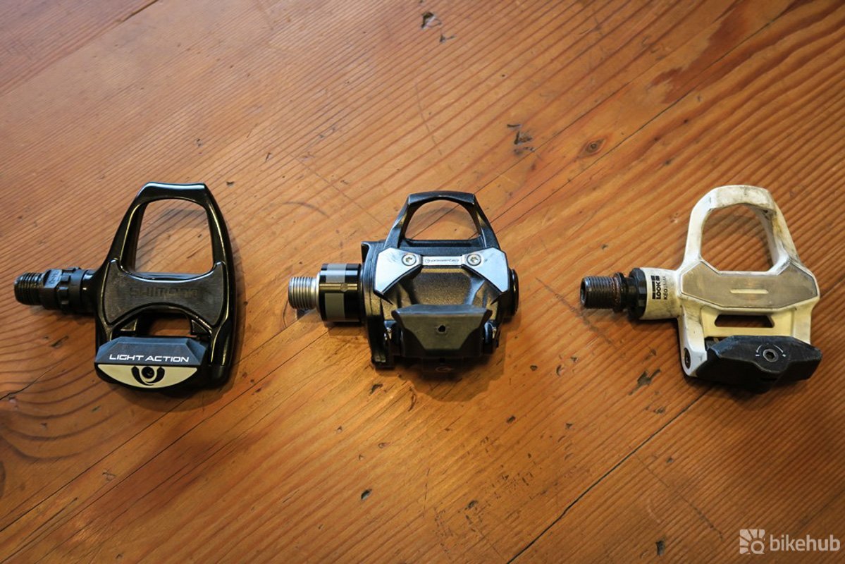

ccs-62657-0-43697000-1444736033.jpgLeft to right: Shimano PD-R540, PowerTap P1, and Look Keo 2 Max.

For those interested here's a LED Indicator chart
?ui=2&ik=c88433d084&view=fimg&th=1505635

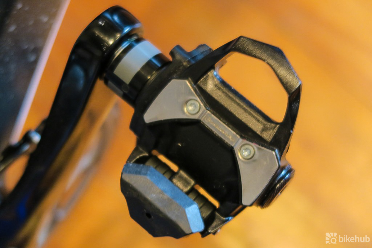

Something else I noticed while taking the photos: of all the road pedals I had on hand the P1's were the only ones that could stand on the axle. The others are all rear heavy and kept falling over and n doing so ruined my chances of a side profile pic of each.
May not have a massive effect, or at all, but the P1's are balanced front to back. Not 50/50, though. Probably closer to 40/60. Use it, don't use it.
