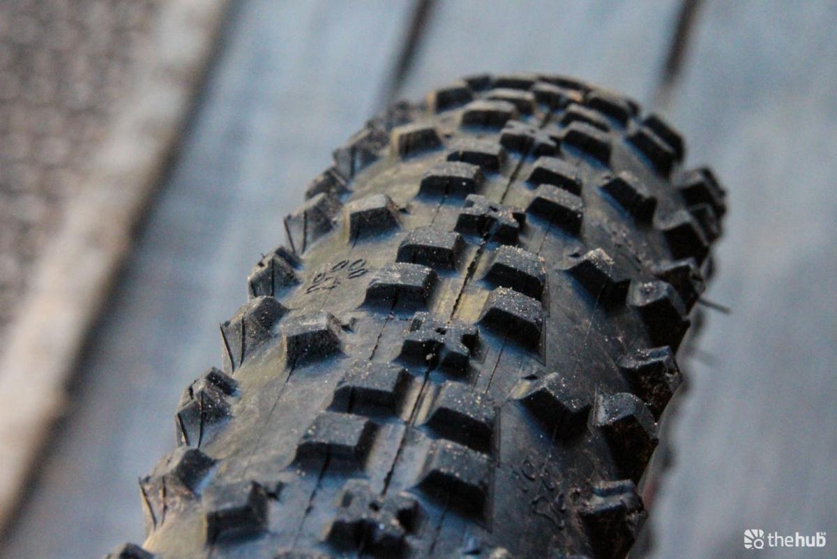

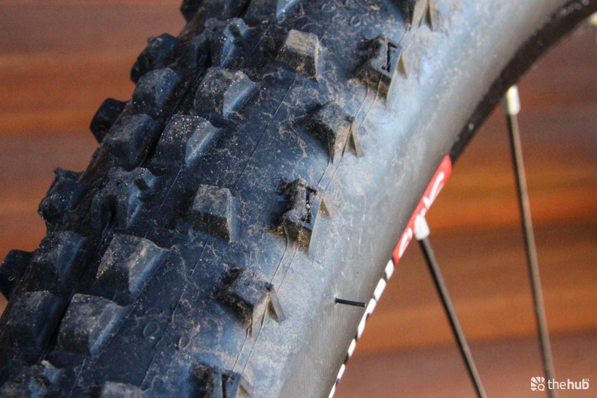

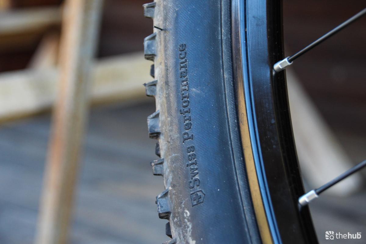

My first few outings on these tyres were to a very wet and muddy Tokai. I was impressed by the grip even in the soggy conditions which Onza don’t really class these tyres for. Thanks to the open tread pattern on the outer edges mud and dirt cleared well and they held on impressively well. In the really sticky clay-like stuff though, traction was limited as they struggled to dislodge the gunk.
In drier conditions I was quickly impressed with the rolling performance. What was first just a feeling of “woah, these are fast” was reinforced on the extended gravel roads of the Baviaans Kloof. On the open dirt roads they were fast rolling with good acceleration and none of the sluggishness slightly grippier tyres can add.
Through windy singletrack I found myself increasingly pushing the traction limits and confidently so. On a mixture of hard packed soil, slippery pine needles and roots, loose and sharp rocky sections they performed well and predictably. Only in very loose sand and very wet conditions did I find they began to lose contact.
For general trail and singletrack riding I found I got the best traction performance running them at lower pressures: usually 1.6-1.8 bar front and back depending on the terrain. Any higher and they tended to get overly slippery over rocks and roots (for reference I weigh in at around 73kg).
Durability
Having ridden close on 600km with these tyres over varied terrain so far they’ve held up well, but they have still got a lot of life in them. In terms of puncture resistance I’ve not had a single issue to date. So far I am very happy with the durability, but I’ll report back after a few thousand kilometers.
