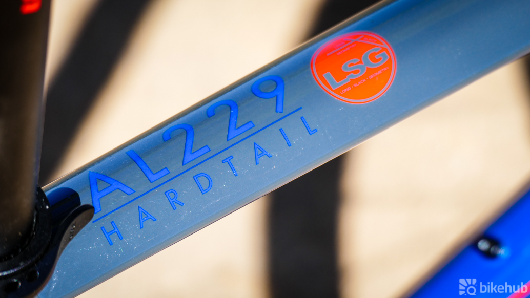

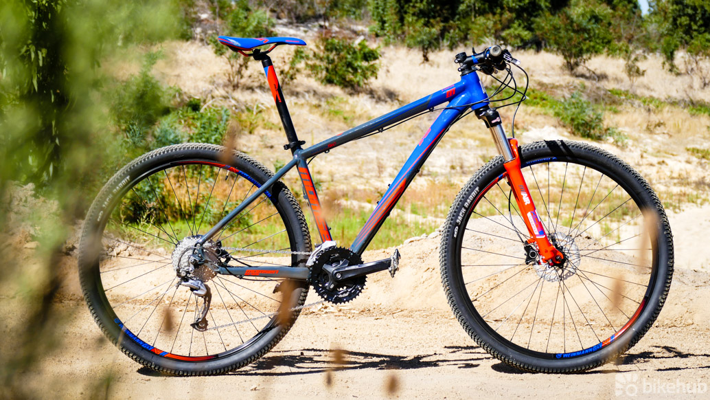

So how long, low, and slack is the Momsen AL229 LSG then? In comparison to modern bikes, the Momsen’s geometry is still very much a traditional design. However, amongst entry level hardtails, it is definitely more progressive than most. For those wanting numbers: on our medium frame the head angle is 70.5 degrees, reach is 423 mm, wheelbase 1113, chainstay length 450, and the bottom bracket drop is 60 mm.

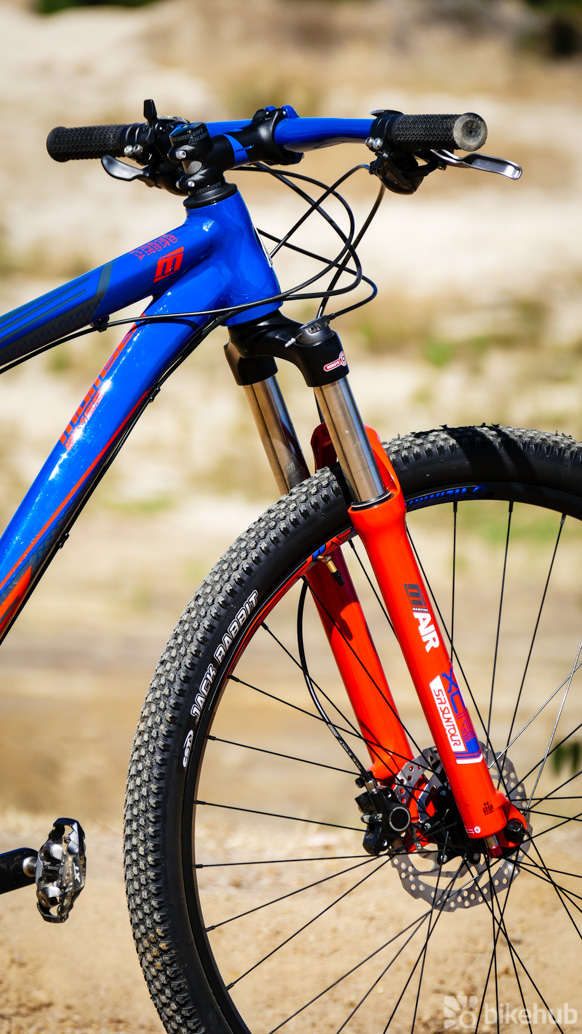

The SR Suntour XCR32 fork with rebound adjust features an air spring rather than the coil spring often specified in this price category. While there is nothing wrong with a coil spring fork, the air sprung variants are usually far easier for riders to set up for their weight, resulting in a better suspension feel. For those looking to put down the watts, there is a remote switch on the handlebar to lockout the fork.

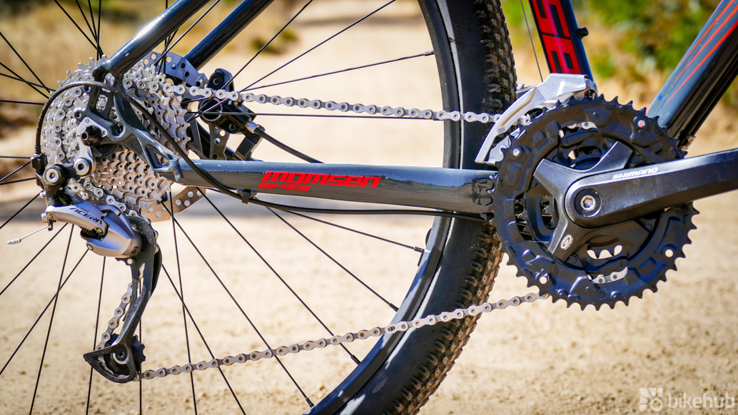

The drivetrain is made up of Shimano’s entry level Altus and Acera components. Shimano have gone a long way to improve their base offerings. The Altus and Acera combo proved to work flawlessly. Compared to much more expensive drive trains, the shifting under power can be a bit clunky, and you need to plan your shifting in advance of steep climbs, but on the flat shifting is smooth and hassle free.
The three chainrings are a bit overkill, as the gear range is more than adequate, but it seems that the cheaper groupsets are sticking to them, so no fault to Momsen on that one. Lastly, the chainstay is going to need a slap sock if you do plan to ride the rougher stuff, as chainslap noise can be alarming on bigger impacts. Overall, the drive system is perfectly suited for general mountain biking, and particularly covering distance on dirt roads.

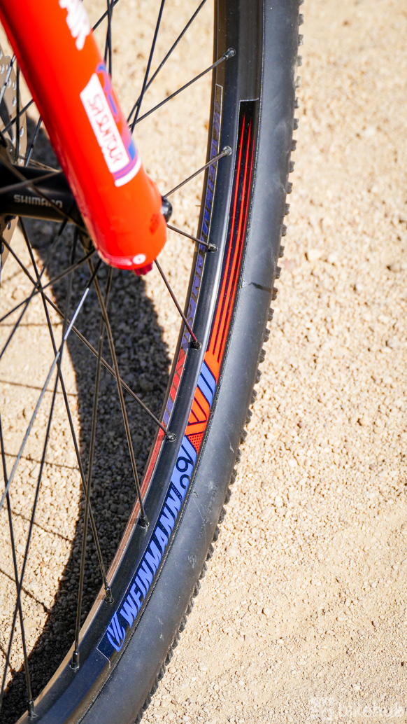

In this price range, the wheelset is never going to be anything amazing. All you can hope for is something solid and reliable. The combination of the Weinmann rims and Shimano hubs show promising signs of being just that.

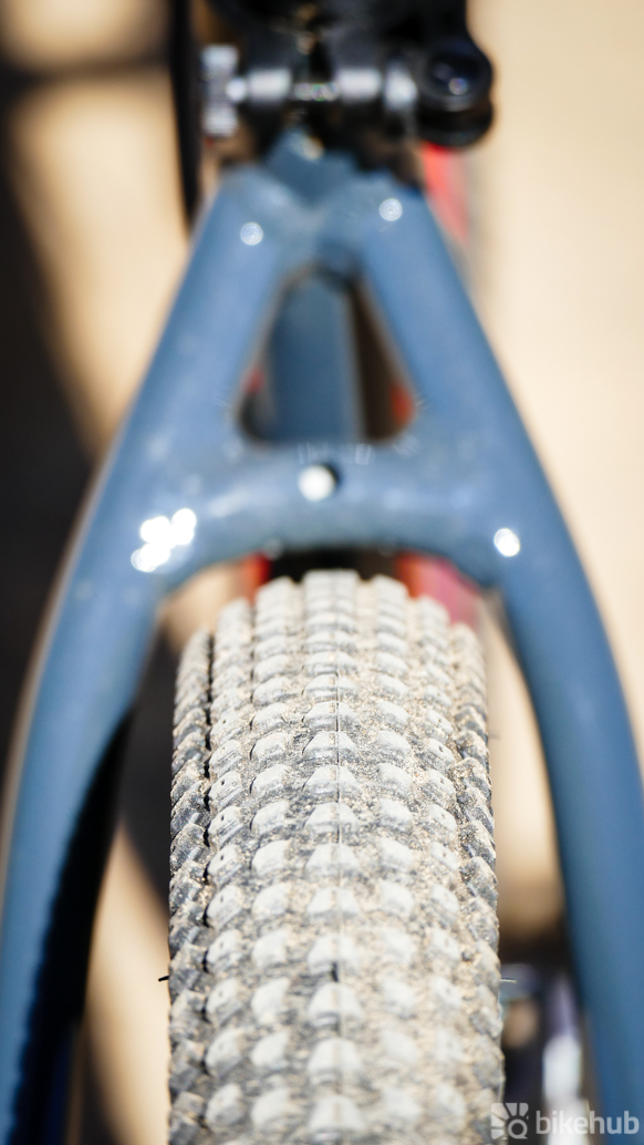

The CST Jack Rabbit tyres rolled very efficiently on dirt roads but in the corners the lack of sizeable tread means there is very little grip for the front tyre, and I was not too comfortable cornering at speed.

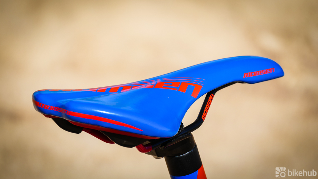

Contact points were good. The Kraton Composite lock-on grips were grippy and provided some shock absorption, and the Momsen 2017 custom, satin steel rail saddle was comfortable for short rides. Considering that I take the stock saddle off most bikes, this is no poor reflection on the saddle.

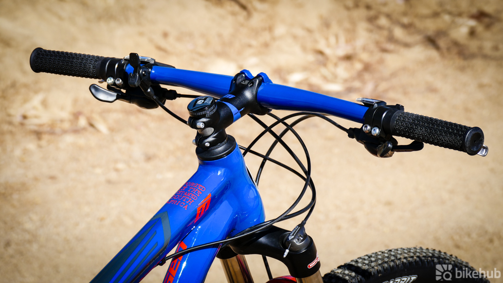

To match the increased length of the bike, the 80 mm stem is a bit shorter than is usually found in this price range, providing a more direct steering feel. At 700mm across the size range, the handlebars unfortunately won’t provide stability for bigger riders, but the bars felt adequate on the medium frame.

Compared to an older AL329, the AL229 LSG geometry of the Momsen is more planted on the trails which goes a long way in boosting confidence. On the steeper descents, being more centred on the bike relieves the fear of being pitched over the bars at any moment. The LSG geometry also increased the room in the cockpit which goes a long way to making the bike feel less cramped and an all-round a better fit. It is about time that the lower end of the market starts seeing the benefit of longer, lower, and slacker geometry. That said, I would not say no to even slacker and longer specs on the AL229 LSG.
Weighing in at 13.9 kilograms without pedals, it is no XC race bike but competitive in the price bracket. It is very comfortable chugging along on the flats, and once up to speed is quite capable of moving it with the best of them. Handling is agile, and aside from the lack of grip on the tyres, the bike nips through berms happily. The fork was impressive with its smooth travel, it is probably not the lightest, but functionally it punches way above the bikes price bracket.
