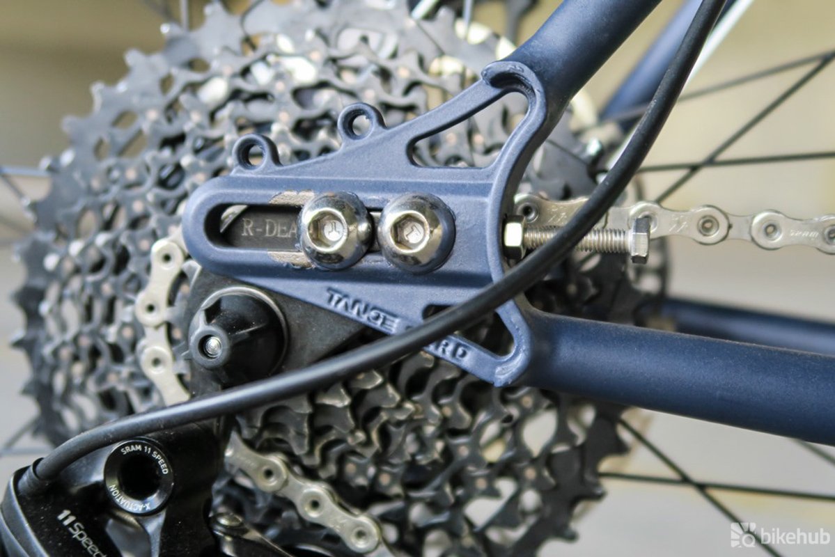

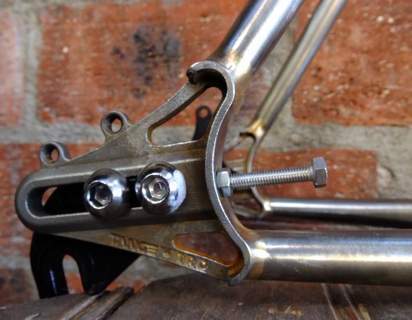

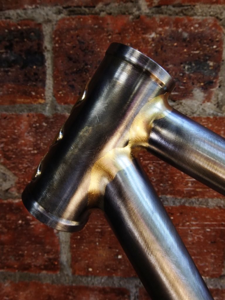

Hungry Monkey frames are built one at a time in the Cape Town workshop of Mercer Bikes. The frame is 650b specific and is equipped with sliding dropouts and has been designed to accept long travel forks (140 – 160mm). The head angle is a relatively slack at 66 degrees running a 160mm fork and the top tube is on the long side – 620mm effective top tube giving you a roomy 428mm of reach in the large size. To make a stable ride at speed, the bottom bracket is lower than the norm and the chainstay length can be adjusted from 420 to 445mm. A 1x specific design, the Hungry Monkey also has cable routing for a stealth dropper post making it a very versatile frame that can be set up for many riding styles.

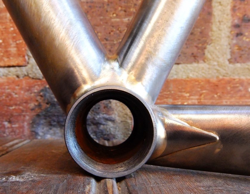

Steel’s longevity and liveliness are legendary and the heart of the Hungry Monkey is its handmade steel frame. A selection of double butted steel tubes from Columbus and Dedacciai are fillet brazed together – brass is melted into and around the join to fuse the tubes to one another. On a microscopic level some interesting things happen – there is a transition zone of bronze that forms through the interaction of steel and brass.
The fillets are then worked on with a file and emery cloth to reveal a smooth bond at each juncture – this helps to dissipate stresses at the join, as there are no sharp transitions to form stress risers. Since brass is also more ductile than steel, there’s a microscopic amount of flex that occurs at the joins. Traditional frame builders believe that this flex further enhances resilience.

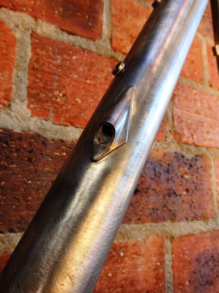

David Mercer does not use gussets on the front triangle as he feels that this concentrates stress around the ends of the gusset. Gussets are however used to increase the wall thickness of the chain stays where they are joined to the bottom bracket to compensate for the lack of chainstay bridges. By leaving out the bridge there’s a bit more clearance for larger tires and mud.

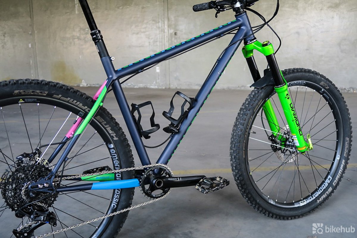

Components
Most Mercer Bikes ship as a frame only, leaving the buyer to cherry-pick all their components themselves allowing for a truly custom build bike.

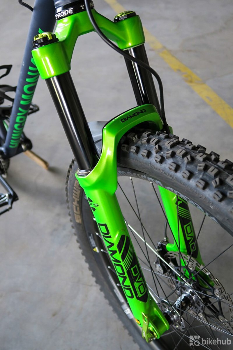

Fork: DVO Diamond
As a recent addition to the build, I don’t have too much to say about the DVO just yet. So far it’s been all good, but I need some more time on it to get it dialed to my liking. For now you can have a look at our “First Look” article about it here.

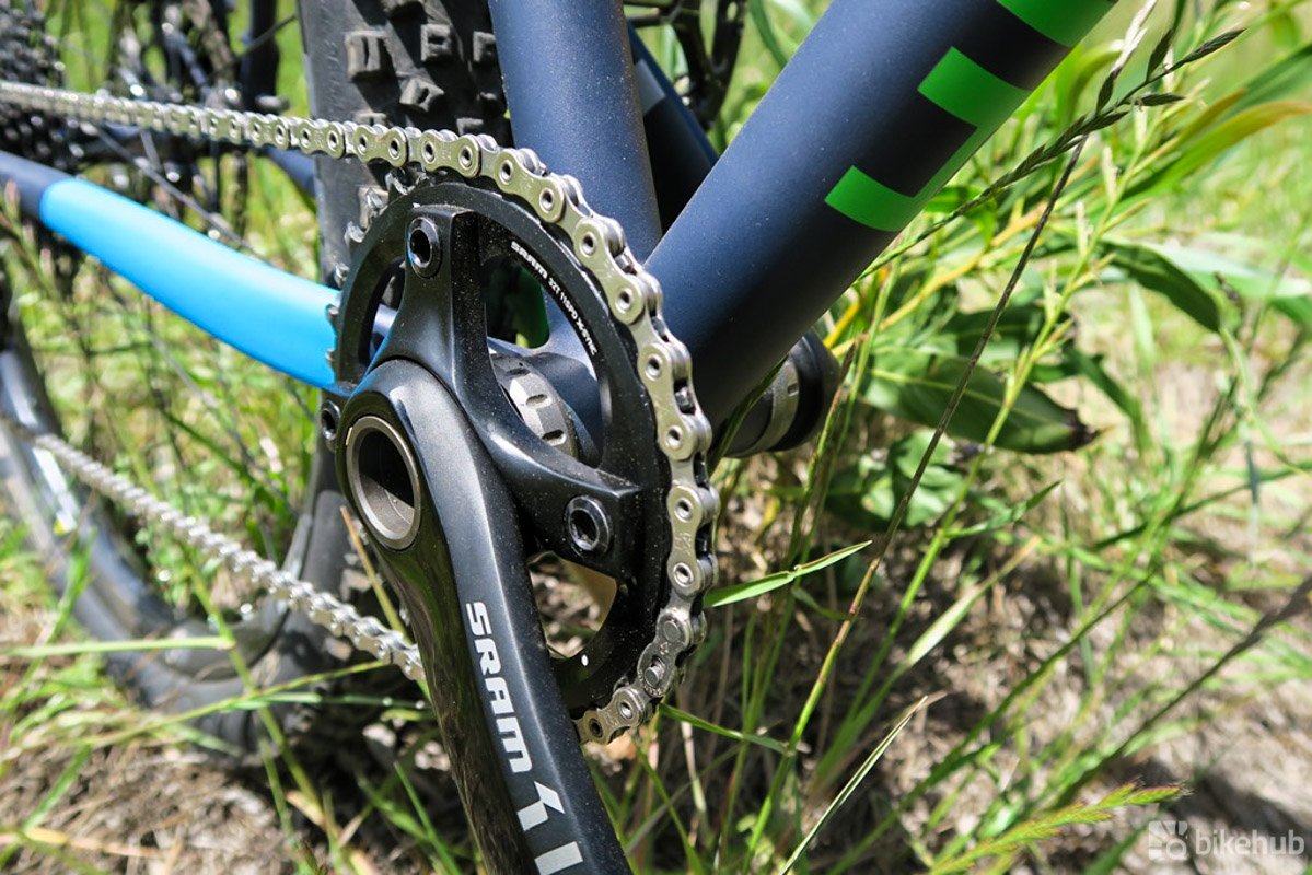

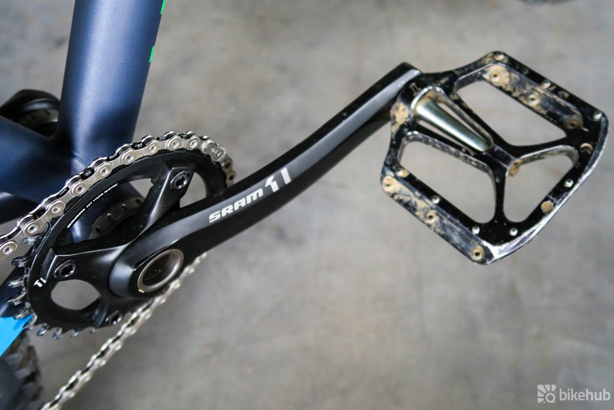

Drivetrain: SRAM X1
One word: faultless. I can add quite a few more words of praise, but let’s leave that for the full review coming up in the not too distant future.

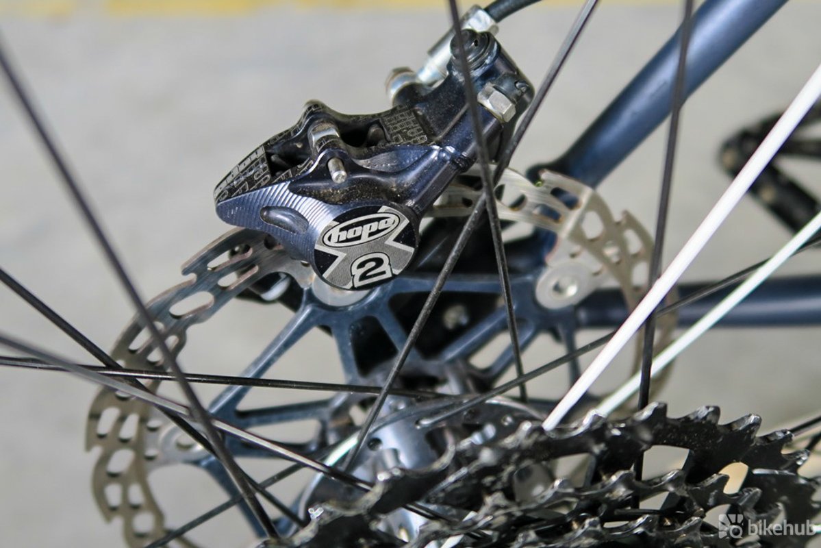

Brakes: Hope Stealth Tech Evo with 183mm floating rotors
Another piece of kit that has made it’s way to more than one build. They haven’t let me down once and to date no maintenance has been needed to keep them operating at their best.

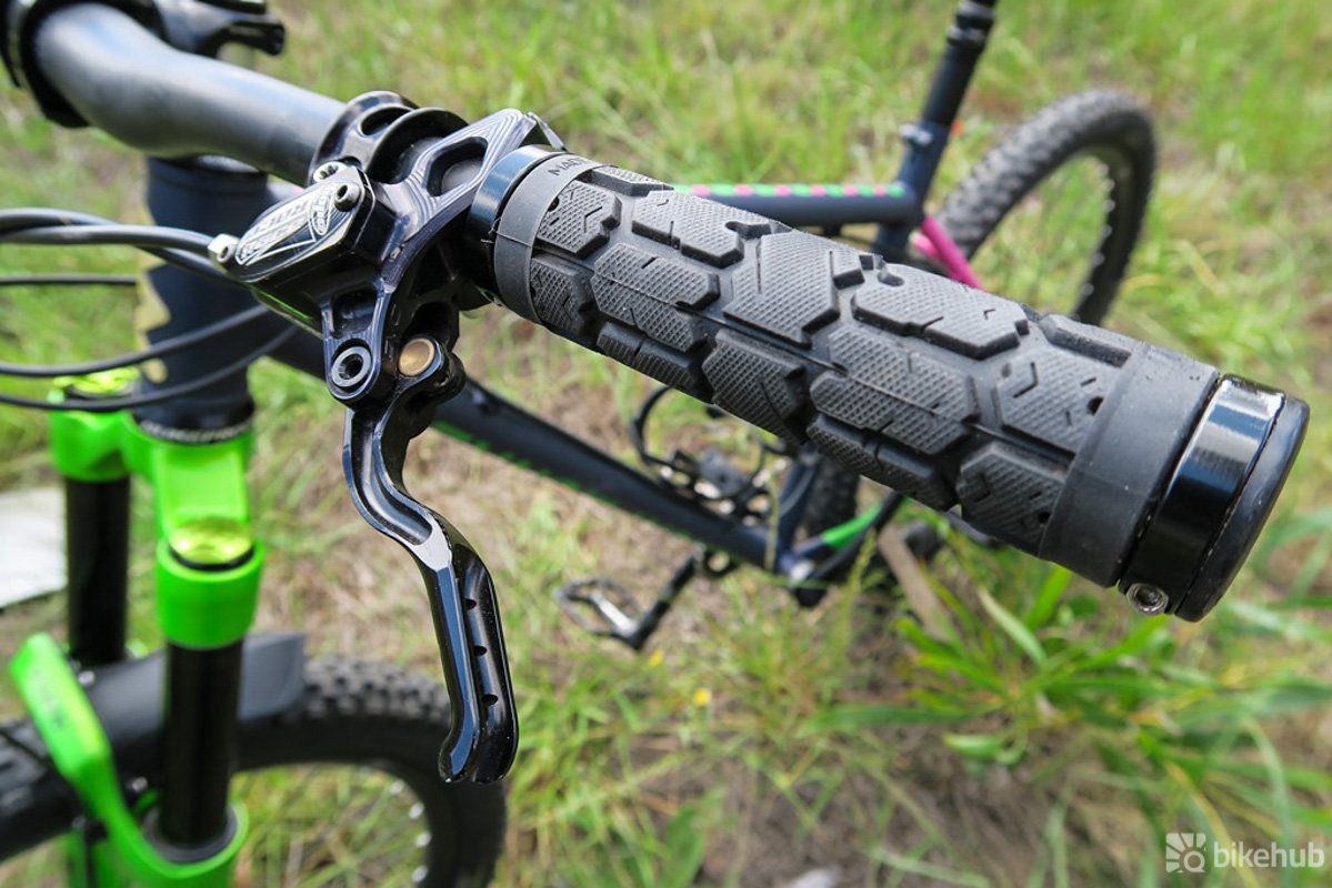

Grips: ODI Rogue
I have been a fan of ODI for a good couple of years. With colour, width and feel options to suit just about every rider regardless of discipline. The Rogues have been my grip of choice, as they provide an extra bit of give without being too soft or spongy. Plus, they perform well come rain or shine.

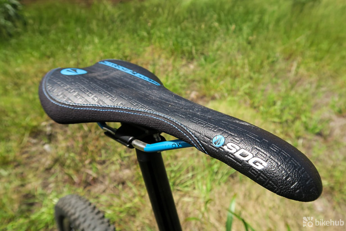

Saddle: SDG Circuit Mountain Ti-alloy saddle
I’ve tried many saddles of this nature and the SDG Circuit has proven to be the most comfortable on longer rides. Full review on it here.

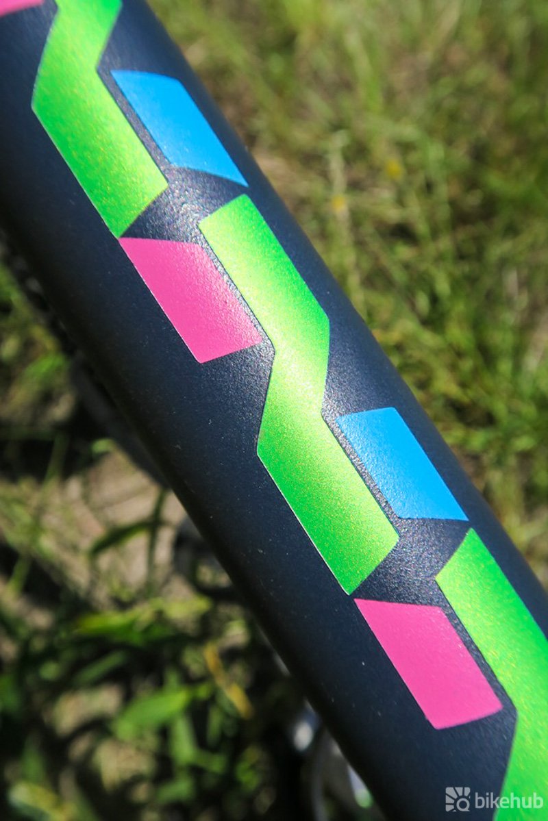

Special mention to Bogus Designs for the KILLER paint job.

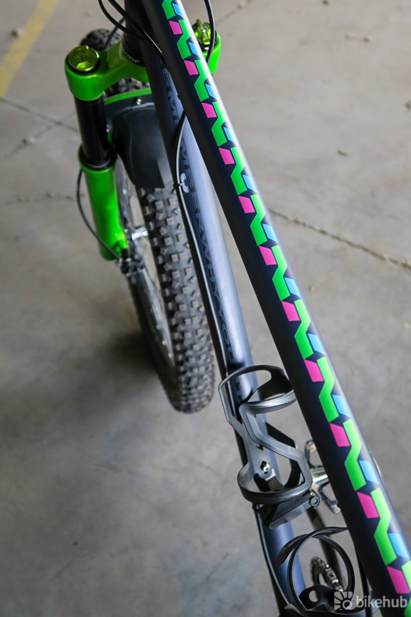

That Paint Job.
I would crash all the time from staring at the top tube!

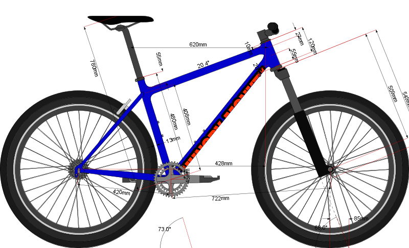

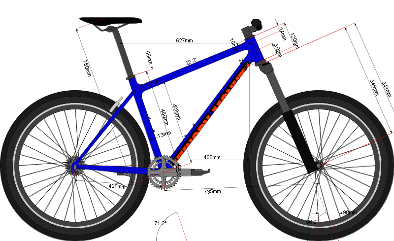

Awesome bike! Where is the geo and some more info? What size tyres can be fitted?
Iwan Kemp
Nov 17, 2015, 8:40 AM
Two pics with geo posted right at the top. Brand dependent, but 2.35 - 2.4 without issues. For more info on the frame have a read HERE
