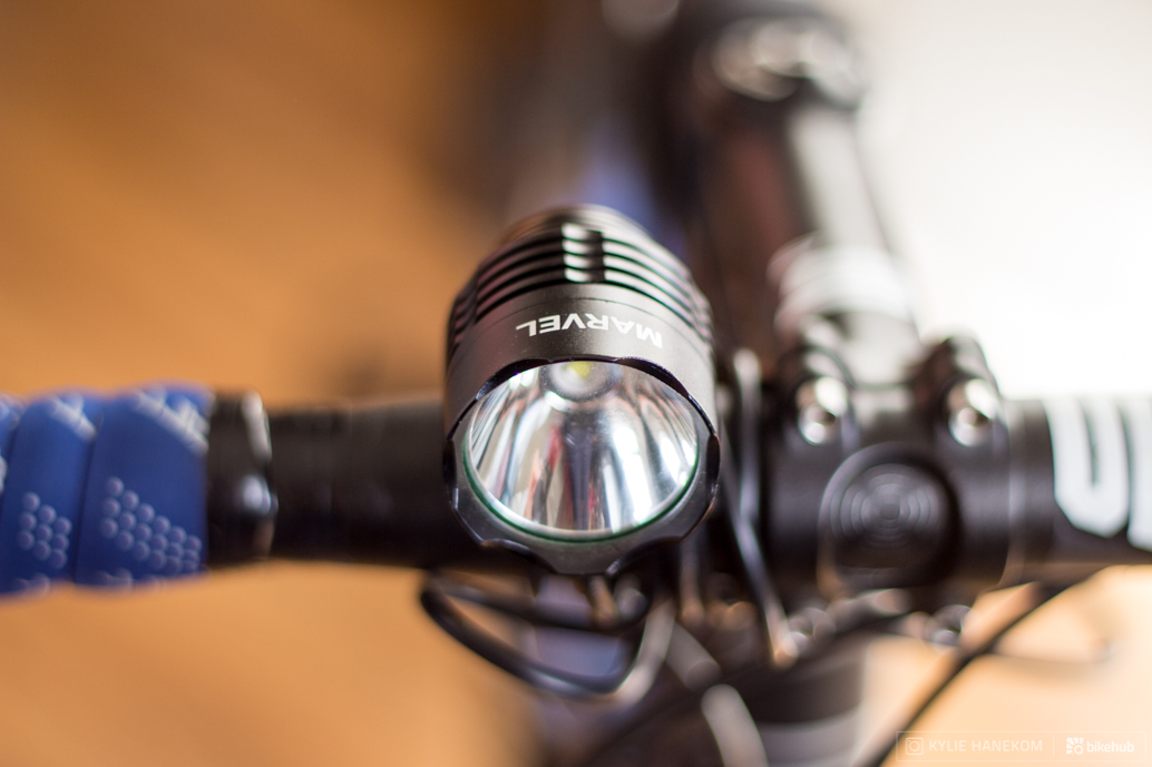

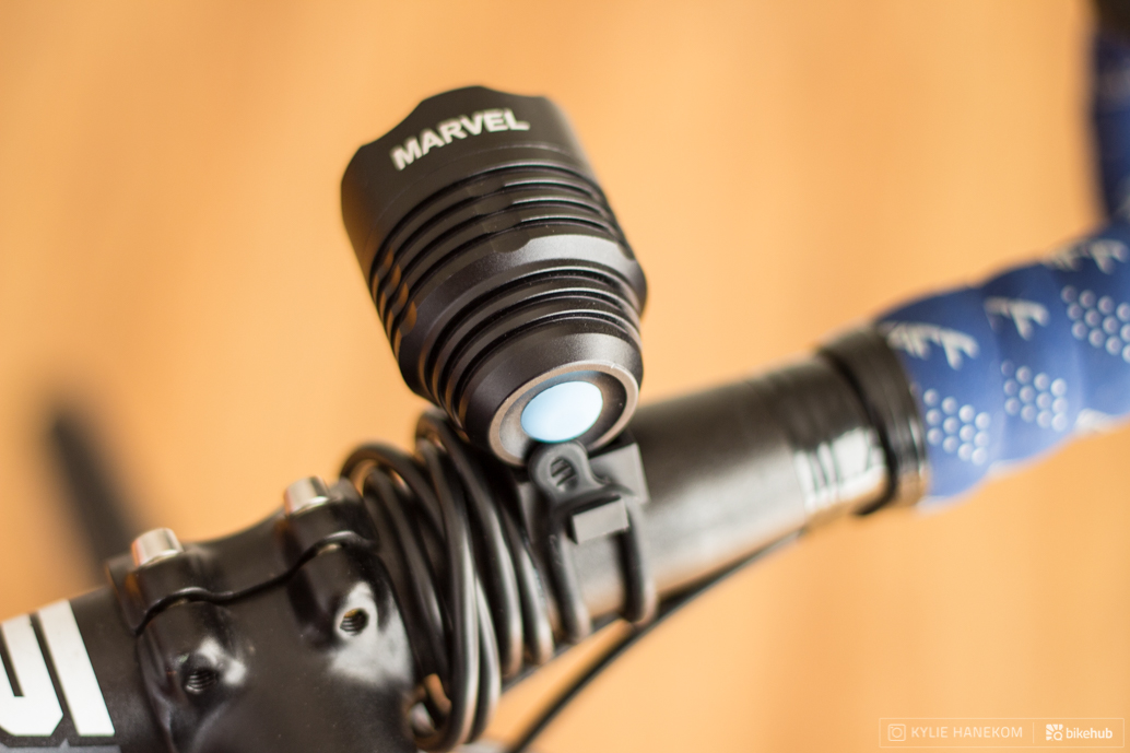

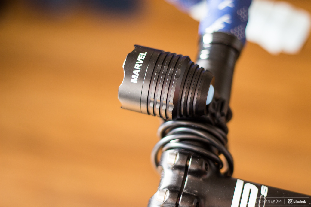

The Pro 900 can be mounted to the handlebars using the familiar o-ring system or attached to the included head bracket. The handlebar mount is stable and easily adjustable. The included head mount (which is similar to what most other brands also throw in) is a bit flimsy for my liking. I usually end up cutting the plastic mount away from the stretch fabric and using cable ties or velcro straps to fix the mount to my helmet.

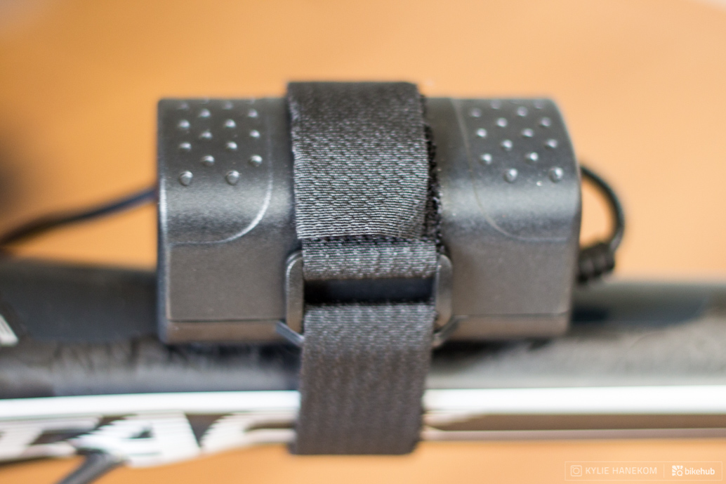

The battery pack has two soft pads on the underside to prevent scratching and improve the grip of the battery pack to the bike. The Marvel Pro 900 battery pack is held in place by a simple velcro strap. I found that the strap needed to be tightened thoroughly to effectively prevent the battery pack from sliding down my top tube, especially on off-road missions.

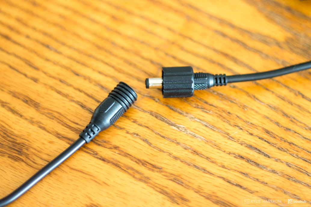

The cable connecting the light to the battery pack is very long for my preferred bar mounting position. Understandably, the length helps with mounting the light to a helmet where the battery would probably be in the riders back pocket. The solution was simply to wrap the cable around the handlebar.

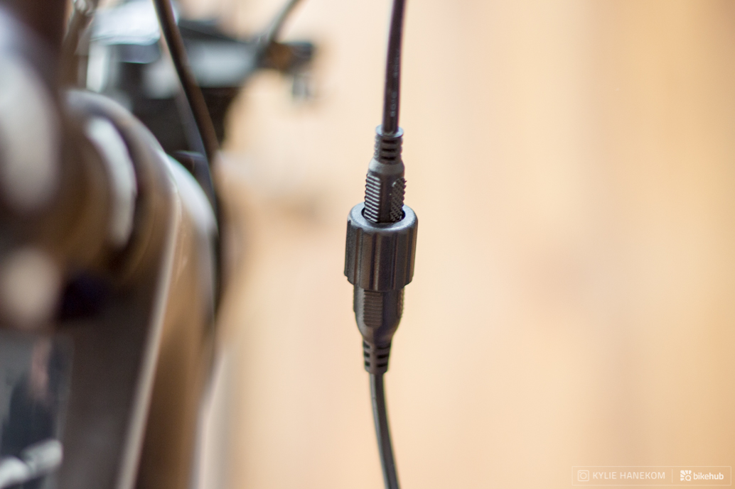

The connection on the cable screws securely into place which means that you’re unlikely to pull it out (which does happen on occasion with press in connections). But at the same time, it means that it will not easily disconnect should it get caught while riding. Although I can’t say this happened to me while testing, it’s worth weighing up the pros and cons here.

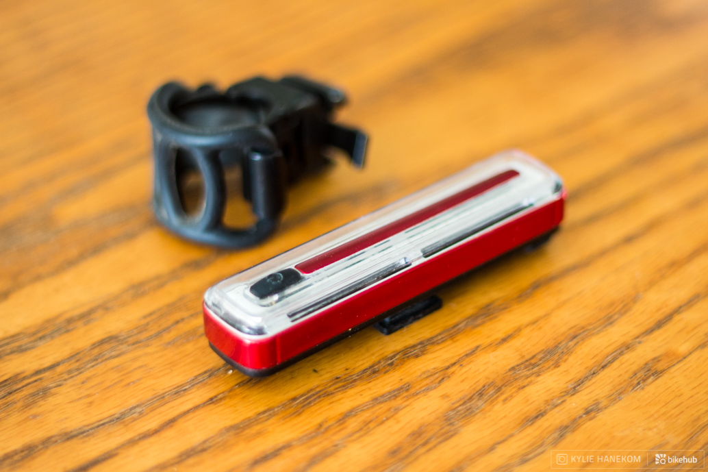

The Streak rear light mounted to the seatpost without fault. The rubber strap felt durable while the adjustable mount angle did not slip from the set position.

The beam has a noticeable spotlight effect in the centre. Straight ahead is perfectly visible but the weaker outer ring of light struggles to drown out shadows. This impacts vision around corners where you are looking outside of the forward spotlight.
On the road, while mounted on the handlebars, this was less of an issue but on twisty singletrack, you might consider mounting the Pro 900 on your helmet so that the beam follows your vision. For the price, you can probably make do but there are lights that provide much better peripheral vision, albeit at a slightly higher price. It is worth noting that Marvel also offers lights with a lot more power and LEDs in their range.
The Streak rear light is sufficiently powerful to be seen at night, even in rainy conditions. On test, the battery life was around 11 hours with use mostly in a flashing mode. There are four power levels allowing you to set it at just the right brightness for your (and motorists) needs.
