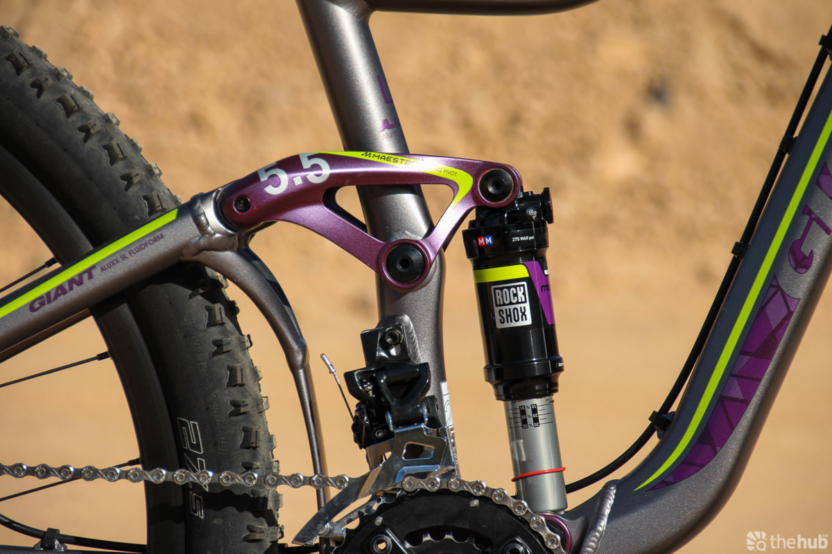

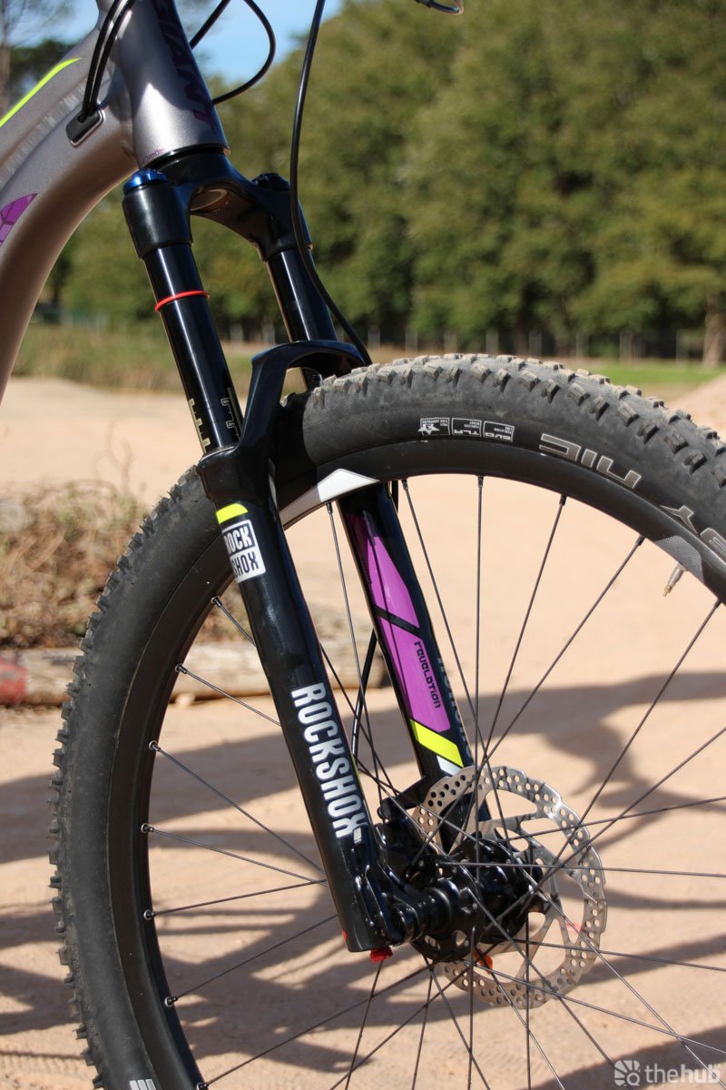

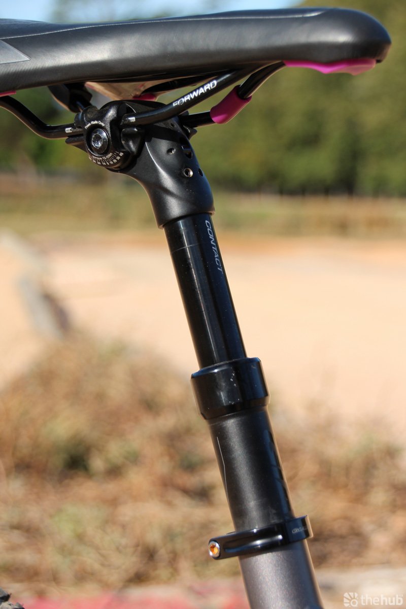

A closer look revealed some pretty fun suspension in the form of a Rockshox Revelation RL 120- 140mm dual position fork and the Monarch R shock on the back. The bike also comes standard with the Giant Contact Switch- R dropper seat post, and a dropper as standard is a huge plus in my view. 650b wheels complete the picture, a choice that is perfectly suited to this bike.

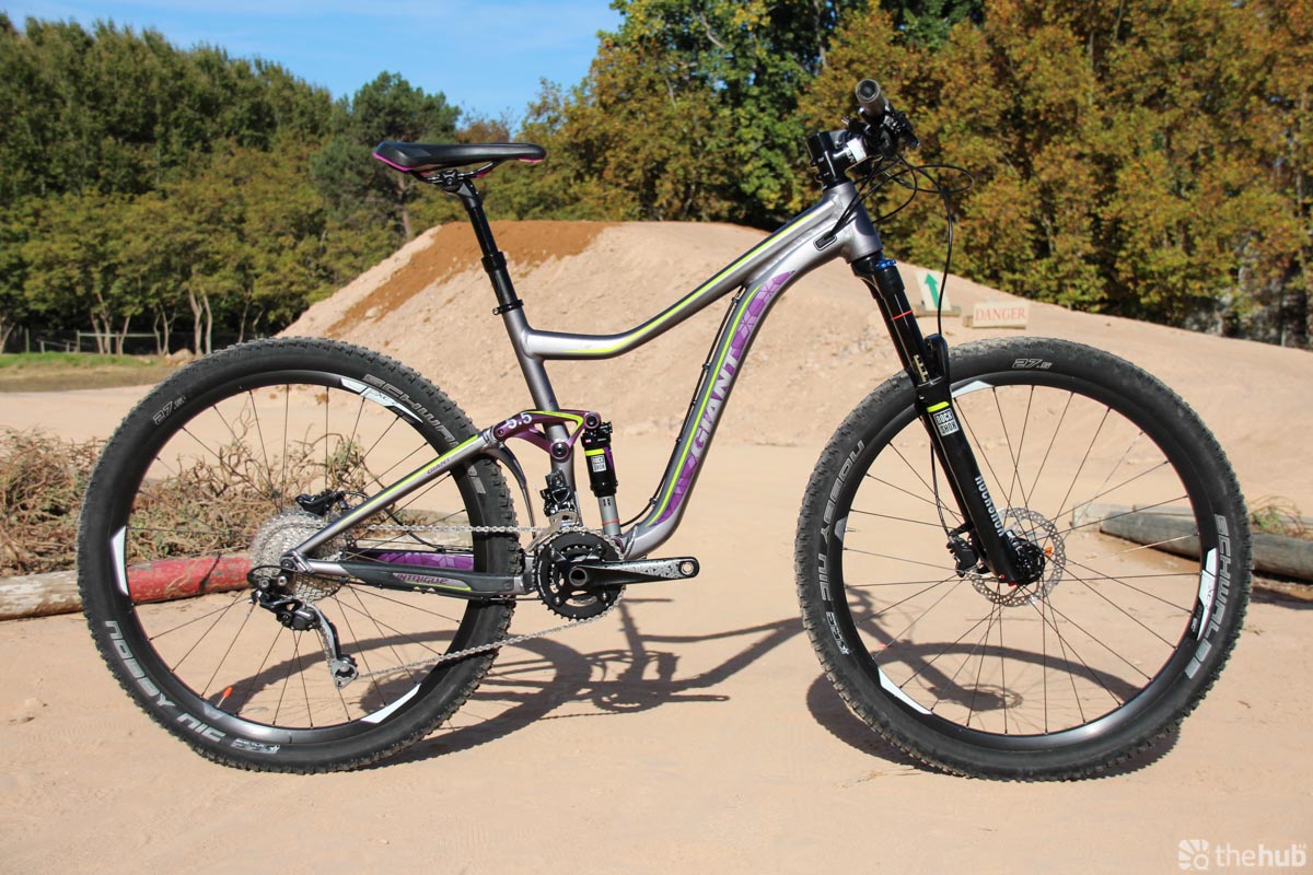

I took the bike to Welvanpas for the first ride. I was immediately impressed by the plushness of the suspension, and the stability of the bike. It should be noted that I currently ride a carbon hardtail and am not used to having squishy rear suspension to smooth away rocks and roots. On the other hand the bike did feel cumbersome initially since it is heavier than I am used to.
I was very keen to try the dual position fork. I started out by setting it to 120mm and locking it out for the long climb up “The Shuttle” to the trailhead. Unfortunately the rear shock on the Intrigue 2 does not come with a lockout, so there was noticeable bobbing at the back. This combined with the extra weight and my feeble legs, meant I was suffering by the time I reached the top of the first climb.
Once you turn the bike downhill, it comes into it’s own: the suspension chews up rocks, and keeps the rear wheel tracking firmly on even the most dusty, loose and rutted corners, and the heavy frame combined with the slack head angle provides a very solid, confidence-boosting ride. I felt like I could make any number of mistakes and the bike would still get me down the trail safely. In fact, I was unable to come unstuck, despite some pretty poor decision-making. It was deeply satisfying to hear my riding partner struggling to keep up with me on the descents for a change.
I grew very fond of the dual position fork during the course of the day’s riding, I found it very simple to use, and extremely helpful for navigating steeper climbs. I also tried the 120mm setting on some of the smooth, flowing descents on the black route trails, although I found I preferred using the full 140mm of travel as the bike felt smoother and more balanced.

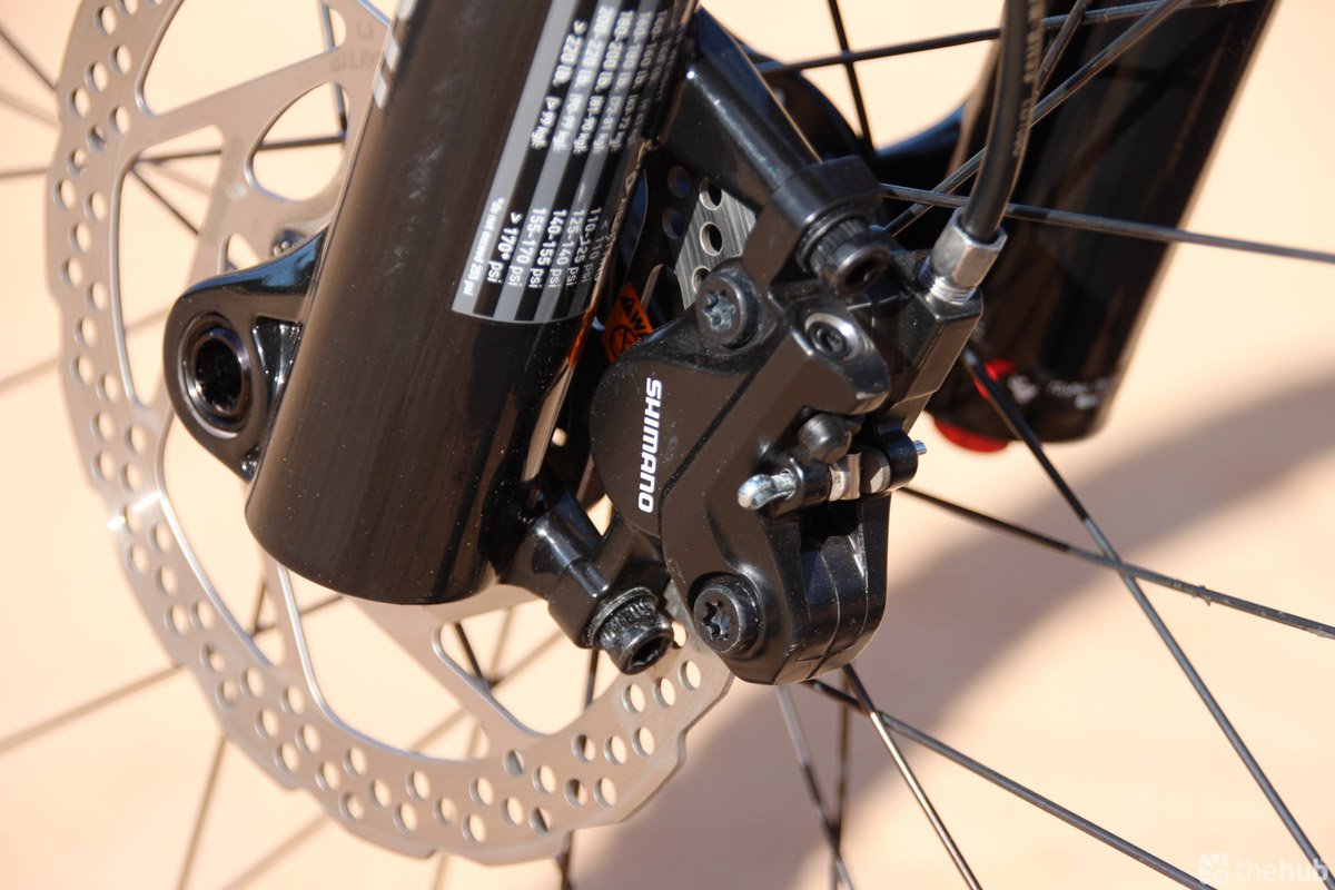

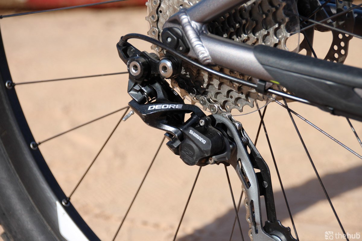

I was impressed with the performance of the drive train: the gears shifted reliably in very dusty conditions. The Shimano M395 brakes were the only feature that I felt really let the bike down. They did not have the responsiveness that I have gotten used to. I struggled to trust them, and felt slightly out of control throughout the ride. The low spec brakes don’t make sense on a bike that in all other respects is designed to be ridden aggressively.
The Shimano M395 brakes struggled to keep up with the rest of the bike.

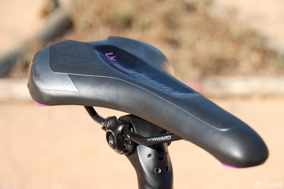

The fit and feel of the bike was good- the medium frame size was spot on for me, and the handling felt intuitive, and there were no points of discomfort even after 3 hours of riding. I found the women’s specific saddle to be very comfortable – it was just the right width and shape. I am told that the Liv Contact saddle can be bought off-the-shelf from Giant/ Liv dealers and retails for around R350.
A relief. The Liv Contact saddle was comfortable and compact.

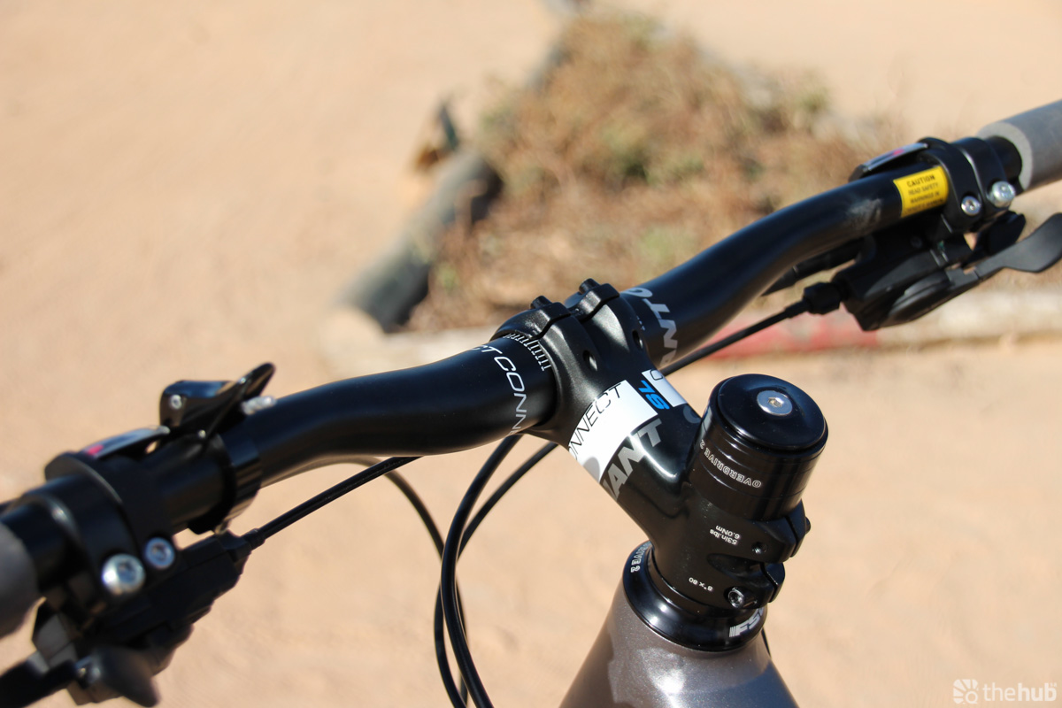

My personal preference would see slightly wider bars fitted to the bike. I also struggled with the position of the dropper post lever, which is situated some distance from the front shifter. I could not activate it without removing one hand from the bars completely, making it difficult to use in technical sections. The lever can however easily be moved to a more suitable position.

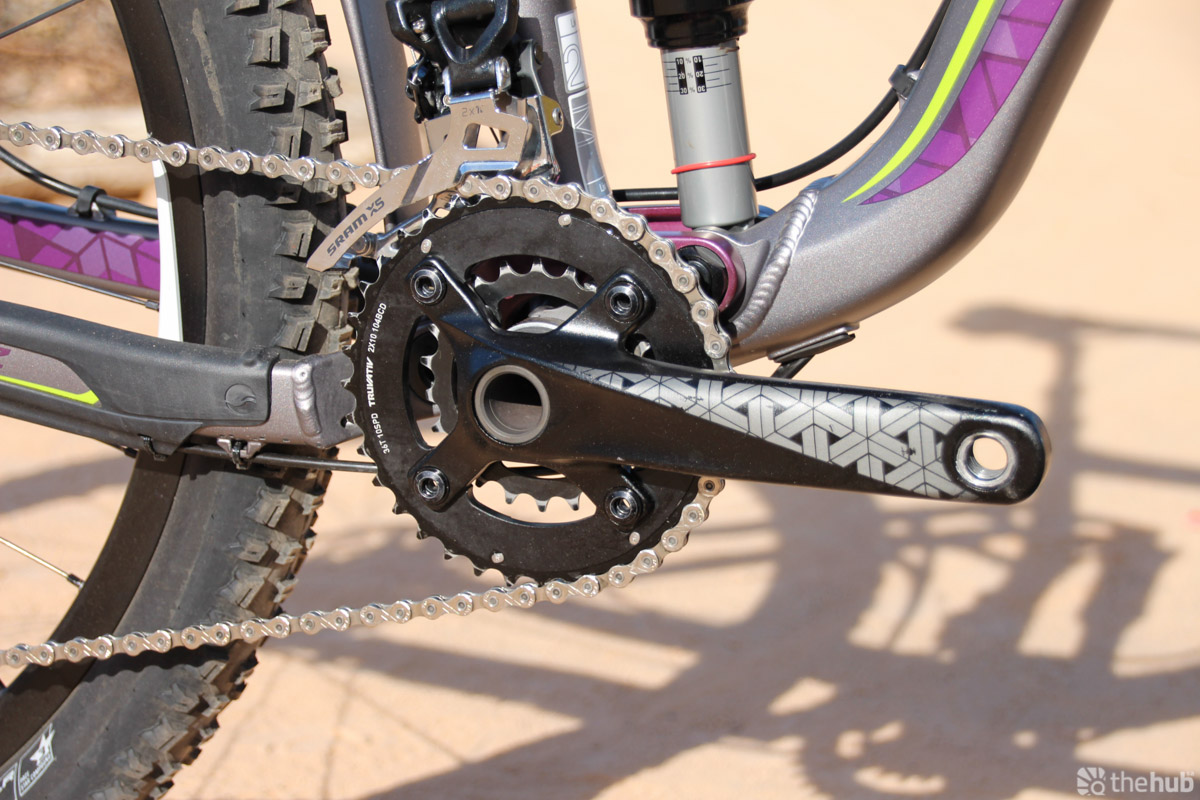

"This combined with the extra weight and my feeble legs, meant I was suffering by the time I reached the top of the first climb."
I noticed the considerable wear on the 22T chain-ring (compared to the 36T) before I even read the above line from your article.
