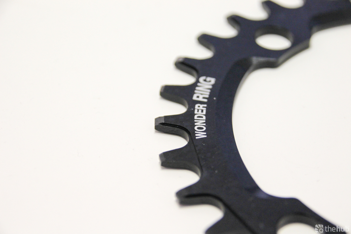

Kitted’s component range is South African made and focusses on the drivetrain with various narrow wide chainrings and a range extender available. On test is the Kitted Wonder Ring 32T 104BCD which is suitable for 1 x 9,10 or 11. The Wonder Ring features a narrow wide tooth profile which, if you’re not familiar with it, helps eliminate the need for a chain guide to keep the chain from falling off the ring.

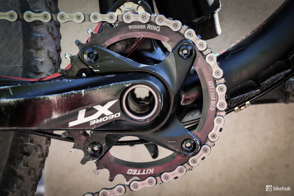

Originally running Shimano XT 2×10, the Wonder Ring was dropped in up front in place of the standard Shimano XT chainrings and a wider range Praxis 11-40 cassette popped on the rear to help with the climbs. A clutch equipped rear derailleur is usually recommended when running one-by and luckily my XT rear derailleur was already of the Shadow Plus variety.

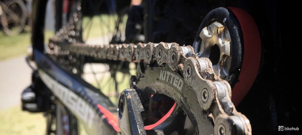

Over a few months of riding I’ve had no issues with the Kitted Wonder Ring. Although at first I was consciously observing the performance, it has become a bit of a ‘set and forget’ exercise. During the test period I’ve had zero chain related issues riding over all types of terrain, from bumpy, technical rocky trails to the variety of three days at Wines2Whales. Other than the adjustment in riding style due to the one-by range I’ve hardly noticed the Wonder Ring. Which for me is a great thing as it means it’s quietly doing it’s job without issue.

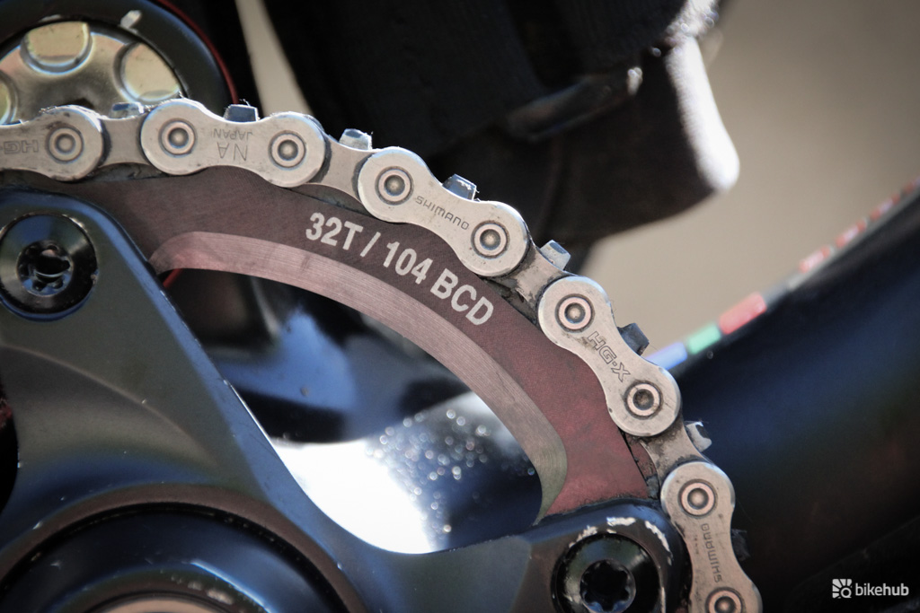

Noise wise I had initially encountered a bit of a grinding sound from the chain ring when in upper and lower gears with the clutch enabled (quite common on many narrow wide rings), but with the clutch disabled this dissapeared. More importantly since then I’ve been riding mostly with the clutch off with zero chain drops. While initially a very quiet setup when clean and lubed I did find things got noisy after a few hours of dirty riding, but much like any setup would and in this case it didn’t hamper performance.

Do all narrow wide rings make the grinding noise?
nope, but from experience, both Kitted and Kalbo when initially fitted and ridden until around 200km would make a noise.... Thereafter should be fine!

My first Kitted ring lasted over 3000km before it went onto a Build a bike. Onto my second and no issues. The noise I see mentioned can be chain related. On a Shimano SLX chain and a YBN chain (10s) no noise, but on a KMC 10s chain I had a kind of whirring noise for the first ride or 2, but now silent. (New chain and ring).

Ive noticed that the grinding noise is Not coming from the chain ring but rather the chain. Ive had an Absolute Black Oval chainring and a Kitted chainring and on both the chain made the grinding noise. You need to add, or remover spacers between the chain ring and your crank at the front, so that it can line up with the centre gear on you rear cassette. The grinding noise is a result from the chain having too much horizontal or side ways movement. Just line it up properly and the problem should be solved.
