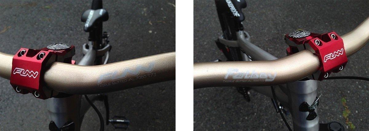

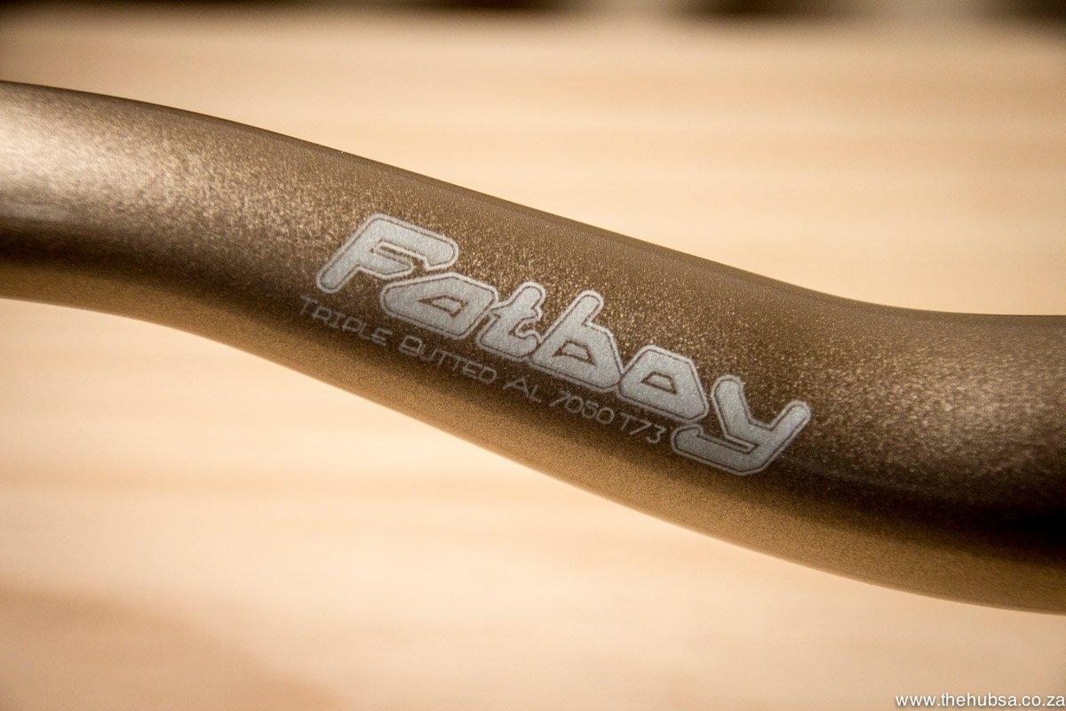

Possibly the most striking thing about the Fatboy bars, even more so than the colour, is the bead blast finish for the centre of the bars and the mirror polish finish for the outer parts. It’s beautifully executed and the only place where it wore away a bit was under the clamps of the brakes, shifter and lock-on grips.
The centre graphics made centring the bars easy. Once set it was also easy to get a feel of how far forward or back you wanted the bars to sit. I set them a little more forward than centre and if I tried something different, I always came back to that position – it just seemed the most natural.
And that was a continuous feeling I got from the Fatboys. From the get go they immediately felt more comfortable than my Nukeproof Warhead bars. While you could feel how the 760mm Nukeproofs would be a bit wide, the FUNNs sat so naturally in your hands that I never once wanted to cut them down. The 5.5º degree upsweep and 8º backsweep were near perfect for me.

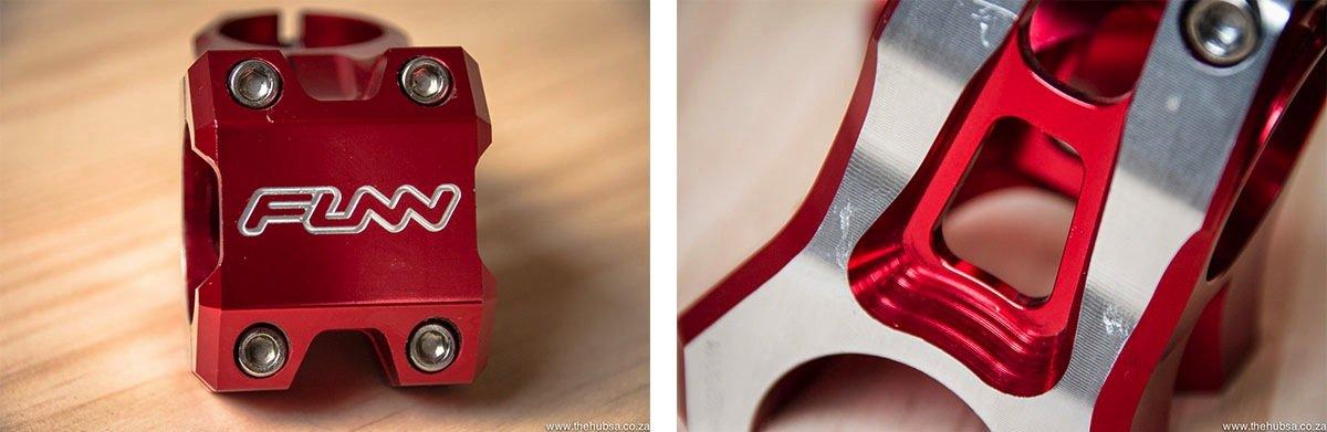

Initial impressions: FUNN Strippa stem

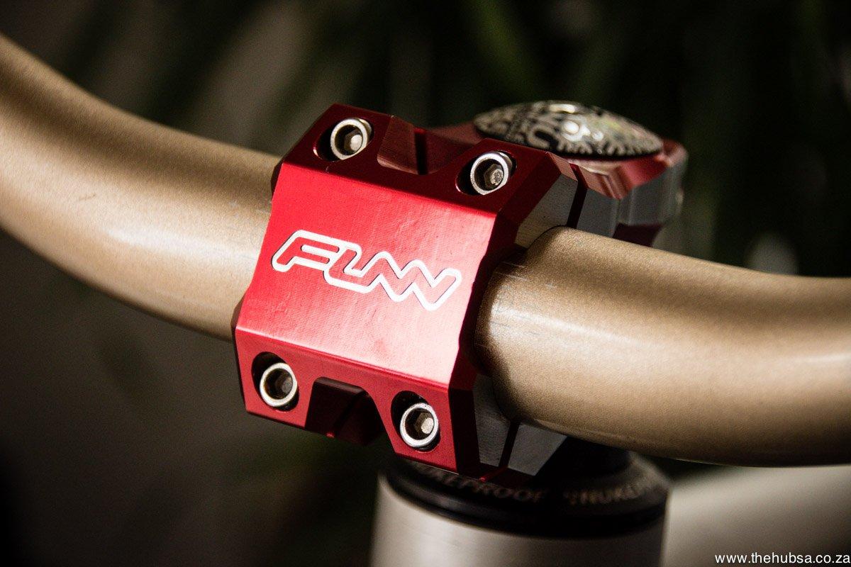

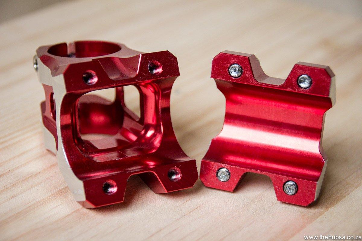

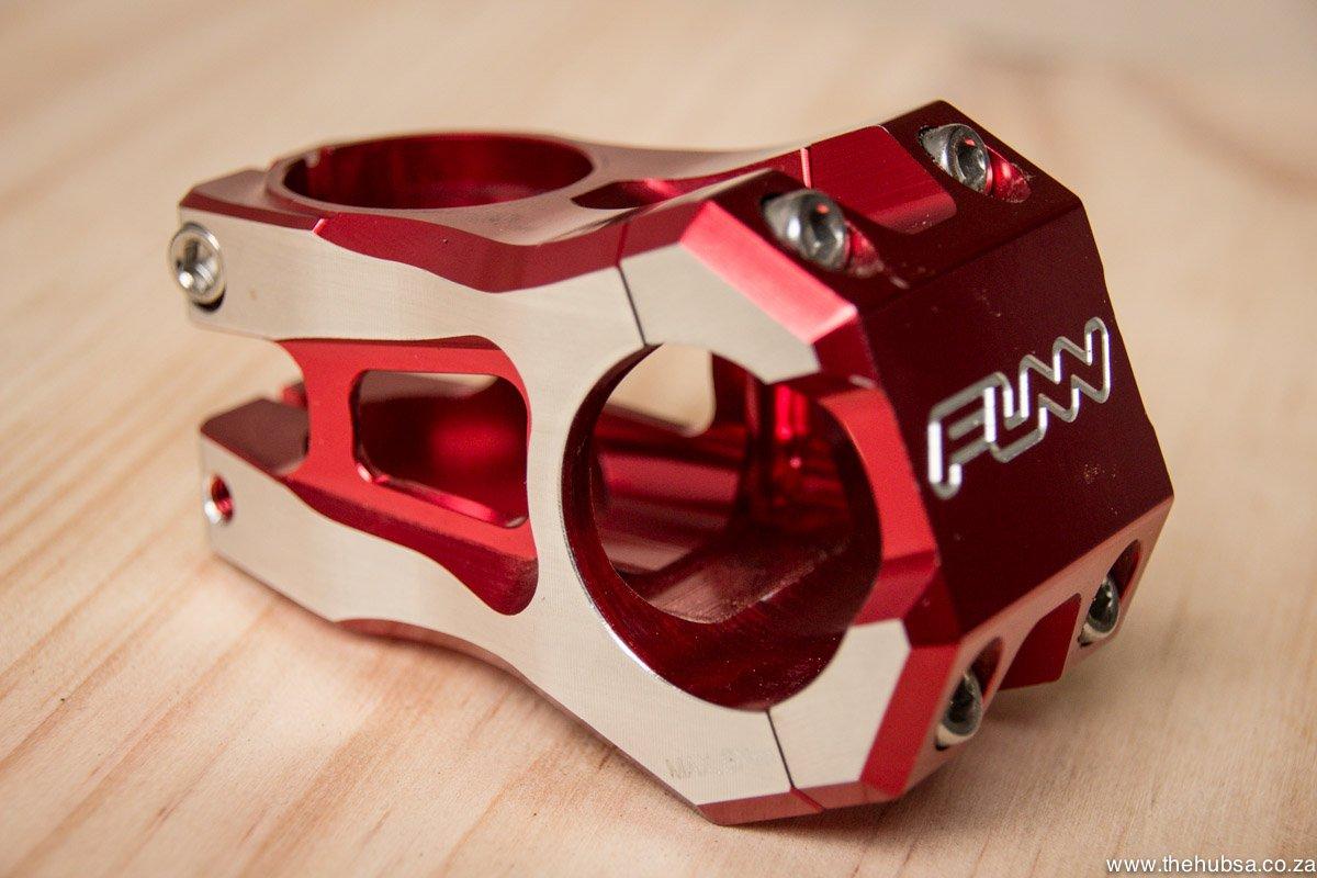

The Strippa’s two-toned red and polished look is clean and stylish but has serious purpose to it. Its full CNC construction is clean and makes for a strong yet relatively light stem at 173g. I did like the shape of the Strippa, the fact that it wasn’t a plain block, but tapered vertically to accommodate the bigger 31.8 diameter clamp and horizontally to increase the wide clamp for increased distribution on the bars. It doesn’t clamp vertically either, like most stems, but is around a 45º angle which is supposed to reduce the pressure placed on the bolts and displace forces better around the rest of the stem.
It’s full of little details, like the clean CNC lines, the beveled edges and the lips protruding a couple of millimetres from the split steering clamp. In fact, almost all the edges have at least a slight bevelling to them, so nothing is sharp to touch. It’s great to see right through to the steering tube, and even right through to the other side. The braces connecting the split steering clamps are a nice touch and the weight saving’s method of cutting away unneeded material lends a bit of a scaffolding look to it. Everything about this stem shouts purpose, even down to the decals deeply engraved into the front and the lightly engraved max torque indicators. The Strippa only comes in a 45mm length but is available in a choice of red, blue, orange, solid black or silver.
Bolted on

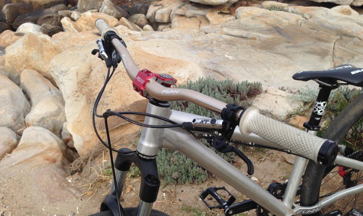

OK, yes the combination of the ‘Cappuccino’ Fatboy bar and the red Strippa stem was a bit gawdy. It literally grabbed at attention but neither of them looked cheap and when something is as flashy as these items and can still look the part then you know they look good.
Not only that, but the Strippa stem felt great too. It was solid, damn solid, and connected up to the Fatboy the increased responsiveness it gave was immediately noticeable. Where other stems would flex from the leverage forces placed on them from wide bars, the Strippa was unfazed. It is a downhill /freeride spec stem after all, and this is what you would expect from it.
