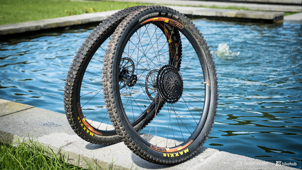

The cSixx XCM 9series 29″ wheelset weighs in at a scant 1,650g as supplied with the XD driver freehub body, tubeless tape, and valves. The wheelset features a 430g rim with a 26 mm internal diameter and the option of 28 or 32 holes. These wheels were designed and tested for riders who are smashing trails during the week and doing stage races on the weekend.

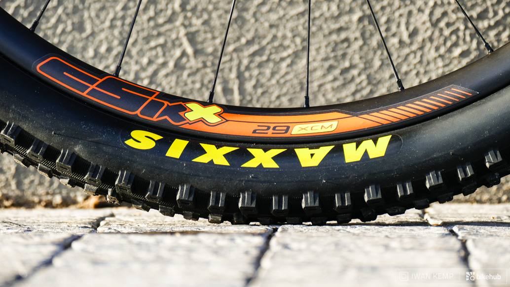

cSixx XCM 9Series Rim
  • Rim typeDeep asymmetric profiled, hookless carbon rim
  • Internal diameter26mm
  • BeadHookless
  • Wall thickness3.5 mm
  • Hole count28h or 32h
  • Depth25 mm
  • Asymmetric profileFront: long side to disc; Rear: long side to drive
  • Weight430 g
  • ERD579 mm
  • Offset3 mm spoke hole offset

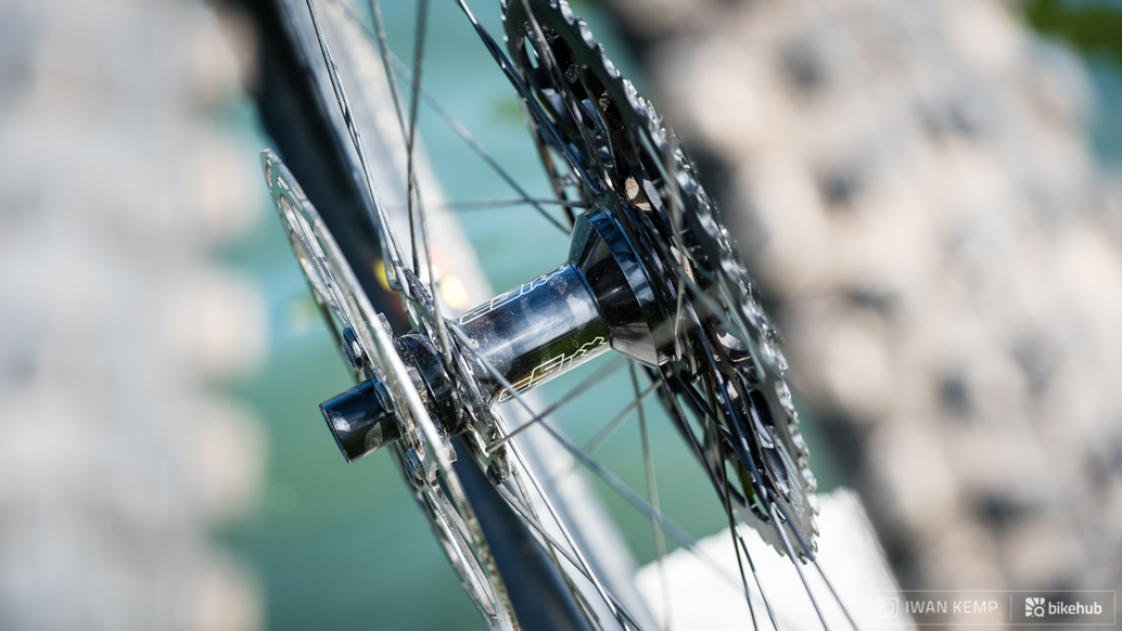

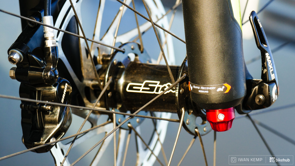

cSixx Rear Hub
  • Engagement3 Pawls with 30 points of engagement, 12° engagement angle
  • FlangesAngled for better spoke angles
  • Widths142mm or 148mm widths
  • Holes28 hole
  • Disc mount6-bolt
  • BodyAluminium with 6902 Bearings
  • Freehub bodySRAM XD or Shimano 10/11Speed
  • Weight274g (142mmx12mm)

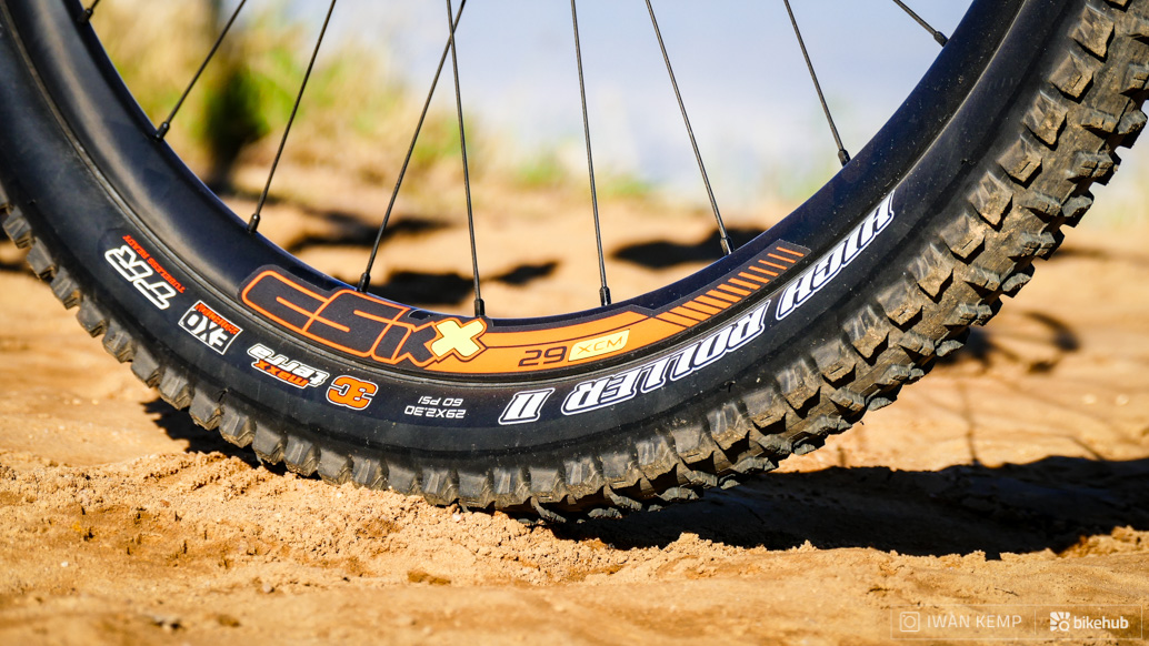

On the Trail
The cSixx XCM 9series wheels have been fitted to a Momsen VIPA Trail, a 120mm 29er trail bike. My use leans towards the trail riding side of things and (much) less so marathon – evident in my choice of tyres with a Maxxis High Roller in front and Maxxis Aggressor out back, both measuring a healthy 2.3″.
On technical climbs that weave through trees and around switchbacks, the slowish engagement of the rear hub is noticeable. Although not as slow as an American Classic hub, it is slower than Hope’s Pro4 and quite a bit behind Industry Nine’s Torch hubs, although those will set you back a pretty penny. If this is something that might bother you, cSixx, fortunately, offer the Pro4 hubs as an option on the custom built wheelsets.
Get the wheels up to speed though and there is not much telling them apart from their rivals. The cSixx XCM 9series wheelset spins up fast and holds momentum well. Lean on them hard through berms and corners and there won’t be any signs of strain or flex.
I tested an aluminium wheelset with the exact same internal width, but weighing in about 100 grams more, to get a feel for carbon versus aluminium . It was immediately evident how much more wheel deflection there was through rough terrain on the aluminium wheels with the carbon cSixx wheels doing a great job staying on course without being too harsh or unnecessarily stiff. Stiff yet compliant, one could say.
I found the width of the rim to be good – wide enough to offer extra traction and grip, but not too wide so as to square off tyres. Consider that not too long ago Stans’s Flow EX rim (built for freeride, all mountain, and downhill riding) measured 25.5mm internally and you will soon realise that 26mm on a marathon / trail wheel is plenty wide.
