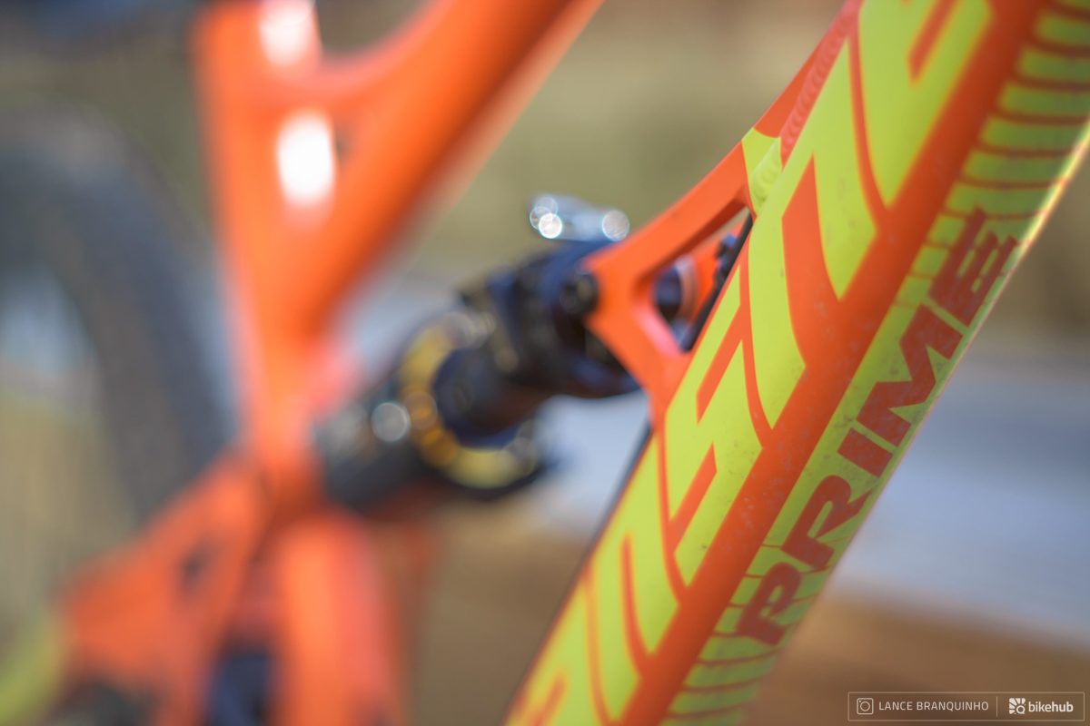

Although the defining feature of Banshee’s Prime is inarguably its KS-link suspension, most observers would comment on the oddity of a ‘new’ aluminium frame in 2017. It’s true, we have all become followers of the string-and-glue cult that is carbon-fibre, but if you are going to be rushing rock gardens and risking an ‘off’, aluminium’s ability to absorb impacts with greater resistance to a single strike critical failure, is not to be discounted.
It’s a disarming attractive frame with strengthening arches between top- and seat tube and above the bottom bracket. If you have a thing for quality metal fabrication and industrial design shaping for the sake of function, instead of fashionable form – you’ll be taken by the Prime’s presence.

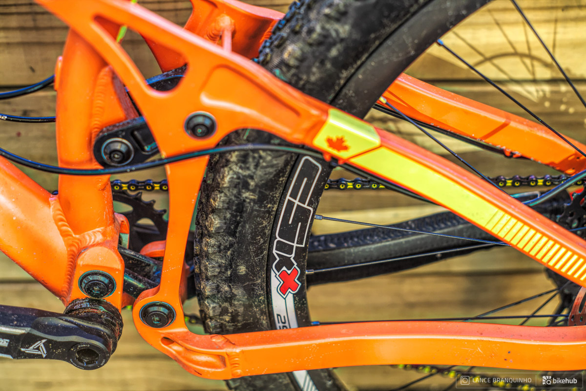

The linkages are cleverly designed and aligned too and its Banshee’s suspension engineering which is a significant part of its boutique brand appeal. Scotsman Keith Scott (no, really, we’re not making it up), is Banshee’s kinematics guy and with a master’s degree in mechanical engineering and experience at Rolls-Royce aerospace, he understands a bit more than most about making your bike’s wheels track the trail, even when the trail is trying to OTB you into every possible feature.

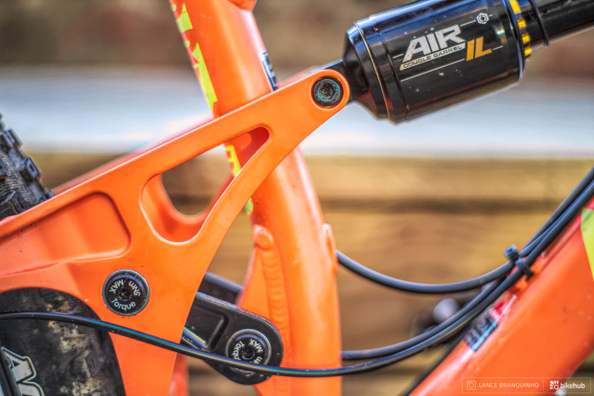

Scott’s suspension design is called KS-link and it functions on the principle of separating front and rear axle forces by connecting the two-triangles which combine for a Prime frame, with two short links. Most bikes feature a chainstay which pivots on the front-triangle, but a few brands add links instead. The idea here is that you decouple pedalling forces (less climbing bob) and improve rear suspension action during braking. A debit is that you have additional bearings and linkages requiring maintenance – but for those who ride bikes which feature a lower link keeping the frame together, there’s often no going back.

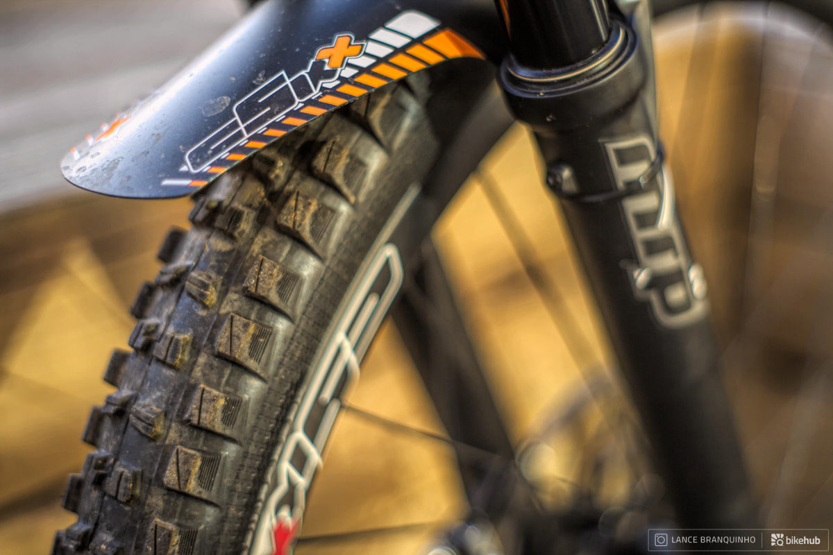

The most sensible South African Prime build could best be classed as Cape ‘Duro, with cSixx XCM rims (25mm internal with frame colour matching decals), an unusual e*thirteen TRSR 2.35 up front and Maxxis Aggressor 2.3 rear, 30-tooth Raceface chainring driving Turbine cranks, with cadence transferring into XT trail pedals. The helm pays homage to Mercedes-Benz roadster tradition, it’s a two-spoke steering wheel – a contemporary interpretation of the original 300 SL.

There is one other 135mm 29er available in South Africa, but it’s carbon, which means the Prime is quite a unique offering. Banshee prides itself on the suspension function of its bikes and with a 160mm MRP Ribbon and Cane Creek Double Barrell Air Inline CS (most elaborately named shock on sale), it’s extraordinarily comfortable traveling over rock strewn technical terrain at speed.
The Cane Creek is hugely adjustable and if you have the discipline to configure it properly (testing settings and noting them, instead of just fiddling haphazardly with the four parameters of tune: LSC, HSC, LSR, HSR), Banshee’s KS-link suspension delivers the paradoxical – perfect ‘pop’ off launches and an innate aptitude to smooth even the worst moonscape of trail braking bumps.
