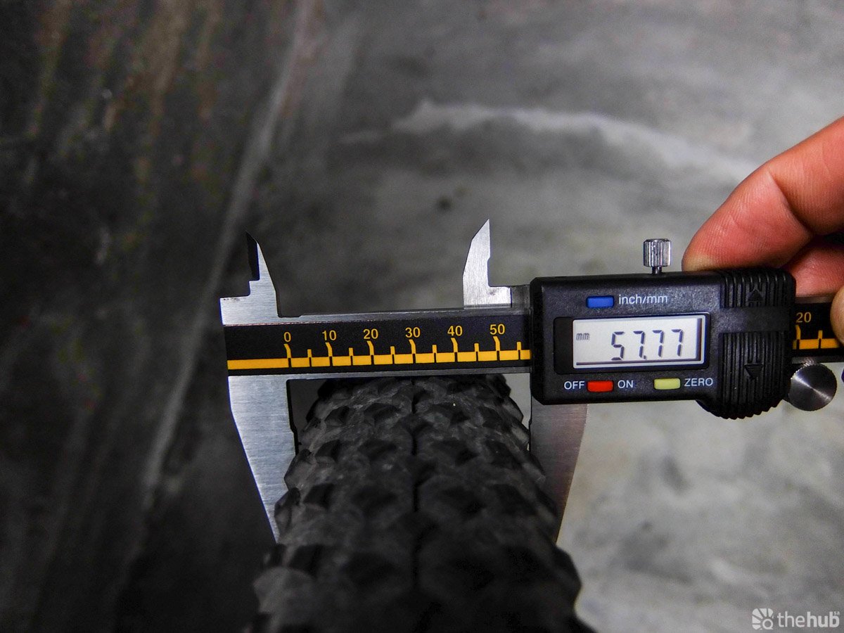

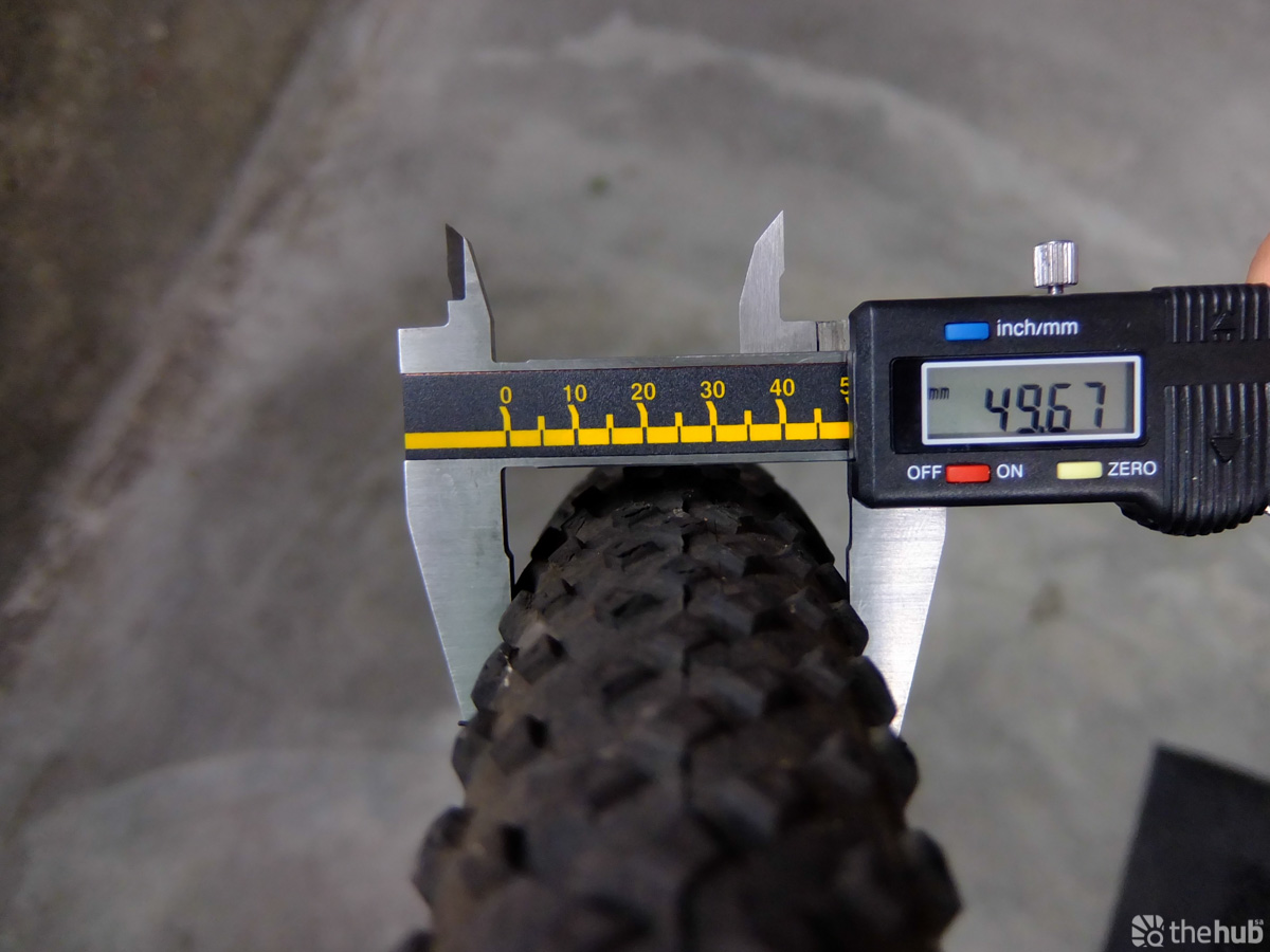

ccs-62657-0-57483400-1431091402.jpgMomsen Mount Graham 29×2.20″ tyre mounted on an Alex Rim DH19 rim.
ccs-62657-0-43818300-1431091397.jpgMomsen Mount Graham 29×2.20″ tyre mounted on a Wide Lightning.
By gaining traction and grip through a wider rim a rider would not necessarily have to run a bigger or gripper tyre, meaning a lighter tyre can be used.
As an example: You’re riding Schwalbe Racing Ralphs, but find them a bit skiddish in front. Usually you would look at fitting a Rocket Ron or maybe a Nobby Nic to get the grip and confidence you’re looking for or you would run a wider tyre in front. By running wider rims this wouldn’t necessarily be needed.

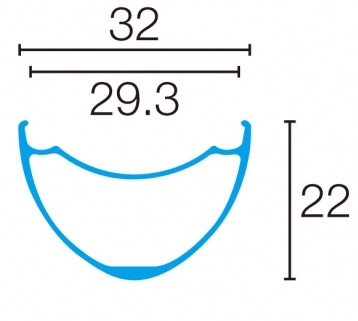

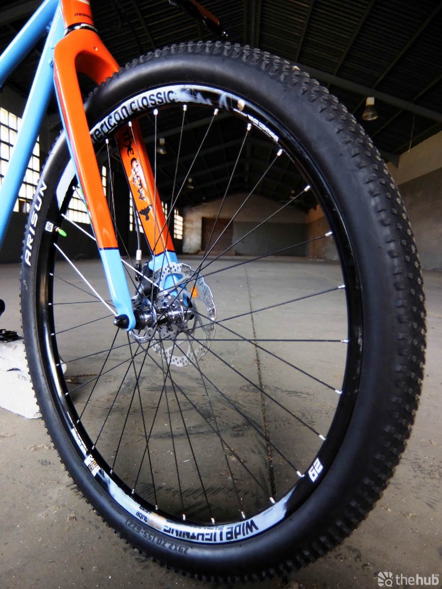

ccs-62657-0-15444000-1431091039.jpgThe Wide Lightnings feature a 29.3mm internal width and a 32mm external width.
I recently spent time on the Momsen Mount Graham tyres for a review. After about 3 months of use, I started toying with the idea using a grippier front tyre instead. While I was looking around at some options, I changed my wheelset to American Classic’s Wide Lightning and decided to move the front and rear tyres across to get an idea of the effect of the wider rim. For reference, the Wide Lightning measures 29.3mm internal and 32mm external vs the AMC MTB 29 Tubeless which is 21mm internal and 26 external.
What a difference those 8.3 internal millimetres make. For starters, I could run even lower pressures than I usually do for extra grip and traction and not sacrifice confidence caused by the tyre rolling on it’s carcass. Secondly the extra width of the rim gives the tyre tread a less rounded profile with less of a drop-off on the sides, giving the tyre a bigger contact patch. This makes the transition from the centre to the side knobs more predictable and further boosting confidence. On the Wide Lightnings, the Mount Grahams proved themselves capable of trail riding with ease and reached it’s limits much later.

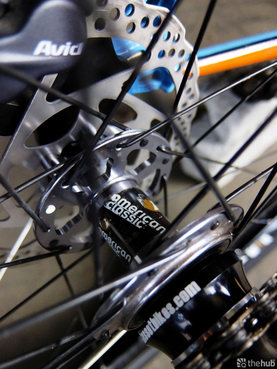

ccs-62657-0-14727400-1431091417.jpgThe American Classic Wide Lightning rear hub setup for single speed gearing.

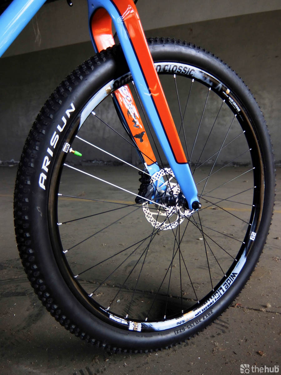

Keen to see what the effect would be on a more trail orientated tyre, I swapped the front tyre for a Vee Crown F. I usually run somewhere between 20-23PSI front and 25-28PSI. Again I could pump it up with 5PSI less than usual when mounted to the Wide Lightnings.
My only complaint would be the slow engagement of the rear hubs. By no means terrible, just not in tune with modern offerings and definitely something that takes getting used to. Even more so when there’s an Industry Nine hub on my other bike. Pedaling up technical single track takes some careful planning and requires consistent pedaling – something that’s not always possible on tricky sections. Once up to speed though, there are no complaints.
