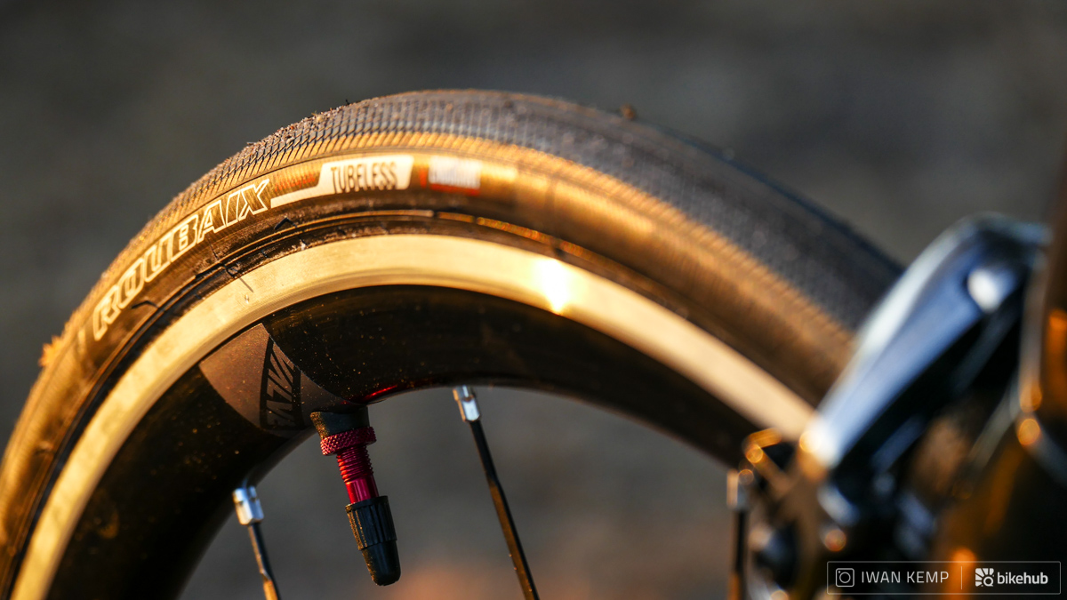

The Argent wheels were originally fitted with Specialized’s 700×23/25c Roubaix Tubeless tyres that allowed me to run them at the maximum allowed pressure without sacrificing comfort, thanks to the wider profile. The Roubaix later made way for a set of Bontrager R3 TLR 700×24 tubeless ready tyres, for no reason other than wanting to try out another tubeless set of tyres. Although I have not suffered a single puncture since April. It has been noticeable how longer the Bontrager tyres stay inflated, needing fewer air top-ups to keep them at an optimum running pressure.

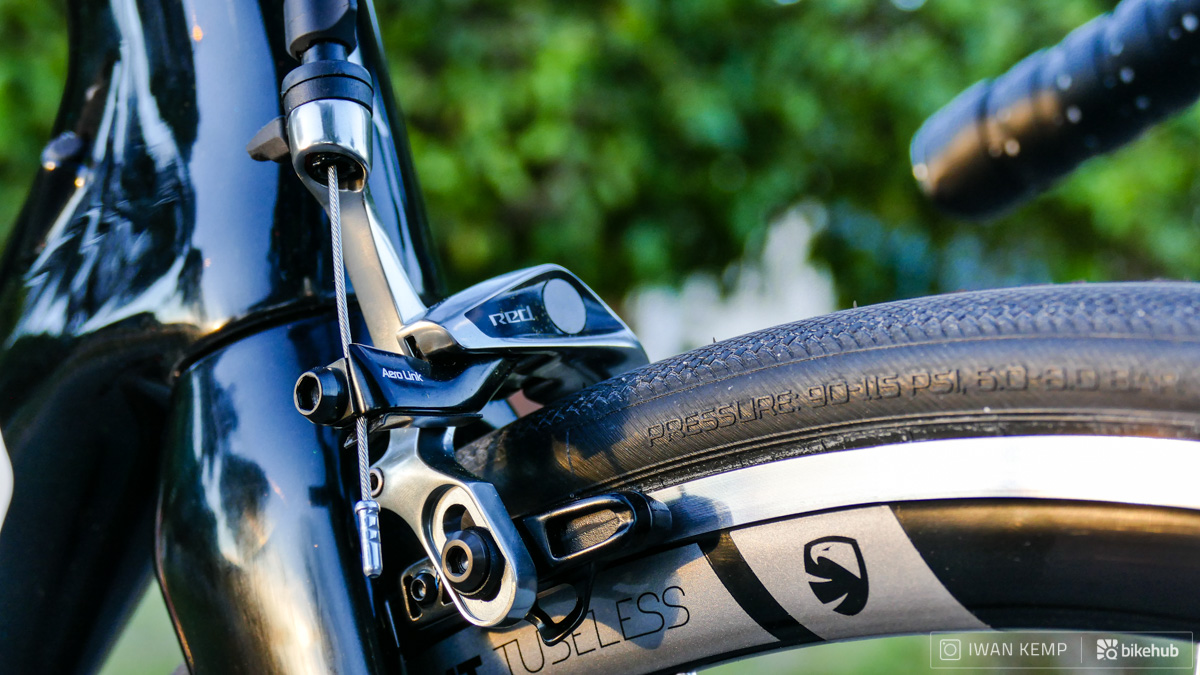

The cam-actuated, six-pawl freehub makes a satisfying noise while coasting and yields good engagement compared to higher-end offerings from some other manufacturers. Jump on the pedals and they surge forward and maintain momentum well. Running the brake blocks right up against the wheel shows some flex under heavy load, although it is more evident through the rub rather than feeling flexible under foot. Descending a pass at speed shows no sign of strain both in terms of flex and its ability to hold momentum well and, paired with the grippy tyres, make for a very fun and rewarding ride.
