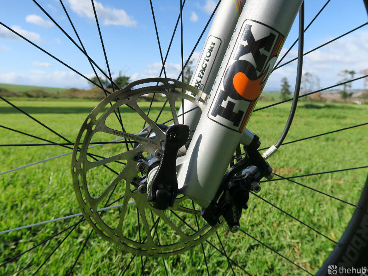

The Fox 34 received a complete redesign from the inside out for 2016. The result: a fairly drastic reduction in weight and a much-needed performance boost. The improved ability of the Fox 34 was long overdue as Fox’s main competitors have had the edge in performance for a few years now.

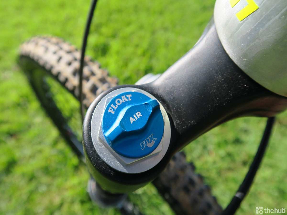

  • New self-equalizing positive/negative air spring
  • Utilizes patented Float shock transfer port technology, first introduced in their circa 1999 Float shock
  • Smoother performance with reduced friction
  • Less vibration feedback through handlebar (thanks to the negative coil spring being replaced by an air version)

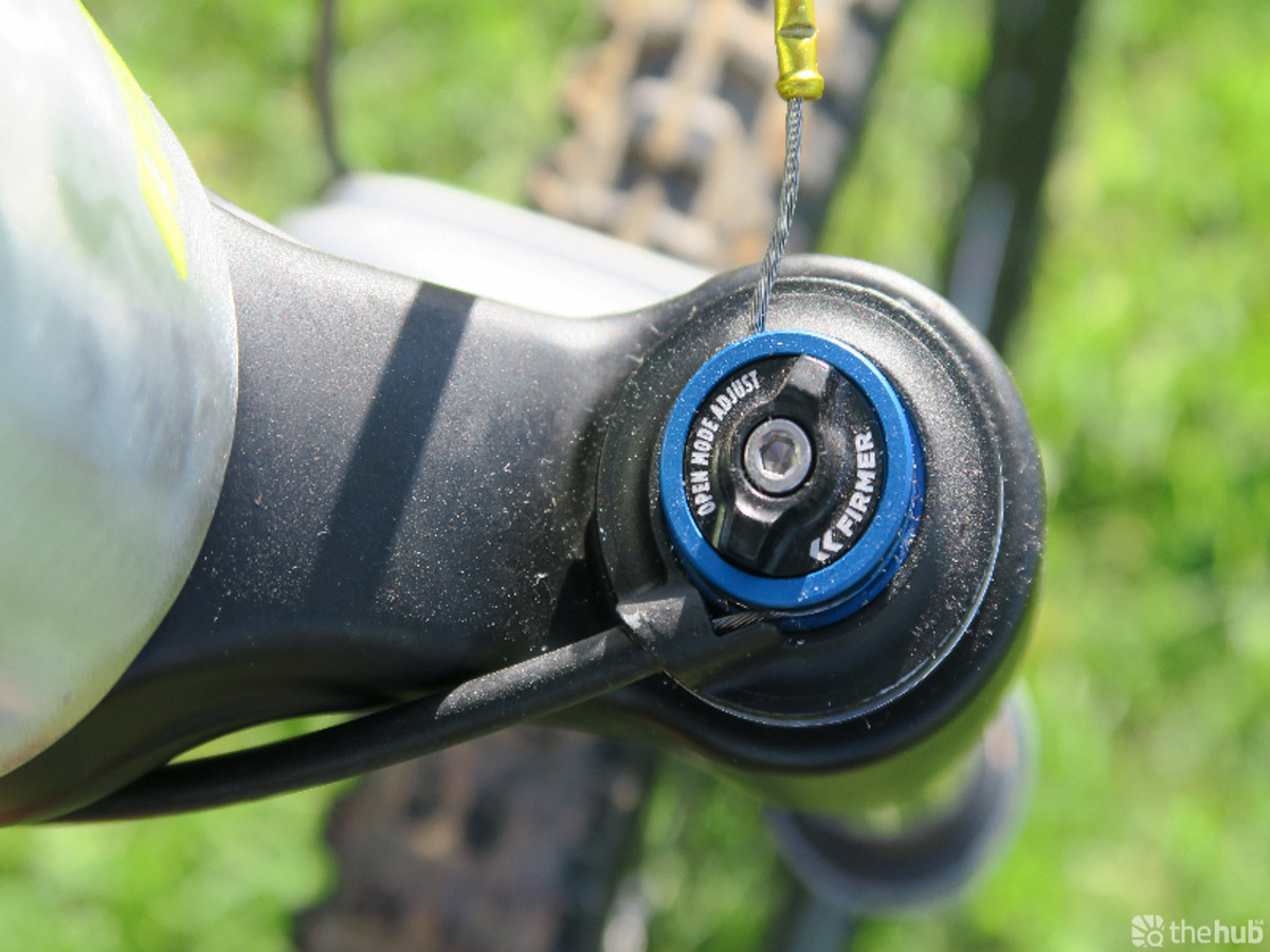

While the FIT4 damper has three compression positions, Fox has done away with CTD and it’s “climb, trail, descend” moniker for “open, medium, firm.” Another big change comes with the small “trail adjust” black knob, which tuned compression in the middle “Trail” setting, making way for 22 clicks of low speed compression adjustment in the open setting – just like RockShox’s Pike. Providing compression adjustment in the open setting makes sense as this is where riders will be looking to dial in the best possible descending performance. In addition, a dual circuit rebound allows the fork to keep up with high frequency impacts, and to recover from deeper hits in a more controllable manner.

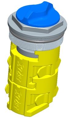

Further adjustment comes in the form of volume spacers, yellow plastic blocks that interlock together. They adjust the spring rate and make the fork more progressive through its travel. Changing volume spacers in the 34 Float is an easy internal adjustment that allows you to change the amount of mid stroke and bottom out resistance. If you have set your sag correctly and are using full travel (bottoming out) too easily, then you could install one or more spacers to increase bottom out resistance. If you have set your sag correctly and are not using full travel, then you could remove one or more spacers to decrease bottom out resistance. The fork comes with one spacer installed right out of the box. For a 160mm travel fork, up to four spacers can be installed. For a 110 mm fork, up to seven spacers can be installed as there is more room inside the fork at full compression.

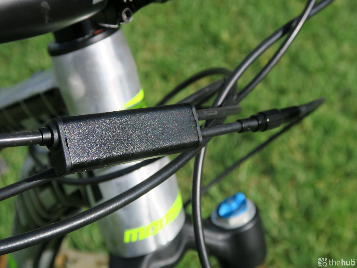

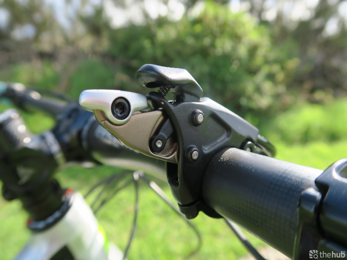

Ours came with the 3-position remote lever that simultaneously changes the setting on the fork and shock. While I do understand that some riders may like it, I’m not a fan. Every so often I will flick a shock into the middle Trail / Medium setting when out riding or when pedaling away on long up hill sections. I would, however, hardly ever take a fork out of the full open mode. Something that was highlighted with the 2015 CTD Forks / Shocks: descend mode wasn’t really rideable which meant I kept the fork in the middle Trail / Medium setting, but if I were using this remote it would set the shock to the middle setting as well. This results in a compromise in terms of setup and on trail use. Maybe makes sense on a bike designed to race XCO, but I still need to be convinced that it has a place on a trail or Enduro bike.

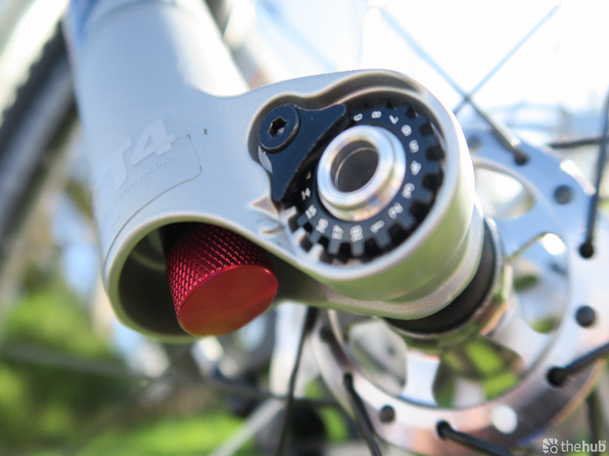

Rebound adjustment is done by turning the red knob at the bottom of the right lower. There are 9 clicks from slowest to fastest. I found Fox’s setup guide to be spot on in terms of amount of clicks needed to match the psi I was running.

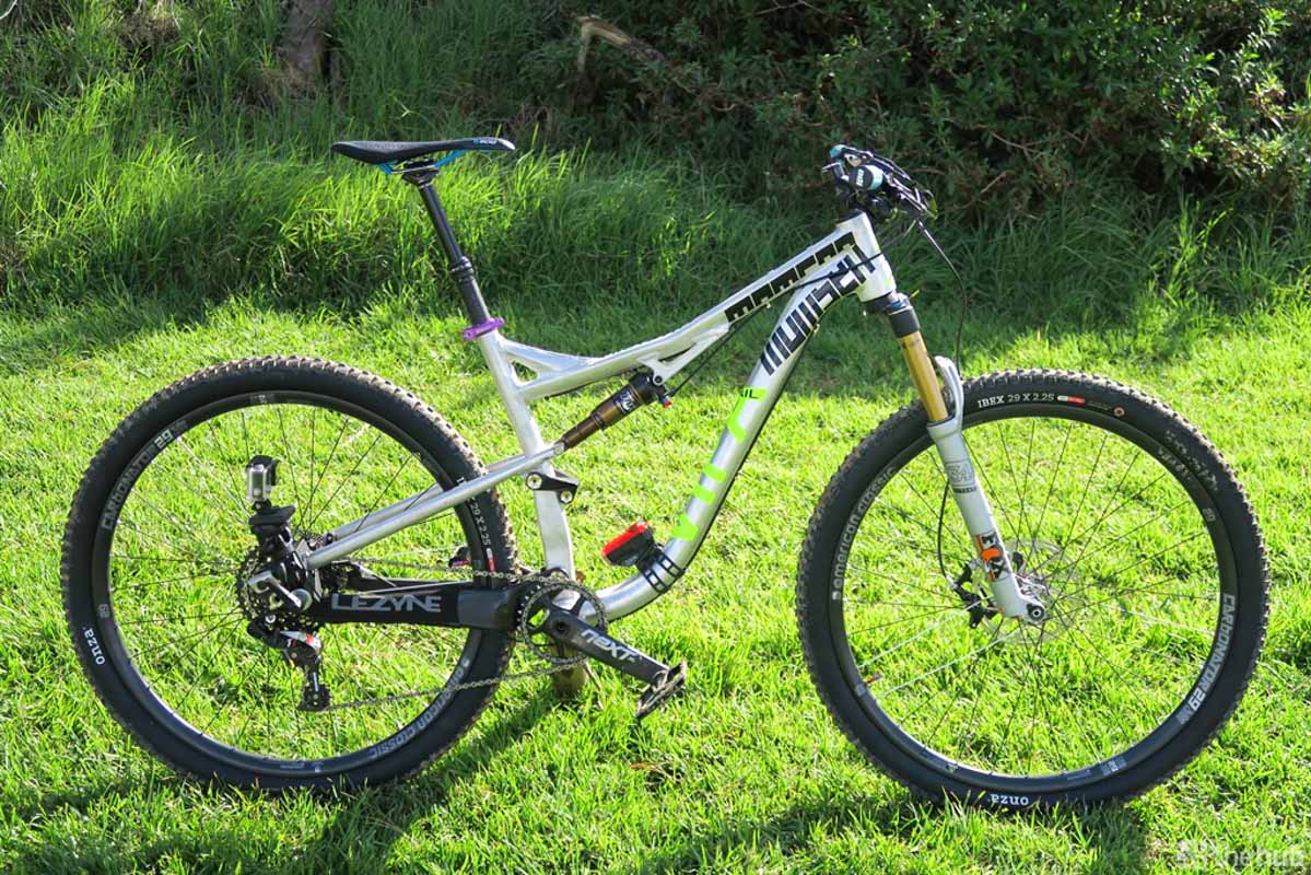

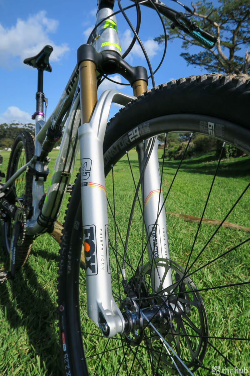

We were fortunate enough to be sent a 130mm FLOAT 34 Factory Series to test on the Momsen Bikes VIPA TRAIL running prototype. Claimed weight for the fork is 1,81kg which is close to 300g lighter than the comparable model from 2015. This was achieved by removing 34g from the steerer tube, 31g out of the crown, 53g from the upper tubes, 49g out of the lowers, and 130g with the new Positive / Negative Float air spring. A job well done by the Fox engineers.
Let’s start with what you’re really here for: the MY16 34 is a night and day improvement over the 2015 model. There’s the usual tuning that needs to happen in order to extract the maximum out of the fork and to get it to your liking, but I can’t imagine anyone riding this fork and not being able to feel the improvement in performance straight away. Forget what you know about the CTD 34 – this is not merely an incremental or evolutionary release.
No longer is setting up the fork one of compromise. All the changes made add up to a highly tuneable fork with a wide range. You could, for example, set the air pressure lower (within reason) for initial small bump sensitivity and then add air volume spacers as needed to make the fork ramp up in compression force to prevent bottoming out during big hits. Riders of all weights and levels can now tune the spring curve of their fork to maximize the travel for their needs.
System friction has been reduced to levels only ever read about. Making the 2016 FOX 34 buttery smooth all the way through its travel. Trail performance is controlled without showing any signs of “dive” under braking or when landing bigger jumps or drop-offs. I’m very happy to report that the full open mode is now rideable.
Out on the trail, I have not missed the external adjustment for high-speed compression as found on the 36 RC2. Maybe I don’t ride hard enough or just too focused to hang when the speed picks up! Speaking of which, once at speed the fork tracks and steers with razor sharp precision showing no sign of flex or letting up.
Thanks to the sorted on trail performance there was no need to fiddle with the 3-position remote lever.

Is that a light on the downtube of the test bike? Why?

Jul 20, 2015, 1:17 PM
It's a Fly6 HD Camera / Tail Light combo. Easiest to mount all over the bike, easy to use and takes great video. Used to track suspension set up and performance. This is what the bike looks like on the day (Other cams / lights were removed for the shot)

Last question. Was the fork actually ridden? It's very clean for a tested mtb fork
Yes. I keep my stuff clean so it'll last longer and I show the same respect and care for review gear. Nothing that'll stop the flow of kit as quick as returning something in a beaten up state.
I like review pics to show the gear. Ride pics can be muddy, dirty and fun.
