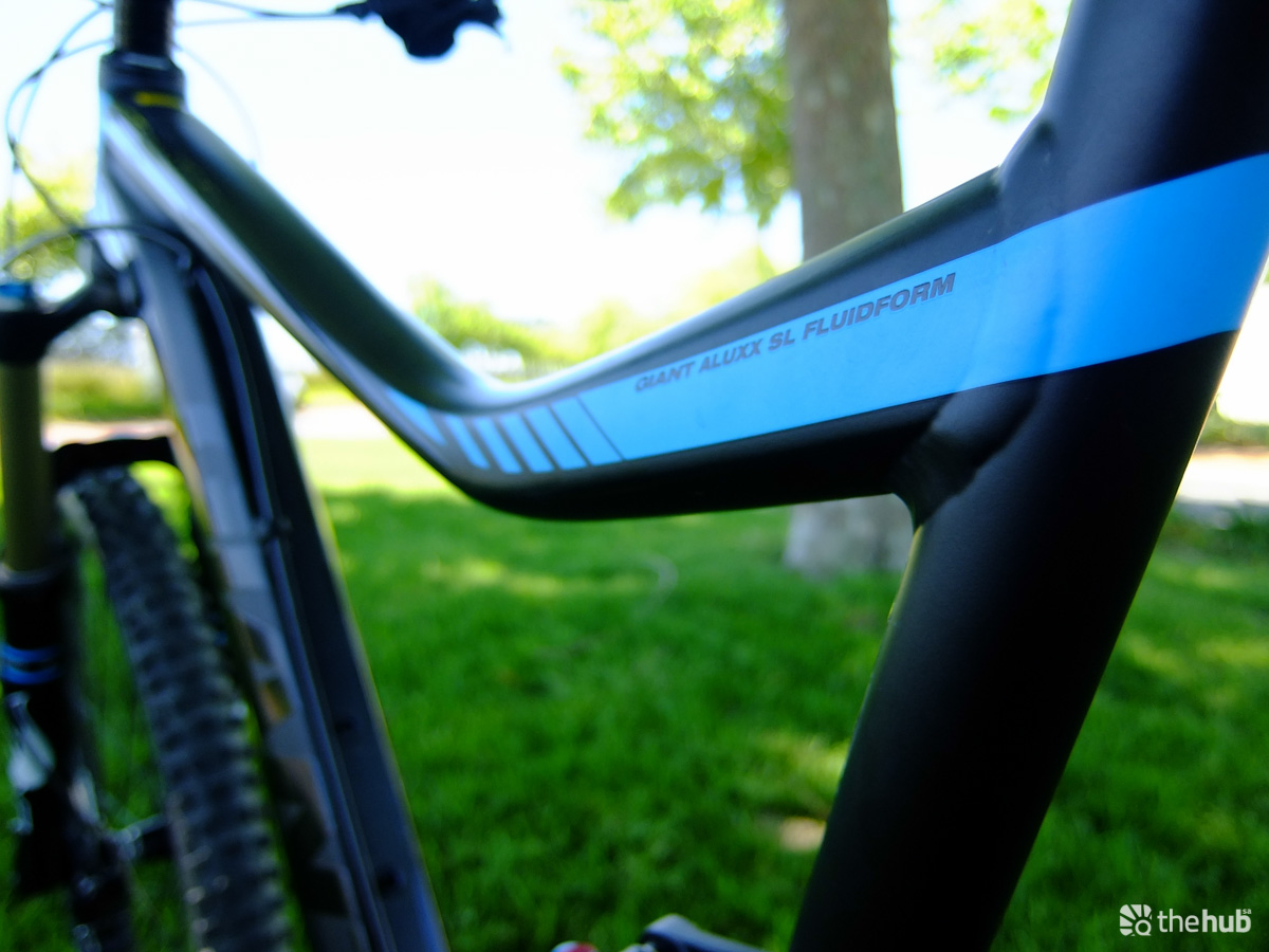

The Frame
At the heart of the Trance is the hydroformed ALUXX SL frameset with Maestro suspension. Giant is proud to say that it’s the lightest alloy 5.5-inch/140mm travel full suspension frame they have ever made. I am glad to see their swooping top tube is back after they abandoned it a couple of years ago in favor of a marginally lighter straight top tube. Not only does it look better to me, it also adds much needed standover height.
The swingarm is 27.5 specific for the shortest possible chainstays and wheelbase, supposedly resulting in snappy handling. At 440mm the chainstays they are not the shortest, but I didn’t really notice the additional length out on the trail. It is shortsighted to put too much value in a single measurement of a bike’s geometry – all the angles, lengths and widths should be considered together, as it’s in this melting pot where magic happens.

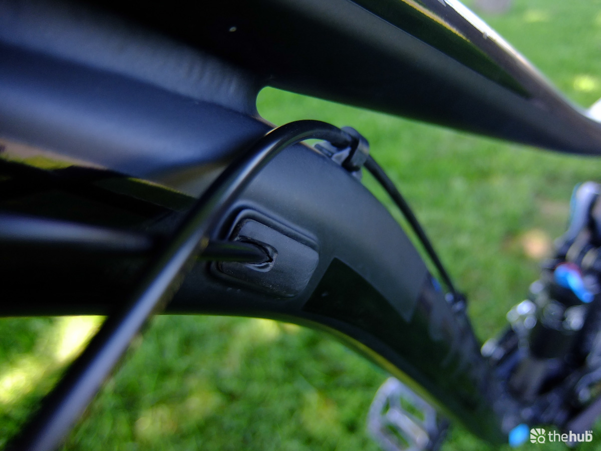

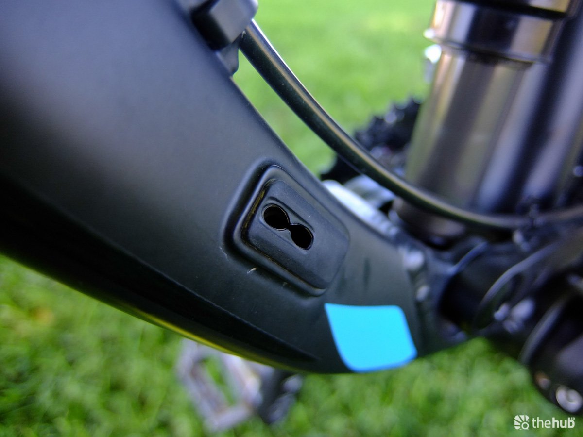

Cables are routed internally for a clean look and Giant has managed to do this in a way that doesn’t lead to any annoying rattling or slapping that so many frames with internal routing suffers from. Keeping with internal routing, the Trance is compatible with “Stealth” dropper seat posts. The hose for the rear disc brake is still routed down the top of the down tube for ease of maintenance, but can also be routed internally should you wish to do so. More evidence of attention to detail can be found in the integrated chainstay protector. We’re seeing more and more of these on frames and can only applaud the industry for adding value and bits where it matters.

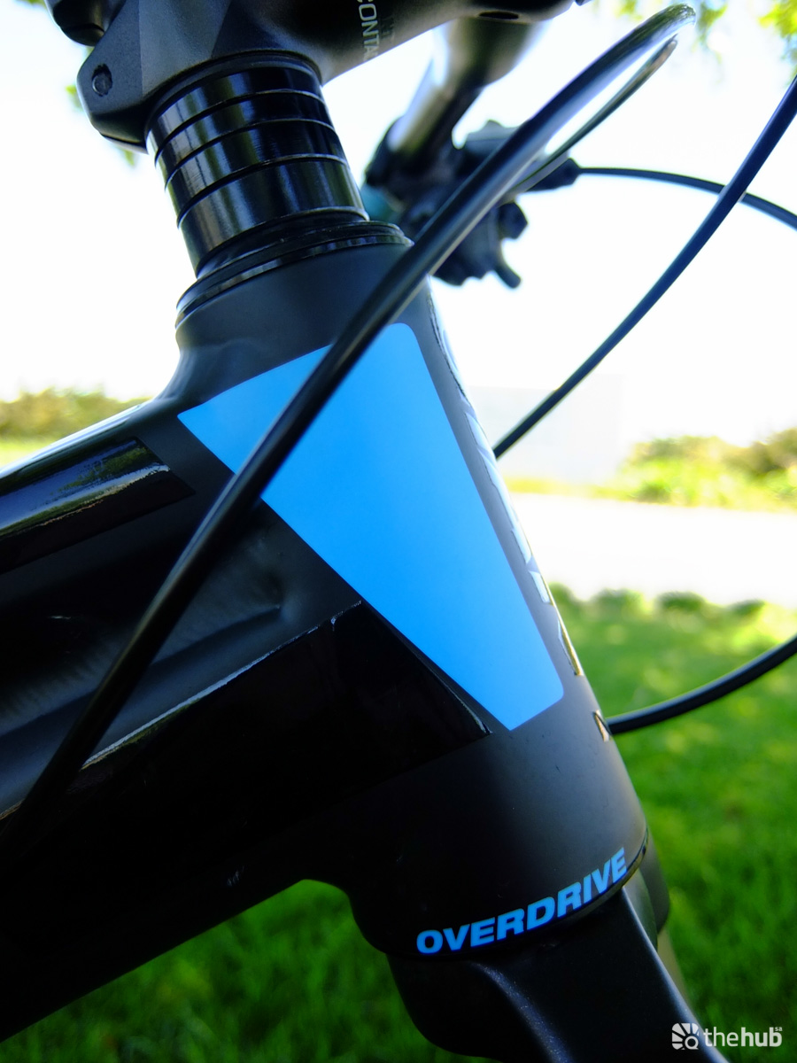

Overdrive 2
For their 2012 model range Giant introduced a new steerer standard called Overdrive 2. Rather than having a 1 1/8th inch diameter, these forks had a diameter of 1 1/4, and tapered down to 1.5″, which Giant claimed resulted in a 30% increase in stiffness at the handlebar. Although it was unique on their bikes, Overdrive 2 (OD2) was not patented and therefore free for all to adopt.
There were however 2 practical issues with OD2. First, complete bikes shipped with OD2 forks which is fine if you weren’t planning to upgrade and sell the OE (Original Equipment) fork. If you did, you could only sell that fork to another Giant rider with OD2 or to someone with a 1.5″ straight steerer, but these are becoming hens teeth and should you find one it would be on a DH bike. Secondly, it used an OD2 stem and finding those aftermarket was a pain to say the least. Only a handful of stem manufacturers developed and launched OD2 compatible stems and most of them disappeared soon after. In terms of it’s benefit I’m sure Giant saw a 30% increase in stiffness on a test bench. My initial thought was that that 30% would be over and above what the average rider would be able to feel on the trail and no real benefit in real life.
Why all this historic info you ask? Well going forward Giant has gone back to standard tapered steerer which means forks and stems are readily available and you will find a buyer for your OE fork or stem that came stock on your Giant. Riders rejoice! Note that Giant still refers to their tapered head tubes and steerer as “Overdrive”.

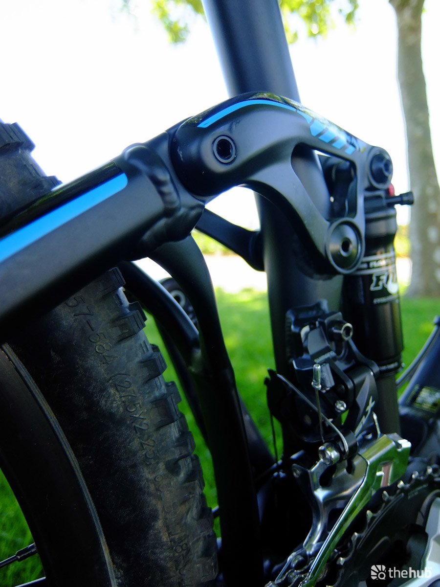

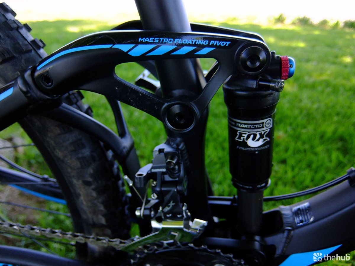

Maestro Suspension
First introduced in 2004 the Maestro has seen several evolutionary changes over the past decade to adapt to riders, modern geometry and drivetrain revolutions. In recent years changes have been made to take full advantage of 1x and 2x drivetrains and cartridge bearings have been incorporated in the upper shock mounts to improve the bikes’ small-bump compliance.

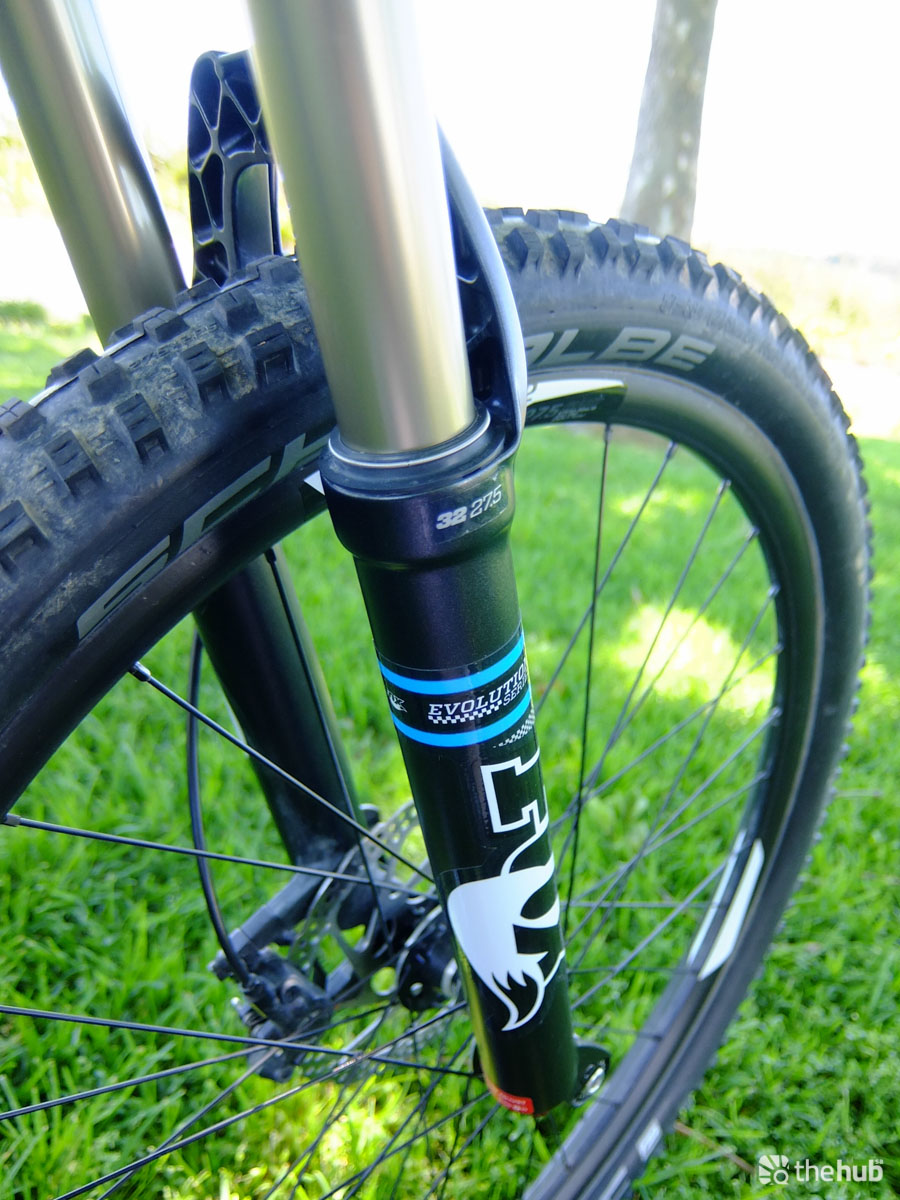

Fork: The Fox 32 Float on the Trance 2 offers a noticeable upgrade in performance over the 2014 Talas and 2014 Float that I’ve ridden recently. It was easier to get the front and rear suspension balanced to my liking. That being said, at 140mm the fork feels stretched and battles with stiffness. Under load or when the trail gets rough there’s quite a bit of twang and it soon feels over-run. This is in part due to the frame’s seemingly willingness to go faster and bigger, but in doing so it stretches the Float 32’s boundaries. From my experience a RockShox Revelation would have better suited the geometry and the faster, harder riding expected on the Trance.

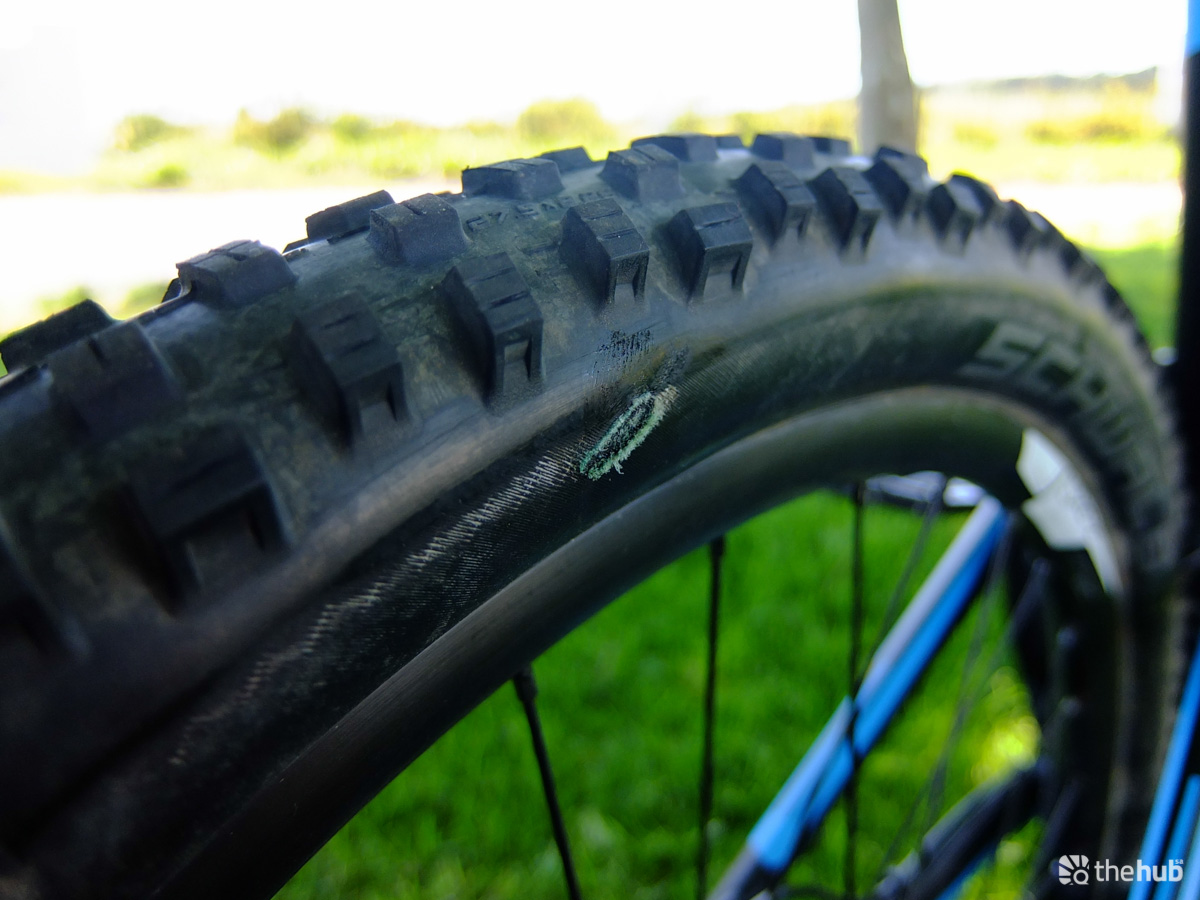

Tyres: Nobby Nics are great all rounders for general trail riding, but when pushed hard they battle to offer enough grip to maintain the speeds the frame can handle. Tires with some form of added sidewall protection is a must on most of the trails I ride and it didn’t take long for the sidewalls to show signs of damage and wear. Note that the Nobby Nics on the Trance are from Schwalbe’s Performance rather than Evo line.

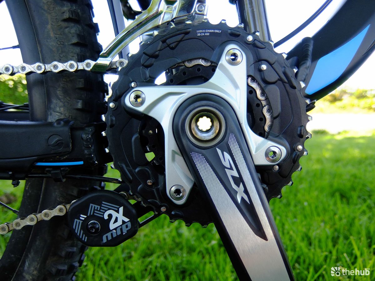

Drivetrain: Shimano’s SLX groupset has become a fan favorite and for good reason. It is tough, strong, and reliable. The 24/38 chainrings paired with the 11-36 cassette provides a good spread of gears whether going up or down.

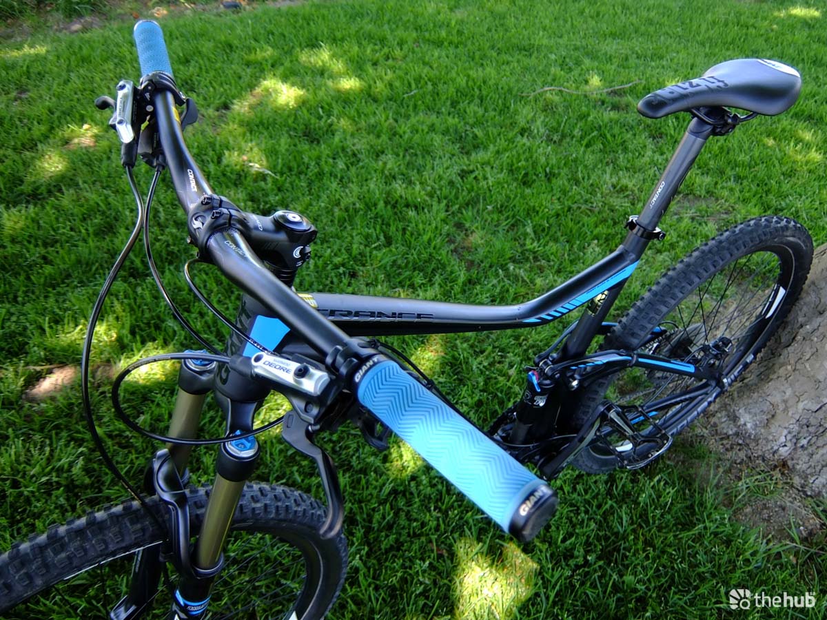

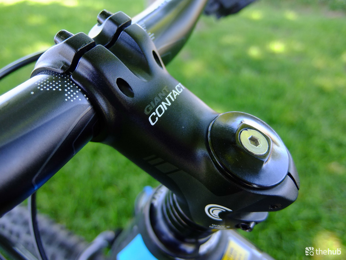

Cockpit: A 730mm Handlebar paired with a 70mm stem is definitely a huge step in the right direction. No longer is it almost guaranteed that you will need to swap out the bar and stem to find something that works best for what the bike is capable of. After playing around with different set ups, I settled on a 60mm stem and 750mm bar – purely personal preference of course.
MRP 2X Chain Guide: The bottom guide does a great job of keeping the chain in place and the ride quiet when the trail gets rough. Seeing one on a bike in this price range is testimony to Giant’s attention to detail in speccing the Trance.
