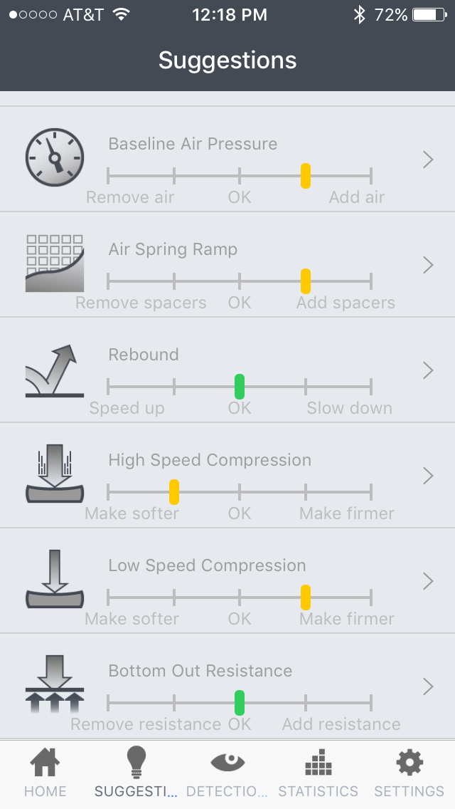

ShockWiz is a suspension tuning system for air-sprung mountain bikes that combines high-tech hardware with an intuitive smartphone app.
Lightweight, durable and powered by a long-lasting coin cell battery, ShockWiz automatically records and evaluates suspension performance every time you ride. The ShockWiz app displays straightforward adjustments that unite bike, terrain and riding style. ShockWiz works for all mountain bike riders, regardless of their experience or bike’s intended use. With ShockWiz, you know exactly how your suspension is performing – and how to make it better.
How it works

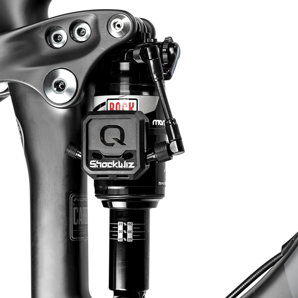

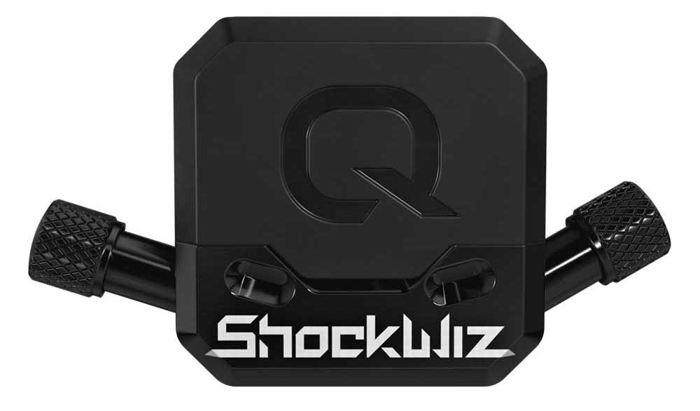

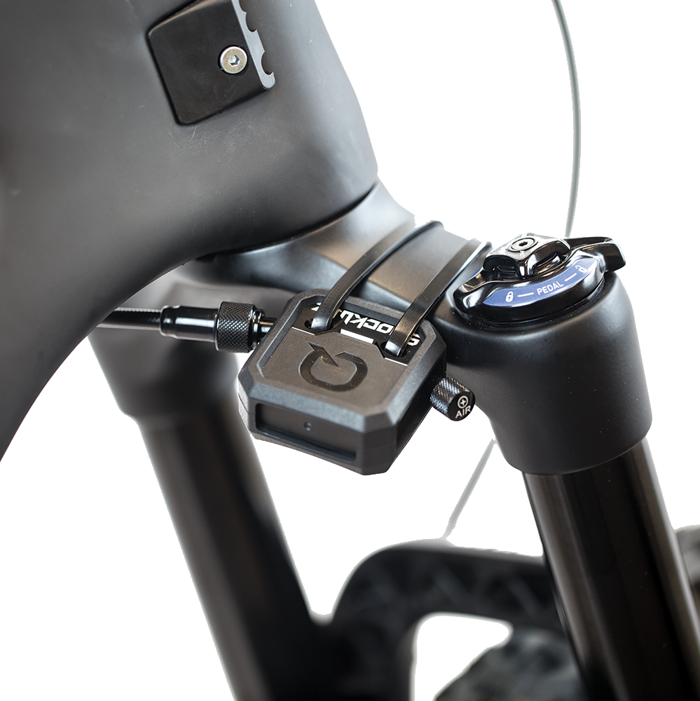

ShockWiz’s small, waterproof case houses a highly accurate pressure sensor and microprocessor. You connect it to your fork or shock’s Schrader valve and it samples air pressure 100 times-a-second while you ride.
Finely tuned algorithms analyze the changes in pressure to detect undesirable characteristics such as pogo, pack-down or bob, and class their severity. If a characteristic is severe or persistent ShockWiz will determine the adjustment required to fix it – baseline air pressure, air spring ramp, rebound, compression – and display this in the smartphone app.

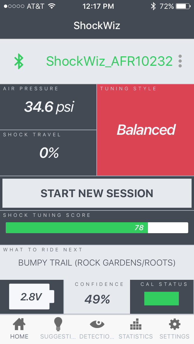

  • Automated tuning recommendations.
  • Shock tuning score — a snapshot of how well your suspension is set up for you
  • Works on hardtail and dual suspension bikes. Works for Cross-Country, Trail, All Mountain and Downhill
  • Inexpensive, replaceable CR2032 battery lasts for months
  • Waterproof and dust proof — IP67 rating
  • Two alternative hoses (included) offer a range of fitting options

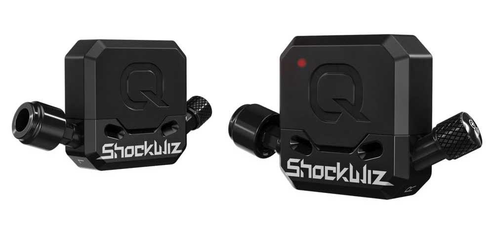

Hardware specifications
Weight: 45g (with rubber mounting boot and valve caps)
Wireless Communication: Bluetooth low energy (also called BLE; formerly called Bluetooth Smart)
Waterproof, Dust Proof Rating: IP67
Battery Type: CR2032
Air Volume: ShockWiz and one hose add around 0.50mL of air volume. (The volume of a single M&M candy piece is 0.60-0.65mL.)

AM Quarq ShockWiz Direct Mount: $449 / €469 / £409 / AUD $579. Dedicated version for inverted forks such as the RockShox RS-1.
