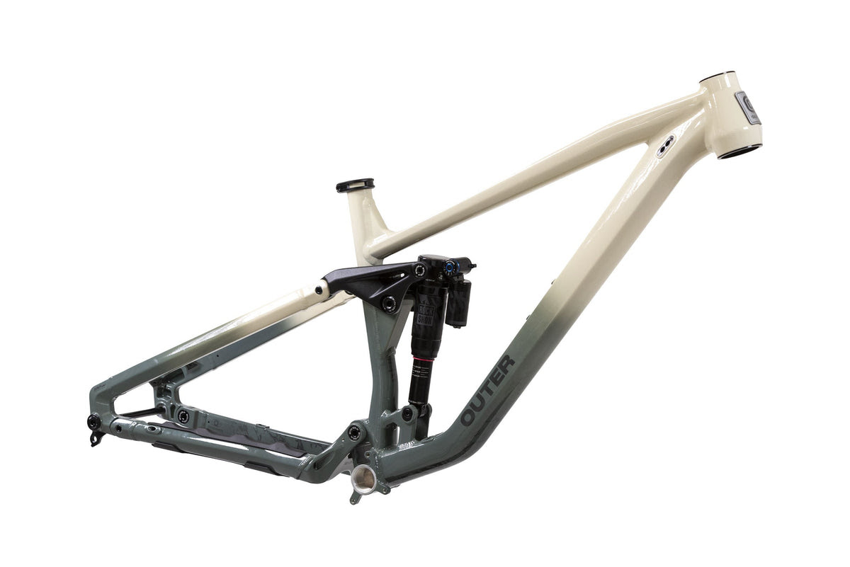

The Shale is our take on a modern enduro machine—capable, confident, and ready for whatever the trail throws at it.
Sharing the same proven suspension platform as our Link E-bike, it’s built for riders who want a bike that feels stable at speed, efficient on the climbs, and controlled in the rough. Its progressive geometry strikes a balance between confidence and agility, with a slack head angle that keeps things steady on steep descents, a steep seat tube that positions you efficiently for climbing, and a moderately low bottom bracket that helps the bike feel planted without losing responsiveness.
A flip chip allows you to switch between a mullet or full 29” setup, letting you fine-tune the ride to match your style. The progressive suspension design ensures small bump sensitivity while still providing the support needed for hard hits and big landings. Standard-size sealed bearings throughout make maintenance straightforward, so you can spend more time riding and less time in the workshop.

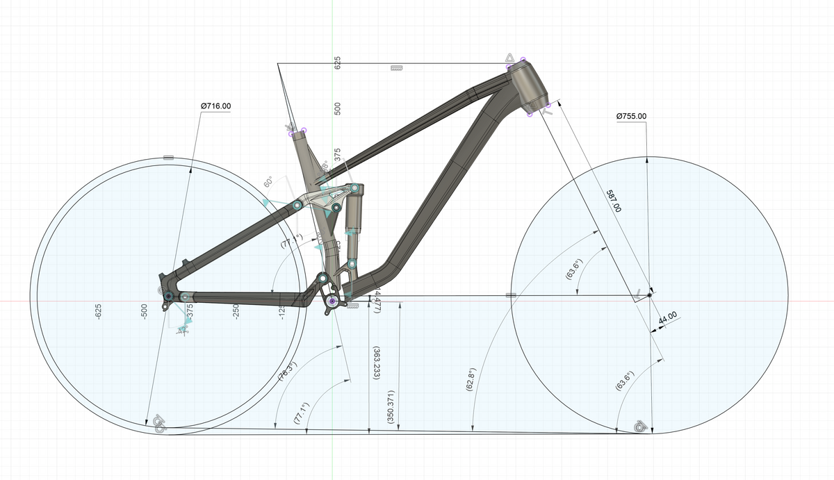

Linkage Design:
We designed an optimised rocker linkage to save weight specifically for the enduro platform. The frame uses an unbridged seat stay design, so a stiff rocker link is critical.
By using a more contoured design and thinning the wall profiles, we found a good balance between stiffness and overall frame weight.
Geometry and Flip Chip:
We experimented with the geometry on this frame to land on something that feels both versatile and modern. The goal was a long, low, and slack setup that is super stable but still holds its own when the trail gets tighter.
Initially, the flip chip was intended purely as a geometry adjustment. But with the growing popularity of mullet setups, we adapted it to function more as a wheel size correction. So, if you swap out the rear wheel size, you simply flip the chip and maintain mostly consistent geometry.

Specifications
FrameAlloy 29” Boost, 160mm travel, UDH hanger, Internal Cable Routing, Compatible Fork: 170mm 44mm offset
Wheel size29” or Mullet
Rear ShockRockshox Super Deluxe Select+ 205 x 62.5mm
HeadsetFSA No.57
Seat Post ClampOuter 36.1mm
Rear Thru AxleOuter Stealth
Frame Warranty5 Years
Weight4.5 kg (size Medium Including Shock, please allow for some deviation)
PriceR30 000 (includes RockShox Super Deluxe, FSA headset, thru-axle, chainstay protector, and hanger)
