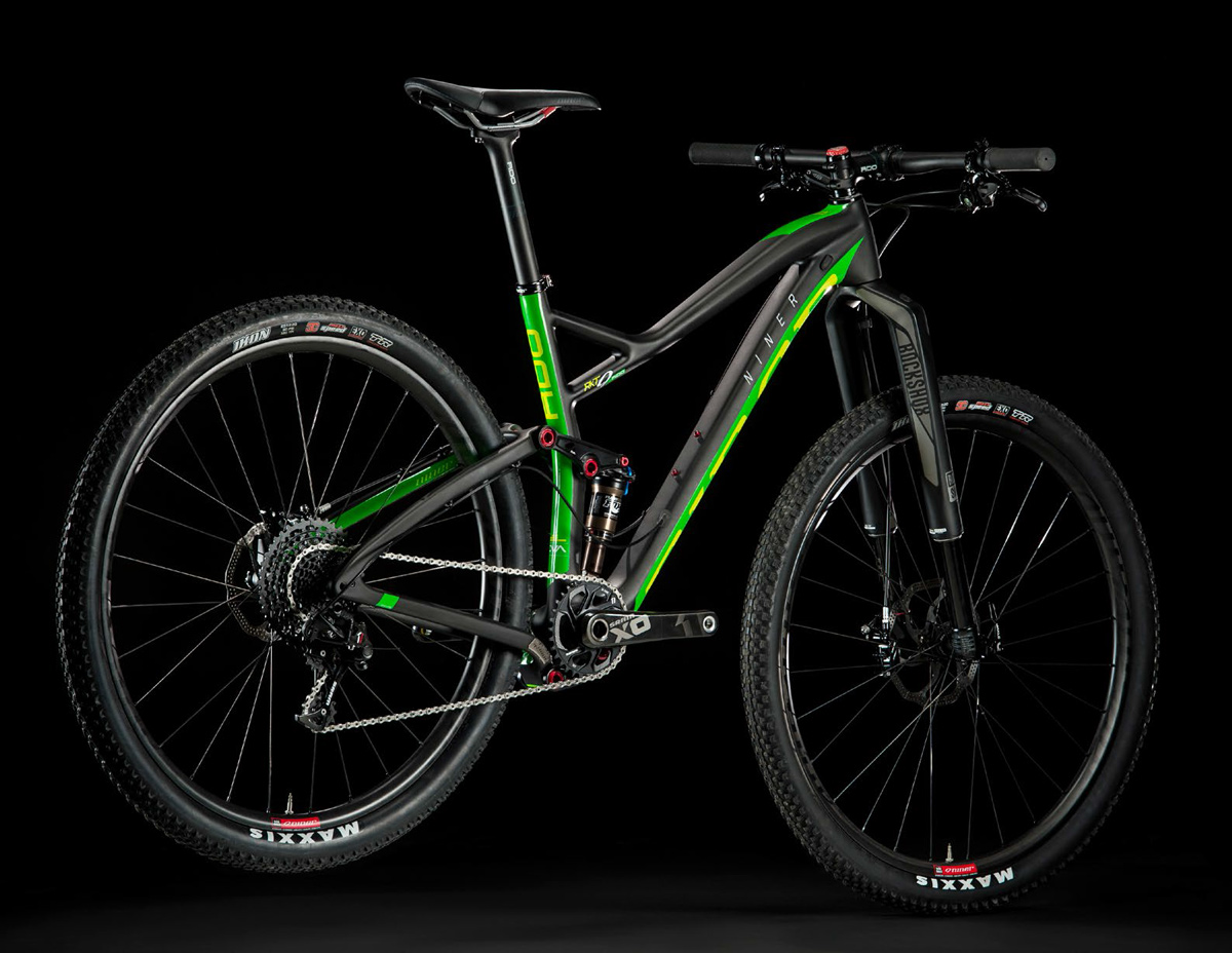

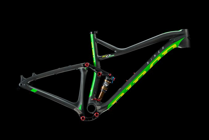

From the race track to everyday singletrack, the RKT 9 RDO is made to fly. Our completely new frame design will have you rethinking what is possible on a short-travel, race-ready full suspension 29er.
The RKT 9 RDO is intended to do one thing very well—fly. All stops were pulled to create the most efficient full suspension race-worthy short travel sled. The frame is constructed using our RDO Carbon Compaction technology, which utilizes highly resilient fibers to provide front and rear triangles that are incredibly lightweight and durable. Punish it on daylong epics and be amazed—it will keep coming back for more despite its featherweight feel.

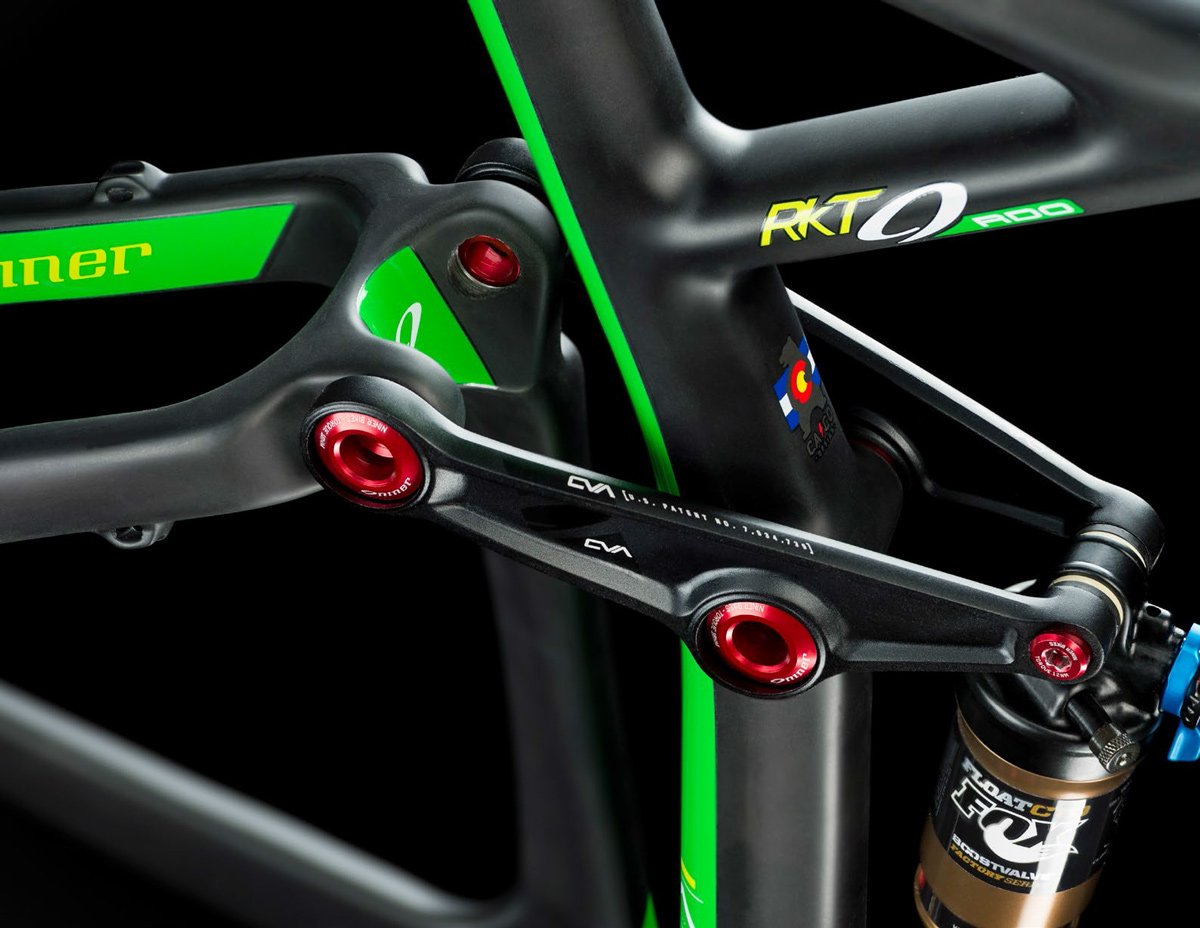

Our patented CVA linkage design allows for pedal forces to operate independently of rear wheel travel, providing every ounce of the rider’s hard-earned energy a clear path to the pedals, and after extensive testing, our engineers optimized the linkage and bearings to produce the lightest, stiffest version of CVA to date. No detail was overlooked.

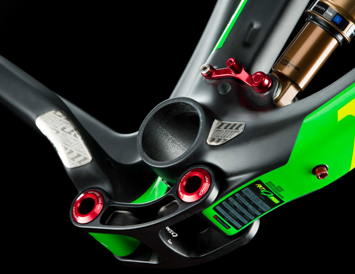

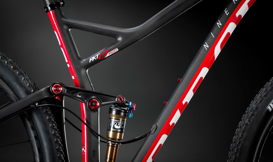

ccs-62657-0-06650400-1443620677.jpgThe new CVA linkage relies on meticulously forged and elegantly finished aluminium alloy. Combined with increased bearing diameters, the revolutionized construction better resists lateral deflection and prolongs bearing life without adding weight to the system.
A 73MM PF30 BB provides compatibility with the latest 1x and more conventional multiple ring drivetrain configurations and can be adapted to a threaded bottom bracket via adaptors. Frame sizes medium and larger have water bottle mounts on both the underside of the down tube and within the front triangle allowing for ample hydration during longer marathon-style endurance events. When the racing gets rough, the frame finds protection behind titanium frame plates which guard against the potential of a dropped chain, while clear protective decals add impact resistance to common rock-strike and high- abuse areas.

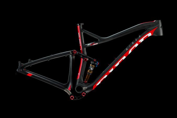

ccs-62657-0-25506800-1443620677.jpgBoasting 90mm of incredibly efficient rear travel, the new RKT 9 RDO frameset weighs a mere 4.5 lbs yet it delivers the same stiffness as the JET 9 RDO. Designed with input from our world class athletes, the bike features a race inspired fit that positions the rider lower in the front end thanks to a new svelte top tube and shorter head tube.

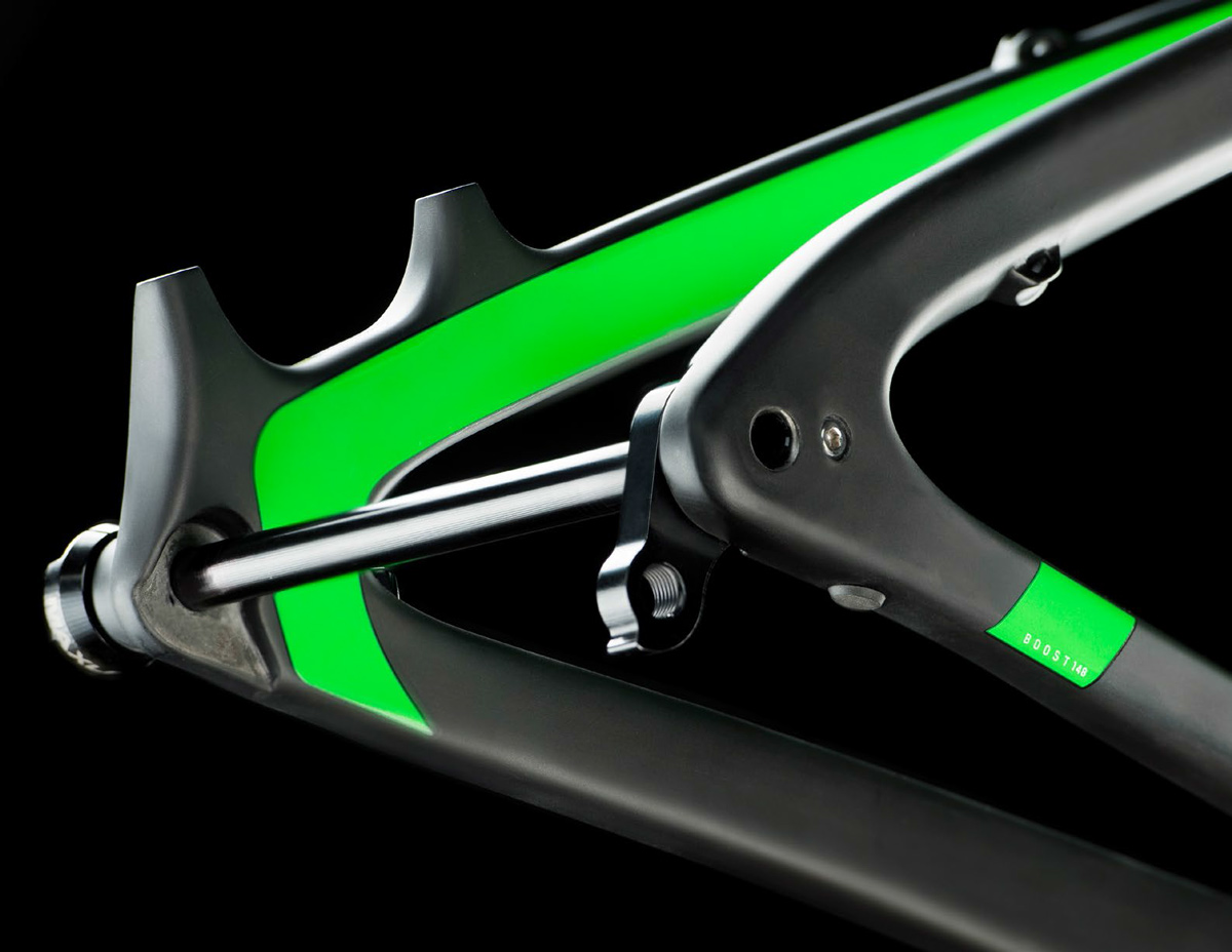

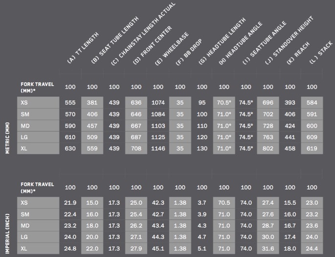

The RKT’s 439mm chainstay length provides the perfect balance of acceleration, climbing traction and the ability to carve up the racetrack. The RKT is the first Niner to feature Boost 148mm x 12mm rear spacing and has clearance for up to 2.4” tires. This feature allows for a wider spoke interface and an overall stiffer wheel and swingarm combo, enabling you to confidently maintain line selection in the roughest conditions.
ccs-62657-0-56624200-1443620677.jpgThe new RKT is built with boost spacing resulting in a stiffer and more robust rear triangle. Wheels with the wider 148 x 12mm hubs also have wider spoke triangulation yielding a combination that provides more positive power transfer and a snappy feel accelerating out of corners.

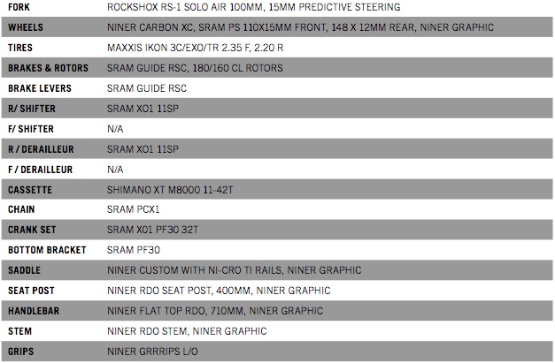

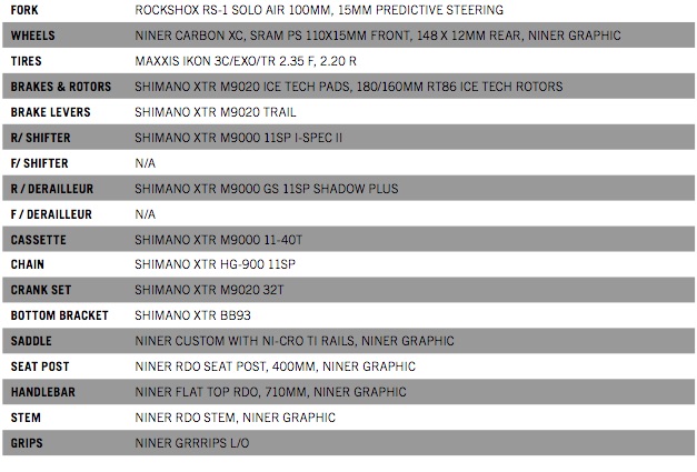

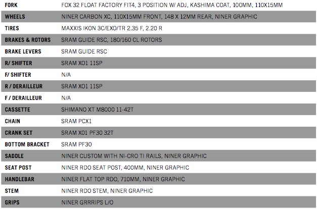

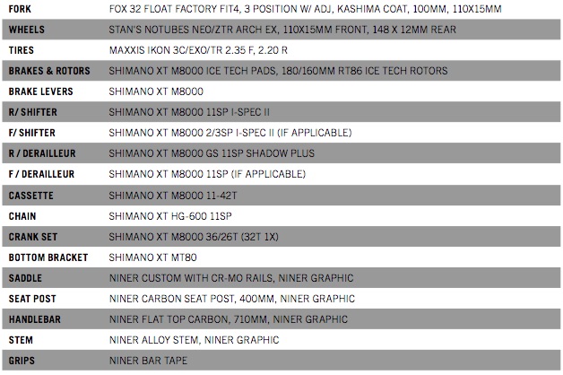

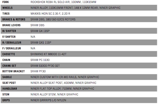

Models and specification:
5-Star XTR 1X – R136,499.00
4-Star X01-RS1 – R107,799.00
4-Star X01 Fox – R96,299.00
3-Star XT 1X – R78,999.00
3-Star XT 2X – R81,899.00
2-Star GX1 – R64,699.00
RKT 9 RDO frame only: R43,399.00

  • Custom forged 6066 alloy suspension linkage is light and stiff

  • Medium, large, xl have one bottle mount under down tube and one bottle mount inside triangle, s and xs have one bottle mount inside triangle

Love everything except for the hanging cables from the rear shock, looks like it could get caught on your foot, probably never would but it would be at the back of my mind.

Geez now I have a boner.... But the pivot is very much like the VPP from SCruz. Only inside out
