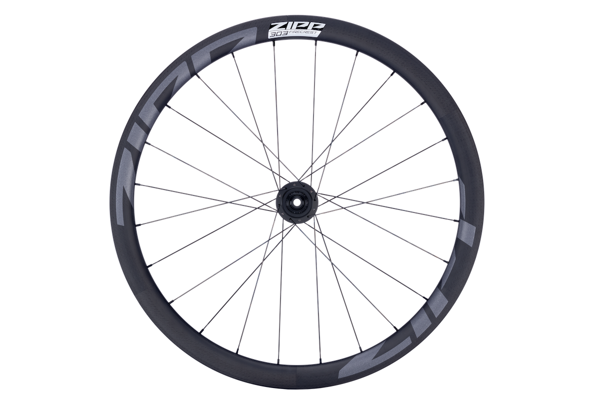

The 303 Firecrest Tubeless Disc brake was designed using real-world direct measurements (vs. primarily wind tunnel or computer simulation). This included Zipp’s new RollingRoad Testing Protocol. The results were huge. Its rim is slightly more bulbous in design than its predecessor, with a 30mm outside width, a 25mm internal width, and a 40mm rim depth. The profile provides low drag and an improved transition between rim and tyre, boosting aero efficiency on the road. The wide rim stance also features less tyre deflection for reduced rolling resistance. The combination of the wider tyre, increased tyre volume, and lower tyre pressure helps to reduce rider fatigue by smoothing out the ride over imperfect pavement and road conditions—the tyre and wheel system absorbs the shaking, not the rider. At the centre of the 303 Firecrest Tubeless Disc brake is a versatile and durable new hubset, the German-engineered ZR1 DB. This hubset features 66 points of engagement for quicker response.

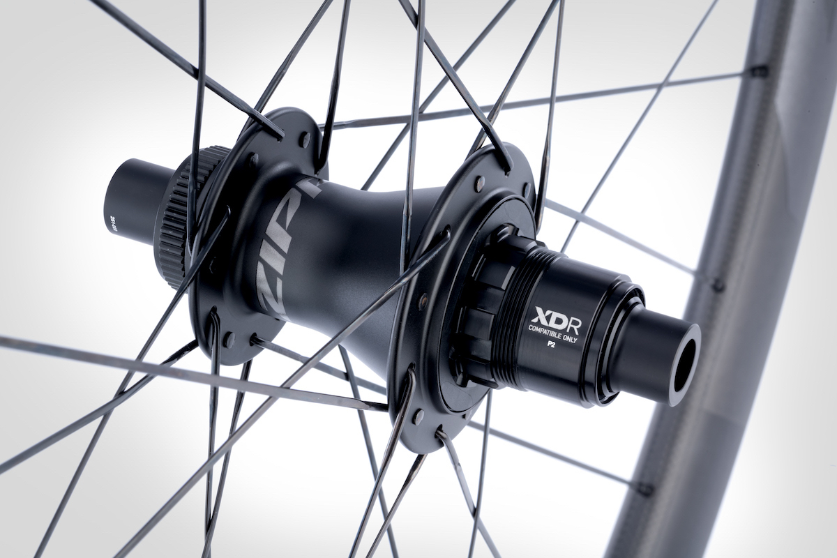

  • New ZR1 DB hub is engineered in Germany with better seal design for improved durability and quicker response with 66 points of engagement
  • Ships with 12mm front and rear end caps
  • Centre locking rotor interface. Lockring is included with the wheels
  • XDR or SRAM/Shimano driver bodies
  • Campagnolo driver body sold separately

Size (wheels): 700c
Rim construction: Carbon
Tyre compatibility: Clincher Tubeless Ready
Brake compatibility: Disc (Center Lock)
Wheelset weight: 1,355g
Rim – inside width: 25mm
Rim profile: Symmetrical
Rim finish: UD fiber, adhesive decals
Nipple material: Aluminum
Spoke type: CX-Sprint
Spoke count: 24
Spoke pattern: 2 Cross
Driver body type: n/a, SRAM XDR, SRAM/Shimano Road
Axle type (Wheels): TA 12×100, TA 12×142
Bearings: Cartridge – Stainless SteelDriver Mechanism: 6 Pawls Leaf Spring
