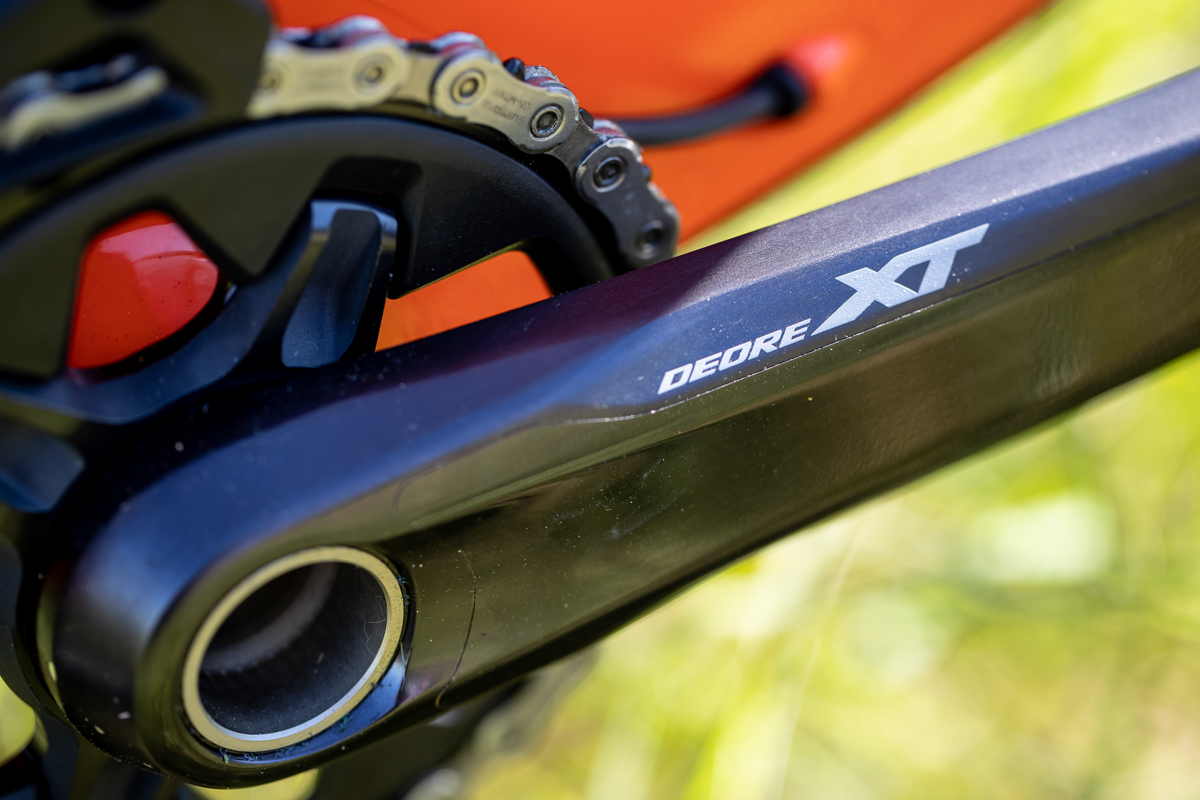

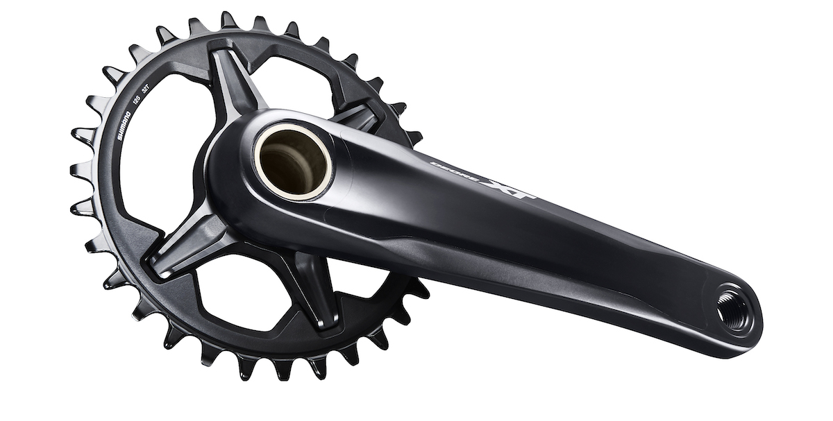

Cranksets: The newDEORE XT 1X12 crankset features HOLLOWTECH II crank arms with an integrated bottom bracket axle and hollow crank arm. Chainrings come with a Dynamic Chain Engagement+ tooth profile, which, with its narrow/wide teeth, is key to the improved chain retention, smoothness and quietness of the drivetrain. For secure and fast mounting of the chainring the crank has a direct mount system to simplify how chain rings are changed.
The crankset comes with 28T, 30T, 32T, 34T and 36T chainring options, interchangeable with XTR and SLX rings, has crank length options of 165mm, 170mm, 175mm and 180mm. DEORE XT cranksets are available for three chain lines:
  • 52mm (FC-M8100-1) for Over Lock-Nut Dimensions (O.L.D.) of 142mm or 148mm, giving the narrowest 172mm Q-factor
  • 55mm (FC-M8120-1) for an O.L.D. of 148mm for wider tyre and frame clearance (Q-factor 178mm)
  • 56.5mm (FC-M8130-1) for an O.L.D. of 157mm and a wide Q-factor of 181mm
  • Crankset weights: FC-M8100-1: 620g, FC-M8120-1: 628g, FC-M8130-1: 636g (All 32T; 175mm, w/o BB)

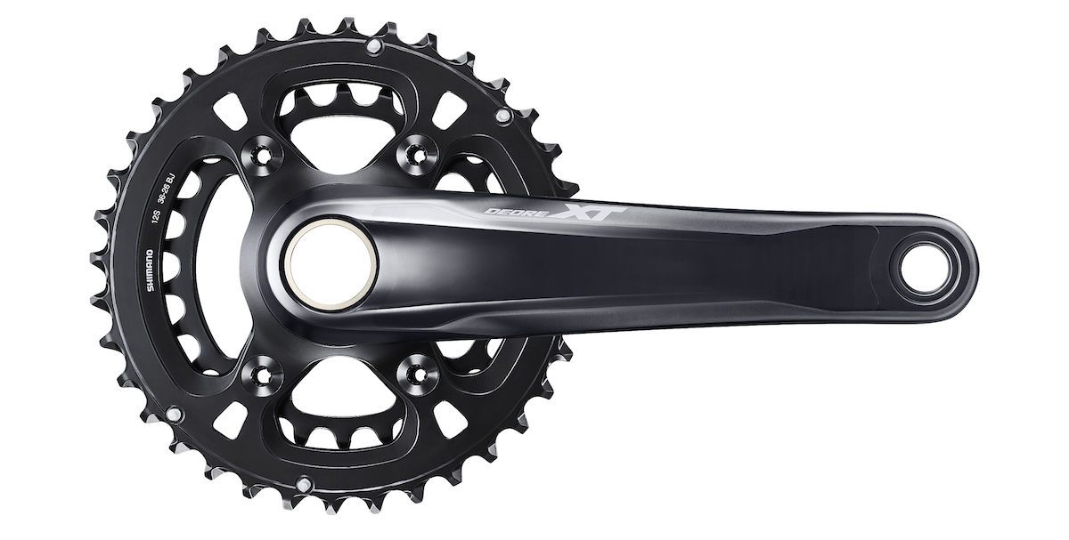

The DEORE XT 2X12 HOLLOWTECH II 36-26T crankset offers the ultimate range when matched with the 10-45T cassette, maximizing the possibilities on all sorts of terrain whilst maintaining small gear steps for a consistent cadence.
Two 2x cranksets are available, both featuring a 2-bolt system for fixing the left side crank arm in place on the spindle.The FC-M8100-2 crankset has a 142mm O.L.D. for chain lines of 48.8mm and a Q-factor of 172mm. The FC-M8120-B2 crankset has a 148mm O.L.D. for chain lines of 51.8mm and a Q-factor of 178mm.
Weight for the FC-M8120-B2 (36-26T, 175mm, w/o BB) is 672g and for the FC-M8100-2 36-26T, 175mm, w/o BB) is 654g.

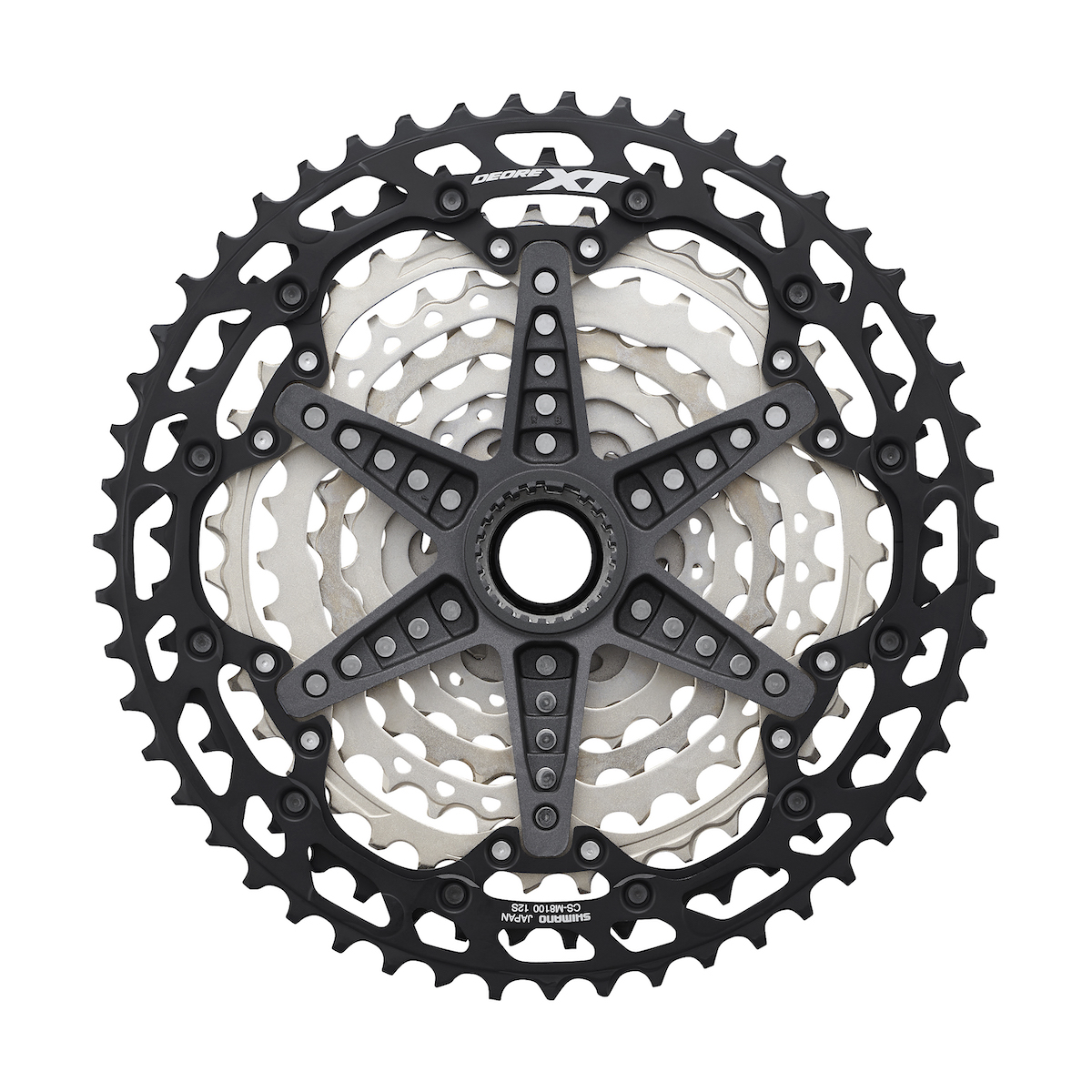

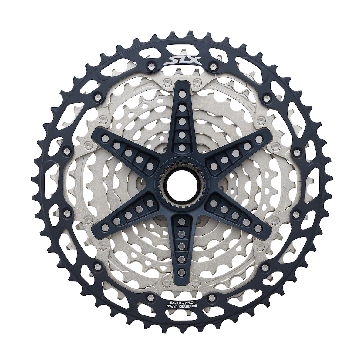

Cassette: DEORE XT12-speed cassettes come with the MICRO SPLINE fitting system and are available in a 10-45T option for small gear steps or a 10-51T option for maximum range. Both cassettes also feature HYPERGLIDE+, allowing for quick up and downshifts and an extremely quiet drivetrain. The cassettes have an aluminium spider to house ten steel sprockets and two aluminium sprockets for optimum durability and weight. The CS-M8100-12 10-51T cassette weighs 470g and the 10-45T option weighs 461g.

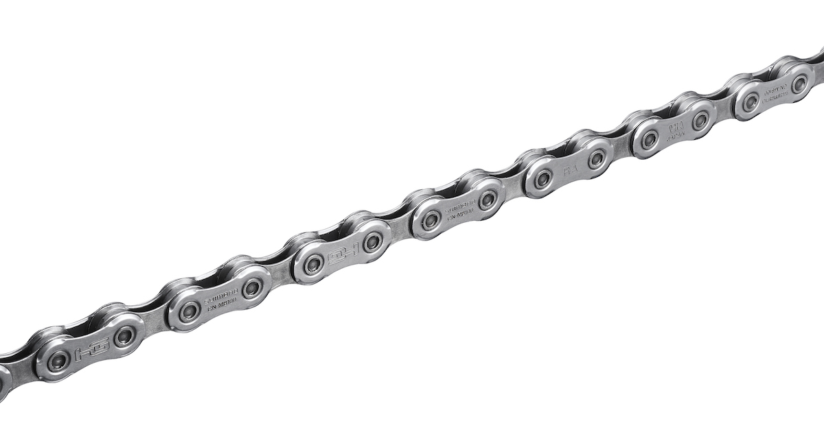

Chain: The new DEORE XT 12-speed HG chain has been redesigned with an extended inner plate to improve chain engagement and retention and comes with chromized roller link plates for enhanced durability and smoother and faster shifting both up and down the cassette. The CN-M8100 chain (113 links + Quick Link) weighs 252g.

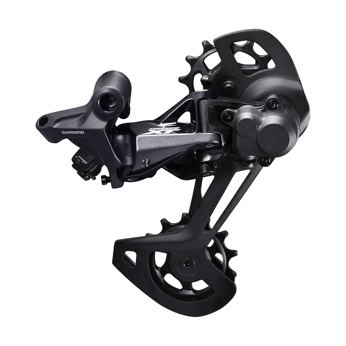

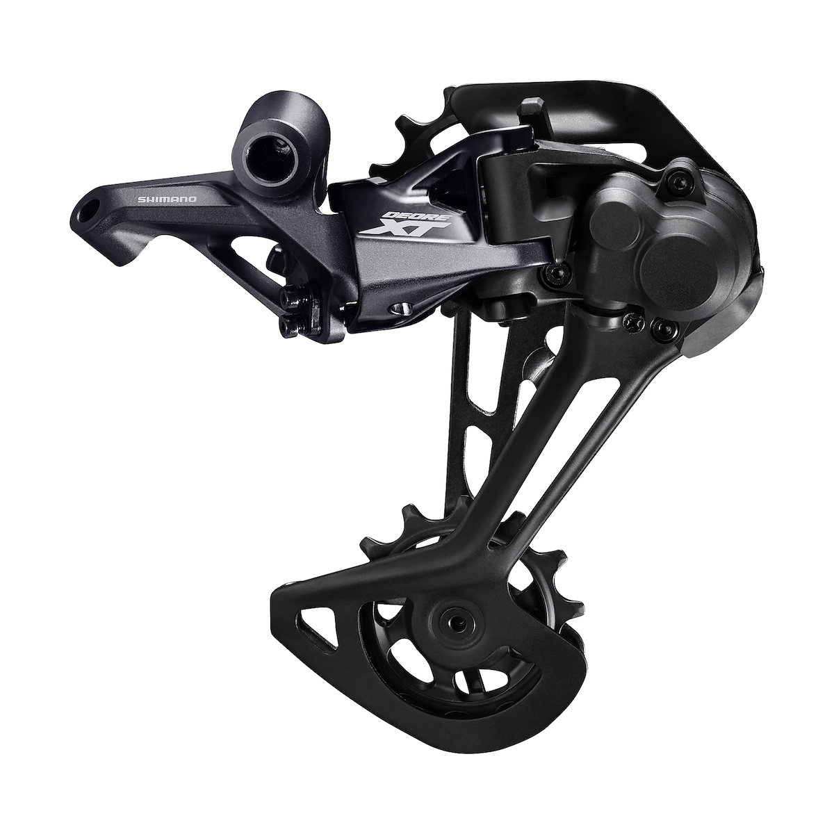

Derailleurs: Coming in either single (RD-M8100-SGS) or double (RD-M8120-SGS) chainring variants, the DEORE XT rear derailleur enables precise and quick shifting over a huge gear range. Both derailleurs feature SHIMANO SHADOW RD+ positioning, bump stoppers and 13T pulley wheels to make rides quieter and more enjoyable. Rear derailleurs weights: RD-M8100-SGS: 284g, RD-M8120-SGS: 290g.

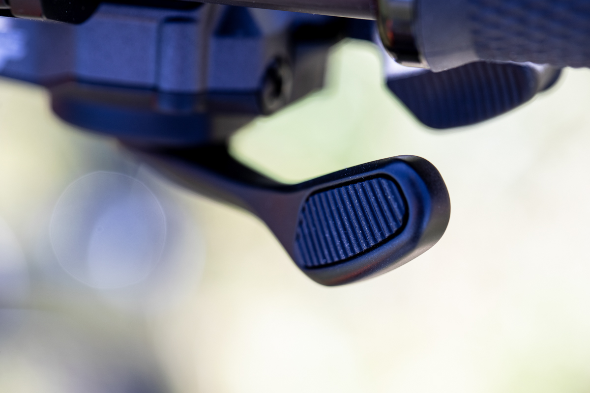

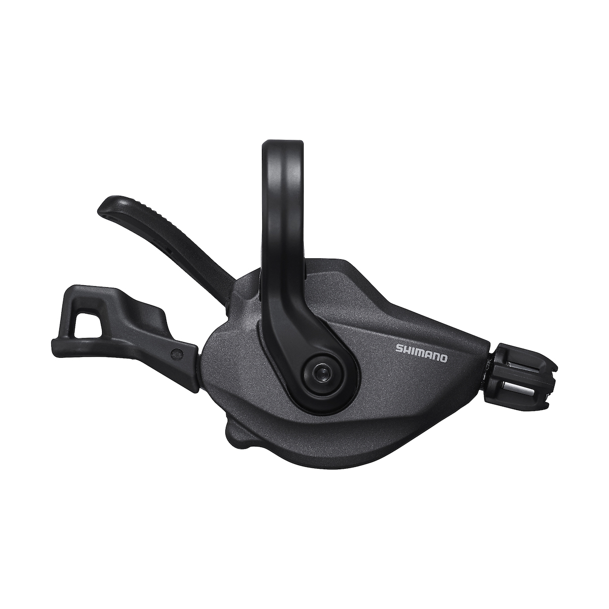

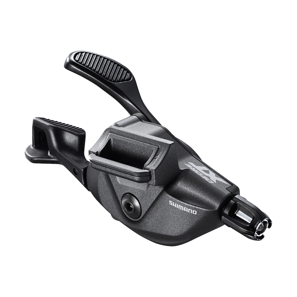

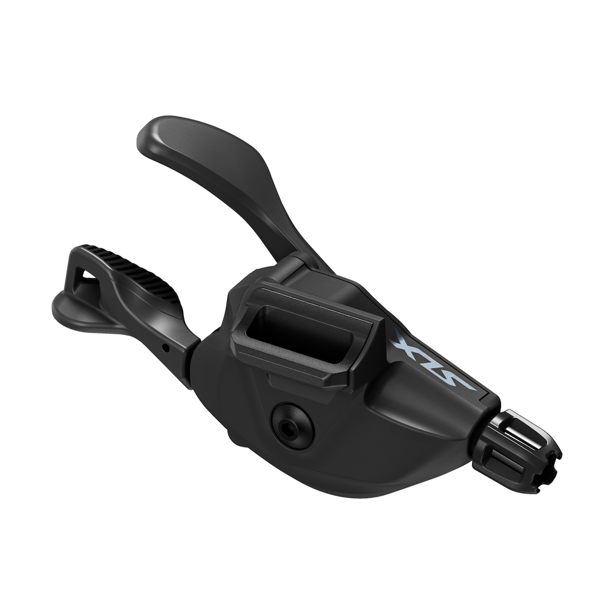

Shifters: With side adjustment and rotational adjustment options the ISPEC-EV shifters, which bolt neatly to the brake lever, offer solutions for tailoring the riding feel. Rubber padding on the paddles and a two-way release enhances shifting even further. The right hand shifter (SL-M8100-IR) uses a multi-release feature to quickly dump cassette gears and, for riders using a 2×12 set-up, a MONO lever on the left (SL-M8100-IL) shifts the front derailleur both up and down with precision. DEORE XT M8100 shifters are also available in a clamp band version. Shifter weights: SL-M8100-IR: 120g, SL-M8100-IL: 73g, SL-M8100-R: 117g, SL-M8100-L: 78g.

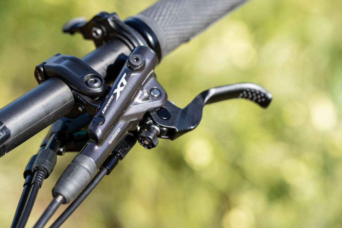

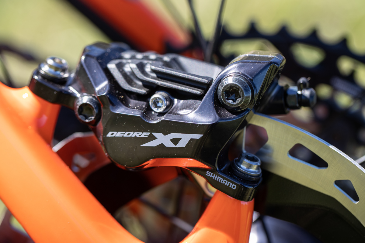

Brakes: DEORE XT brakes calipers are available in an XC-specific 2-piston version or a Trail/Enduro 4-piston version. The 2-piston version shares the same design as the previous XT M8000 version, which means the previous G02A/3A/J02A/3A resin brake pads or G04S/J04C metal pads are compatible, whereas the 4-piston version is a new completely new construction drawn from the XTR M9100 design, sharing the same N03A (resin) or N04C (metal) finned pads (compatible also with D03S or D02S pads).
The DEORE XT brake levers work with both the XC and Trail/Enduro calipers and come equipped with Shimano’s SERVO WAVE system for quicker engagement, improved power and a shorter free stroke. The brake levers are now angled in two positions against the handlebar for a stiffer brake sensation. The levers also feature a reach adjust dial and a free stroke adjustment screw for simple brake tune-ups on the trail.
XC style brake kits (BR-M8100-BL-M8100) with rotors (160 mm RT-MT800) and brake pads weigh 392g and Enduro style brake kits (BR-M8120-BL-M8100) weigh 410g including rotors and pads.

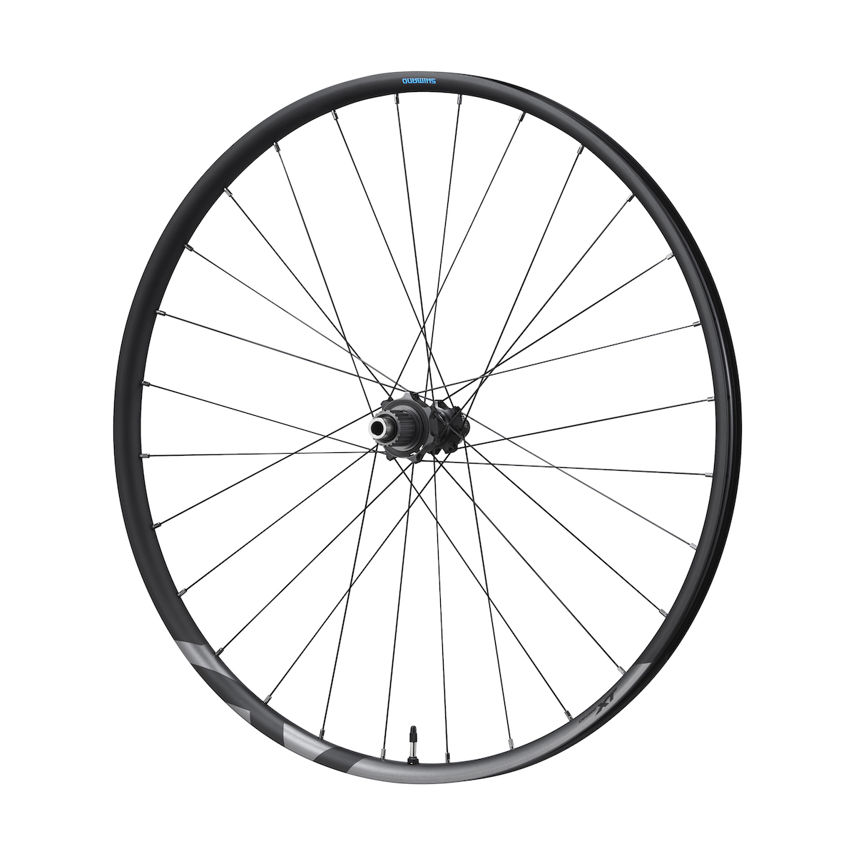

Wheels: Unlike the XTR M9100 series, the Shimano DEORE XT M8100 series offers complete 27.5 and 29” wheels for XC and Trail/Enduro riding.Shimano XC wheels offer a 24mm wide tubeless ready, fully closed rim bed for tyres up to 2.35”.The 28 double-butted straight-pull spokes offer a perfect mix of stiffness and weight (WH-M8100-27.5: 1764g, WH-M8100-29: 1840g) for fast XC riding.
On the other hand, DEORE XT Trail/Enduro-specific wheelsets offer a 30mm internal rim width made for tyres up to2.6”. Rear hubs come with zero-dish (O.L.D. 148mm) and the aluminium rims take 28 J-bend spokes to keep these tubeless wheels strong yet light for aggressive riders and riding conditions (WH-M8120-27.5: 1846g, WH-M8120-29: 1932g).
Both the XC and Trail/Enduro rear wheels feature E-THRU axles (15mm front, 12mm rear), 148mm O.L.D. widths and come with Shimano’s MICRO SPLINE cassette interface on the rear hubs.

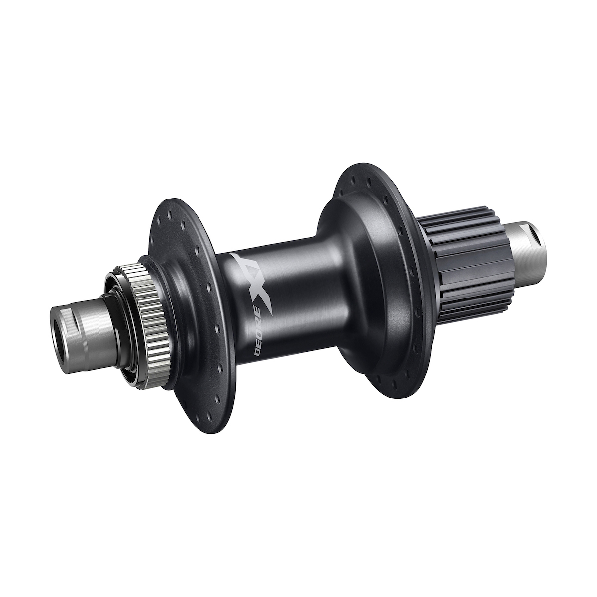

Individual DEORE XT front hubs and freehubs are also available in widths of 100mm and 142mm, 110mm and 148mm, and 157mm. Hub weights: HB-M8110: 142g, HB-M8110-B: 147g, HB-M8110-BS: 158g, FH-M8110: 305g, FH-M8110-B: 307g, FH-M8110-BS: 306g, FH-M8130-B: 310g.

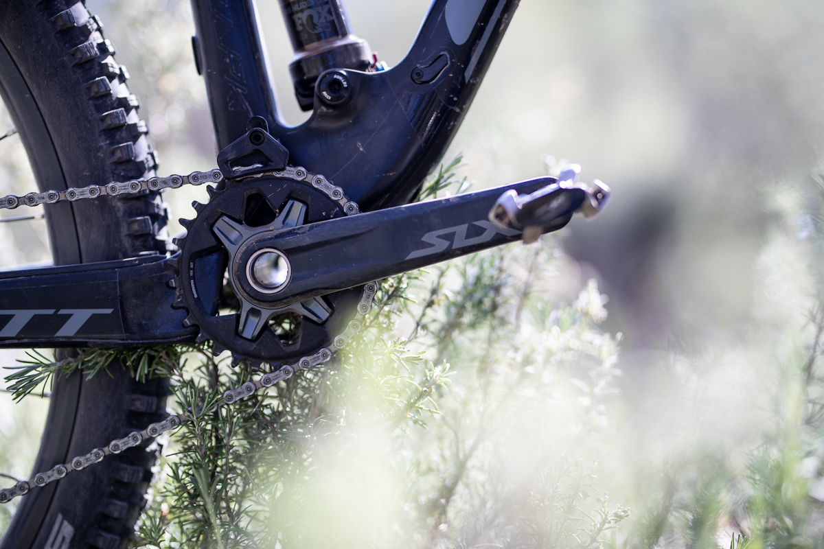

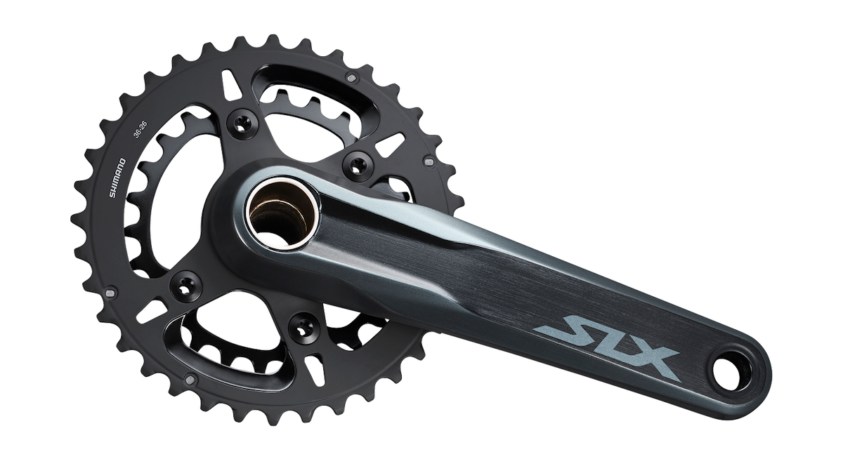

Cranksets: The new SLX 1×12 crankset features HOLLOWTECH II technology with an integrated bottom bracket axle and hollow crank arms. Chainrings come with a Dynamic Chain Engagement+ tooth profile, which, with its narrow/wide teeth, aids chain retention, smoothness and quietness of the drivetrain. To securely and quickly mount the chainring the crank is equipped with a direct mount system. The crankset comes with 30T, 32T and 34T chainring options, interchangeable with XTR and DEORE XT rings, and has crank length options of 165 mm, 170 mm and 175 mm.
SLX M7100 cranksets are available in three chain lines:
  • 52mm (FC-M7100-1) for Over Lock-Nut Dimensions (O.L.D.) of 142mm or 148mm to give the narrowest 172mm Q-factor
  • 55mm (FC-M7120-1) for an O.L.D. of 148mm for wider tyre and frame clearance (Q-factor 178mm)
  • 56.5mm (FC-M7130-1) for an O.L.D. of 157mm and a Q-factor of 181mm
  • Crankset weights: FC-M7100-1: 631g, FC-M7120-1: 638g, FC-M7130-1: 656g (all 32T; 175mm, w/o BB).
The SLX 2×12 HOLLOWTECH II 36-26T crankset offers the ultimate range when matched with the 10-45T cassette, maximizing your possibilities on all sorts of terrain while maintaining small gear steps.
Two 2x cranksets are available, both featuring a 2-bolt system for fixing the left side crank arm in place on the spindle. Much like DEORE XT, the FC-M7100-2 crankset has a 142mm O.L.D. for chain lines of 48.8mm and a Q-factor of 172mm. The FC-M7120-B2 crankset has a 148mm O.L.D. for chain lines of 51.8mm and a Q-factor of 178mm.
Weight for the FC-M7120-B2 (36-26T, 175mm, w/o BB) is 682g and for the FC-M7100-2 (36-26T, 175mm, w/o BB) is 674g.

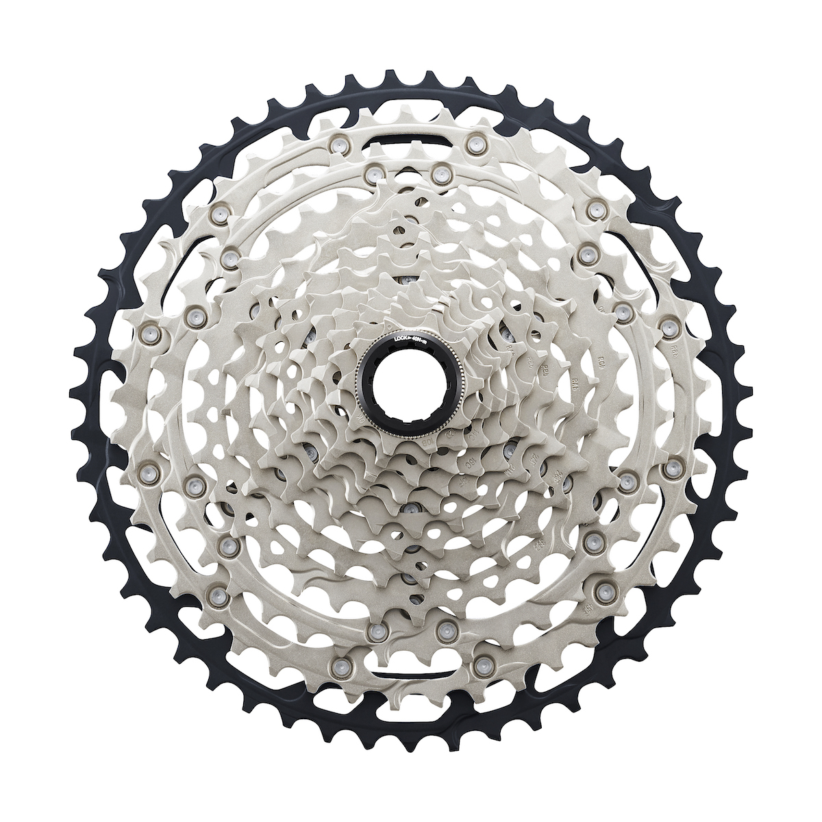

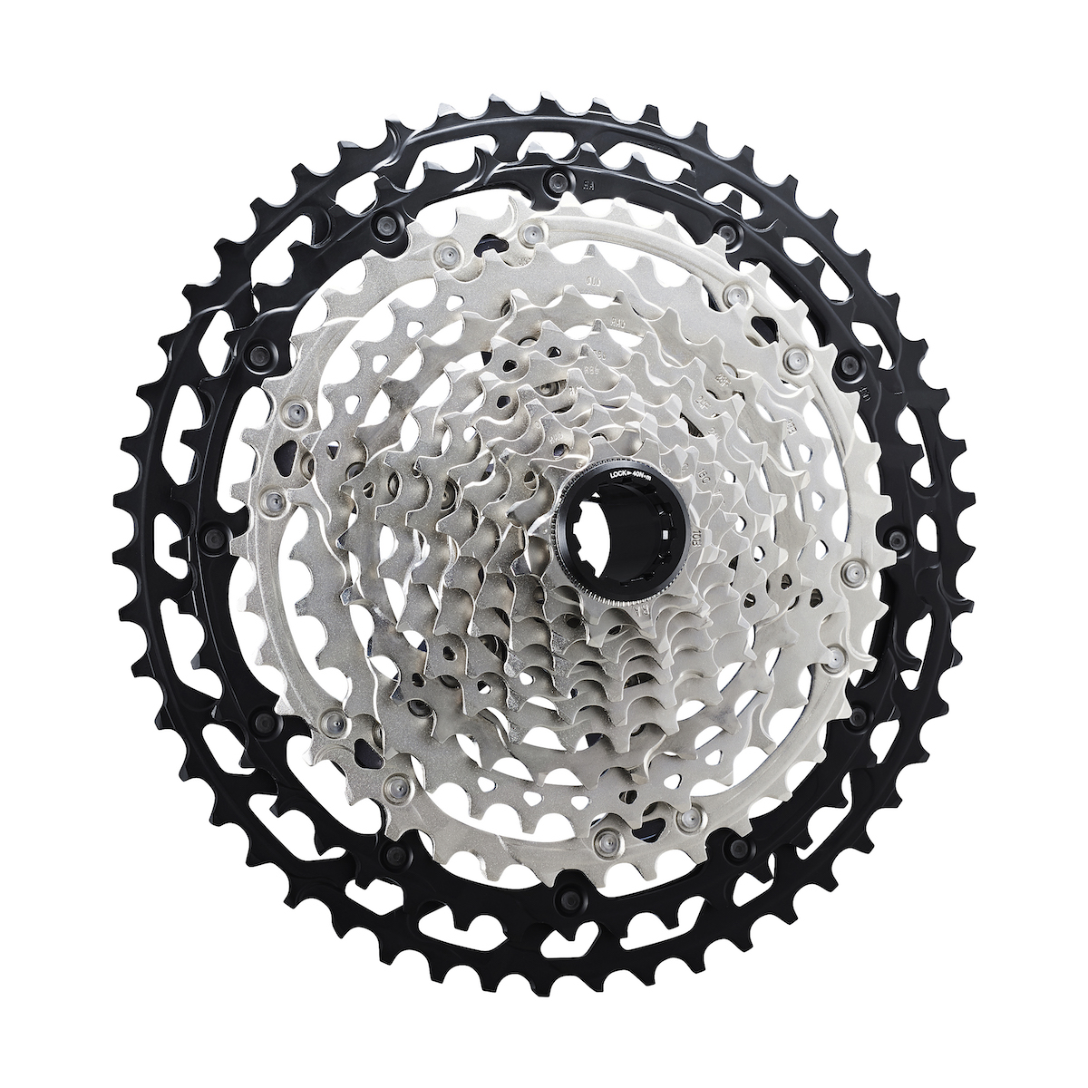

Cassette: SLX12-speed cassettes come with the MICRO SPLINE fitting system and are available in a 10-45T option for small gear steps or a 10-51T option for maximum range. Both cassettes also feature HYPERGLIDE+, allowing for quick up and downshifts and an extremely quiet drivetrain. The cassettes have an aluminium spider to house eleven steel sprockets and one aluminium sprocket for the best balance of durability, weight and riding styles. The CS-M7100-12 10-51T cassette weighs 534g and the 10-45T option weighs 513g
Chain: The SLX new 12-speed HG chain has been redesigned with an extended inner plate to improve chain engagement and retention and comes with SIL-TEC roller link plates for smoother running and more durability in all conditions.The CN-M7100 chain (113 links + Quick Link) weighs 252g.

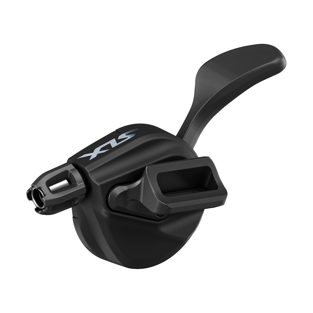

Shifters: With side adjustment and rotational adjustment options the ISPEC-EV shifters, which bolt neatly to the brake lever, offer solutions for tailoring the riding feel. For riders using a 2×12 set-up, a MONO lever (SL-M7100-IL) on the left shifts the front derailleur both up and down with an extremely light and precise action. SLX M7100 shifters are also available in a clamp band version. Shifter weights: SL-M7100-IR: 121g, SL-M7100-IL: 73g.

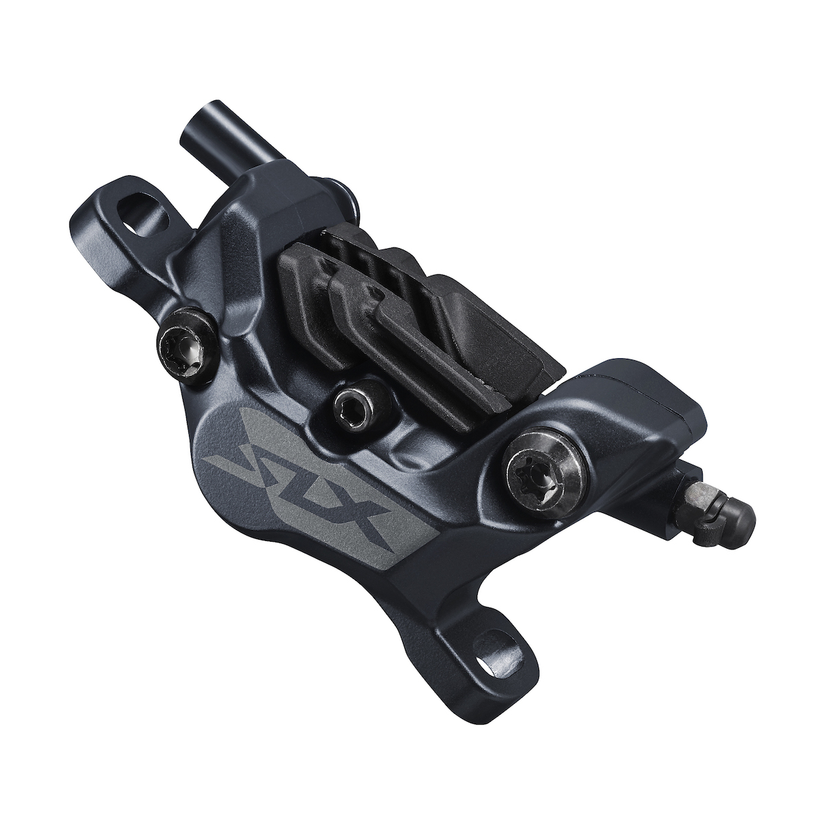

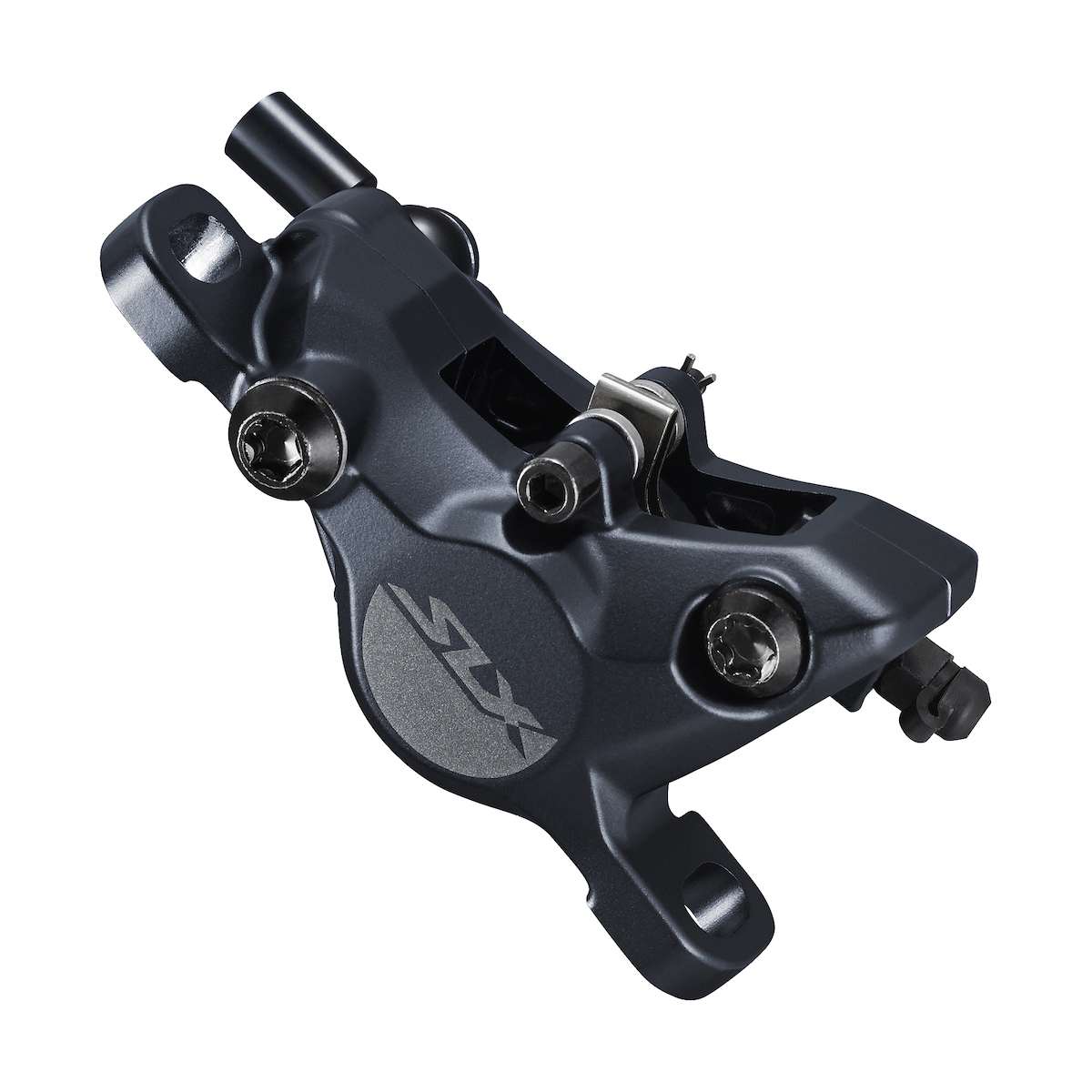

Brakes: SLX brakes calipers are available in an XC-specific 2-piston version or a Trail/Enduro 4-piston version.The 2-piston version shares the same design as the previous version, which means the previous SLX-level G02S/J02A resin brake pads or G04S/J04C metal pads brake pads are compatible, whereas the 4-piston version is a new completely new construction drawn from the XTR M9100 design, using D03S (resin) or D02S (metal) brake pads pad (compatible also with N03A and NO4C finned pads).
The SLX brake levers work with both the XC and Trail/Enduro calipers and come equipped with Shimano’s Servo wave system for quicker engagement, improved power and a shorter free stroke. The brake levers are now angled in two positions against the handlebar for a stiffer brake sensation. The levers also feature a reach adjust dial for simple brake tune-ups on the trail.
XC style brake kits (BR-M7100-BL-M7100) with rotors (160 mm SM-RT70) and brake pads weigh 425g and the Enduro style brake kits (BR-M7120-BL-M7100) weigh 444g including rotors and pads.

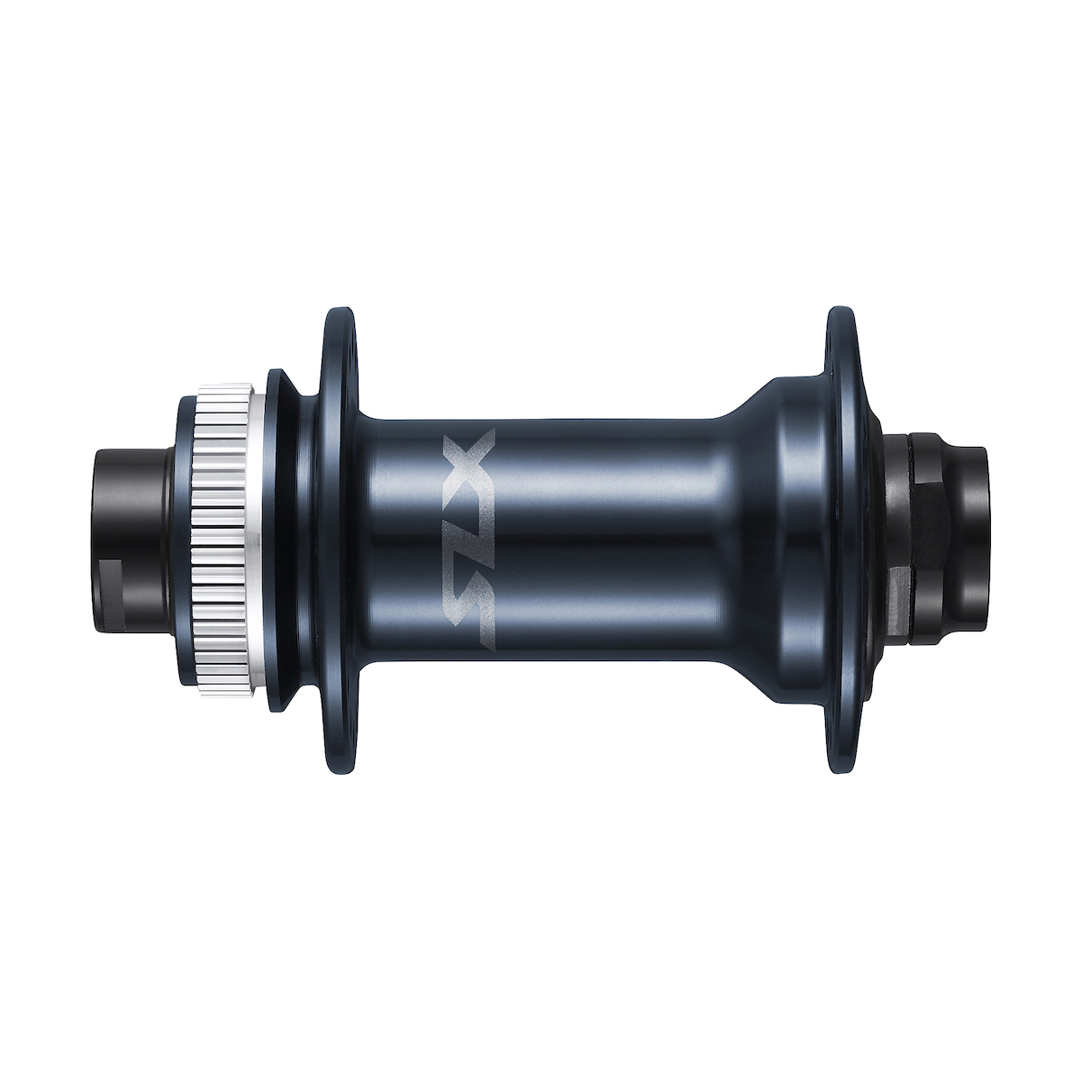

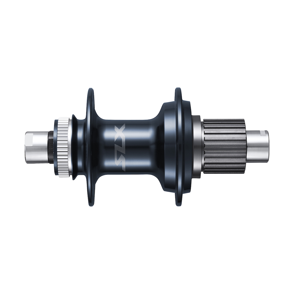

Hubs: Individual SLX front hubs and rear FREEHUBs are available in widths of 100mm and 142mm, 110mm and 148mm, or 157mm. The freehub (FH-M7110) features a cassette body with Shimano’s MICRO SPLINE design. Hub weights: HB-M7110: 142g, HB-M7110-B: 147g, FH-M7110: 350g, FH-M7110-B: 354g, FH-M7130-B: 359g.
