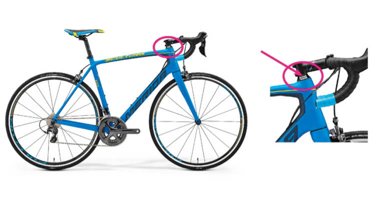

How can you see if your fork is affected?
The affected forks are limited to two model numbers and one production code. The details can be found on a sticker with QR-code that is visible when the stem is removed and the fork has been taken out of the frame.
FK-CF1638 (model number – rim brake version) or
FK-CF1638D (model number – disc brake version)
A-0-UD production code
Only forks with either of the two model numbers as well as the production code are affected.
Not affected forks – markings on the replacement forks
If there is a different number on the sticker on your MERIDA carbon fork steerer than the fork is not affected and has passed all safety tests.
