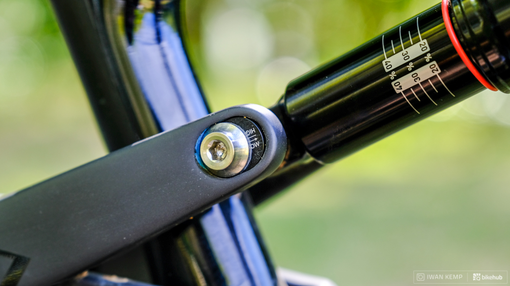

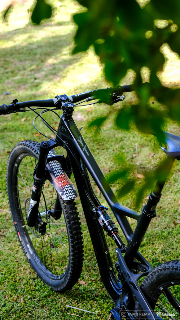

YT’s 29er Jeffsy has been part of our long term fleet since February and has been put through its paces on a variety of trails during the test period. For those who are not familiar with the Jeffsy 29, it is a 140mm 29er trail bike with geometry that can be adjusted using a flip chip that changes the bottom bracket height, head angle, and seat tube angle.

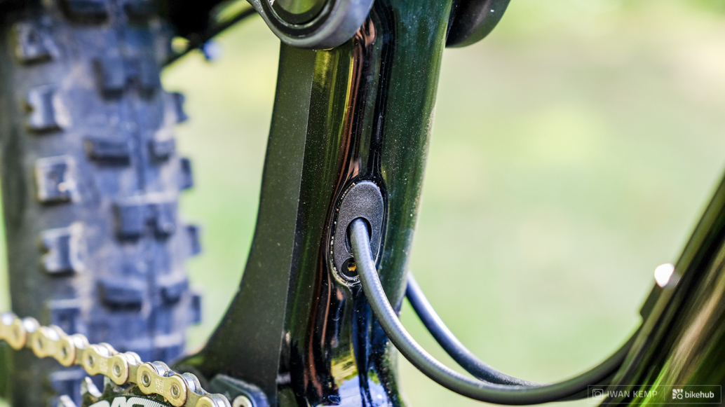

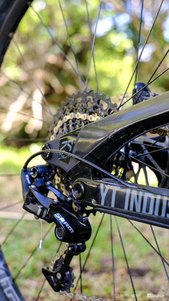

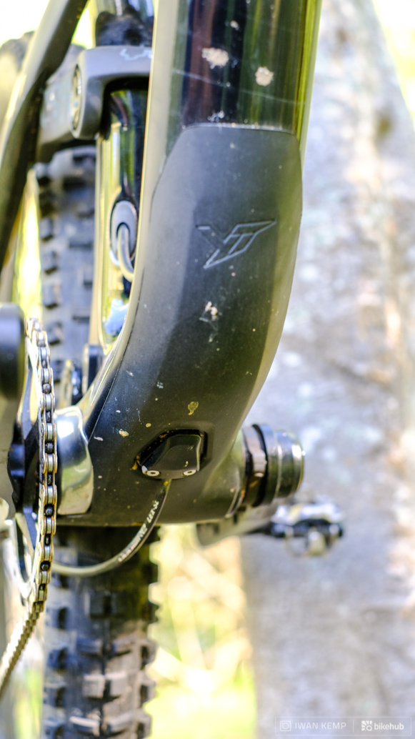

As has become standard, the Jeffsy boasts Boost 148 rear axle spacing. Cable routing is mostly external apart from the dropper that enters the seat tube just above the bottom bracket junction, and the rear derailleur cable which runs internally. Fortunately, the other cables run neatly on the top of the down tube with guides doing a good job of keeping them in place and minimising excessive rub.

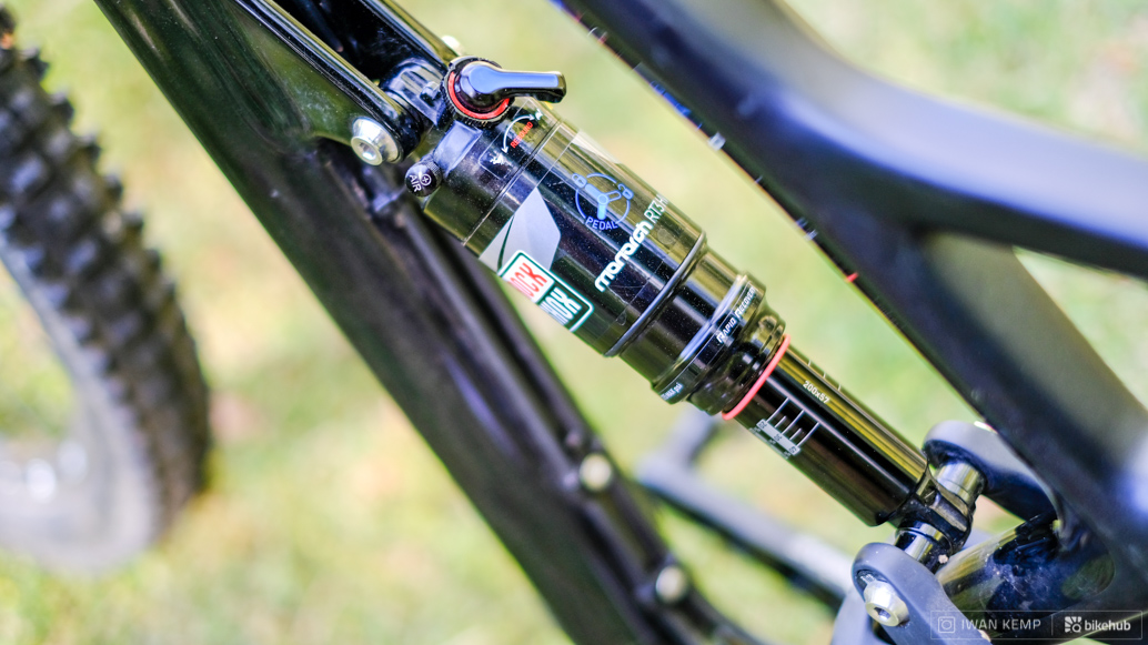

As with their Capra and Tues, the Jeffsy makes use of a Virtual 4 Link suspension system that has a progressive suspension design with easy movement through the mid travel and support ramping up close to the end of the range. Unlike the Capra, there is no strut between the downtube and seat tube supporting the linkage. The rocker link bolts are also very neatly hidden under the seat stay. This has freed up some space in the front triangle to fit a small, proprietary water bottle and mount. The mounting and bottle can be added to the bike at checkout and did not come with our test bike.

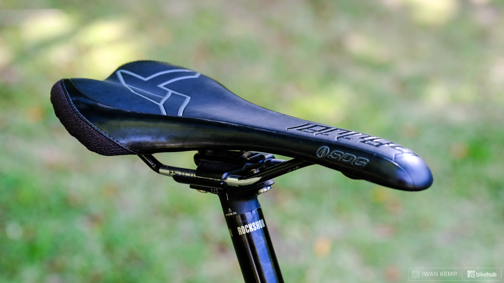

The saddle has proven itself incompatible with my body. I’m not one to shy away from a low profile saddle but, even though I have owned one before, the SDG Circuit was not my idea of a day’s fun in the sun. It was simply too narrow and hard and became uncomfortable on longer rides. I first tried Specialized’s Power saddle and then their Henge Comp – both of which were comfortable, with the Henge staying on the longest. I have since put one on my Knolly Warden as well.

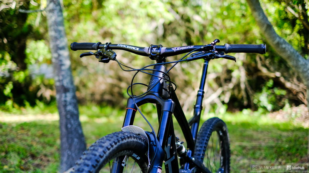

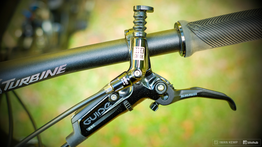

The Rockshox Reverb lever sits in an awkward place. I prefer it to be on the left-hand side below the handlebar, as it is quite a bit easier to push and actuate the dropper without too much movement in your hand. Swapping this out will only follow a wheel upgrade and while I’m at it, I will most likely change it out for RockShox’s 1x remote lever.
The Race Face Love Handle grips are quite thin and I found them tiring on longer rides. These made way for a set of ODI Rogue grips I had in my spare stash. These were then replaced by SDG Hansolo Lock-On Grips which are also manufactured by ODI. I found these to be a perfect match for all-day rides as well as the shorter, more technical blasts that the Jeffsy is capable of.

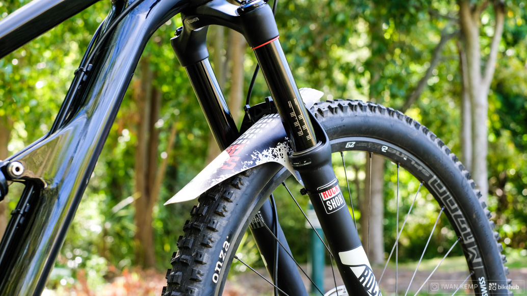

With the wheels the only exception, the bike arrives kitted out ready to ride. Great tyres, nice wide bar with a short stem, solid suspension in the Pike fork and Monarch shock, and a dropper seatpost as standard. Simply put, the bike comes very well specced straight out of the box, and even more so considering the asking price and capability.

The YT Jeffsy does a remarkable job of being capable and well-balanced in both the high and low geometry settings. You won’t hate climbing and just riding along in the low setting and you won’t loath descents and technical sections in the high setting. Some bikes, when dropped to the low setting and fully geared towards descending, are a real battle with climbing and/ or pedal strikes. Conversely, some bikes in the high setting actually feel too upright, which leads to a drop in confidence when railing corners. Although the differences, and certainly the benefits of each setting can be felt, the bike is competent in either setting.
It is a capable climber and makes light work of climbs even with the all-mountain Onza Ibex tyres. I settled on a shock setup that leaned towards plush, running 25% to 30% sag. This had me using platform damping on my way to the top on longer rides.

As mentioned in my 3-month update, the only reliability niggle I’ve had was with the SRAM Guide RSC brakes that suffered a technical issue. Since they have been warrantied they have been faultless and performed as expected. The rest of the bike has been as reliable as man’s best friend.
