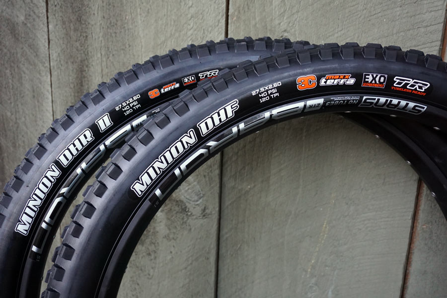

ccs-62657-0-84654200-1492450236.jpgMaxxis’s Minion DHR and DHF in 2.6 widths.

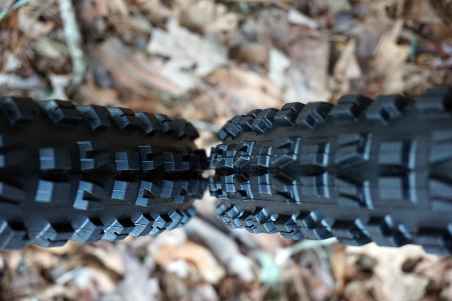

ccs-62657-0-02075900-1492450239.jpgThere is a 7% difference in volume between a 2.5 and 2.6 Maxxis tyre.

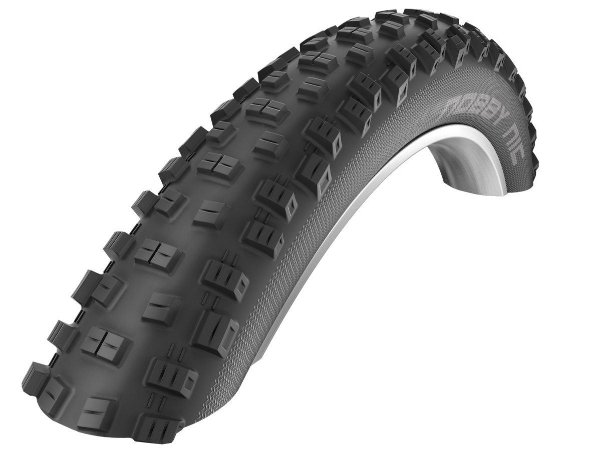

ccs-62657-0-08543700-1492450950.jpgSchwalbe refer to their 2.6″ Nobby Nic as a second generation plus-size tyre.
