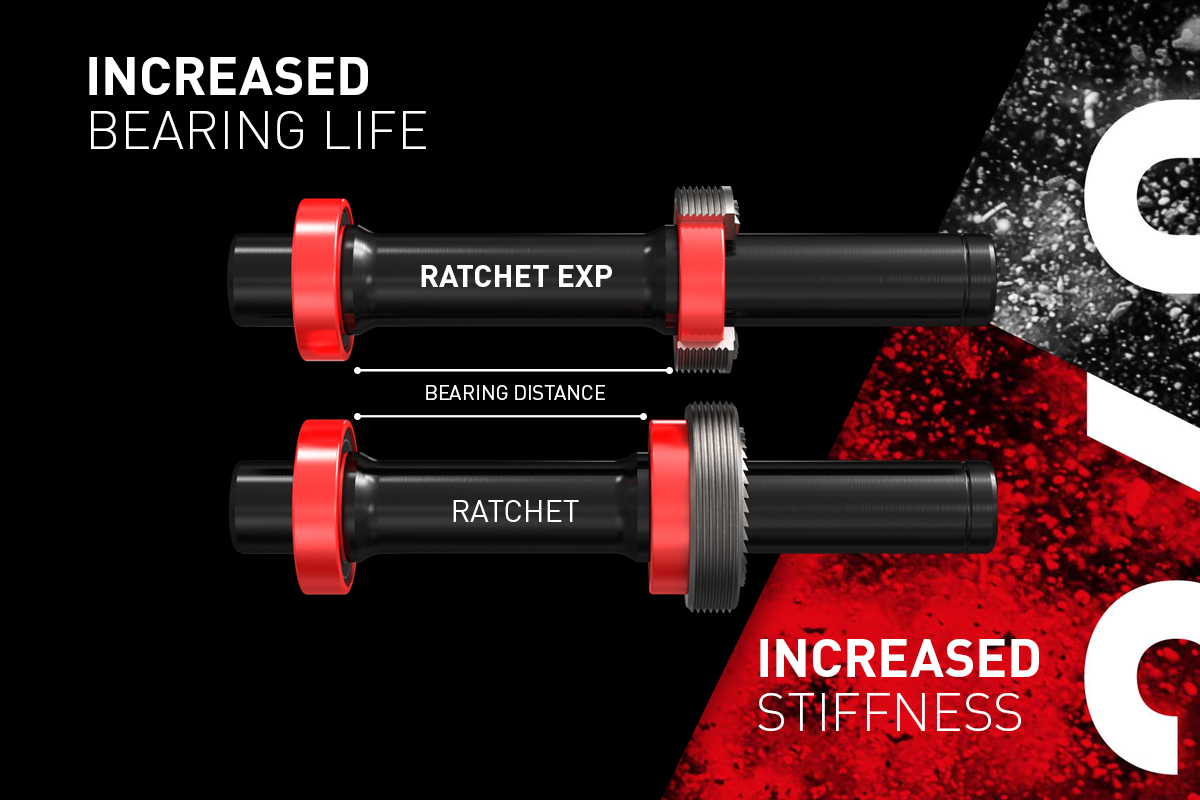

Increased Bearing Life
The integration of the bearing into the threaded ring allows the bearing distance to be maximised. The increased distance further supports the axis, which results in less deflection of the axle and thus protects the bearings and increases their lifetime.
Increased Stiffness
The bearing distance is limited by the size of the freehub system. In the previous system, the drive side bearing had to be placed next to the threaded ring which meant that the distance could not be increased.
The integration of the drive side bearing into the threaded ring increases the bearing distance, resulting in a 15% improvement of axle stiffness.

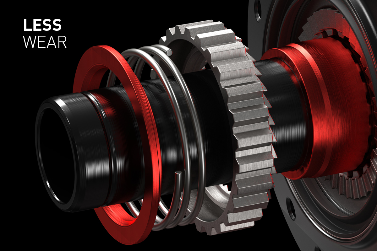

Less Wear

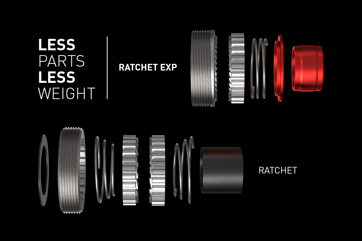

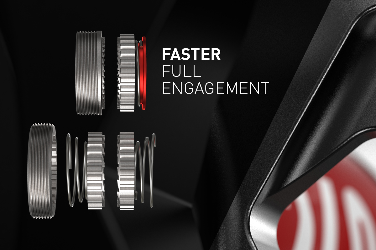

A single cylindrical spring ensures the faster full engagement and thus increases reliability.
Faster Full Engagement
The previous system required two conical springs to ensure proper alignment of the two ratchets. The fixed connection of the inner ratchet of the RATCHET EXP with the hub shell allows to use only the one cylindrical spring to ensure proper alignment of the moving ratchet. This Results in a faster full engagement that eventually reduces wear. On top of this, like it’s 180 cousin, the new 240s hubs will all come with 36 tooth ratchets as standard for 10 degrees of engagement.

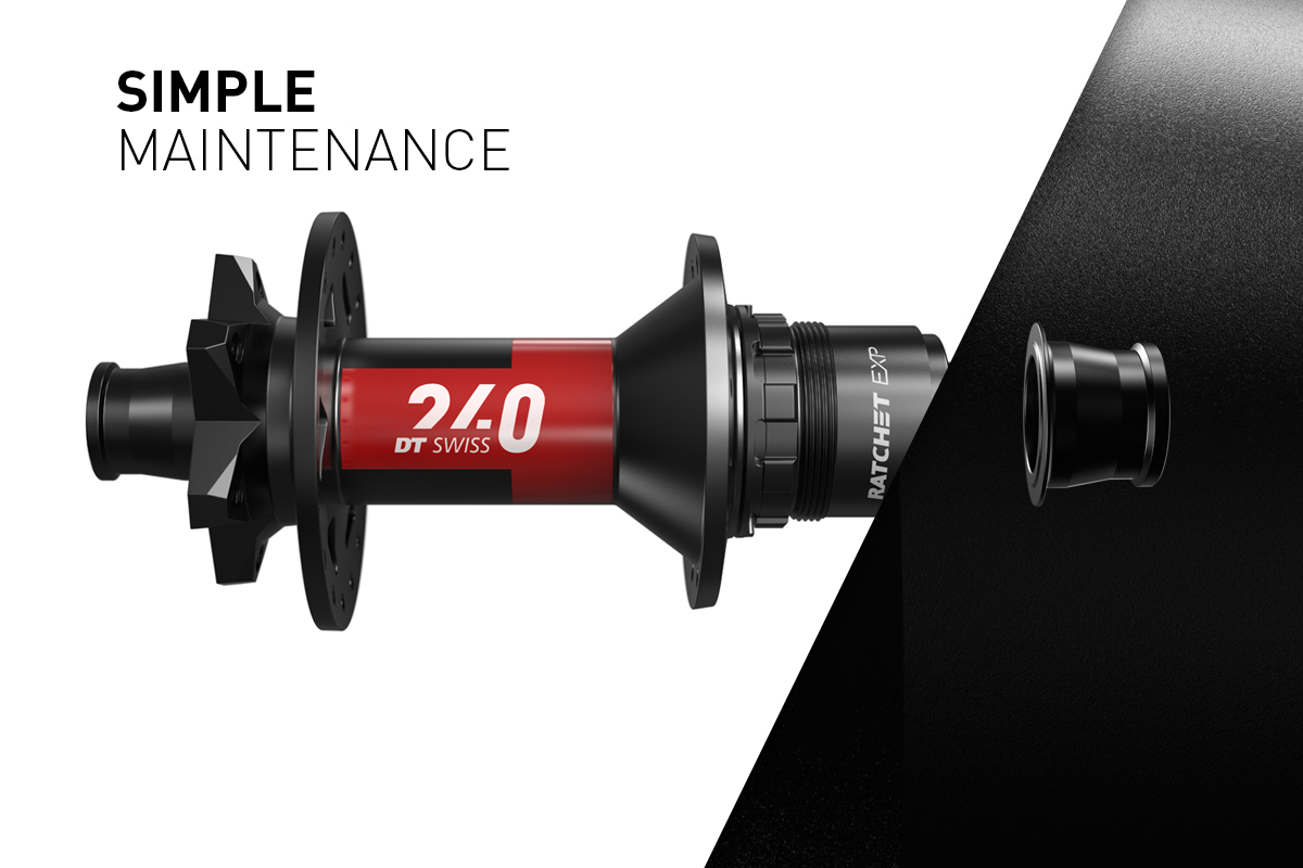

Simple Maintenance
The no-tool concept allows for tool-free disassembly. Featuring an incorporated notch, the newly developed shape of the end caps simplifies disassembly significantly and therefore makes the maintenance even easier.

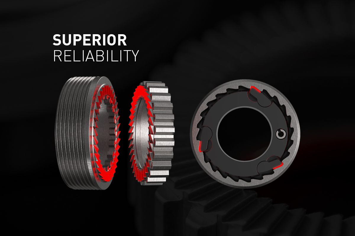

Superior Reliability
The full engagement of the ratchets creates a large contact surface and therefore a low surface pressure that leads to superior reliability.
What makes the Ratchet and Ratchet EXP Systems superior is the fact that all the teeth on each of the ratchets engage simultaneously every time. In comparison, the engagement surface of pawl hubs is rather small.

Not only the reliability has improved though. The fusion of ratchet and threaded ring reduces the number of single parts of the system that offers an important advantage.
Less Parts
The previous Ratchet system required two springs to function correctly as the inboard ratchet was not fixed to the hub shell. The fusion of the ratchet and the threaded ring in the Ratchet EXP hub not only increases durability, it also reduces the overall number of components, utilizing a single spring, resulting in a decrease in weight of the freehub system.
