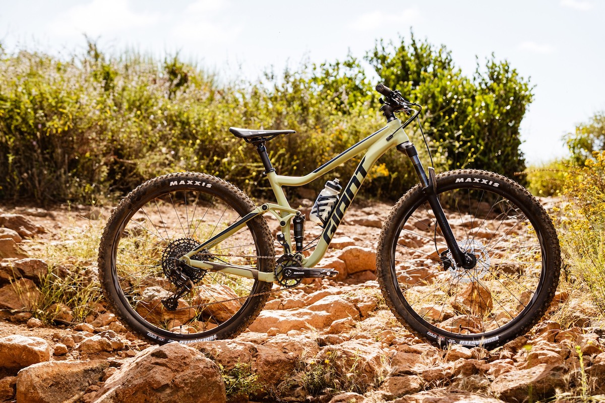

The all-new Stance 29 features progressive frame geometry that’s optimized for larger diameter wheels. The FlexPoint suspension system provides 120mm of rear wheel travel, and new “long and low” geometry includes a 67.5-degree headtube angle and 75-degree seattube angle—a combination that optimizes the roll-over capabilities and momentum of the bike’s 29-inch wheels.
The new frame is also designed around a 130mm suspension fork for added control on technical trails, and all models in the Stance 29 series feature Giant WheelSystems and tires with tubeless technology right out of the box.

Giant Stance 29 2
The Giant Stance 29 2 (pictured above) will be available in South Africa later this week.
