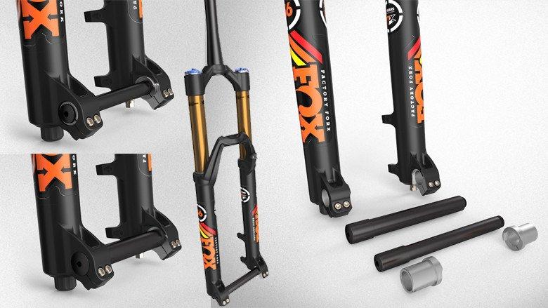

The model year 2015 36 offers rigidity and improved traction for all-mountain riding and Enduro racing in a new lighter chassis. Also of note is its updated geometry, new convertible thru-axle design that works both with 15mm and 20mm, purpose-built RC2 damper, and redesigned air spring system that equalizes rider weight for increased traction.
  • Lighter: half-pound weight savings over its predecessor (starting at 4.19lbs/1901g)
  • 36-specific RC2 damper: redesigned valve system provides better small bump compliance, reduced friction, better traction, and wider tuning range
  • Redesigned air spring system: equalizes rider weight for increased traction
  • Convertible thru-axle design: works with 15mm and 20mm axles

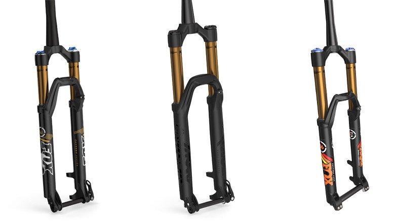

Stealth FLOAT Forks – for a limited time, FOX is offering three blacked out FLOAT fork models with stealth black decals and black anodized knobs.
  • 32 29”/100mm CTD w/Trail Adjust
  • 34 27.5”/160mm CTD w/Trail Adjust
  • 40 26”/203mm RC2
