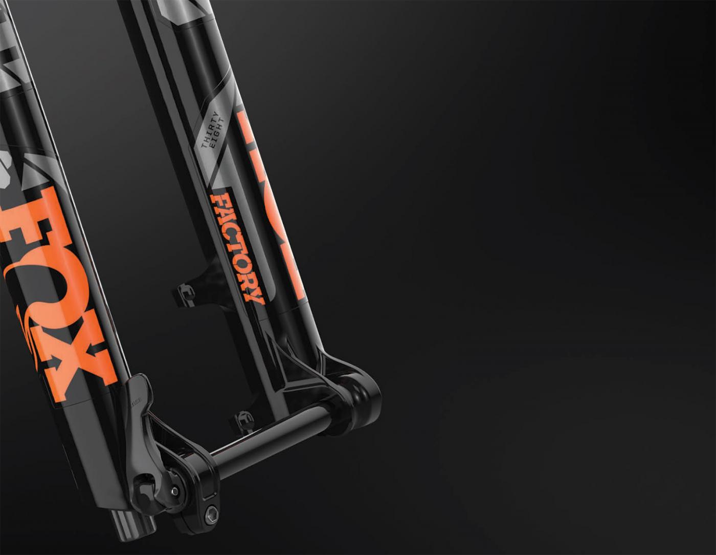

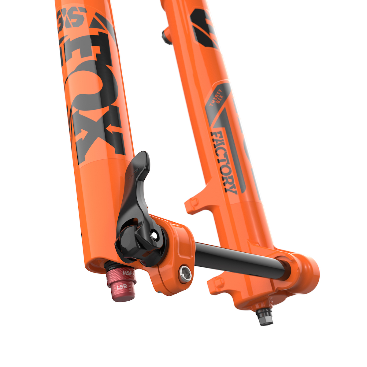

Floating Axle
Floating axles might look similar to other axles, but in fact they offer a distinct performance advantage due to their unique ability to match the exact width of the fork’s wheel mounting surface precisely to the front hub flange spacing, thus creating perfect chassis alignment and eliminating unwanted friction between the upper and lower fork legs. Floating axles provide much smoother suspension movement throughout the entire range of the fork’s travel, notably improving sensitivity and overall ride quality.
The all-new 36 and 38 come equipped with a new quick-release lever operated patent-pending floating axle system, combining the benefit of a floating axle with the ease of a tool-free quick-release. With this system, spacing is locked in via a floating sleeve, allowing repeated front wheel removal and reinstallation while maintaining perfect fork alignment. Floating sleeve positioning comes preset from the factory so if you are unsure of how to operate the floating axle system or simply don’t want to bother with it, you can just install the front wheel and get on with your ride.
Available optionally is the new Kabolt-X, a lightweight bolt-on floating axle exclusively for the all-new 36 and 38 that not only shaves grams but also increases torsional stiffness via its sleeveless, single-sided pinch bolt design. The all-new 40 utilizes a double-pinch bolt floating axle design to provide maximum stiffness for Downhill racing applications. Chassis alignment must be reset each time the front wheel is removed and reinstalled on both the Kabolt-X and 40 floating axles, but the end result is the same – perfect alignment and perfect performance.

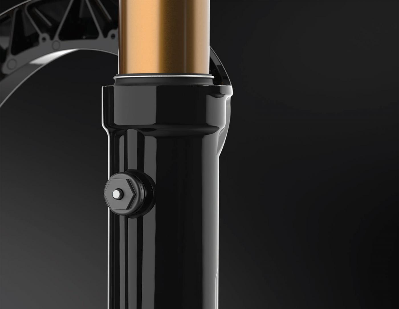

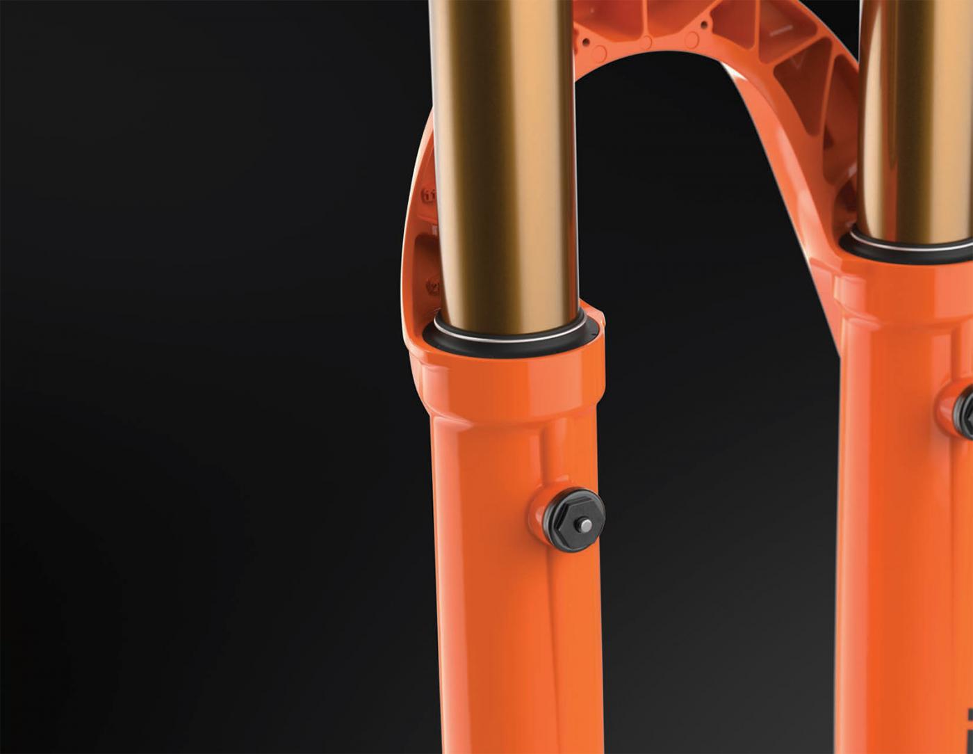

Bleeders
Our lower leg bleeders allow for atmospheric pressure equalization at the simple press of a button. Pressure build-up in the lower legs dramatically decreases fork performance, preventing full travel from being achieved, and diminishing small bump sensitivity and responsiveness.

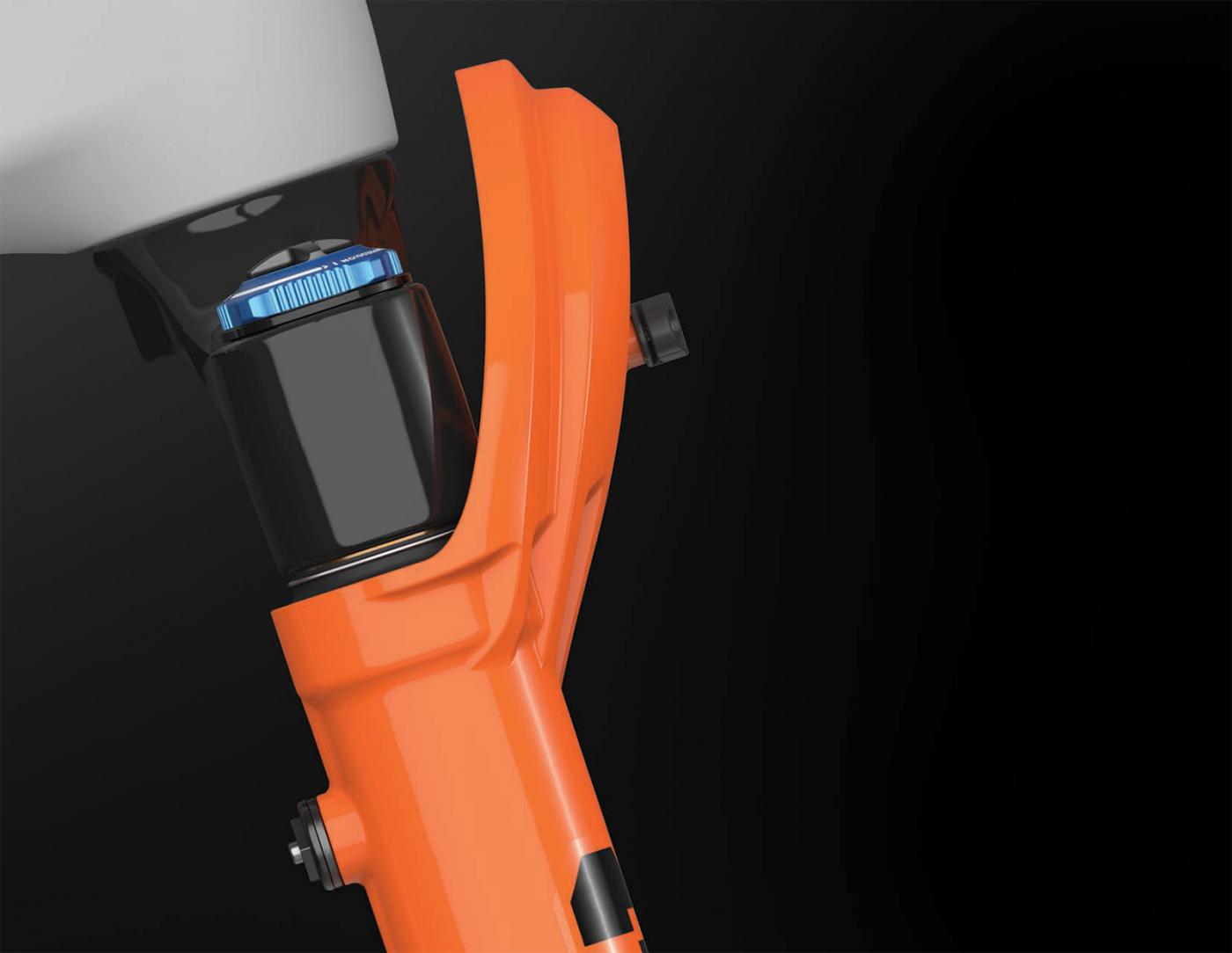

Lower Leg Arch
Stiffness-to-weight is the ultimate metric for bicycle design. Engineers invest countless hours poring over every ounce of material in an effort to optimize this critical ratio. The all-new 38 pulls out all the stops, shaving every possible gram while making sure not to compromise stiffness or strength requirements of modern, hard-hitting long-travel Enduro riding.
Modern frame designs and geometry trends require modern suspension design solutions. The arch design of the all-new 36, 38, and 40 is designed to pair perfectly with modern Enduro and Downhill bikes. Head tube profiles have grown larger and larger, and fork offsets shorter and shorter. Our new arch shape takes this need into account by jutting forward to provide ample headtube clearance at full compression. State-of-the-art computer modeling techniques helped us to create an organic lower leg shape that optimizes stiffness with the absolute minimal amount of material.

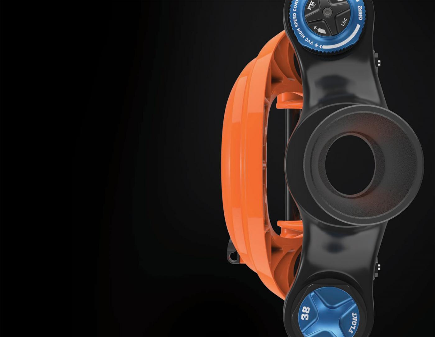

Elliptical Steerer (38 ONLY)
The 38’s elliptical steer tube is one of many ways we’ve further optimized stiffness-to-weight, placing more material only where it is needed, and eliminating every ounce of it where it’s not.

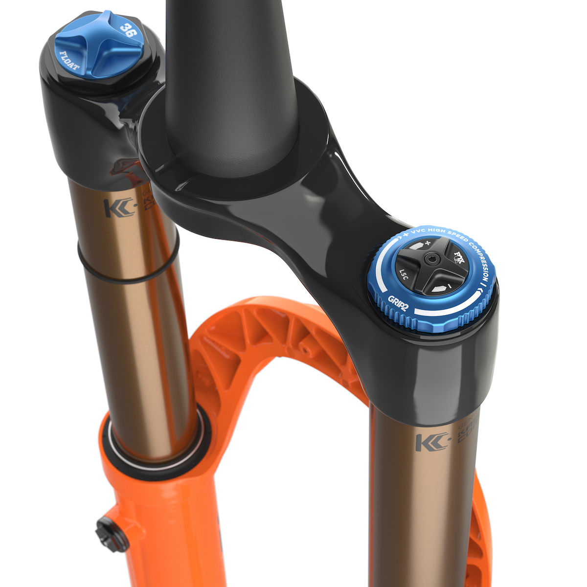

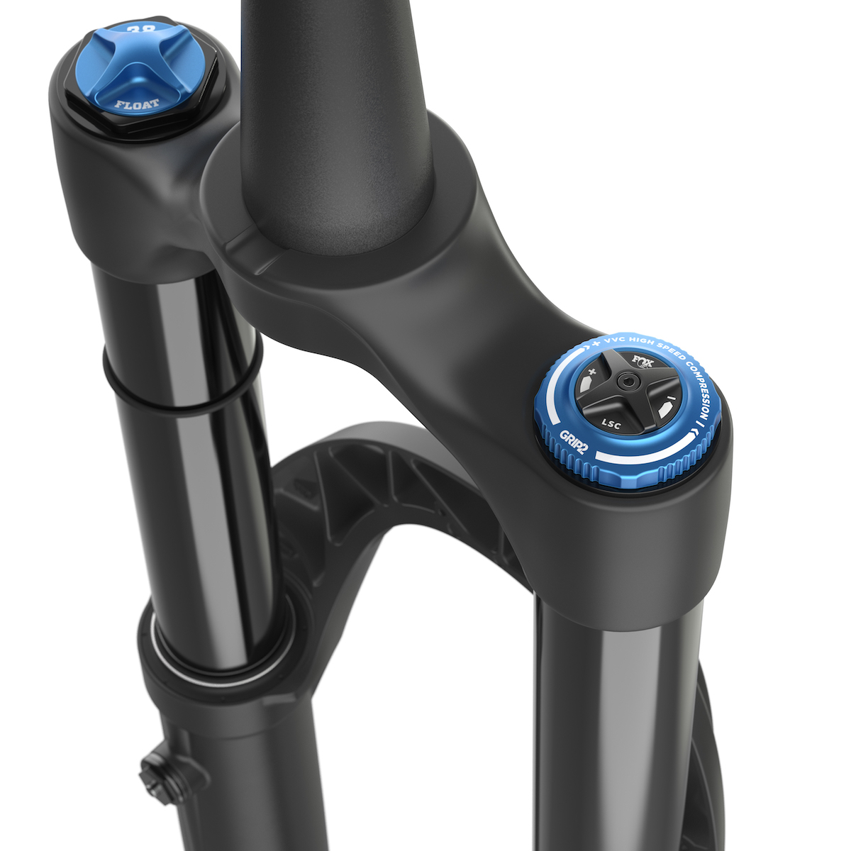

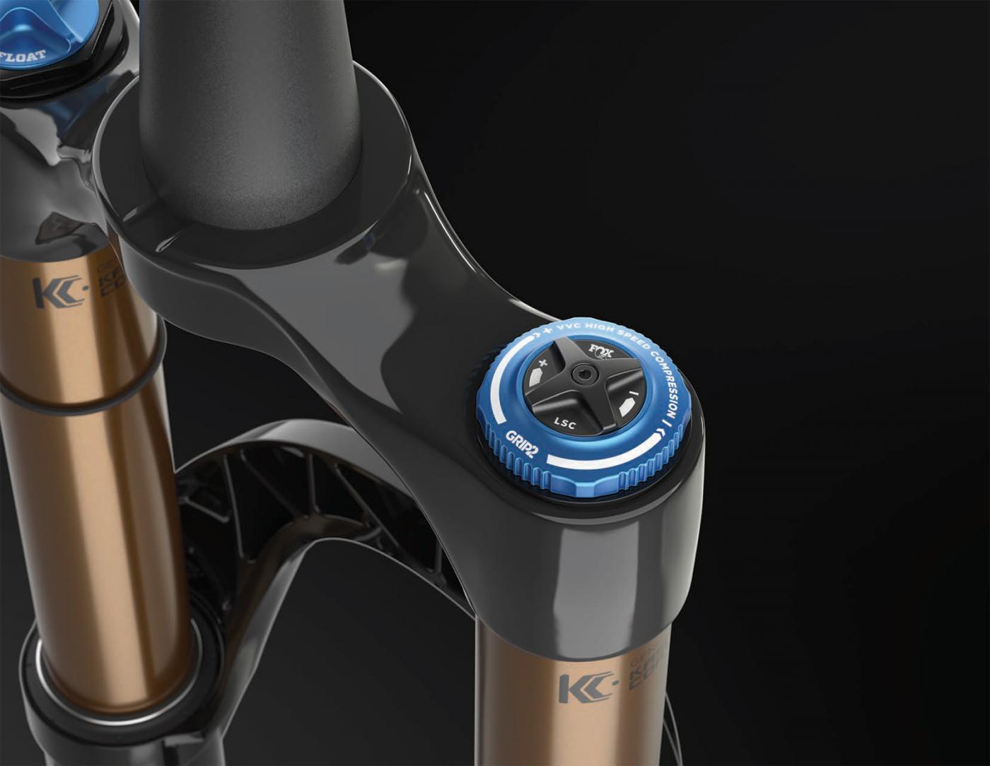

GRIP2
Our GRIP2 damper is the benchmark for unparalleled ride quality and ultra-precise on-the-fly adjustability. For 2021, we’ve taken GRIP2 to the next level by adding our patented VVC technology to the compression circuit. VVC is a proprietary variable valve control system that allows for external fine-tuning of suspension performance. GRIP2 achieves with the twist of a knob what typically requires the time consuming and complicated task of completely disassembling and reassembling the fork.
FLOAT EVOL
EVOL technology increases negative air spring volume, optimizing small bump sensitivity. EVOL’s linear spring curve delivers plushness off the top, extra mid-stroke support, and more tunable bottom-out progression.
The benefits of EVOL are further enhanced by our new Lower Leg channels and Bleeders, which both function to reduce air pressure captured in the lower legs, allowing the EVOL air spring to operate freely without unintended interference.

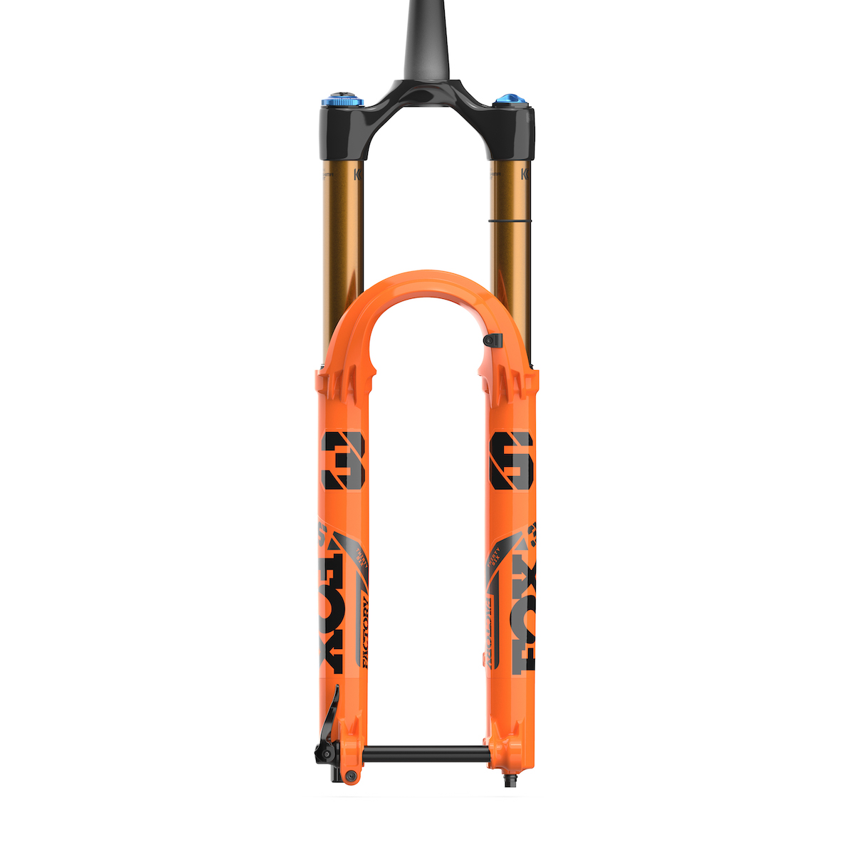

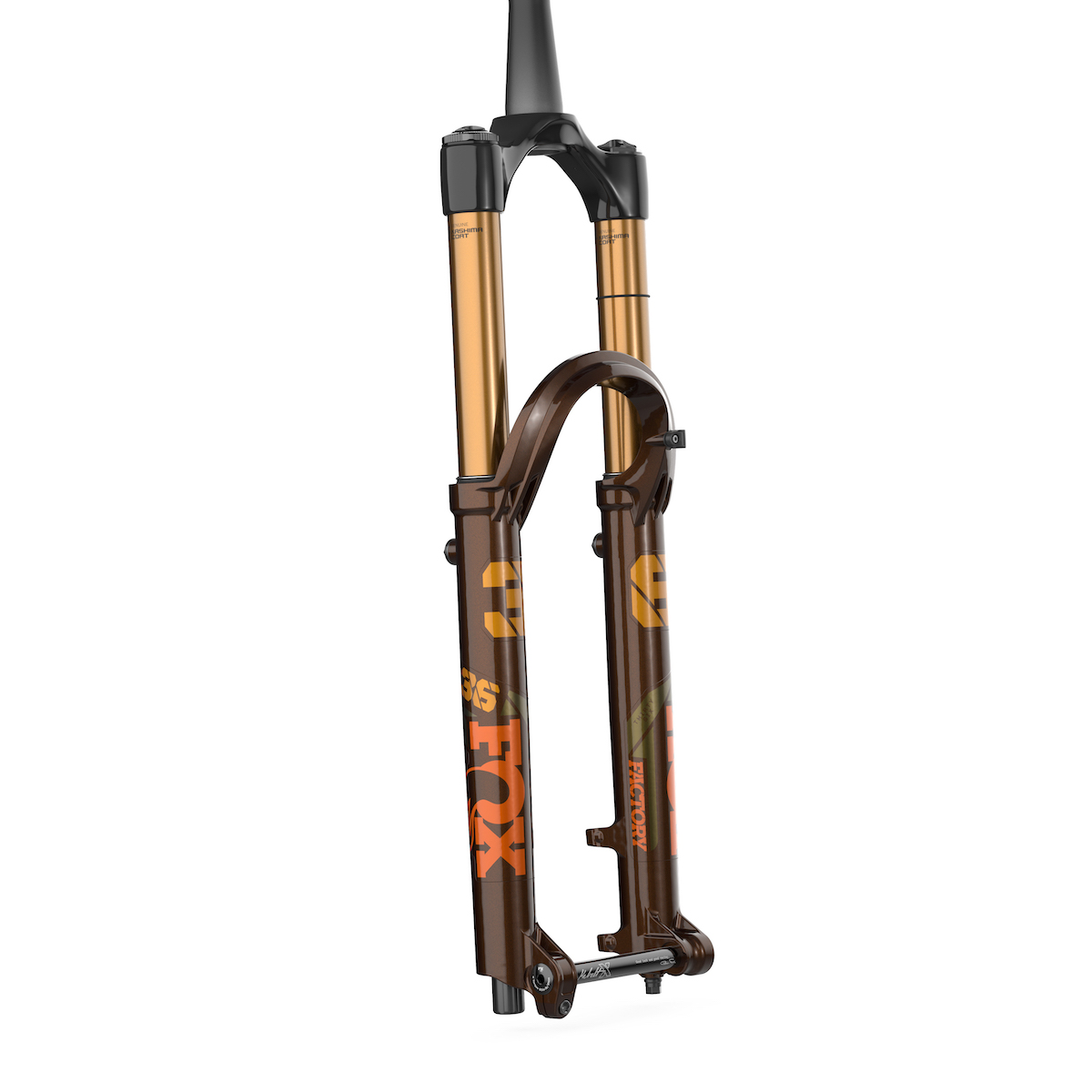

ALL-NEW 36
The new enduro fork standard is anything but standard. With all new design inside-and-out, plus an unmatched combination of ride quality, tunability, stiffness, weight, and alignment–we took the award-winning, EWS favourite and made it even better.
Specs:
  • ALL-NEW chassis
  • NEW lower leg bleeders
  • NEW air/oil channels
  • NEW floating axle
  • NEW arch shape offers improved head tube clearance with shorter rakes
  • Matching 8-click HSC and HSR adjustment on GRIP2 forks and X2 shocks
  • Damper option(s): GRIP2 with VVC, FIT4, Live Valve, GRIP
  • Updated EVOL air spring
  • Travel option(s): 150mm-160mm
  • Increased crown diameter to match modern frame shape profiles
  • Wheel size(s): 27.5″ and 29″
  • Offset(s): 37mm, 44mm and 51mm
  • Optional mud guard
  • Factory Series models feature Genuine Kashima Coat
  • Available in Factory, Performance Elite, and E-Bike models
  • Starting weight: 1965 g
  • MSRP USD $849 – $1099 / CDN $1129 – $1449 / EUR €1339 – €1459

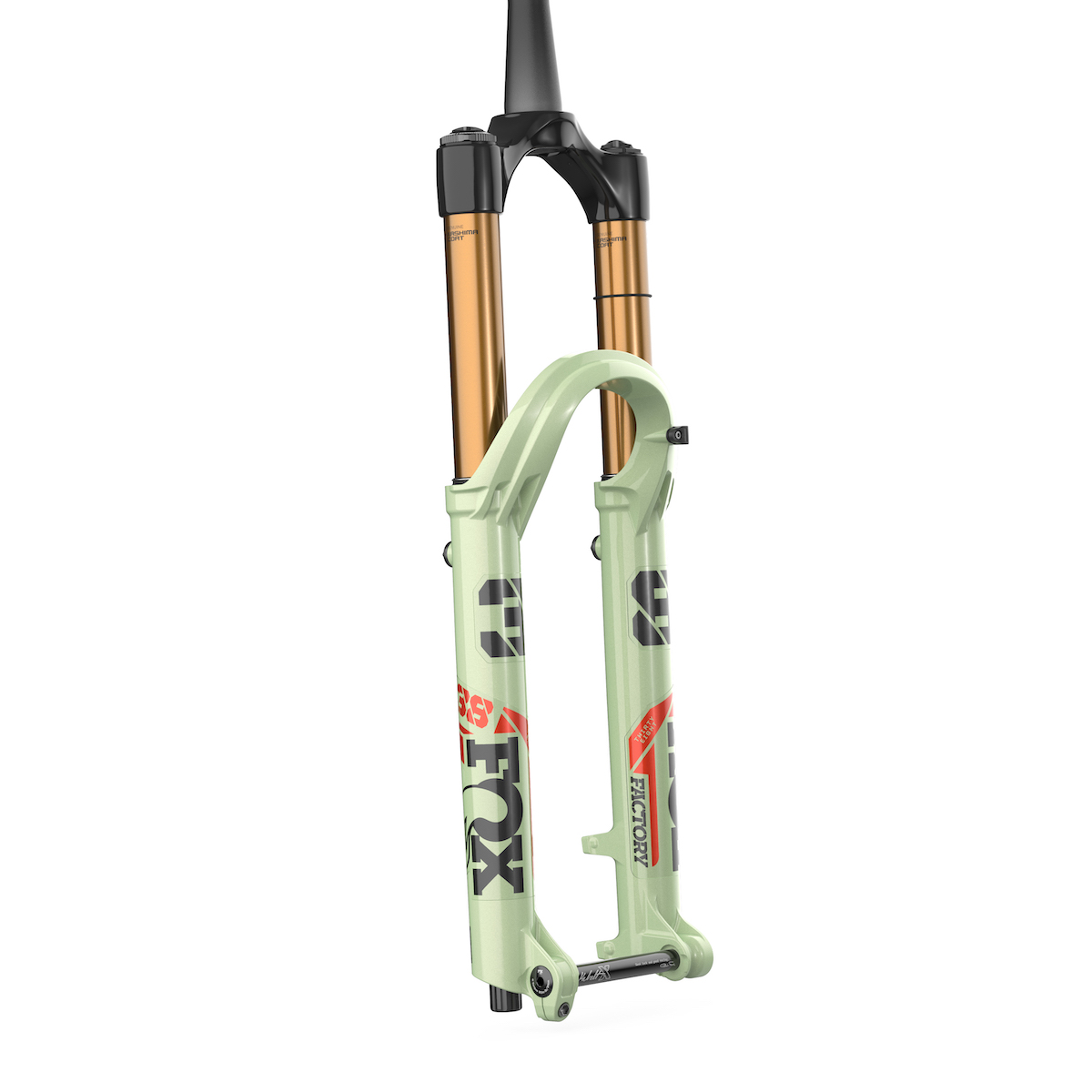

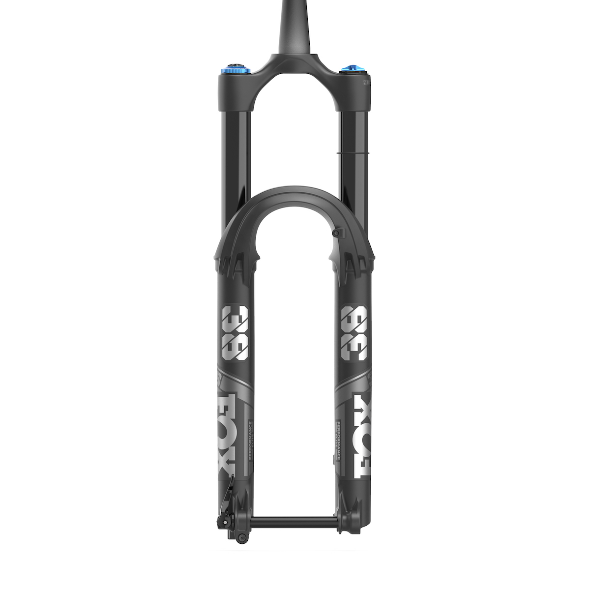

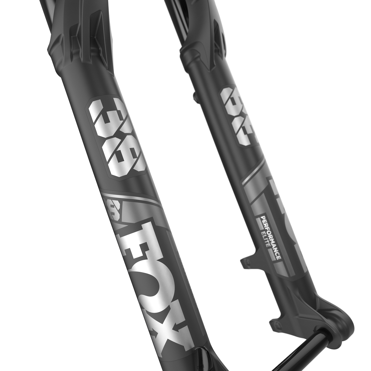

ALL-NEW 38
All the revolutionary features of the brand-new 36 packaged in a super-stout chassis engineered specifically for modern hard-hitting, long-travel enduro-style riding. The all-new 38 is hungry to devour all you can throw at it and ask for more.
Specs:
  • NEW elliptical steerer tube maximizing stiffness to weight
  • NEW floating axle
  • Damper option(s): GRIP2 with VVC FIT4, GRIP
  • Travel option(s): 160mm-180mm
  • 31% stiffer transverse shear, 17% stiffer fore/aft and 38% torsionally stiffer than 36
  • 58mm crown diameter to match modern frame shape profiles
  • Available in Factory, Performance Elite, Performance, and E-Bike models
  • Starting weight: 2180 g
  • MSRP USD $949 – $1199 / CDN $1249 – $1579 / EUR €1259 – €1589

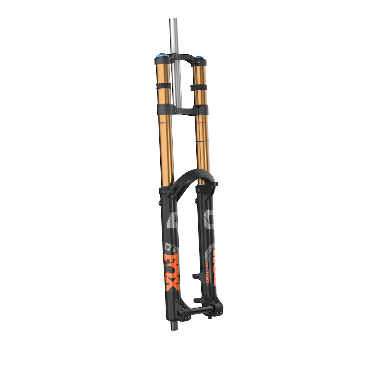

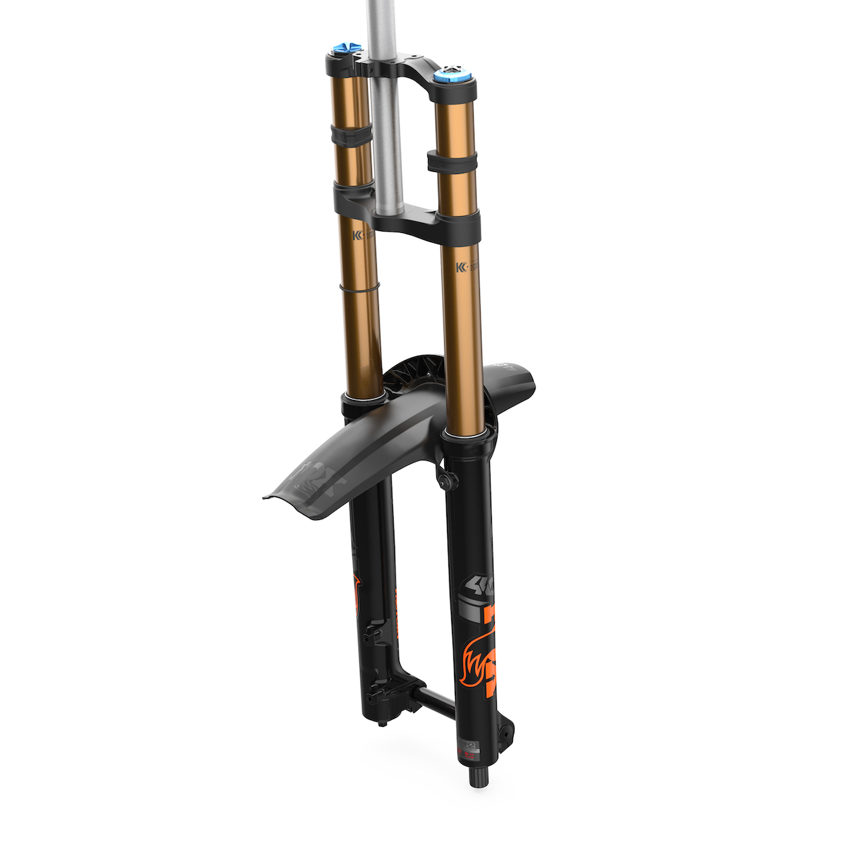

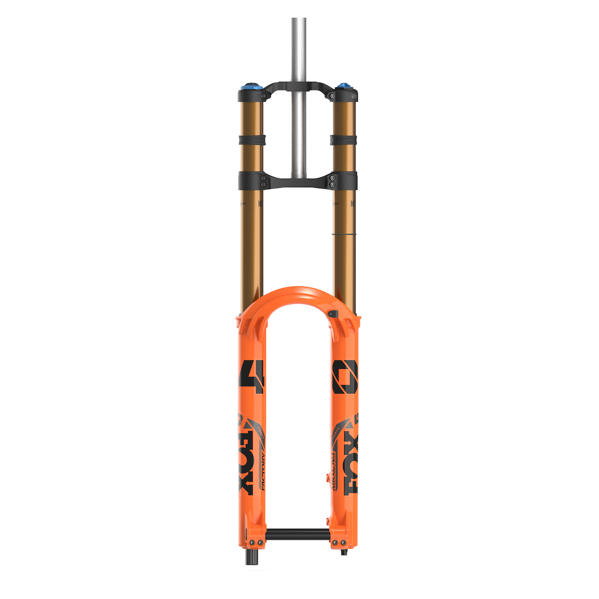

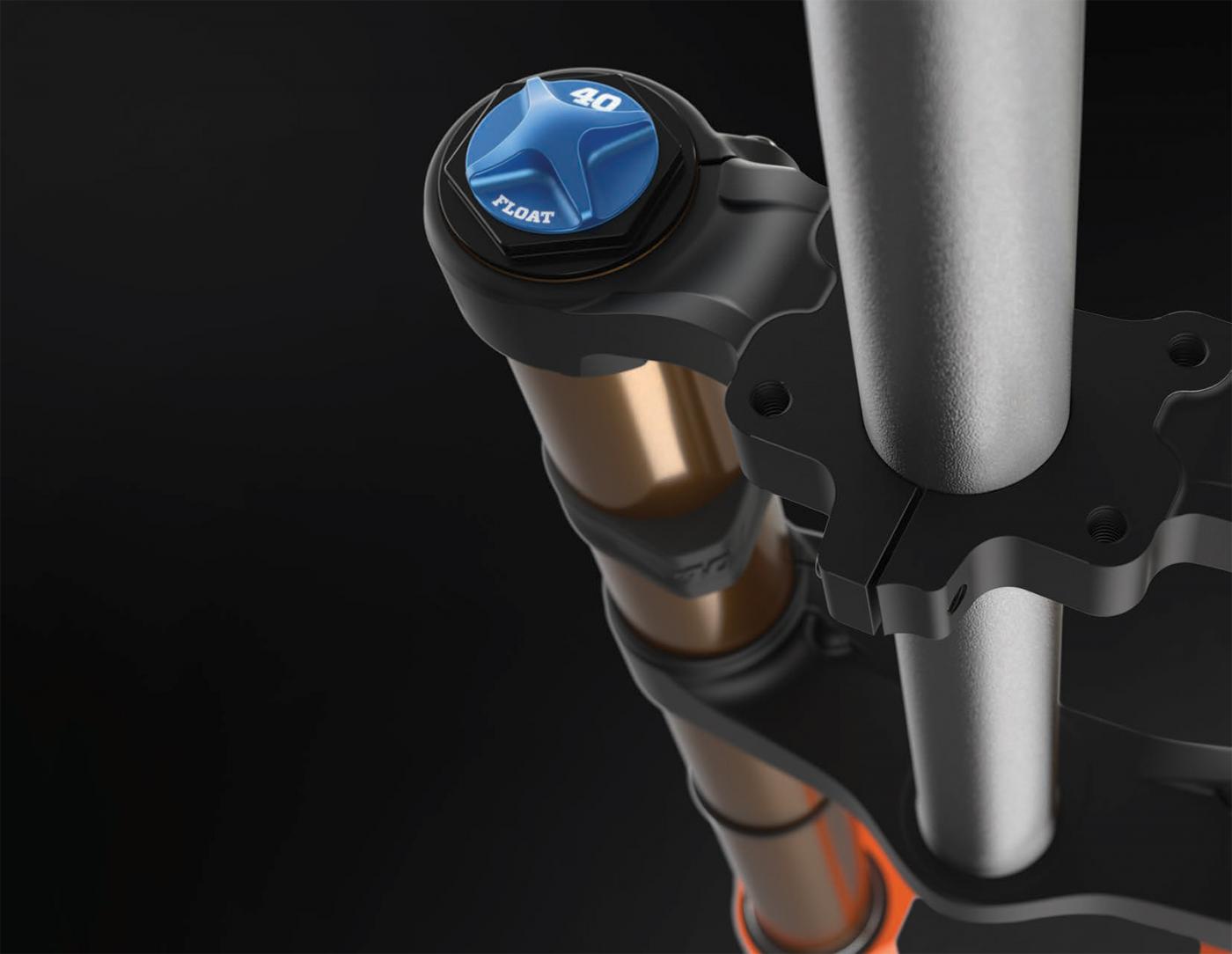

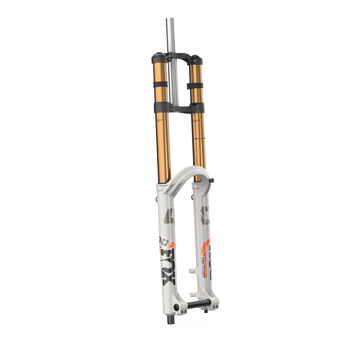

ALL-NEW 40
Completely redesigned for 2021, this world cup weapon has its sights set on the top step. Equipped with an updated version of our award-winning grip2 damper, an updated EVOL air spring, and a host of other radical new performance-driven features, the all-new 40 is ready to attack the track with ferocity.
Specs:
  • ALL-NEW chassis
  • Damper option(s): GRIP2 damper now with VVC (Variable Valve Control), GRIP
  • Pinch-bolt 20mm x 110mm floating axle
  • Travel option(s): 203mm
  • Offset(s): 48mm, 52mm and 56mm
  • Available in Factory Series
  • Starting weight: 2816 g
  • MSRP USD $1749 / CDN $2309 / EUR €2299

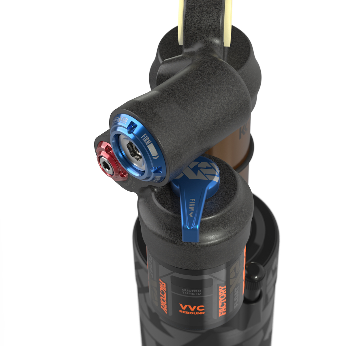

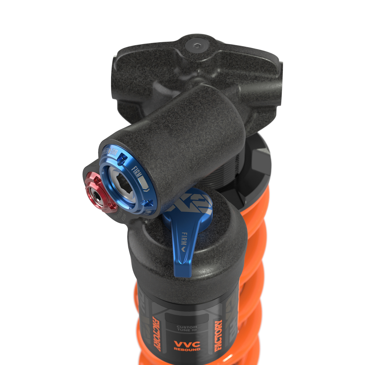

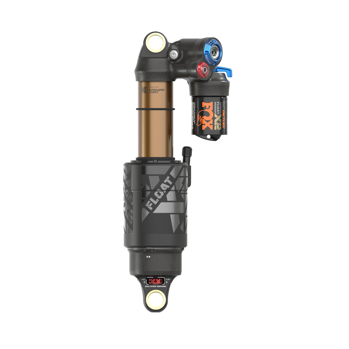

ALL-NEW FLOAT X2
The all-new X2 changes everything, including the game. This award-winning, gravity-defying air shock holds nothing back, especially not you. Boasting a laundry list of advanced features, the Float X2 is ready to clean house.
Specs:
  • ALL-NEW chassis
  • NEW damper
  • NEW high-flow main piston
  • NEW progressive MCU bottom-out bumper
  • NEW HSR with VVC (Variable Valve Control)
  • Independent firm mode circuit – firmer lockout than previous Float X2
  • Ultra-low-friction, highly durable damper shaft finish
  • Improved bearing ratio for metric sizes
  • Reduced length reservoir for better fit on more frames
  • Finned inner body for improved structural rigidity and reduced hysteresis
  • NEW lower friction air seal
  • Updated compression ratios, 300psi max
  • MSRP USD $639 – $669 / CDN $789 – $879 / EUR €849 – €889

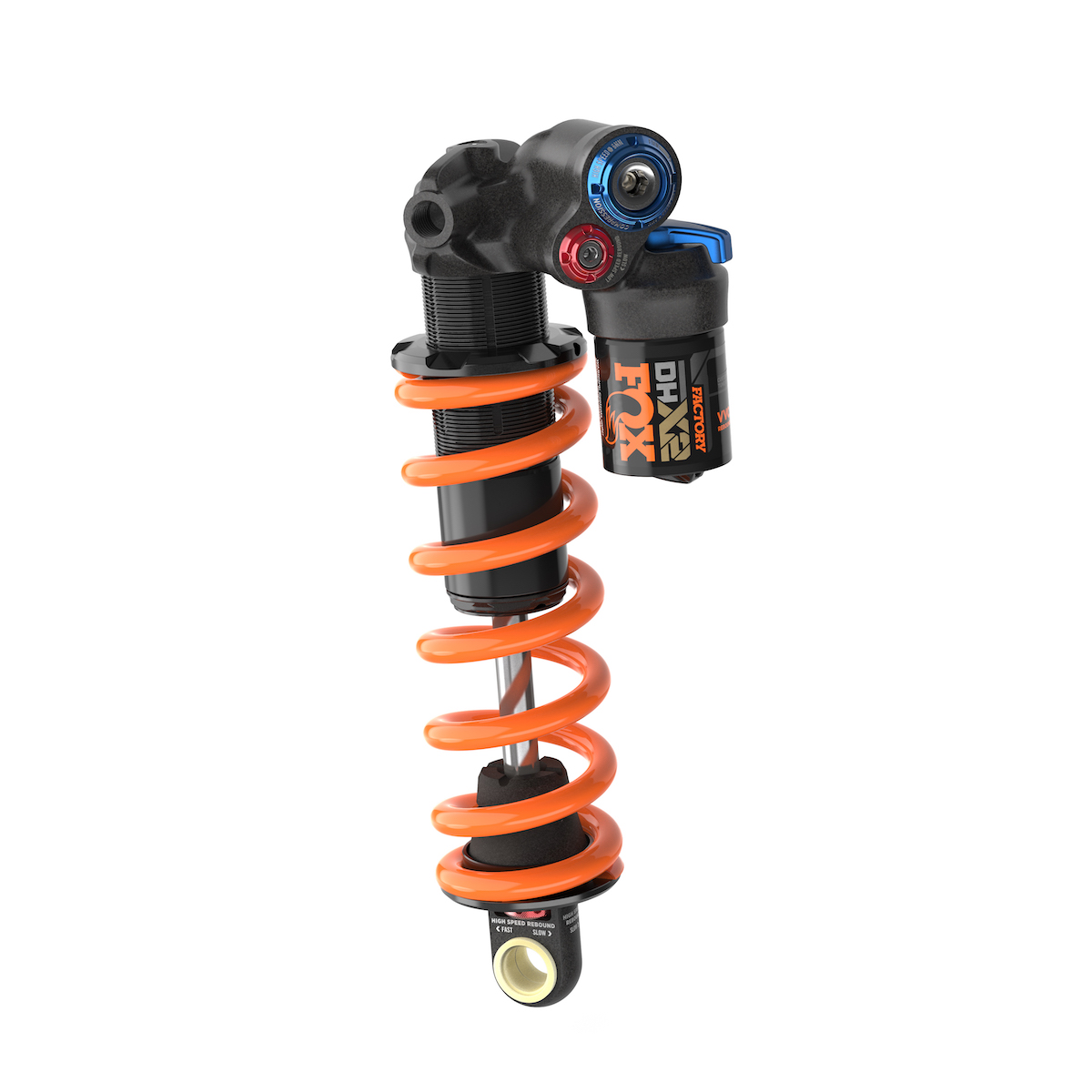

ALL-NEW DHX2
Featuring an entirely new chassis and damper, enhanced tunability, smoother action, and a new MCU bumper for progressivity and end-stroke control – the all-new DHX2 is ready to race straight out of the gate.
Specs:
  • ALL-NEW chassis
  • NEW damper
  • Matching 8-click HSC and HSR adjustment on Grip2 forks and X2 shocks
  • Independent firm mode circuit – firmer lockout than previous DHX2
  • Ultra-low friction, highly durable damper shaft finish
  • Steel outer body and finned inner body for improved structural rigidity and reduced hysteresis
  • NEW detents on spring collar to prevent loosening under light preload conditions
  • MSRPUSD$619-$649/CDN$759-$859/EUR€819-€859
  • Spring sold separately
Shocks Q&A
Q: Why did the outer body on the DHX2 change from aluminium to steel? Isn’t steel heavy?
A: Steel has a much higher modulus of elasticity…it stretches less than aluminium of equal wall thickness under high pressure. This allows for faster pressure responses to shaft motion leading to less hysteresis. Less hysteresis equals more grip and control.
Q: Are different MCU bumpers available?
A: The DHX2 and FloatX2 both use different MCU bumpers but each is specific to each shock model and cannot be interchanged. There is only one size of bumper available or each model. Additional tuning is handled via spring rate, spring volume, compression, and rebound.
Q: Why don’t the new shocks have RVS anymore?
A: We replaced RVS with VVC. VVC offers greater tunability.
Q: The new shocks have an independent Firm Mode Circuit, what does that mean?
A: With the change to VVC, we were also able to make the 2-position switch on its own circuit, making for a notably firmer “lockout” and more efficient climbing as compared to the prior shocks. The firm mode tune no longer has any influence on the open mode tune; they’re now completely independent.
Q: DHX2, why did we switch from trinitride on the DHX2 damper shaft?
A: Shaft finish and seal design go hand-in-hand, we went to a new low-friction seal for 2021 and through extensive testing we found that a hard chrome shaft coating performed best with the new seal, providing the lowest friction and longest durability.
Q: Why do the new X2 shocks have the high-speed rebound knob at the eyelet?
A: The switch from RVS to VVC to on high-speed rebound meant the HSR knob needed to be located in line with the damper shaft, as the HSR dial is connected to a small shaft within the damper shaft, that directly adjusts the VVC unit.
Q: Why is the number of volume spacers on the new FloatX2 shocks so different than last year’s model?
A: The air springs was completely re-worked for 2021, as a result fewer spacers are necessary to achieve the same progressivity.
Q: Does needing fewer volume spacers mean there are reduced tuning options?
A: For 2021, our engineers redesigned the balance of damping force and spring force. The high-speed compression adjuster now has more significant tuning range that changes how the shock feels and rides on big compressions, reducing reliance on volume spacers.

That VVC mechanism is pretty cool, so simple actually. Well done.
