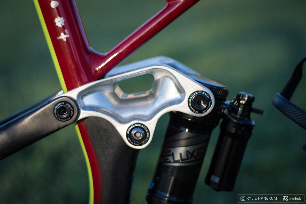

The suspension on the Slakline is ready for big action with Pyga’s take on the four-bar Horst Link suspension system delivering 160 mm of rear travel. The bike is designed to be ridden with a beefy 170 mm fork upfront.
The frame is largely constructed from Toray carbon with the chainstays and suspension rocker being made from aluminium. Pyga believe that for the way in which this bike is intended to be ridden, the aluminium chainstays provide better impact resistance against rock strikes and crashes than carbon stays do. They also explained that the weight difference is negligible.

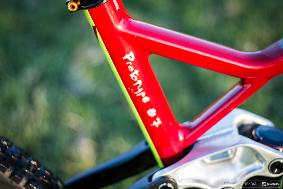

ccs-62657-0-07058000-1502707590.jpgPrototype #7 and Patrick Morewood’s own test bike.

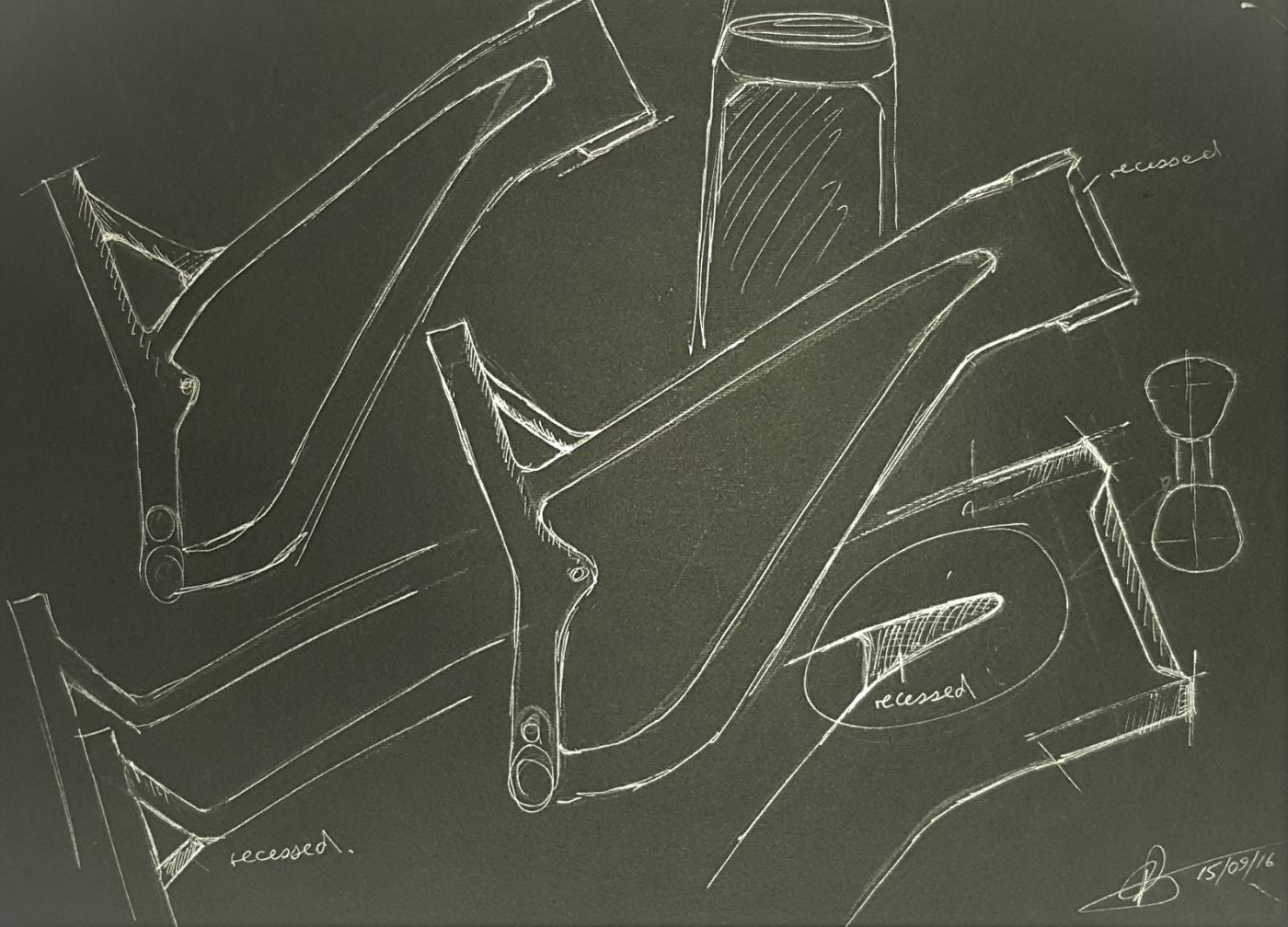

I like the Slakline’s clean but aggressive aesthetic. Looking at it makes you want to get out and ride. There are some nifty touches like the recessed joint where the top tube and downtube meet at the headtube and the separate seat stay tubes with the absence of a seat stay arch. Removing the arch meant that Pyga had to use double row bearings and adapt the rocker to make the rear end stiff enough. The rocker on this prototype is an early design. On the production bike, it will look a bit different and undergo a dark grey anodizing similar to the colour of the stays.

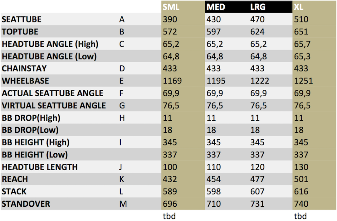

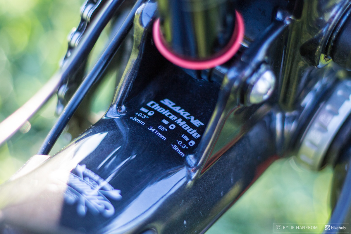

The Slackline has an adjustable geometry with two settings, high and low. The high mode sets the head angle at 65.2 degrees while the low mode drops it to 64.8 degrees. The prototype I rode was set to a third setting (called neutral) with a 65-degree head angle placing it right in the middle of the available two settings.
ccs-62657-0-58712300-1502709510.jpgThere will be two geometry settings on the production bike, high and low.

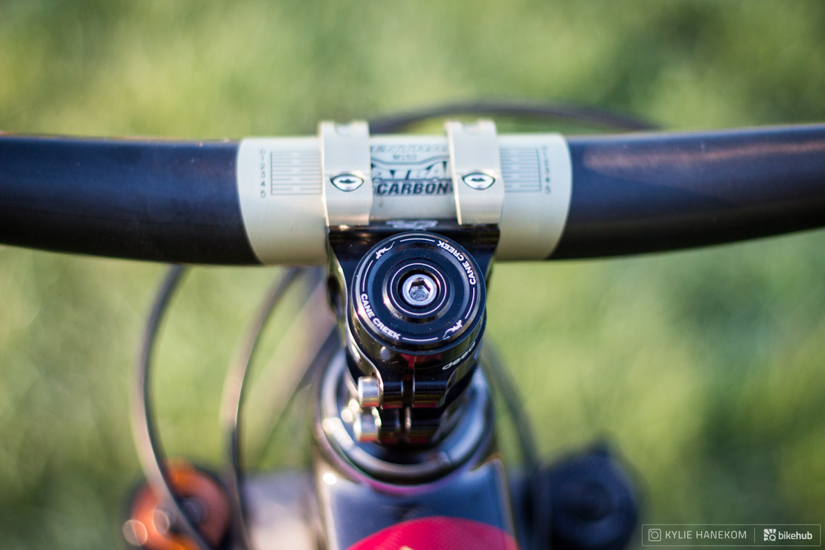

ccs-62657-0-19267100-1502709027.jpgThe Slakline geometry leans towards short stems. This prototype is fitted with a 40 mm stem with another Pyga tester preferring 33 mm.
The rest of the bike is long, low, and slack enough to meet the requirements of most modern geometry devotees. The reach is healthy with the large frame extending to 477mm and a sizeable 1222 mm wheelbase. The chainstays measure in at 433 mm. Take a look at the full geometry table below.
Pyga Slakline Geometry:
Eventually, the Slakline will be available in four frame sizes: small, medium, large and extra large. The first batch of frames will however only be available in medium and large. The Slakline boasts good tyre clearance and accommodates 27.5” and 27.5+ (up to a 2.8-inch tyre) wheelsets. Taller riders on the extra large frames will see their bike’s designed for 29-inch wheels.

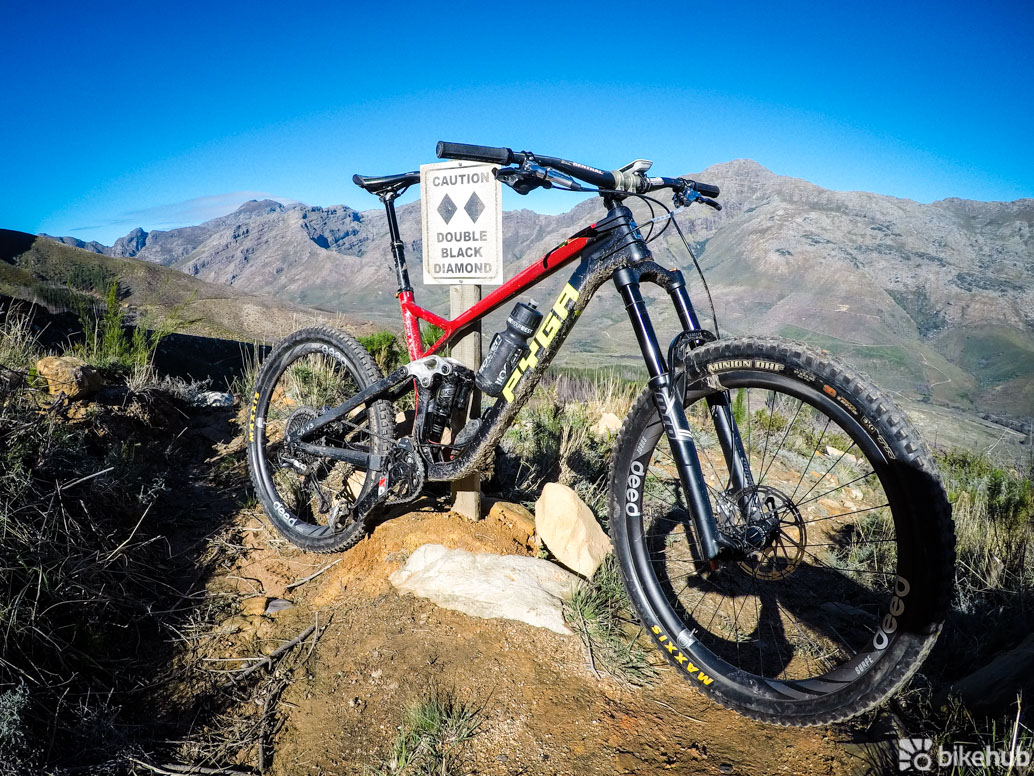

Slakline First Ride
Being one of only a few prototypes, my time with the Pyga Slakline was unfortunately limited. Pyga were understandably eager to have it back to continue testing. This meant that I had precious little time to play with suspension setup and simply defaulted to the recommended manufacturer settings with a few tweaks. The results were surprisingly good.

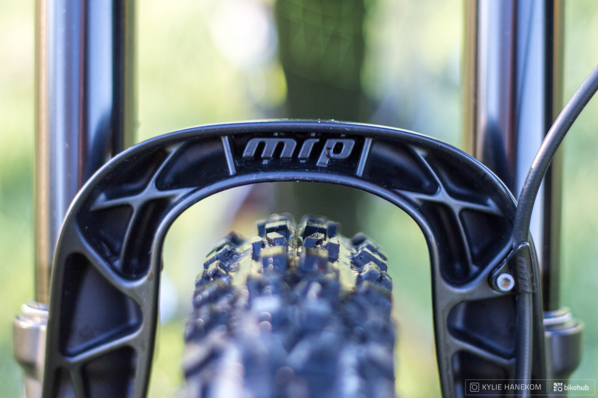

Initially, having never ridden one, I had concerns about getting the dual air MRP Ribbon fork dialed in but the manufacturer’s recommended settings (I opted for their plush setup) did the job. To their credit, MRP has excellent information and product support on their website. Despite only having a short time with the MRP Ribbon, I thoroughly enjoyed the fork’s feel.
The Slakline’s main task is to descend technical trails and to do it fast. On this objective, it delivers. At high speed, the bike feels composed, even as the world blurs and you focus your vision on the trail, there is a sense of trust in the bike’s surefootedness. The Slakline holds a line well through chattery rocks and roots, with predictable grip into turns while the poised balance and big impact stability off drops and jumps are encouraging. I gave it my best but could feel that the Slakline had a lot more to reward riders with more bravery and skills.
Away from the steep and technical black rated trails, the Slakline still has a lot to give. On smoother, less demanding trails, even with its slack angle and plush travel, the Slakline remains agile and responsive to rider input. Pumping and flowing down a meandering trail is thoroughly enjoyable. The bike also pedals well when called into action with good acceleration out of turns and up punchy climbs.

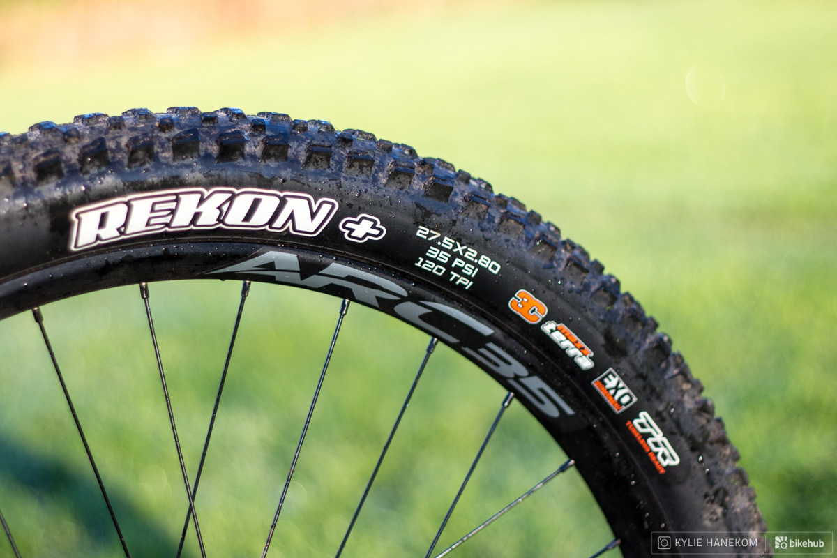

Fitting the Plus tyres is like putting on a superhero’s cape. I found that the added grip, cushioning, and balance are a major boost to confidence and fun levels. On climbs and flat sections, the added bulk of the Plus tyres made little impact to the Slakline’s ability.
The Slakline’s climbing is class leading. For a 160mm enduro mountain crusher, the Slakline climbs far better than anything that I’ve experienced with this geometry and travel. Climbing on most enduro bikes is simply about finding a comfortable gear, sitting down, and chatting to your mates until you get to the trail head. The Slakline is different. It is engaging to climb. To the dismay of my riding buddies, I found myself in an unnecessarily hard gear out of the saddle attacking climbs like I would on my long term Pyga Stage test bike.
As an enduro bike, attacking climbs is not a feature many riders will covet but the Slakline’s pedaling qualities go along way in making it one of the most enjoyable and comfortable bikes on which to spend a full day riding trails. Assuming your fitness is up to it, the Slakline will allow you to stay out on the trails longer and get in more runs than many other all mountain bikes can. The suspension tune also helps in absorbing blunt impacts while the shock is in its firmest setting. The only time the Slakline gives away that it is a slack descending bike is on very steep climbs where the front end does need some encouragement to remain on the ground.
In my reviews, I am cautious to recommend long travel bikes to riders without them understanding just how much is required to push the bike to its limits and how well it climbs. But in the case of the Slakline, there seems to be little disadvantage in selecting a slack 160mm enduro bike. That said, I am super keen to swing a leg over the slighter shorter travel Hyrax (see details below) to see where that bike fits into the spectrum.
In the end
There are few bikes that match the Pyga Slakline’s ability to open up the entire mountain. A confident, composed enduro bike ready for the toughest descents but still an efficient all-day climber on the ascents. The Slakline’s all-mountain versatility is rare, putting it right at the top of my enduro bike list.
The Slakline’s all-round abilities make it the best enduro bike I’ve ridden.
