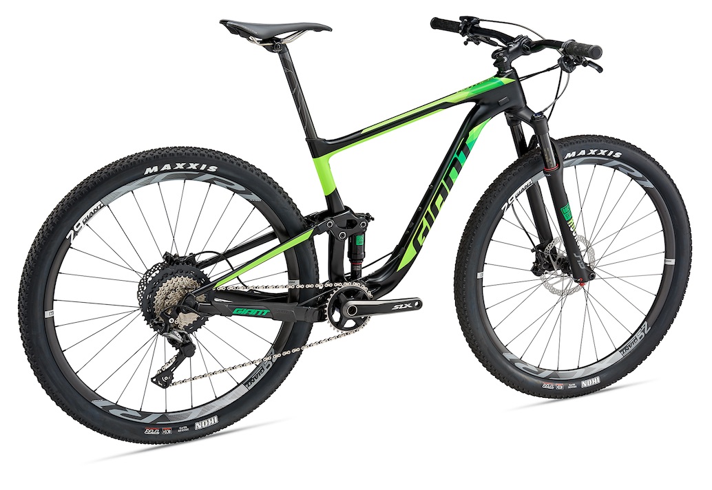

After declaring 650b to be their wheel size of choice, Giant have somewhat neglected the Anthem 29er. An important bike for Giant in South Africa, the Anthem has been rolling around on much the same frame since 2012. But this has all changed with the announcement of the 2018 Anthem 29.
The new Giant Anthem 29
ccs-62657-0-22991600-1498470106.jpegThe Anthem Advanced Pro 29 series features a full-carbon mainframe and rear swingarm, making it the lightest full-suspension 29er Giant has ever produced. Anthem Advanced Pro 29 0 model shown.

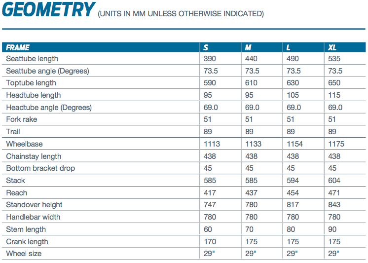

Giant have brought the new Anthem geometry bang up to date with a slacker head angle, longer top tube, and a steeper seat angle while shrinking the length of the rear end and the headtube height. For those that like numbers, the head angle is now 69 degrees with a seat tube angle of 73.5 degrees. Chainstay length is now 438 mm while the reach on a large frame is 454 mm. For those less inclinced to look at the geometry chart, the purpose of these changes is to create a bike that is more agile and boosts confidence on the descents while still maintaining that all important racing edge.
ccs-62657-0-18033900-1498470107.jpgThe Anthem Advanced Pro 29 series features a new Advanced-grade composite rear swingarm. Handcrafted in Giant’s own composite factory, it’s 125 grams lighter than the aluminum rear swingarm while also adding stiffness and compliance. Availability varies by country. Photo: Jake Orness.

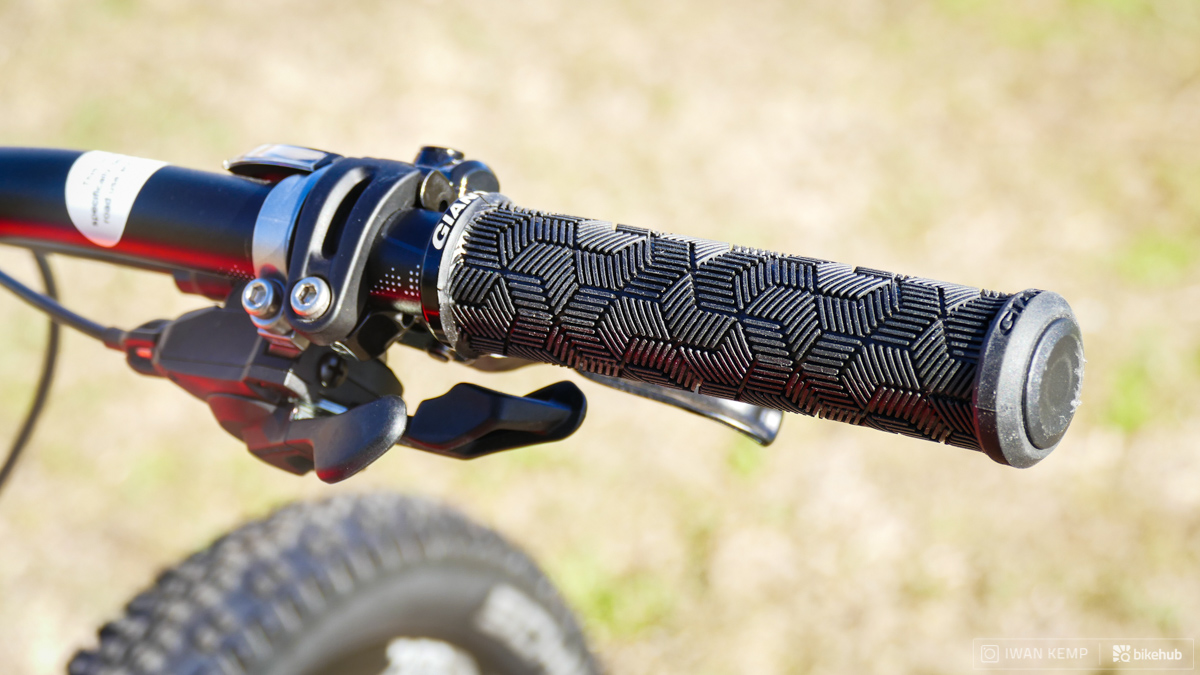

The new geometry has also allowed for changes to the steering hardware. The longer top tube means that you can comfortably fit a shorter stem with the 780 mm handlebars (which can be cut down). The result is a bike that has precise handling on the trails.
The geometry is near identical across the range, with the exception of a slightly lower standover height on the Anthem 29 models.

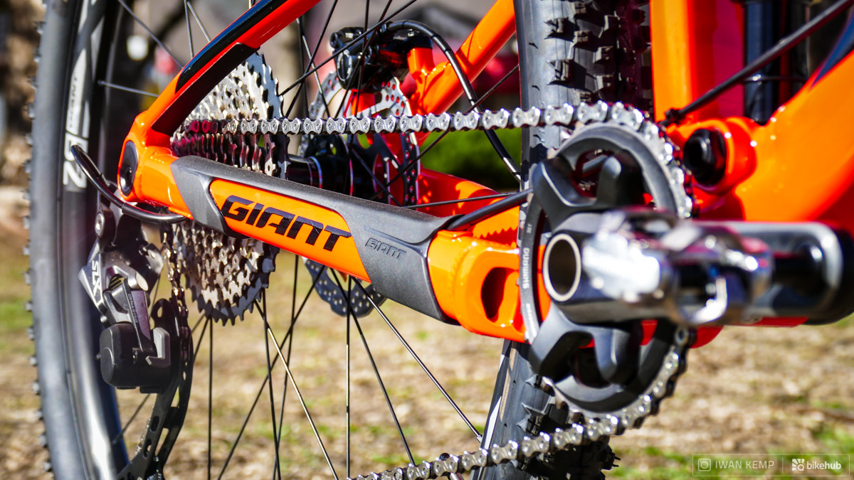

Updated Maestro suspension
Although Giant’s Maestro suspension has proven itself time and again, they made a few changes on the new Anthem. The new Anthem is designed for 90 mm of rear travel with a 100 mm fork.
The first obvious change is the carbon upper-rocker which has a new shape and promises increased stiffness at a lighter weight.
Another visible change is the Trunnion mounted metric shock. The new shock brings with it a longer stroke which (combined with a few other tweaks) produces a lower leverage ratio than the previous Anthem. Giant say this leads to a bike with better pedalling and braking efficiency. It has also reduced the shock pressure, which allows for more useable rebound, and more efficiently uses the full travel of the bike.

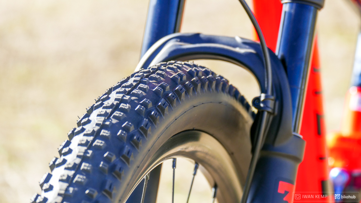

The wheels are from Giant with the labelling displaying a width of 29 mm (we’re unsure whether this is the internal or external measure). The rims are wrapped with a pair of Racing Ralph tyres. Both the wheels and tyres are tubeless ready. The handlebars are generous at 780 mm and are attached to an 80 mm stem on the Large model.
