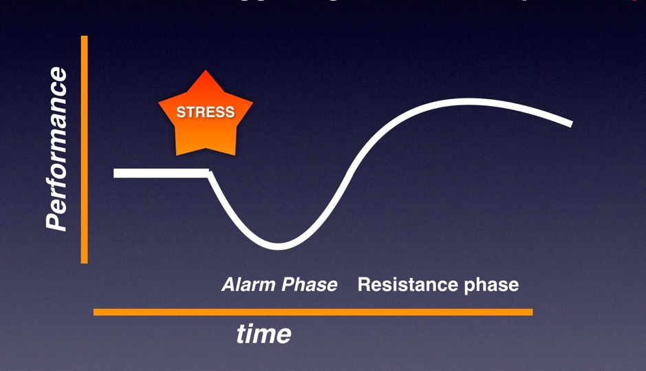

ccs-62657-0-08704300-1468997093.jpgFigure 1: A diagram describing effect of training stress upon performance, as described originally by Hans Seyle in the general adaptation syndrome.
The general adaptation syndrome and its application to training
The simplified explanation of the general adaptation syndrome shown in figure 1 consists of an alarm phase and a resistance phase. In brief, the alarm phase is the body’s initial response to the training stress and may be demonstrated by performing an extremely hard session or effort two days in a row. This will normally lead to a worse performance the second day. The resistance phase is the phase after the body has responded and adapted to the training stress. During this phase a repeated very hard effort will lead to an improved performance.

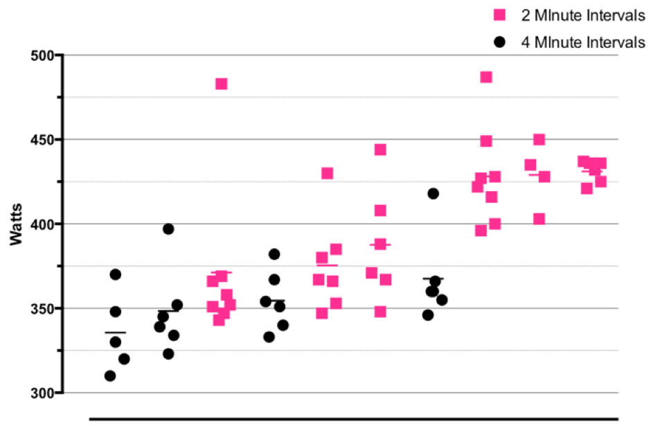

This leaves us with the question: “How should we be analysing our data to ensure that we are improving?” Commonly, hard training sessions consist of interval sessions. The major advantage of training with a powermeter is that it provides you with an exact objective measure of your performance. You should analyse and plot each interval and calculate your “session average” for the specific sessions. Therefore if you do a 3 x 10 minute interval session, and you achieve 410W, 398W and 388 watts for the 3 respective intervals, your session average is 399 watts. It becomes a bit harder to measure performance objectively when you are not training with a powermeter, because measures such as speed and distance may be affected by the wind and other factors. Below we have included an example from an athlete.
ccs-62657-0-38702900-1468222442.pngFigure 2: A diagram showing session analysis of all 4 minute (typically 6 x 4 minute intervals with 2.5 minutes rest) and 2 minute intervals (8 x 2 minute intervals with 90 second rest) that a certain athlete has performed. These sessions are analysed to ensure that the session average (shown on the figure with a short horizontal line) is improved from session to session.
Sticking to a standardised training session which is repeated often allows us coaches to compare apples to apples. It may seem monotonous to some repeating certain sessions, but it is difficult to compare 5 x 5 minute intervals to 6 x 4 minute intervals. For this reason, our library of sessions are often limited and would recommend you do the same for you to be able to repeat certain session to ensure that you are progressing.
