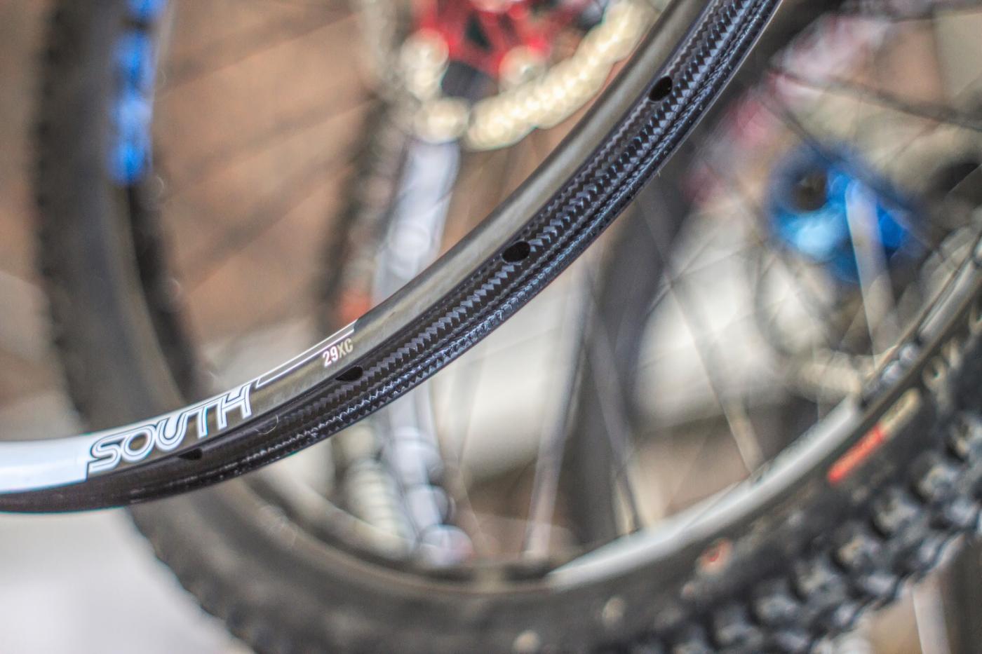

With its intricate shapes and range of finishes, carbon is a magical material offering the promise of unrivalled performance and elegant aesthetics. It’s not often that engineering components happened to both look good and work well – as is the case with carbon.
Requiring fewer spokes – due to the inherent rim strength – and with a clever layup, carbon wheels can be a percentage of grams lighter, equalling a tremendous performance gain, due to the energy sapping of effect of rotation mass.
The gains in acceleration and unflinching tracking and steering accuracy with carbon wheels, must come at a cost. And this cost is not only a loss of compliance and the debit in comfort, but perhaps something we rarely stop to consider…

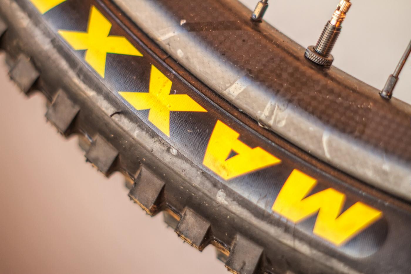

‘But I run low tyre pressures already, my tread is elongated at the contact patch too, so what’s the point?’ Well, if you are riding carbon, perhaps not. I’ve found that slightly higher tyre pressures are the norm on my carbon rims, for fear of suffering a catastrophic rock strike. It’s a counterintuitive action – true – but I’d wager many carbon wheel riders do the same, aware that their rims are stronger than aluminium, but also impossible to dent remedy if something goes very awry.
Under Pressure
If we consider Cooksley’s theory, the compound effect of a stiffer carbon wheel, shielded by higher tyre pressure, could possibly cede braking superiority to the softer aluminium rim rolling a tyre with less air volume in it. Even with both wheelsets running similar tyre inflation pressures, the vertical compliance of an aluminium rim should – theoretically – provide superior braking, as it deforms slightly in support of the elongated tyre contact patch its carrying.
