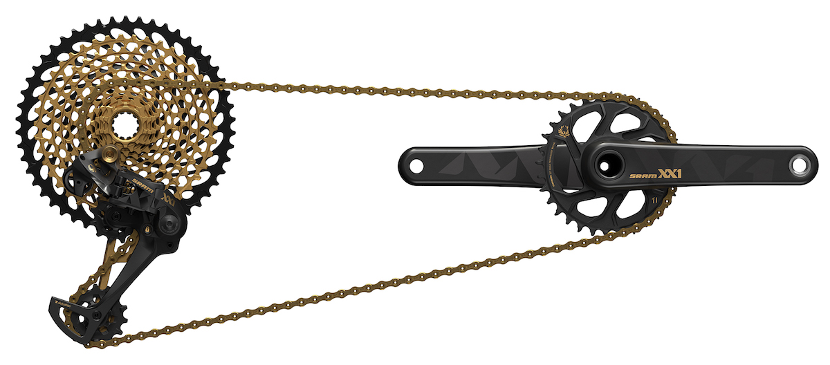

In 2010, if you walked into a bike shop, nearly all the demo bikes were running 2x drivetrains. Today, it’s a world 1×11 and if you wish for the calming spread of ratios of your fondly remembered 2×10, a new 1×12 drivetrain can do that. Those who have ridden both will confirm that 1x systems are superior. Less complexity, cleaner handlebar, better side-profile bike aesthetics (yes, that is a thing for many people) and perhaps most importantly: silence and an absence of chain suck risk.

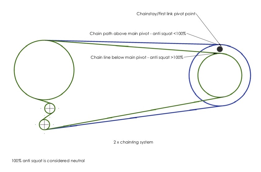

Although a current 1×12 drivetrain has the potential to equal a 2×11 system’s spread of ratios, the inevitability is that in a climbing scenario, you’ll still be using a much larger front chainring. On a dual-suspension bike, the influence of that larger chainring induces a potentially greater energy loss by not optimising the anti-squat characteristics engineered into dual-suspension bikes. The difference is small, but on a few long, gradual climbs, it is sure to compound.
True, the 2x system is slightly heavier overall but on a long climb, the compound effect of its slightly greater rotational mass could be argued as less of a fatigue inducement than having a 34- or 36-tooth chainring. How? Much like an economist, I’d advise you to look at the graphs.
You’ll notice that similar climbing gear ratios deliver vastly different anti-squat percentages. Neutral anti-squat registers as 100%. The 2x system has a number greater than 100%, meaning that the influence of a rider pedalling, has a notably reduced effect on suspension movement. With the 1×12 your anti-squat number is below 100% (worse), which means you’ll suffer incremental effort losses through factional suspension movement over the duration of a long climb. The reason is that a smaller ring front ring is superior during climbing, is that it operates the chainline on rotation below the chainstay pivot point, which you can see in the accompanying drawing.

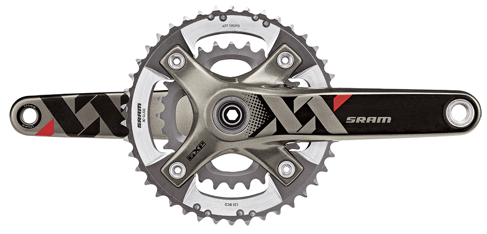

Yet the continued presence of 2x systems shouldn’t be that surprising in a country where paradoxically, we have very large riders, who love competing in long-distance stage races. That 1×12 system might have a theoretically amazing spread of ratios, but for some, having a smaller secondary ring up front, to boost anti-squat way beyond that neutral 100% value during an ascent, will be of greater value than the weight penalty it implies, when the long climb start escalating in gradient percentages.
And when the bunch starts edging up in speed, it’s a lot less fatiguing to keep up the cadence, when you have smaller incremental steps between the gears. It’s why the 2x simply refuses to die.
