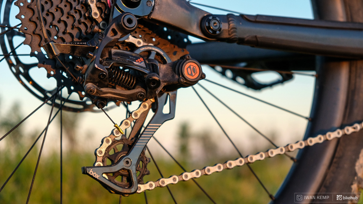

As mentioned in our First Look of the Knolly build, the most unique feature on the Box drivetrain is the shift lever. To downshift into an easier gear you press the lever with your thumb towards the front of the bike as you would on a SRAM or Shimano drivetrain. You can drop up to four gears in one go should you want or need to. To upshift you push the lever with your thumb from the side in the direction of the stem, with single changes the only option here. Thankfully it works well and it only takes a ride or two to get used to it. Riding different bikes does mean that every time I ride the Knolly after a couple of rides on SRAM equipped bikes I need to get my head and thumb around this way of shifting again.
Some fine-tuning of the lever is allowed by the two-position bar clamp which brings the lever in closer. This is even more important as you need to get the upshift in the best possible position in order to be able to shift without ‘thumbling’ around (see what I did there?). I find the throw of the downshift to be a bit long but the upshift fires like a rocket.

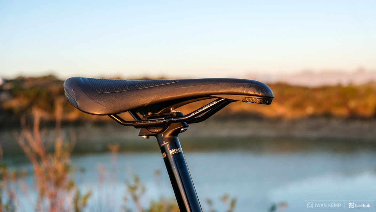

Thanks to the Warden’s straight and short seat tube there is more than enough exposed seat post to run a 150 mm dropper on my size Medium frame with a 77.5 cm saddle height. In fact, I should have gone for a 170 mm dropper and will definitely do so if the opportunity ever comes around to swap the 150 mm dropper out.

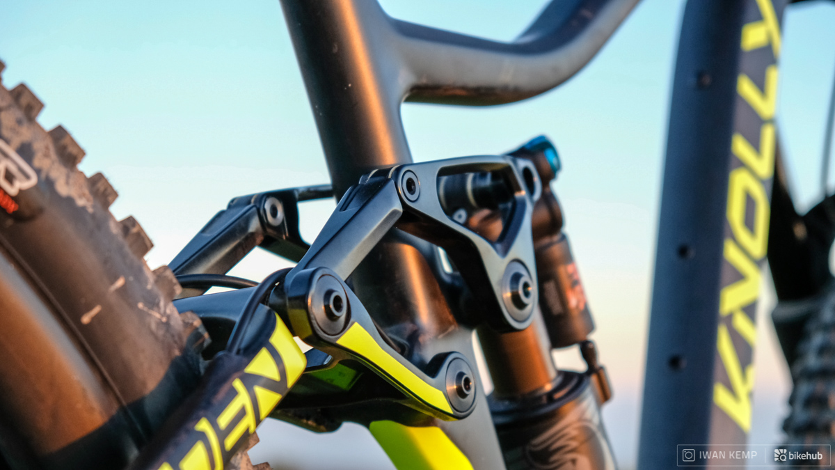

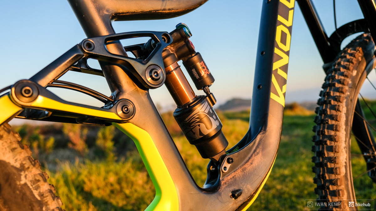

I like my bikes to have some pop on the trails, which means I balance my suspension somewhere between plush and firm. Progressive suspension design and components help with this, but getting it right means spending time with suspension setup. To get going I used MRP and Fox’s recommended settings, but changed the X2 shock to Knolly’s soon after and then worked my way from there.
Knolly recommended baseline set-up: (all settings from full closed)
Optimal sag: 30%
Low Speed Compression: 15 clicks
High Speed Compression: 15 clicks
Low Speed Rebound: 16 clicks
High Speed Rebound: 16 clicks
Knolly team rider Jeremy Stoward’s set-up:
Optimal sag: 33%
Low Speed Compression: 20 clicks
High Speed Compression: 12 clicks turns
Low Speed Rebound: 11 clicks
High Speed Rebound: 8 clicks
The fly in the ointment was getting the front to work with the rear, mainly due to the dual air system of the MRP mentioned earlier. I’ve managed to get that dialed to my liking and have been happy with the way the suspension performs. The Fox X2 climbs better than what I remember of the Cane Creek DB Inline on the aluminium Warden we reviewed. Admittedly, I do use the climb switch on the shock to get to the top of a trail which firms up the rear without giving it a harsh, completely locked out feel.

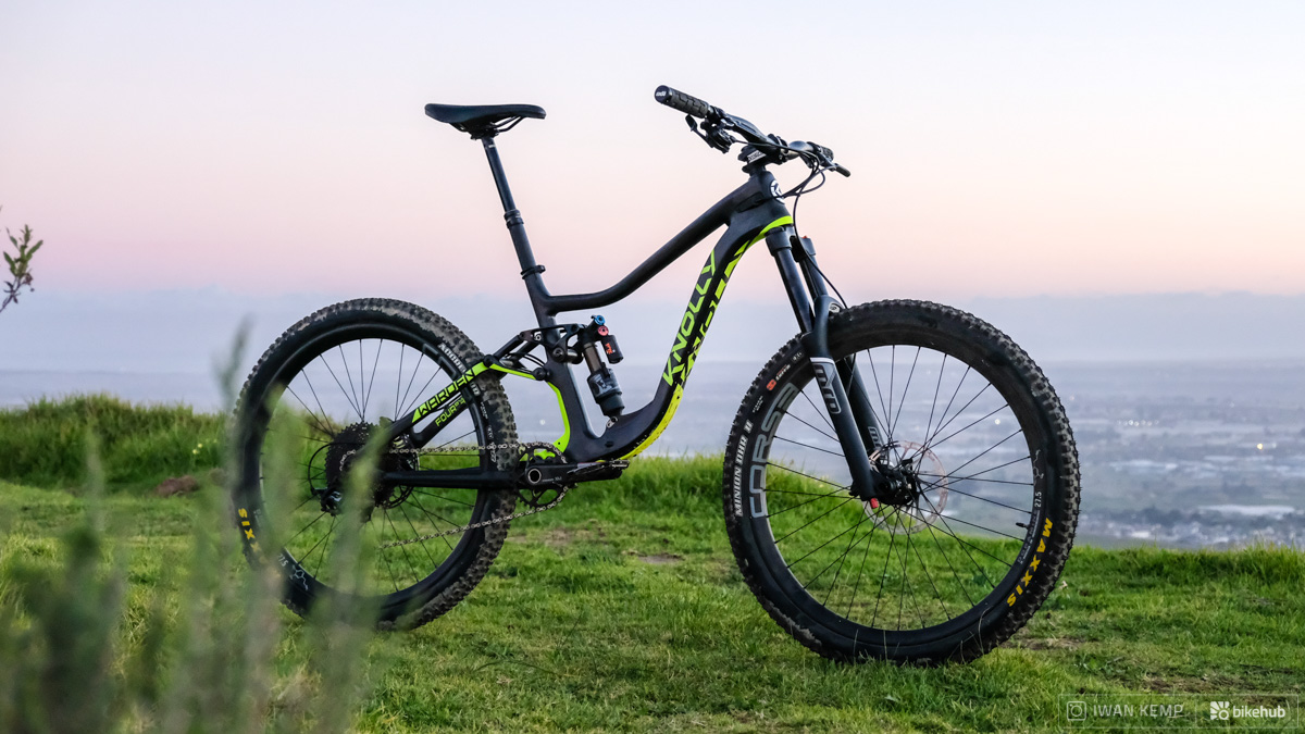

The bike’s mass does mean climbing is best done selecting a comfortable gear and enjoying the view to the top, but only when compared to lighter, shorter travel bikes. Climbing on the Knolly Warden is good, very good in fact for a long travel bike weighing close to 13.5 kg that is meant for going big. Front wheel drift is kept at bay with by sitting on the front of the saddle.
Point the bike down and it comes alive. The combination of suspension design and geometry gives it a very nimble, agile feel yet it still stays planted on fast runs. Usually, you would trade confidence at speed with playfulness through the twisties or visa versa, but the Knolly Warden manages a good balance. I ride it mostly in the neutral (high) position, but one has to keep in mind that it is in line with most bikes in the category with the slack position pushing low and slack further down the geometry scale.
In the End
The carbon version of the Knolly Warden builds on the reputation of the aluminium version as a great do-it-all bike sitting on the enduro/ all mountain end of the riding scale. It won’t kill you on the way up and will reward you in heaps on the way down, seemingly giving nothing up on either side. I’ll spend some more time on the suspension over the next couple of months to see if there’s more performance that can be extracted from the bike and will report back on that in our long-term review.
