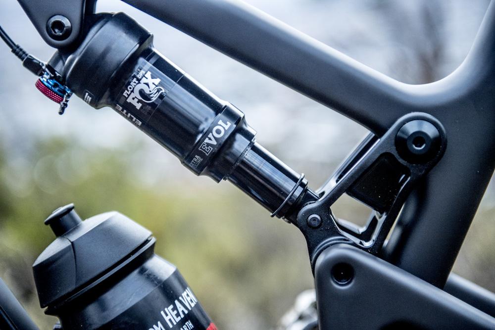

Rear suspension is different, and beautifully complex. The way that the motion of the rear wheel is handled, and how that force is transferred into the rear shock can become complicated by many different pivot, linkage and swingarm arrangements.
ccs-62657-0-36433300-1539697248.jpgPhoto credit: Craig Kolesky.
These “complications” are what give full suspension bicycle designs their “mechanical advantage” over a hardtail, and the performance traits we’ve all come to love. But we don’t fully understand our current suspension design, then how do we know its performing right? And more importantly, how do we know it’s right for us? Well… read on!
