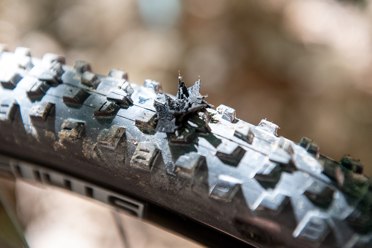

The laser-cut material of the DART is also more flexible and better able to contour to the shapes of different punctures, maximizing surface area to increase the sealing reaction. Because the DART anchors to your tyre and creates a bond with your sealant, it also won’t pull out while riding the way a conventional plug can. Among the best features of the DART’s design are that it doesn’t require trimming once inserted and that excess material won’t get in the way of your ride. DARTs can’t be felt while riding, even when used for road tyres, and they wear smooth naturally.

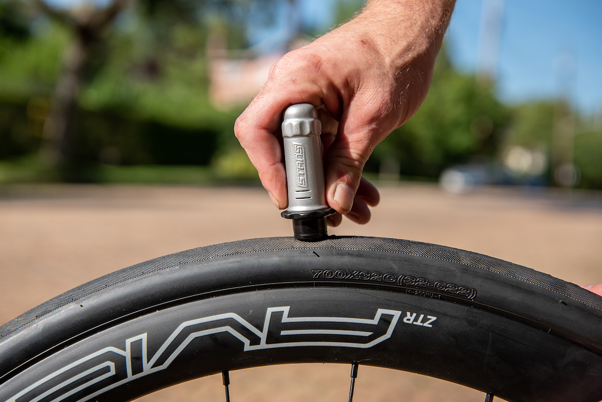

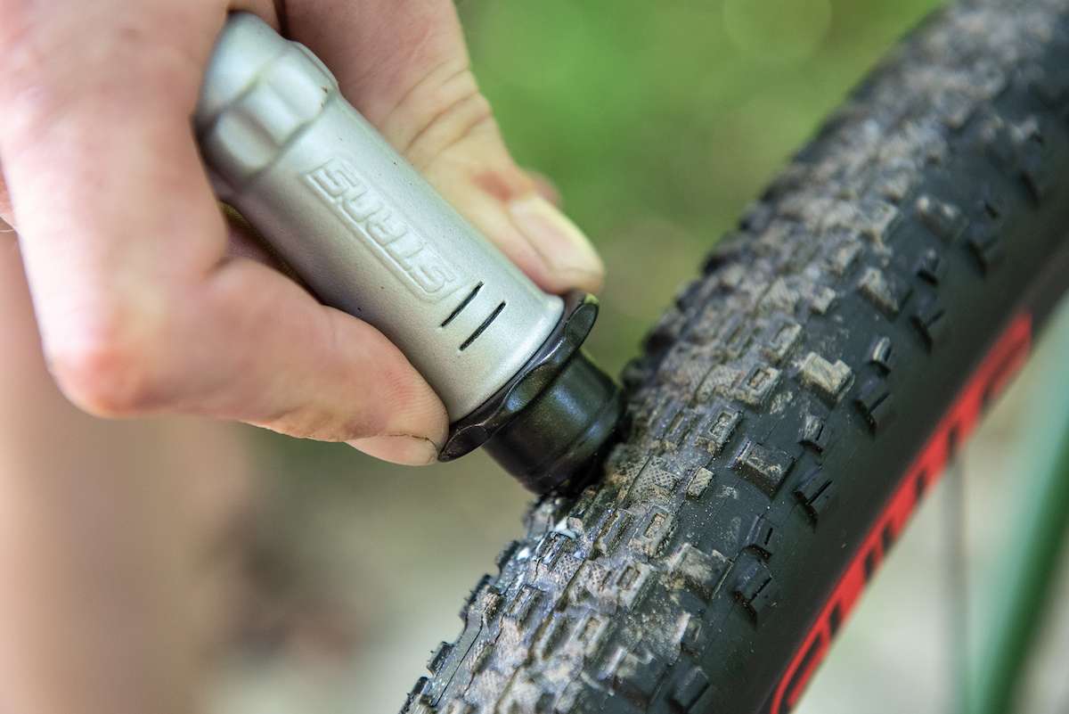

During development, the DART was meticulously engineered to make tubeless tyre repair more simple and straightforward than any other tyre repair system. Ease of use was a priority. When repairing a puncture, simply position the tip of the DART into the puncture and press until the head of the DART Tool contacts your tyre. The length of the rod is specifically calibrated to insert DARTs to the perfect depth every time and to anchor them into place securely. That means no more damage to rim or rim tape during a fast repair.

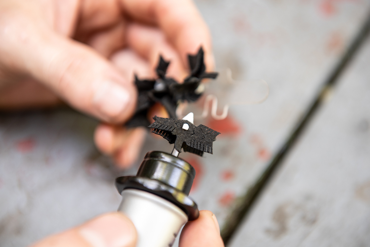

Rapid deployment was another key design criteria of the DART Tool. The double-sided head of the tool holds two sealed DARTs on each side, allowing both to be used quickly in succession to seal very large slices or snake bite-like punctures that create multiple holes.

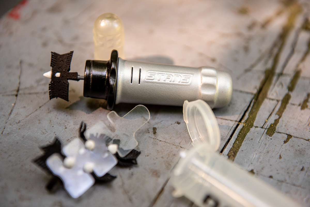

The DART Tool’s ergonomic design features an ultra-strong yet lightweight molded plastic handle that is easy to hold and allows precise placement, a serious advantage when repairing difficult-to-reach punctures next to a tyre knob or bead. That same handle includes a built-in valve core remover to make it even easier to also add more sealant whenever necessary.
A complete DART Tool, including two loaded DARTs, weighs only 15g. This is in part because the rod that presses DARTs into punctures is made of ultralight, corrosion-resistant, and incredibly strong carbon.
DARTs are made to be stored for extended periods and are fast and easy to reload and reuse. Clear thread-on caps not only let you see through them to confirm whether your DART is in fact loaded and ready for its next repair, but they also protect your DART, keeping it clean between uses. A DART Refill container is available and includes a rack of five DARTs.
