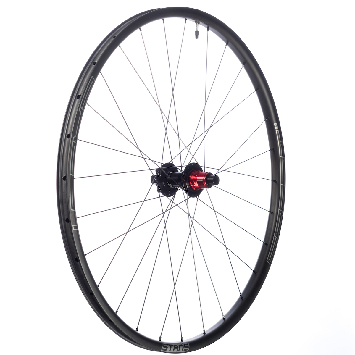

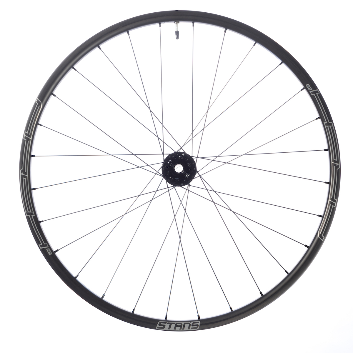

Crest CB7.

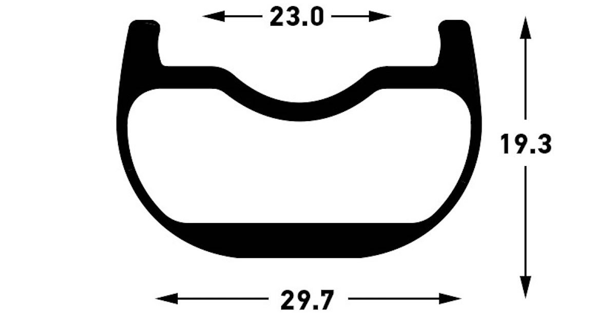

At 325g, the Crest CB7 is among the lightest rims available for cross country racing. Its 23mm internal width makes it ideal for today’s wider cross country tires without adding unnecessary weight.

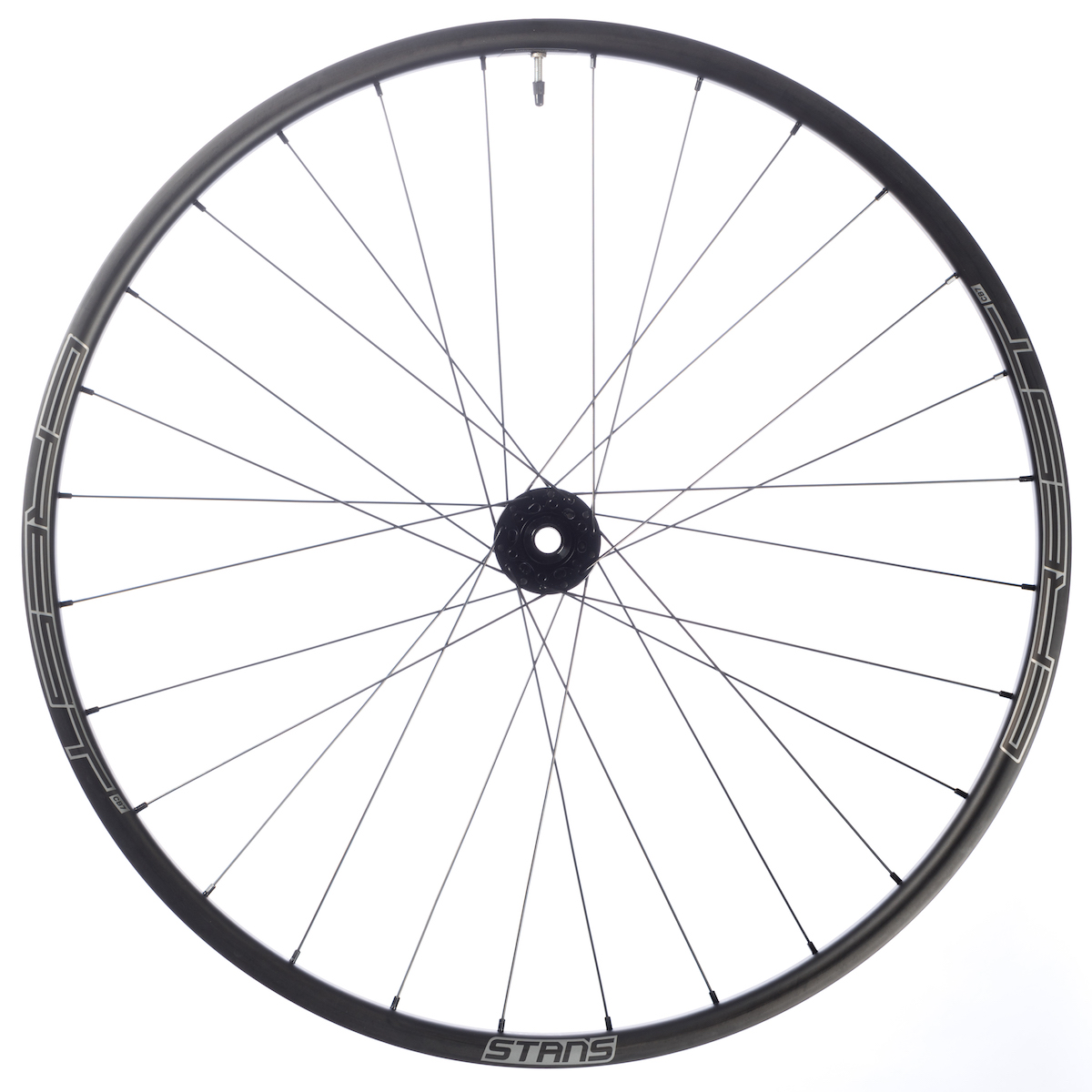

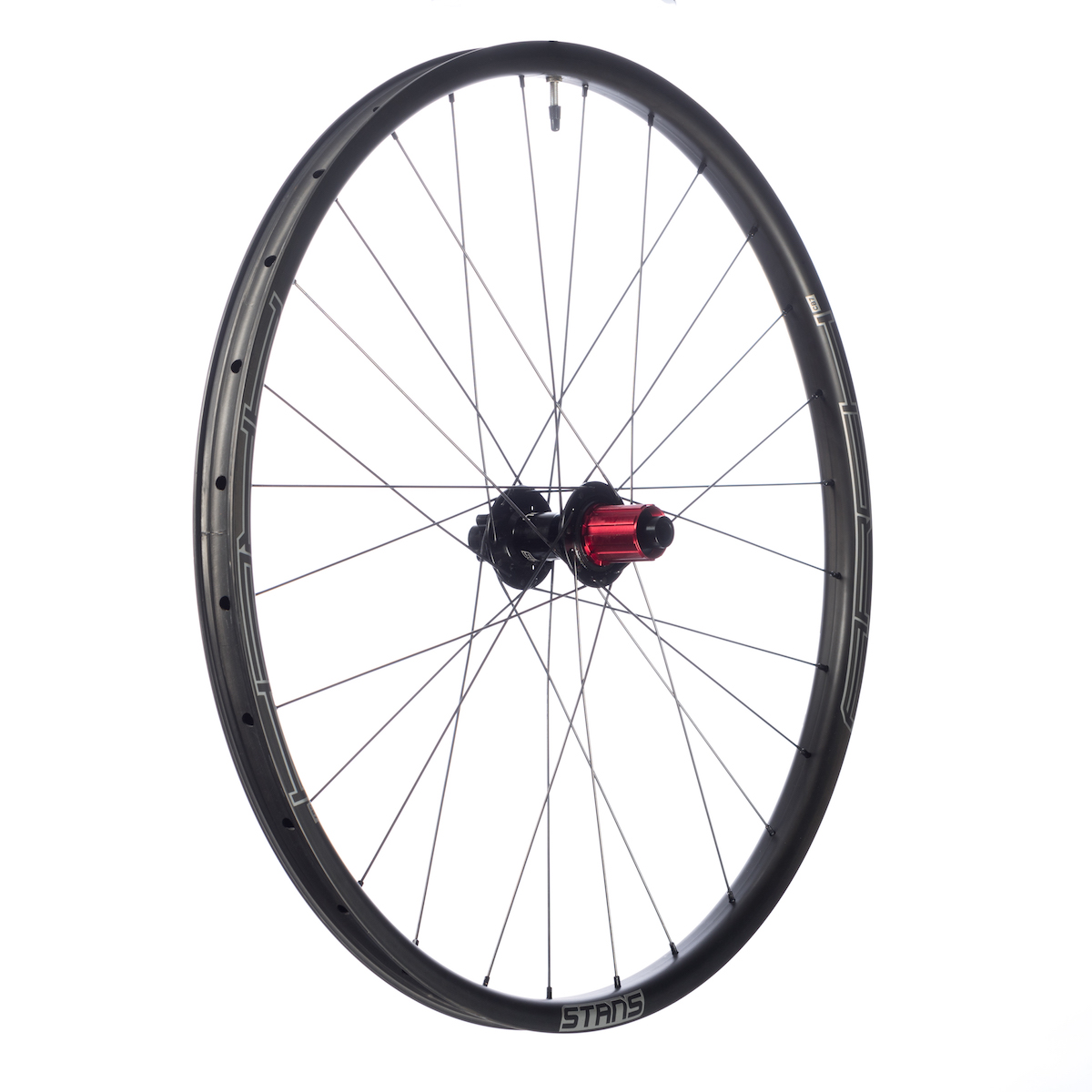

Arch CB7.

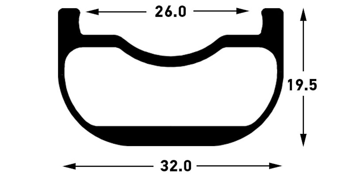

Designed for trail riding, the new Arch CB7 has an interior width of 26mm, making it perfect for today’s trail tires.

Crest CB7
Use: Cross Country Racing
Internal Rim Width: 23.0 mm
Optimal Tire Sizes: 2.00″ to 2.25″
Hubs: Stan’s Neo with Durasync 28-hole Front, 28-hole Rear
Spokes/Nipples: Sapim Force Black 2.0/1.7/1.8mm, Sapim Secure Lock Alloy Black
Wheel Weights and Sizes: 1,452g (29″)
MSRP: Wheelsets – US$1,399, Rim – US$600
Arch CB7
Use: Trail, All-Mountain and Enduro Racing
Internal Rim Width: 26 mm
Optimal Tire Sizes: 2.25″ to 2.50″
Spokes/Nipples: Sapim Race Black 2.0/1.8/2.0mm, Sapim Secure Lock Alloy Black
Wheel Weights and Sizes: 1720g (27.5″) / 1794g (29″)
