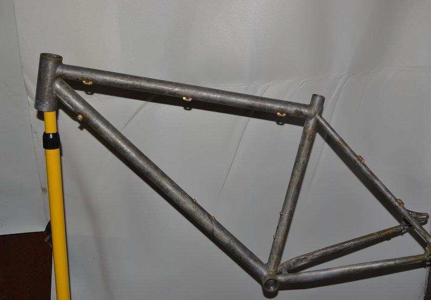

Momsen STR 29 fresh out the box

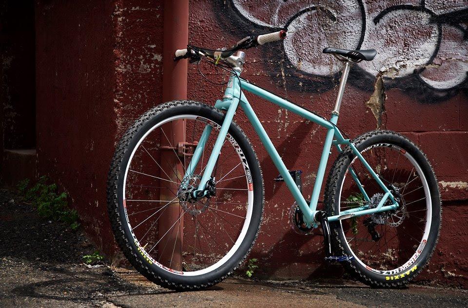

The original idea/inspiration

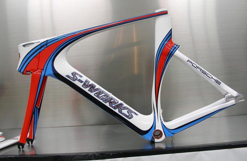

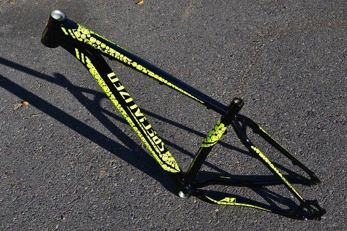

In my search I stumbled upon a Martini Racing Specialized Shiz and got a lot of inspiration from the effort and attention to detail that went into it. The guy had custom decals made and went through a lot effort to get the exact look he was looking for. Full details can be viewed here.
Slick custom Martini paint job on a Specialized Shiz

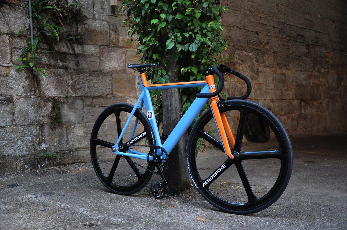

I emailed him pictures of my two ideas and after a conversation or two we decided it would be best to go with the Gulf colours. I was just happy I found someone who was almost just as excited as me to work on this project. Anton collected the frame from me one Friday afternoon after work and by the Monday he emailed me the first updates. Inspiration for the look comes from a track frame that was resprayed in the Gulf colours.
Gulf racing inspiration

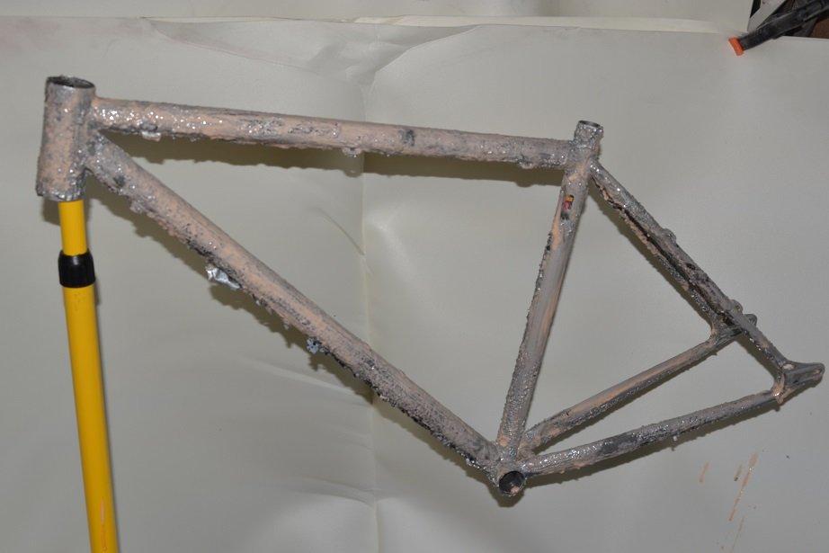

Paint stripper applied, no going back now.
Close up of the work of the stripper

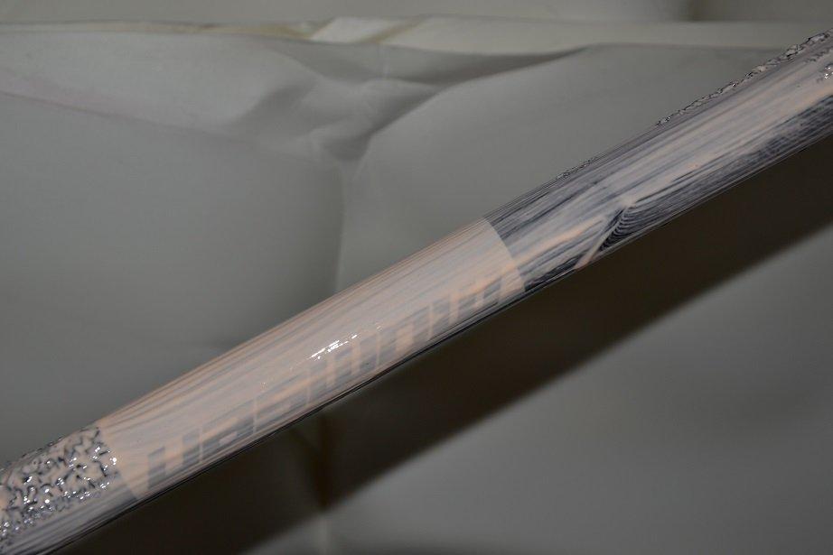

Frame stripped down to bare metal

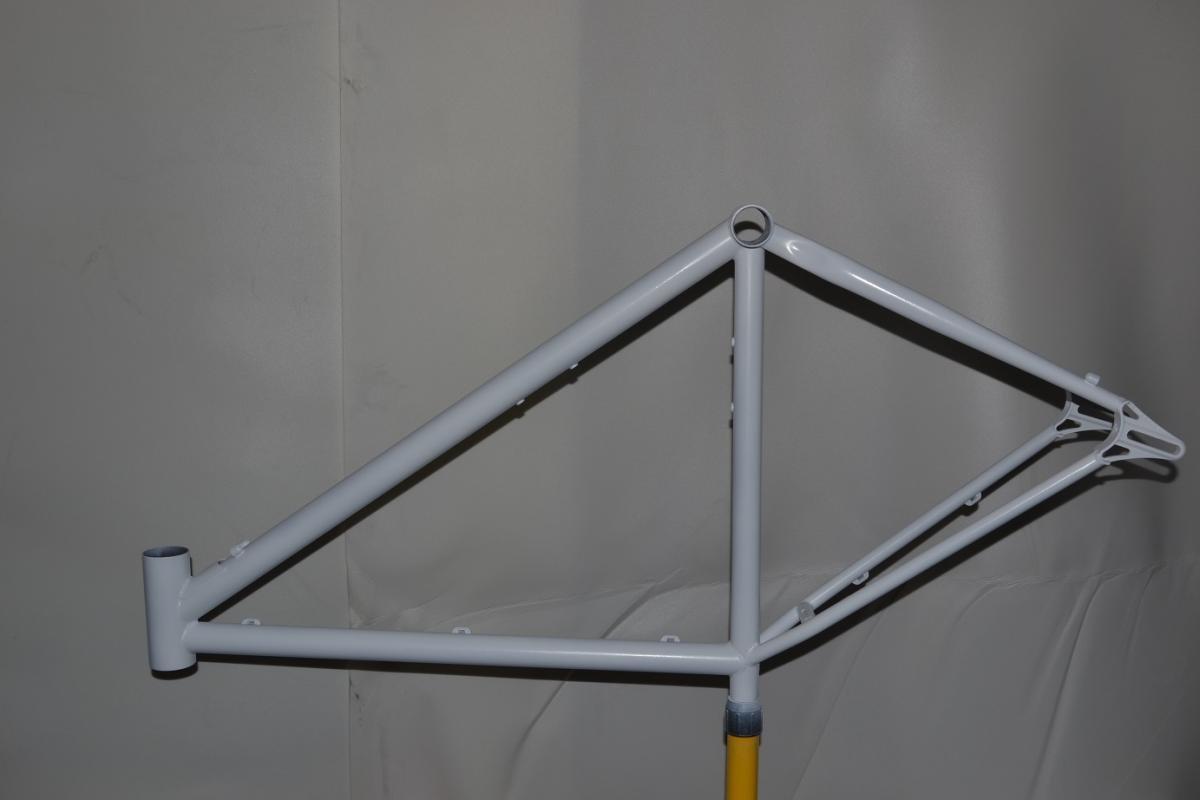

Epoxy primer applied. Looking clean and ready for some colour.

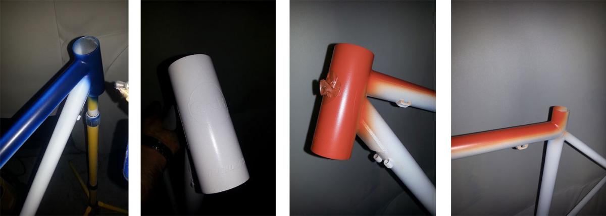

From left: The first colour laid down for pin-striping; the frame sprayed white agin to cover the excess blue, the masking visible in the photo is for the logos to come; base layer for the orange. It will receive a much brighter orange over the base layer. The reason for that is the orange is a bit transparent and does not cover too well if sprayed on its own. If you look closely you will notice the vinyl stencil laid down for the pinstripe.
