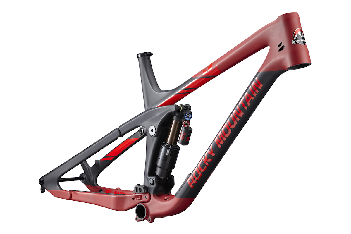

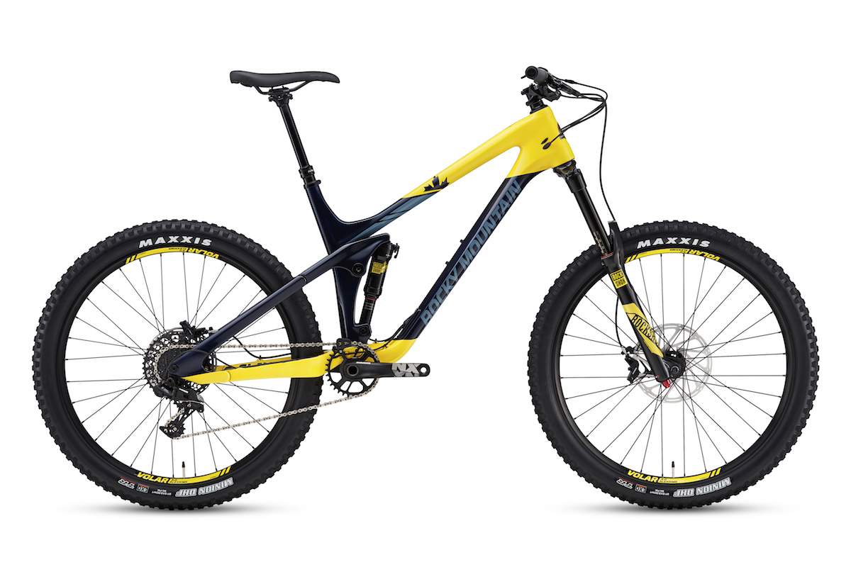

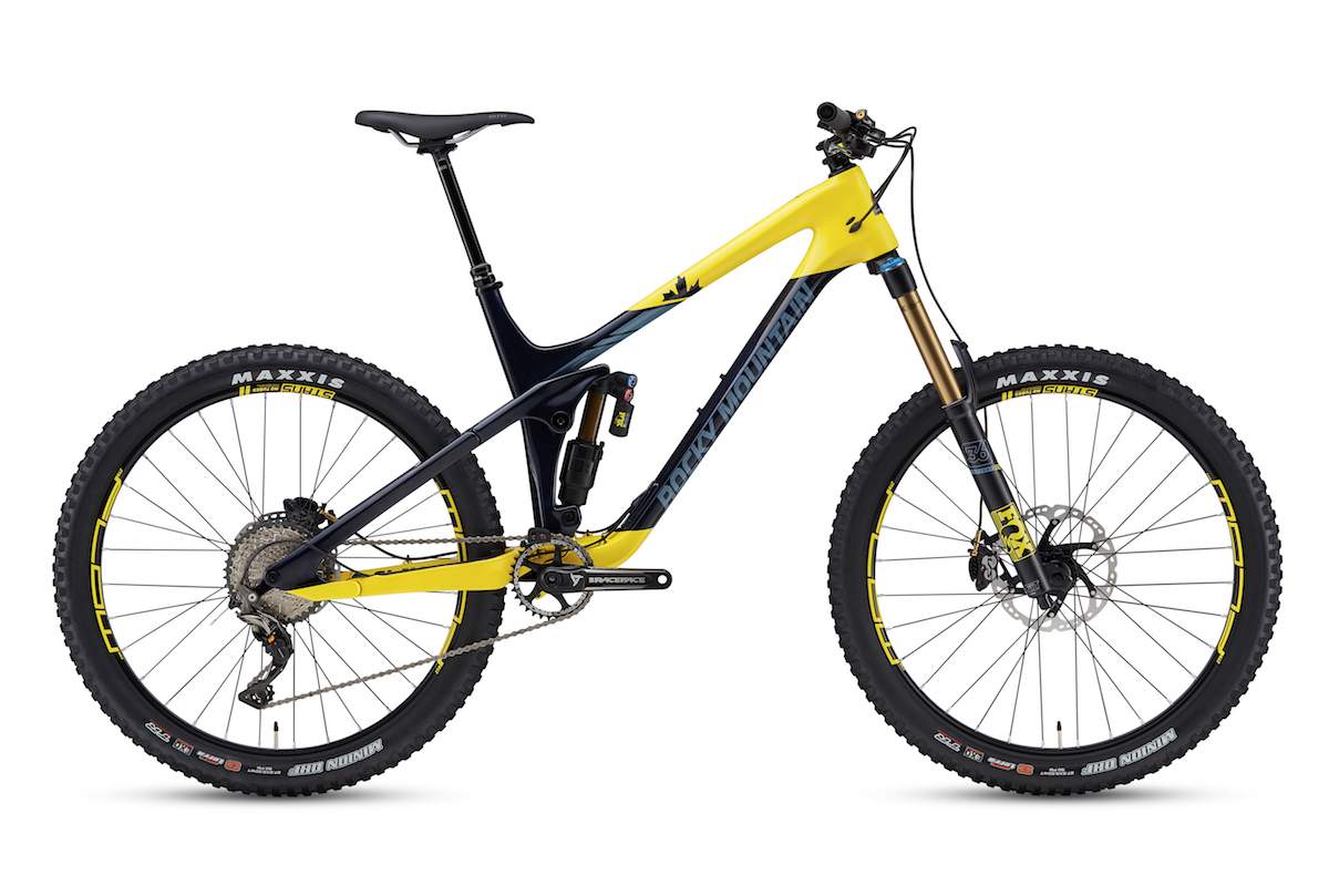

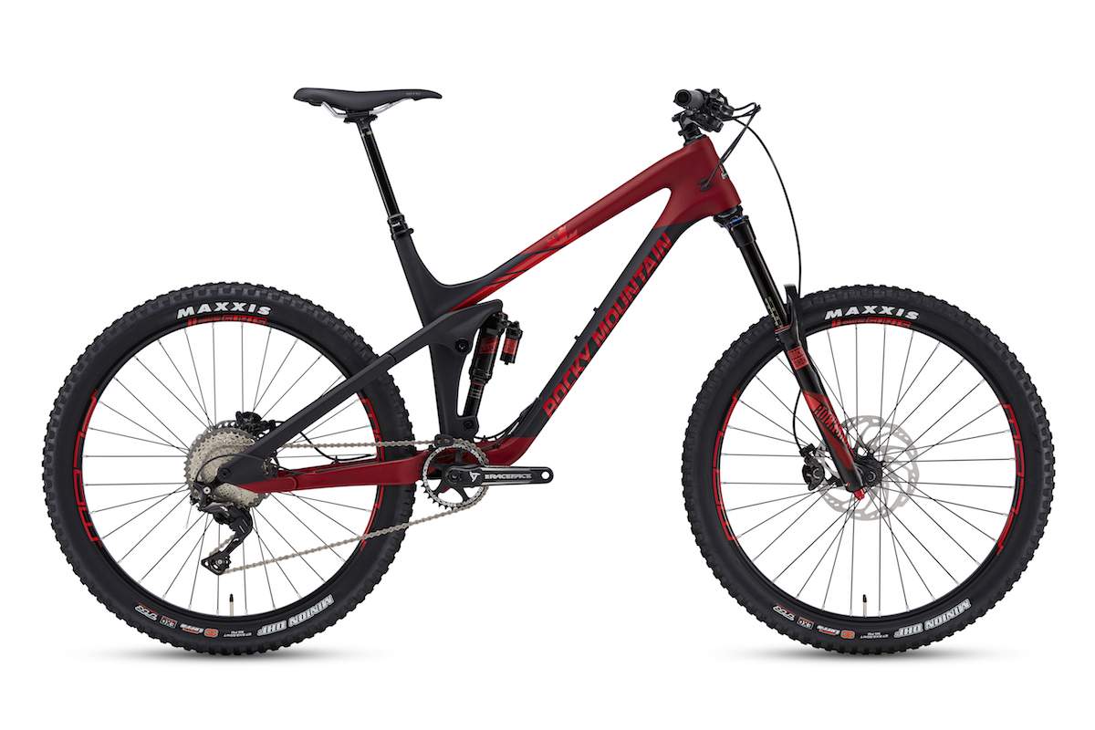

Designed to lay waste to the world’s roughest trails, the Slayer is back as an all-carbon weapon. From the most aggressive Enduro World Series tracks to bike park laps and big mountain lines, its downhill-bike capability and pedaling responsiveness are matched with an uncanny ability to find and hold speed in rugged terrain. All killer, no filler.
Intended Use: Enduro / All Mountain
Front Travel: 170mm
Rear Travel: 165mm
Wheel Size: 27.5”
“I’m super fired up that the Slayer is back,” says team rider Thomas Vanderham. “A few things really stood out to me through the development process—it pedals incredibly well, carries a ton of speed, and that extra bit of travel is awesome when you really want to rally! I see myself spending a ton of time on this bike.”
Details

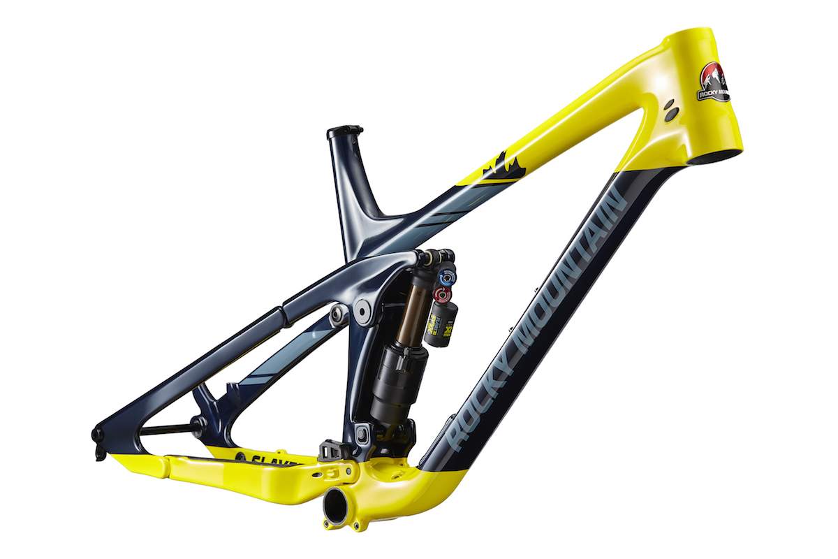

  • Full Smoothwall™ carbon frame
  • Ride-4™ adjustability chip for precise geometry adjustments
  • All sizes fit one water bottle inside the front triangle
  • Future-proofed to run Di2 and a dropper post concurrently
  • Max type Enduro cartridge bearing pivots with simplified hardware, Pipelock™ rocker link pivot
  • Shock-eyelet bearings for small-bump sensitivity
  • Single-sided chainstay and seatstay pivots for a narrower rear triangle—eliminates heel rub, even with Boost spacing
  • Metric shock, 230×65
  • 1x specific
  • Clearance for up to 27.5×2.5 “wide trail” tires, and compatible with 26+ tires (26×3.0)
  • Full-length internal dropper post and lockout routing. Internal brake routing in the front triangle, internal tube-in-tube shift routing
  • Oversized downtube ports for ease of cable routing
  • New derailleur hanger design reduces hardware complexity
  • Lightweight bolt-on axle saves 35g compared to a traditional Boost axle
  • PressFit BB92 bottom bracket, ZS44 | ZS56 headset
  • Post-mount 180mm rear brake
  • Max chainring size is 36t
  • Sizing: S/M/L/XL
Suspension
Our four-bar Smoothlink™ suspension has been tuned to eat up rough terrain and square-edged hits. We also increased the anti-squat values to make sure the bike pedals efficiently—whether you’re sprinting for a transfer stage or grinding towards a backcountry descent.
The Slayer features shock-mount bearings for incredible small-bump suppleness. Predictable, efficient, and capable, its rate curve provides good support at sag and a moderate ramp towards the end-stroke.

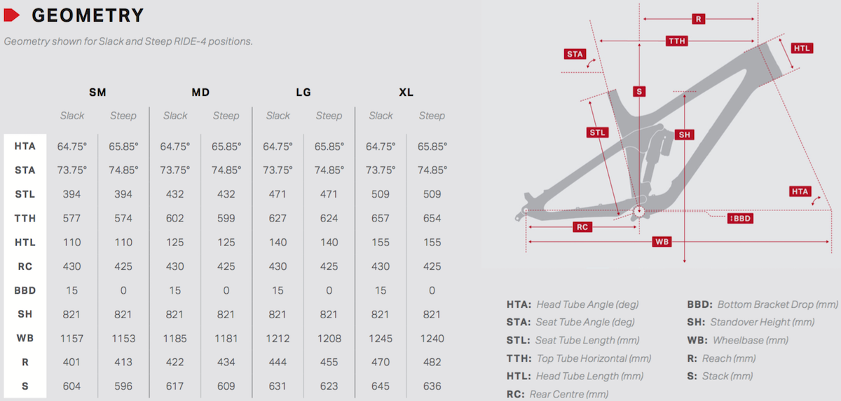

Geometry
When we decided to bring the Slayer back, we knew it needed the crush-everything-in-its-path attitude of the previous generation while keeping the agility and efficiency that made it a favourite among aggressive trail riders. The updated geometry retains a fairly steep seat-tube angle, while the reach has been extended and the head-tube angle has been slackened.
We kept the BB drop neutral and the rear centre quite short to improve cornering, and shortened the seat-tube lengths to make room for the next generation of longer dropper posts.
Our Ride-4™ adjustability system was chosen for the Slayer in order to provide precise geometry adjustments while leaving the suspension curve virtually unaffected. The head-tube and seat-tube angles can be changed by just over a degree, and the bottom-bracket can be raised or lowered by 7.5mm. This allows racers to adapt their geometry from track-to-track while keeping shock tuning predictable and simple.
Technologies
  • The RIDE-4™ system uses a single chip insert to adjust the geometry on bikes that require more subtle changes. This allows for more precise adjustments and more isolated shock-tuning.
  • Smoothwall™ carbon uses one of the world’s most sophisticated carbon processes to build frames with industry leading stiffness-to-weight, ride quality, and durability. By using rigid internal molds, we are able to perfect the shape of the internal features and eliminate excess materials. We use different types of carbon in specific frame areas to maximize stiffness and impact resistance while minimizing overall weight.
  • Smoothlink™ suspension stays supple yet supportive through a wider range of gears than conventional single pivot or other four-bar suspension configurations. This patented system reduces both pedal-bob and bottom-outs, while allowing us to fine tune variables like braking and climbing traction across a wide range of intended uses.
  • The Pipelock™ collet system expands radially and locks into the frame, creating a wide and rigid pivot stance. Using Pipelock collets lowers front triangle pivot weights while maximizing lateral stiffness.
  • Size Specific Tune™ ensures that riders of all sizes get the right balance of small-bump compliance, mid-stroke support, and end-stroke progressiveness. Our design team does custom shock tunes based on real world field testing, and adjusts each tune for every specific frame size, from S to XXL.
Models

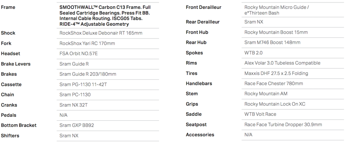

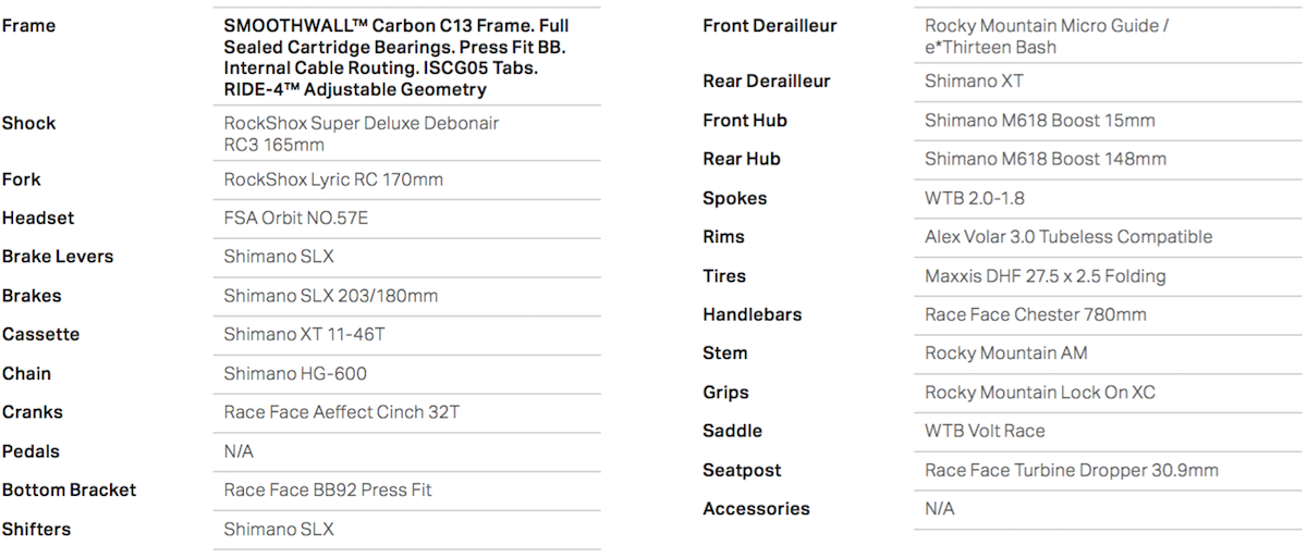

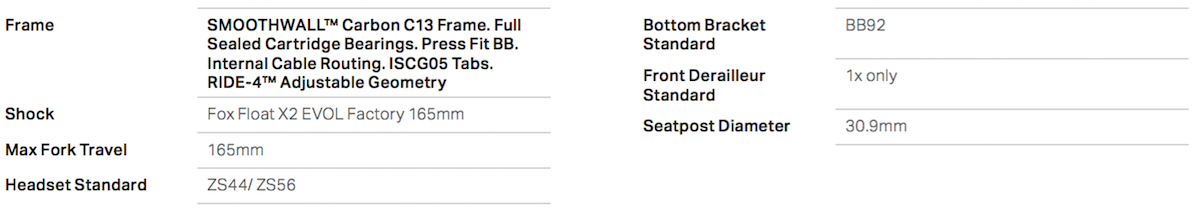

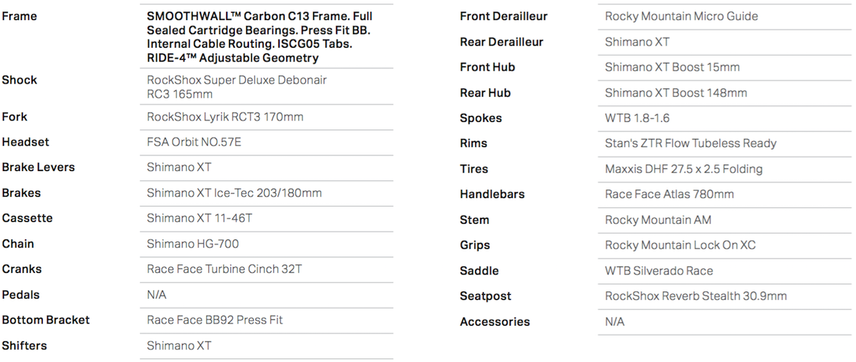

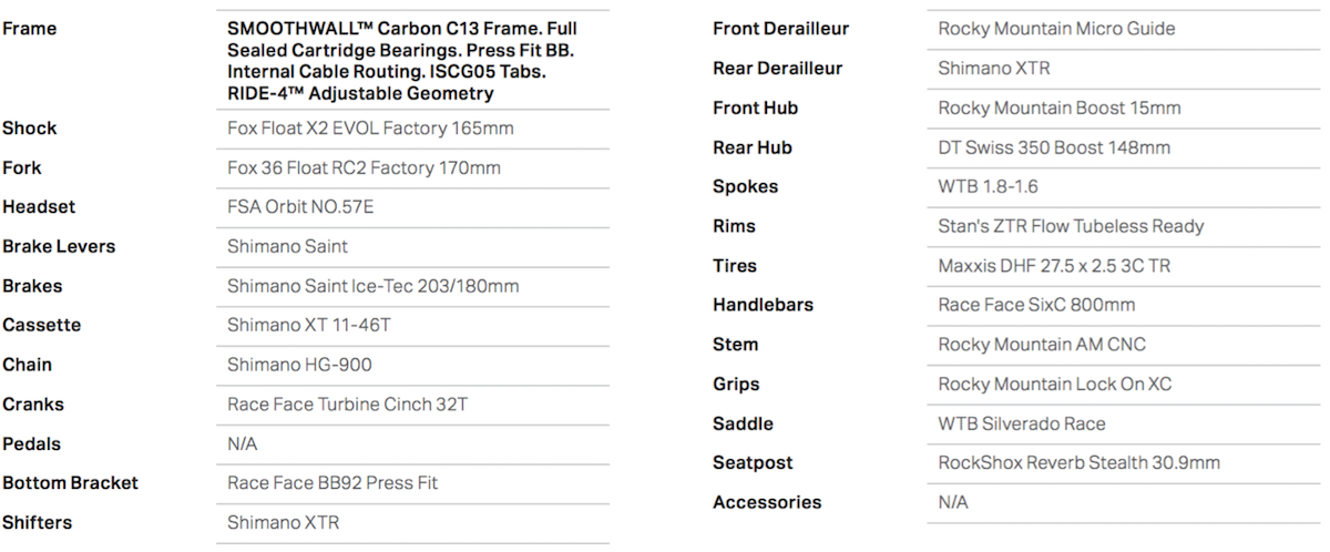

Slayer 790 MSL
Slayer 770 MSL
Slayer 750 MSL
Slayer 730 MSL
Slayer 790 MSL Frame Only
