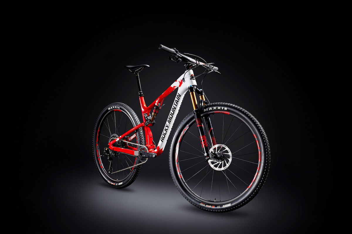

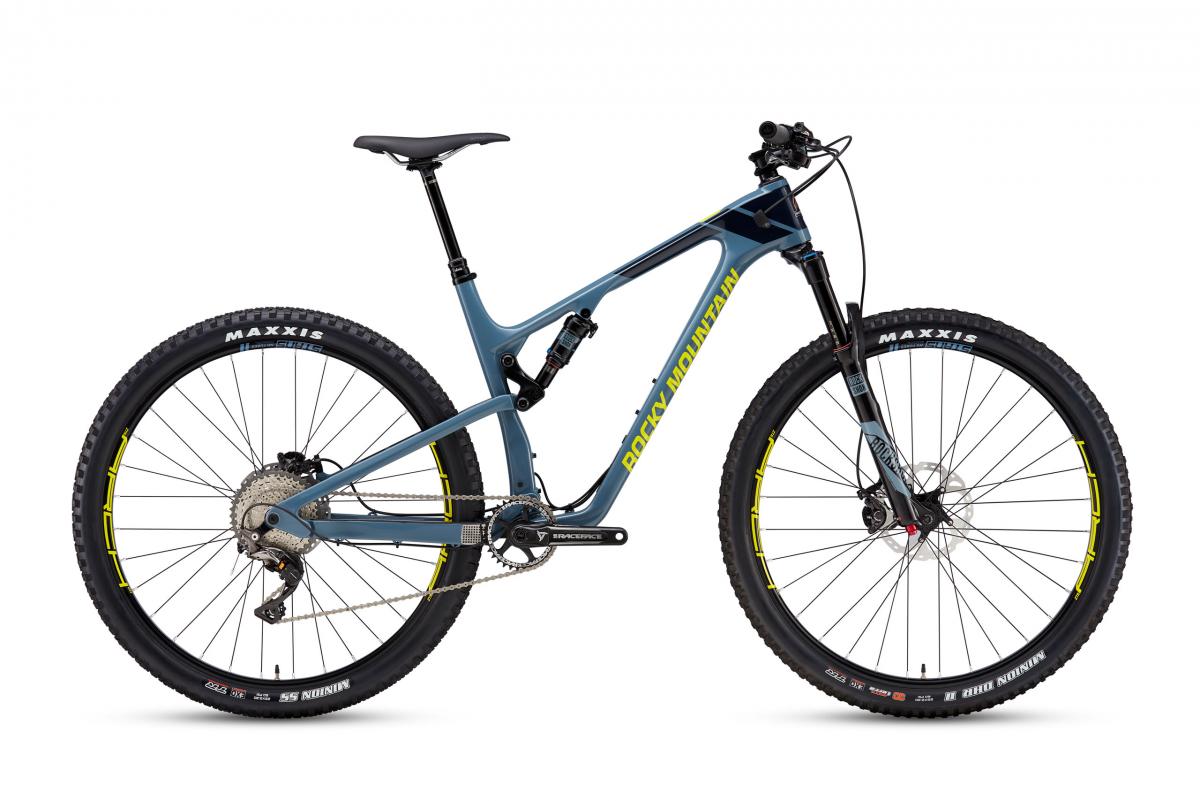

This is the result of over two decades at the front of the pack. The new Element features more efficient suspension performance, refined marathon geometry, Ride-9 adjustability, and room for two bottles inside the front triangle. The smallest details were examined in search of point-n-shoot rigidity and unrivalled speed.
“This new Element is a full-on XC marathon weapon, but with the confidence of a trail bike” says product director Alex Cogger. “People used to show up to BC Bike Race expecting to grind fire roads all day, only to walk the descents and snap their made-for-the-scale bikes in half. XC racing has evolved, and bikes that can’t handle the real world have no business on the course.”

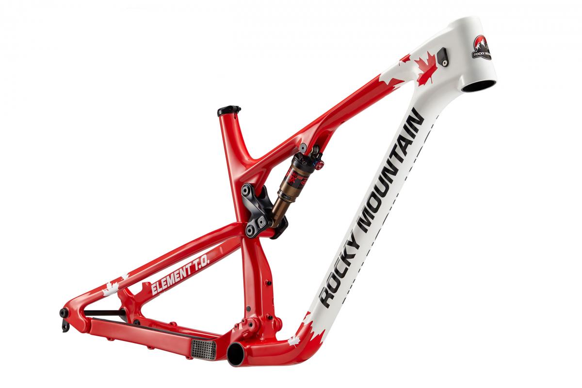

- Full Smoothwall carbon frame weighs 2250g (size Medium, including shock and hardware. Two-tone paint on T.O. frame adds 30g)

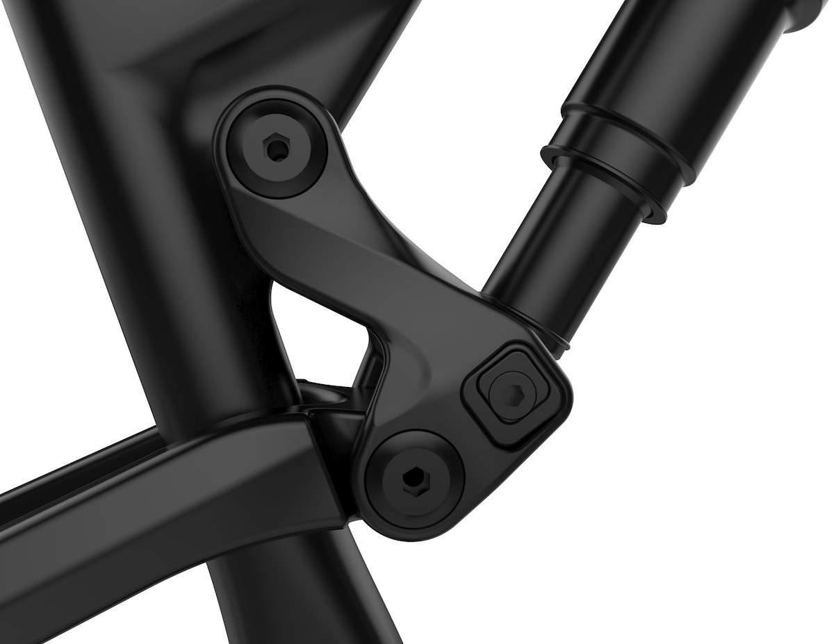

- Ride-9 adjustability chip moved into the link, saving weight and bulk
- All sizes fit two water bottles inside the front triangle
- Future-proofed to run Di2, Fox Live, and a dropper post concurrently
- Frame available with special edition Team Only paint job

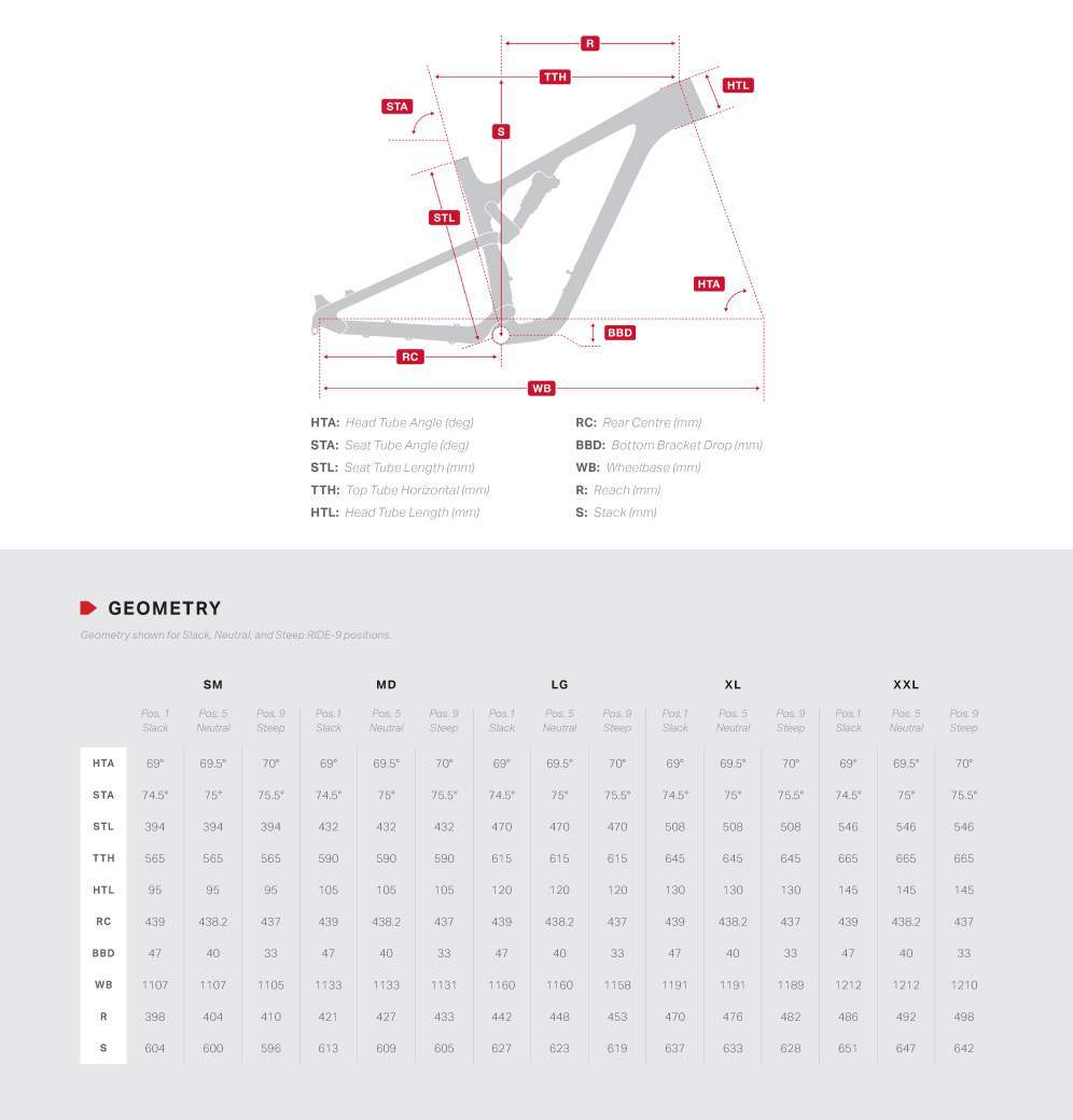

The new Element received a substantial geometry update, while retaining the confidence and handling that people loved about the previous generation. It’s slacker to keep things stable when you’re seeing stars four hours in, but uses a longer fork offset to keep steering dynamics precise.
We’ve shortened the rear centre, lengthened the reach slightly, and steepened the seat-tube angle—allowing for shorter stems and wider bars without sacrificing a powerful pedaling position. The bike hasn’t been stretched into downhill sled territory, but we’re offering an XXL size for those that need longer reach.
Ride-9 Adjustability
With the increased demands of modern XC courses and stage races, our Ride-9 adjustment system allows riders to fine-tune the Element’s geometry and suspension. In adapting the system from our trail bikes, we moved it from the forward shock mount into the link—reducing weight and bulk. The headtube angle can be adjusted from 69° to 70° and the suspension rate can be tuned for an XC race feel or a more aggressive trail feel. For multi-day stage racing, marathon racing, and real world XC, this makes it easy to dial in the perfect balance of snappy, confident, and responsive.

- The Ride-9 system allows riders to adjust geometry and suspension to specific riding styles and terrain. Nine configurations are possible thanks to two interlocking chip inserts.
