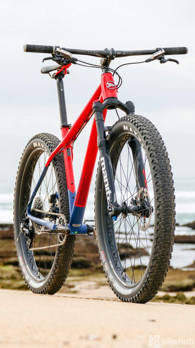

The Sphere 1 is Silverback’s reimagination of the hardtail with plus sized wheels. It features 3.0″ tyres to add grip, stability, and comfort. The extra small and small bike sizes use 27.5 x 3.0” tyres, whereas the medium, large and extra large bikes are fitted with bigger 29 x 3.0” tyres. There are two models available in the range with the Sphere 1 pitched as more performance driven bike of the two, with shorter chainstays and high end aluminium tubing, while the Sphere 2 has a slightly more stable geometry for increased traction and balance for entry level riders.

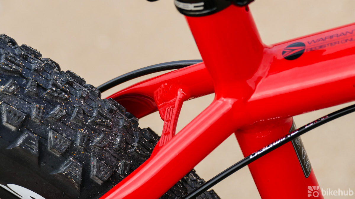

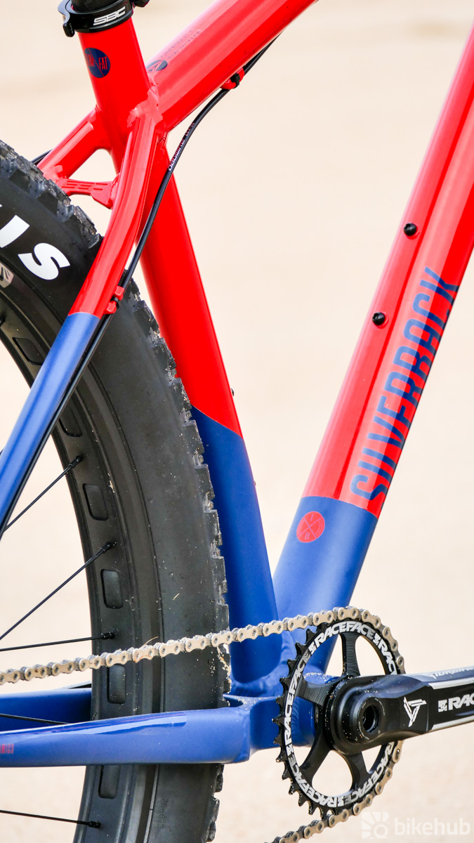

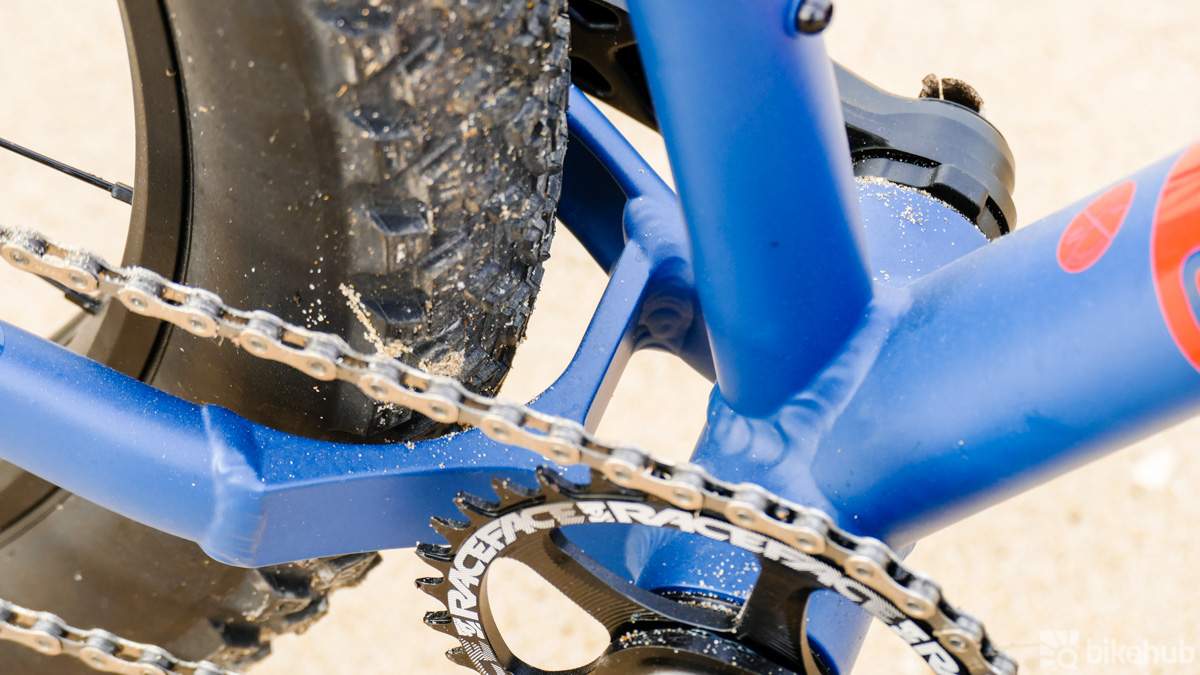

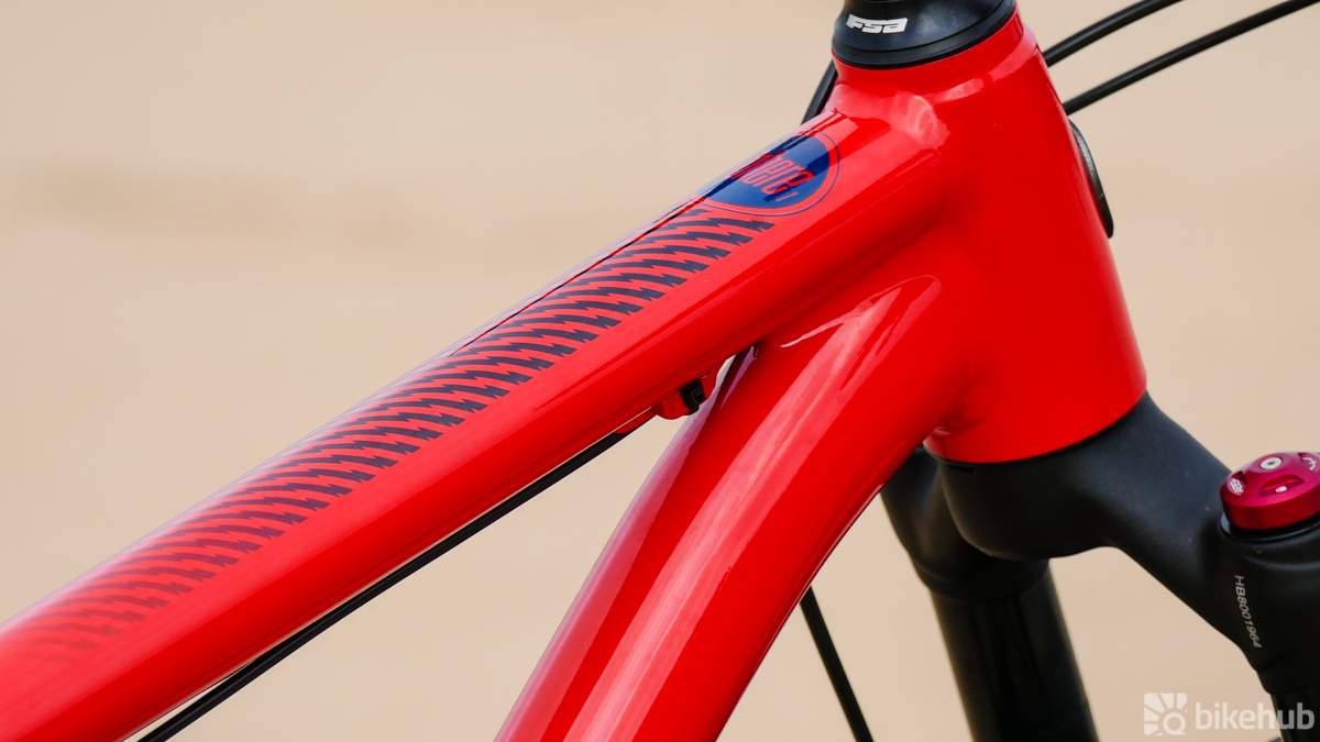

The Sphere 1 frame is made from 6061 Alloy with custom butted tubing that is hydroformed to increase stiffness and strength while keeping weight down. Workmanship and attention to detail is high on the frame and extends to the build kit with colour matching rim decals and saddle. Cable routing is external for ease of maintenance and there is space for two large water bottles inside the front triangle.
Although I am a fan of tubes with some hydroforming and a bend or two, the straight, oval main tubes look good and somehow add to the menacing look of the bike. This also results in a greater weld area and less stress risers, both of which should make the frame more durable.
A 31.6mm seatpost makes the frame dropper post friendly, but a lack of dedicated guides or internal routing means you will have to route your dropper externally and cable tie the hose to the rear brake hose running down the bottom of the top tube.
The Sphere makes use of the wider Boost axle spacing for stronger, stiffer wheels. As mentioned, Silverback have decided to run 27.5+ wheels on sizes Extra Small and Small and 29+ on Medium, Large and Extra Large.
As with all other Silverbacks that I’ve tested over the previous two years, the paint job stands out for me. I know it is very subjective, but the colour combinations chosen for each bike and model range always look great, suiting the style of each bike.

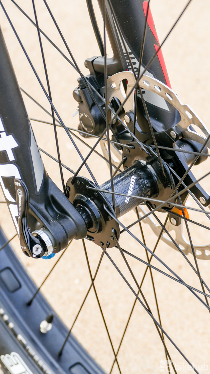

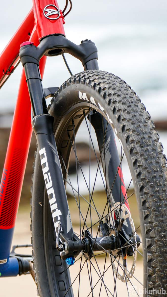

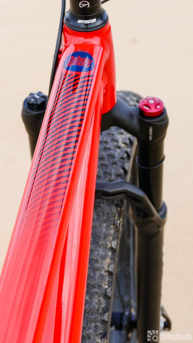

This was our first time on Manitou’s Magnum Comp, a dedicated plus fork with 34mm stanchions and 110mm Boost spacing. The wider spacing results in wider hub flanges and improves spoke bracing angles for a stronger and stiffer front wheel. The added room also increases tyre clearance allowing for a 3.4″ tyre in both a dedicated 27.5 and 29″ chassis.
The fork’s on trail performance was good, needing minimal tinkering to get it into an optimal performance setting. The fork uses Manitou’s unique front quick release system that required a trip to YouTube to figure out how to release and fix the axle in place. When you know how it works, it is quite simple to use but I feel that it’s a proprietary design just for the sake of it.

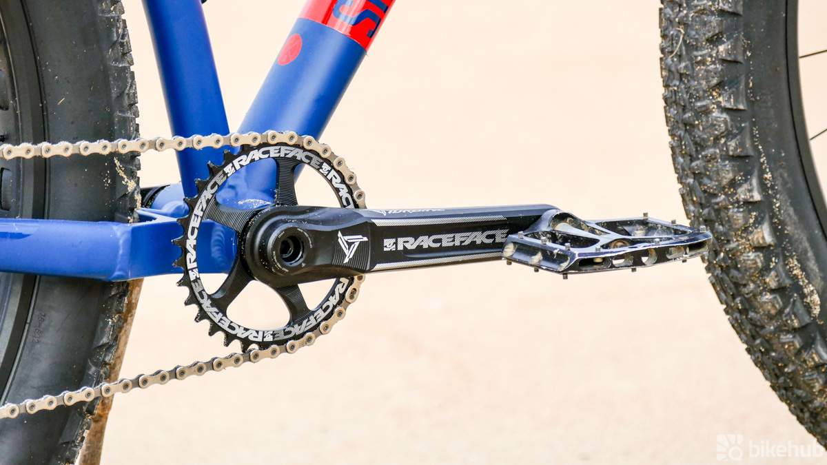

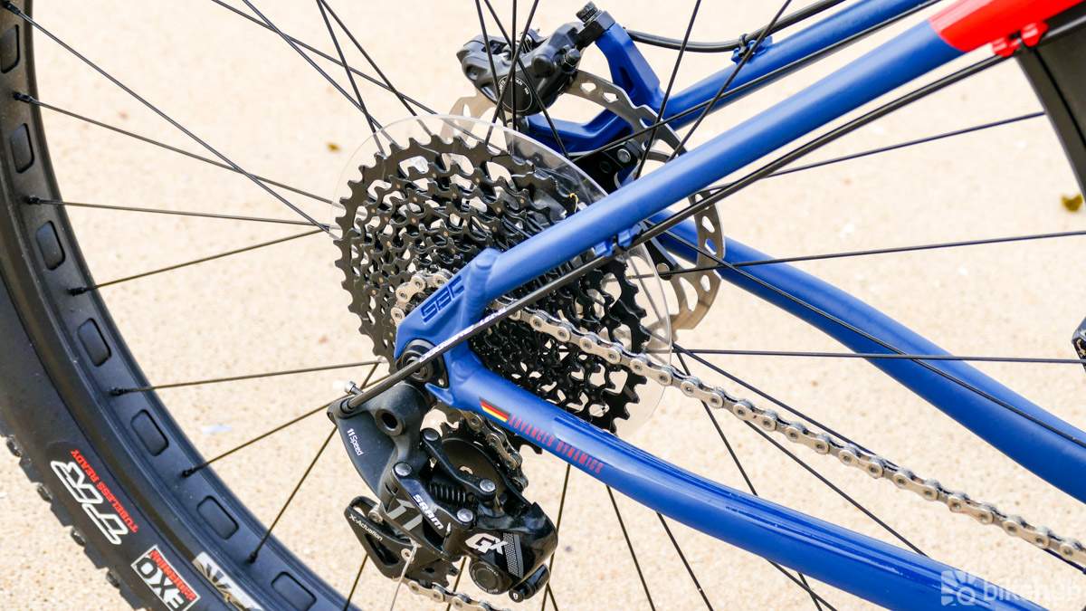

A Race Face Turbine Cinch crankset drives a 11 speed SRAM GX drivetrain. Shifting was everything you would expect from SRAM and the 32T chainring provided a good spread of gears for most of our trails.

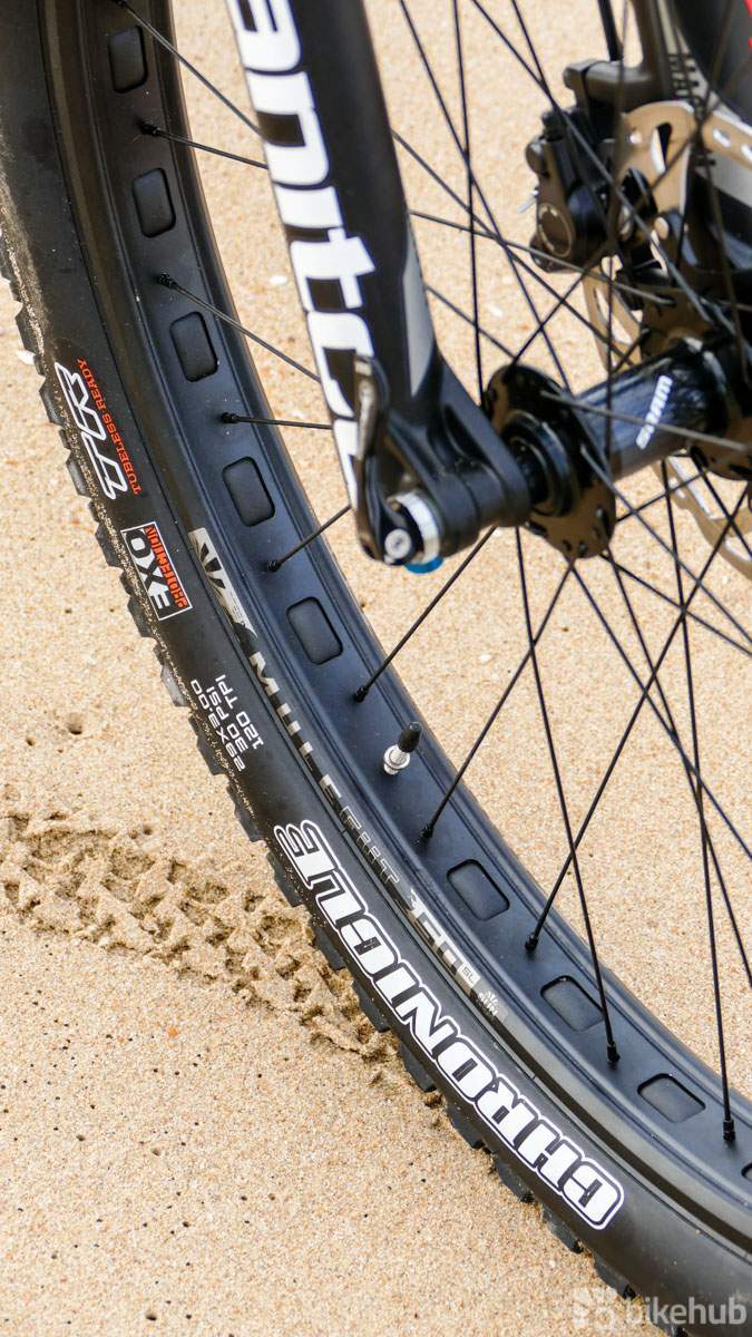

The Sphere 1 rolls on SUNringlé Mulefut SL rims laced to SRAM hubs. With an outer rim width of 50mm and inner rim width of 45mm the rims are properly wide and come with SUNringlé’s black rim tape. The SRAM hubs are not the fastest engaging hubs when applying the pressure but once up to speed they roll smoothly with no signs of drag.

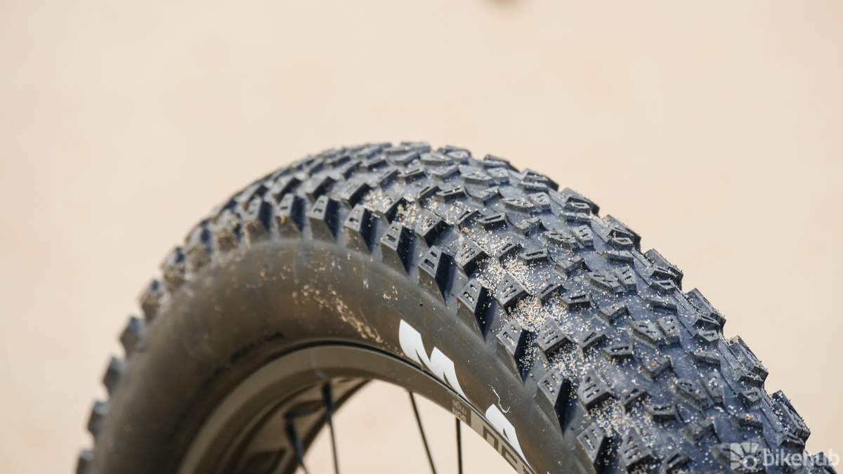

Silverback selected the 3.0″ Maxxis Chronicle tyres using EXO with a Kevlar Bead casing. The Chronicle is a good plus sized tyre suiting the Sphere 1 well. An evil of plus size tyres is that they become quite spongy if the tread blocks are too big. These offer good grip and traction with none of the “riding on marbles” feel.

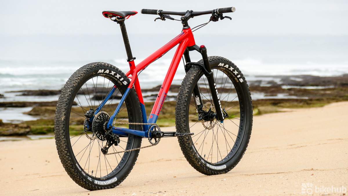

With tyre pressure as low as 10 – 15psi, the Sphere 1 rolls noticeably more smoothly than my steel Mercer Hungry Monkey hardtail with a level of “suspension” built into the wide, fat tyres which allows for extra momentum going through or over rough terrain. Throw in the extra grip going around corners and you have yourself a fast, fun-machine. On flowing single track it is easy enough to sit back, relax (as a matter of speaking) and just let the bike go with the flow. What is unique is the “give” through trail clutter while having the direct drive feel of a hardtail when stepping on the pedals.
The only element of riding one has to get used to on a plus bike is the sensation of the bike pulling sideways when riding off camber terrain. To better explain: when riding in a gutter that drops from right to left the bike feels like it is pulling right due to the extra traction on that side. It is by no means unique to this bike and doesn’t impact on your riding, but it is something to get used to.
There is some extra drag from the tyres when pedalling up a long climb, but I’d like to see how it compares to non-plus sized tyres that offer the same levels of grip and traction, as I reckon it will be no worse.
General handling is good and on par with what one would expect of a trail, borderline all mountain, hardtail. This highlights the lack of a dropper seatpost, but surprisingly enough the fork’s 100mm travel does not seem to hold the bike back too much
Verdict
The Silverback Sphere 1 is a great all round trail hardtail offering the feel and handling of a 4″ dual suspension bike. With the added drag offset by the ample grip and traction, the Sphere 1 delivers a fun and rewarding ride for those looking to explore beyond their usual trails.
