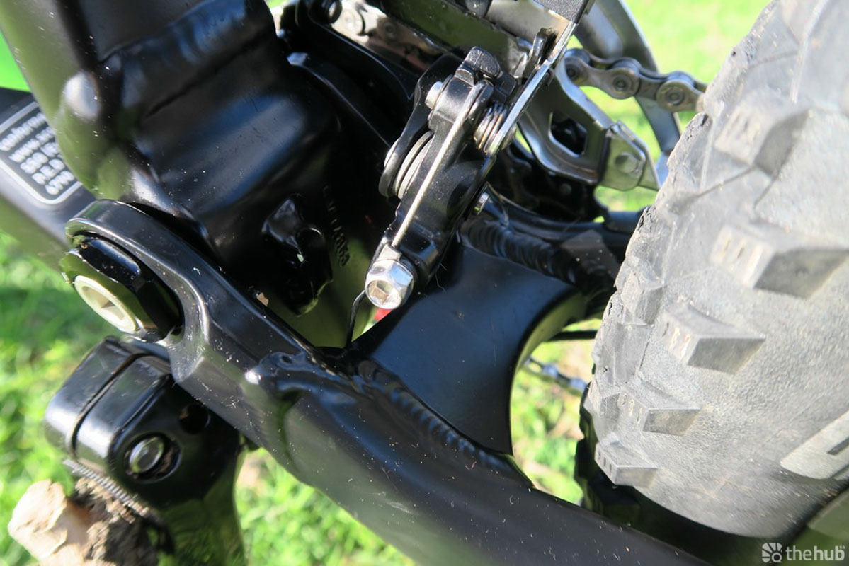

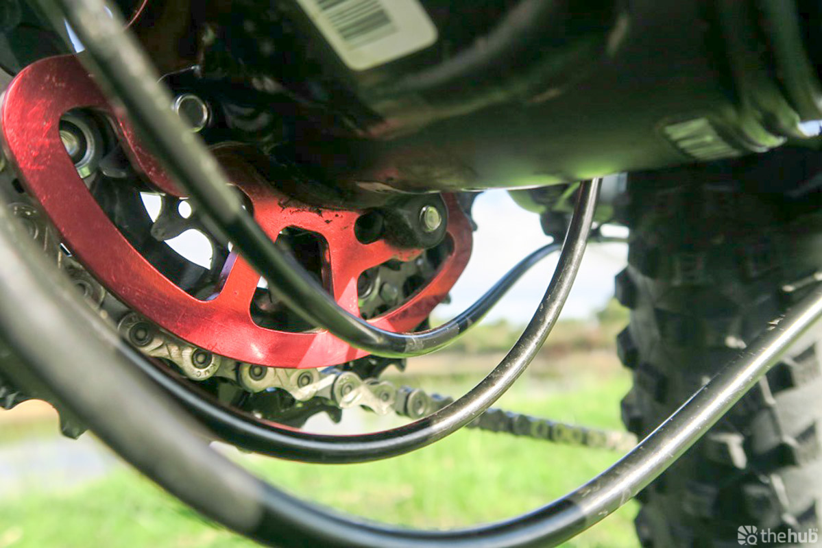

A “chainblocker” plate protects the frame from chain suck by blocking it from falling off the inner ring and damaging the frame. The system is compatible with 3x and 2x drivetrains. The optional ISCG adaptor allows riders to run a chain device for single or 2x chain set and is removable when not in use.

The area in in front of the rear tire where the front derailleur mounts is a possible mud-clogger.

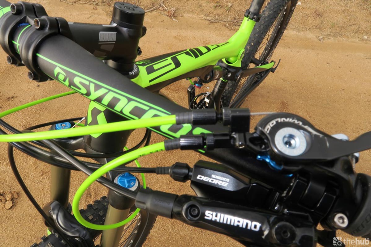

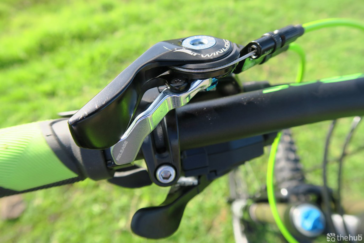

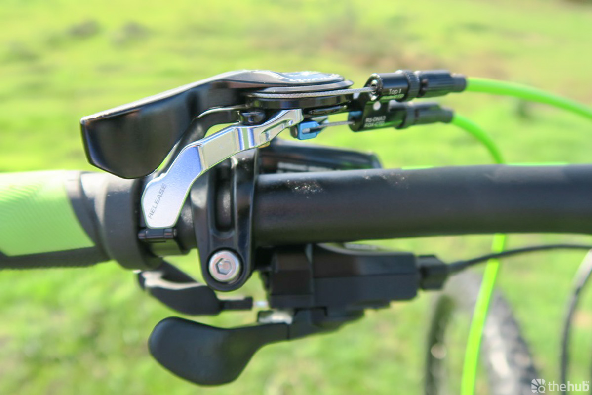

Twin Loc Lever System
https://vimeo.com/6849224
If it’s not enough that the frame comes with a trick or two up it’s sleeve, Scott takes it a step further with their patented TwinLoc system, which is controlled by the handlebar mounted lever. When the lever is pushed to switch the shock to Lock mode, the fork is simultaneously put into Climb mode. Switching to Traction mode limits the rear shock’s travel to 100mm and puts the front fork into Trail mode.
The reduction in travel in Traction mode is achieved by reducing the shock canister’s air volume, creating less sag, which in turn raises the bike’s ride height, and slightly steepens the head angle.
Pushing the lever to its second stop locks out the shock and fork entirely, turning the Genius into a rock solid pedaling machine.

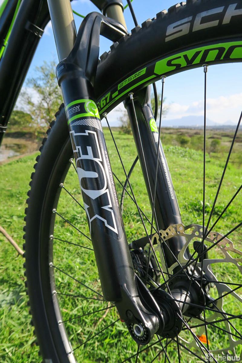

Fork: A Fox 32 Float Evolution CTD does duty up front. At a 150mm it is showing noticeable signs of flex when pushed. A Fox 34, Rockshox Pike or even a Revelation would be a welcome upgrade for those looking to ride the bike at it’s limits.

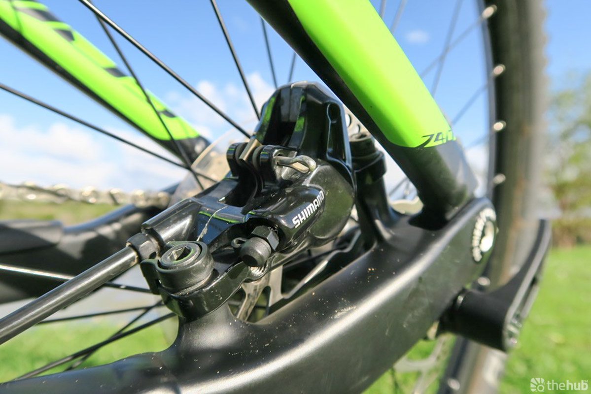

Brakes: Stopping power comes courtesy of Shimano Deore hydraulic disc brakes. Although not fancy in any way they do get the job done. It really is nice to know that even the cheaper disc brakes out there can perform as expected when needed.

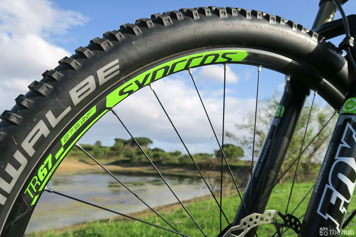

Wheelset: Shimano hubs laced to Syncros TR67 rims using DT Swiss Champion spokes, are fitted to the Genius 740. I have become used to wider rims and it takes some getting used to and a slight adjustment of riding style. It’s not a major issue and if you’re not riding wide rims you won’t even notice.
Tires: Schwalbe’s performance series tires are a popular OE choice. I would bump the Nobby Nic front and Rocket Ron rear up one level in the Schwalbe line-up and fit a Hans Dampf front and Nobby Nic rear. The new Nobby Nic is doing a great job covering most basis and when out riding your favorite trails you want tires with grip that can match the potential of the frame.

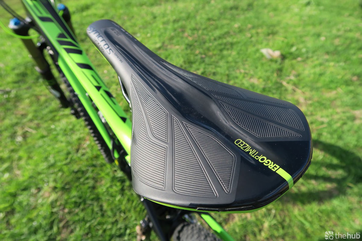

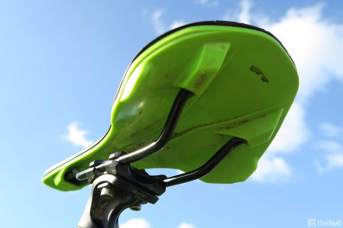

The finishing kit (handlebar, stem, seatpost and saddle) all comes from Syncros. Acquired by Scott in 2012 from Ritchey, Syncros is well-known for quality gear. Again, to match the potential of the frame, I would bump the 720mm handlebar to at least 750mm and drop the stem to 50 or 60mm. The long stem and narrow-ish handlebar felt a bit old school and the bike definitely felt more comfortable and capable when I switched those out. This is obviously a very personal choice.
The Syncros XM saddle was comfortable and hitting all the right notes for me.
A dropper seatpost was notable in it’s absence and although a QR release for the Syncros seatpost was welcome, I did miss a dropper post. I however understand the need to keep costs down and as the entry level bike in the line-up some cuts had to be made.

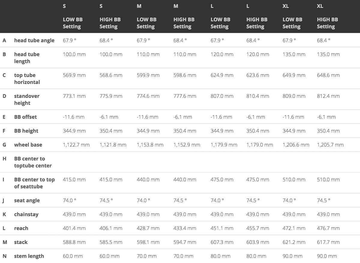

Geometry

Few questions:
1. I assume you rode it in the "Low" setting for the review? Did you still feel at 67.9' that is was too steep?
2. Will swopping out forks compromise the twinlock system or could you still use it on any other RL fork?  Otherwise, is it removable?

Just had a look at their website an I must say I am baffeld how even the top-spec Genius is still stocked with a 2x10 drivetrain (XTR, but still, what is this 2013?) and a 32mm Fox (Kashima who cares).
It's only the Tuned Genius that runs 1x11 but still a string of spaghetti up front.
If you're going to charge R60k and up for a bike then you need to run 1x11 and a Pike/Fox 34.  Otherwise you're basically telling your customer to spend that cash plus still upgrade it.
I can't help feel that this is because of the TwinLock system.

Hi Nico
1. "Too steep" is relative and a question best answered around a braai or out on the trail. Not because I'm trying to avoid the answer, but it's a big question that I feel should not get a flat, yes or no answer.
On the trails I rode I never felt it was too steep although there were some sections on one trail I missed a slightly slacker HA.
2. It can work with any fork that can take a remote lever

That cockpit is a madhouse. Have they never heard of less is more. Imagine running all that plus a dropper. OMG!

It seems all a bit moot though.  The 2016 range Genius seems to run beefier Fox forks and 1x11 deeper into the range.  Guess the market has forced their hand.

Is the bottom bracket stick a standard feature or upgrade?

The decision to go twinlock with a noodly fork says that. If you want a pike on this bike you probably the same guy who couldn't give two ****s about twinlock.
