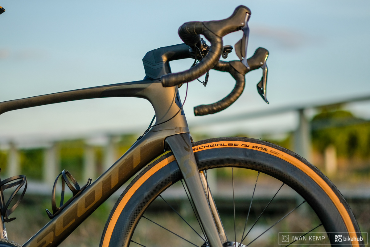

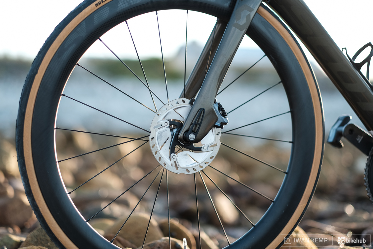

The aerodynamic gains were achieved in three ways. The first was to add “winglets” to the fork lowers to help guide air over the disc. In fact, the left-hand side wing is large enough to shield a significant part of the brake caliper without sacrificing adjustability. That design feature makes up one of the three lost watts. A second watt was saved by giving the front thru-axle a removable lever. Then, the wider tyre and rim creates a more aerodynamic leading edge, saving another watt. And there are the three watts back in your pocket. At a mere 45 gram of extra weight compared to the rim brake frame.

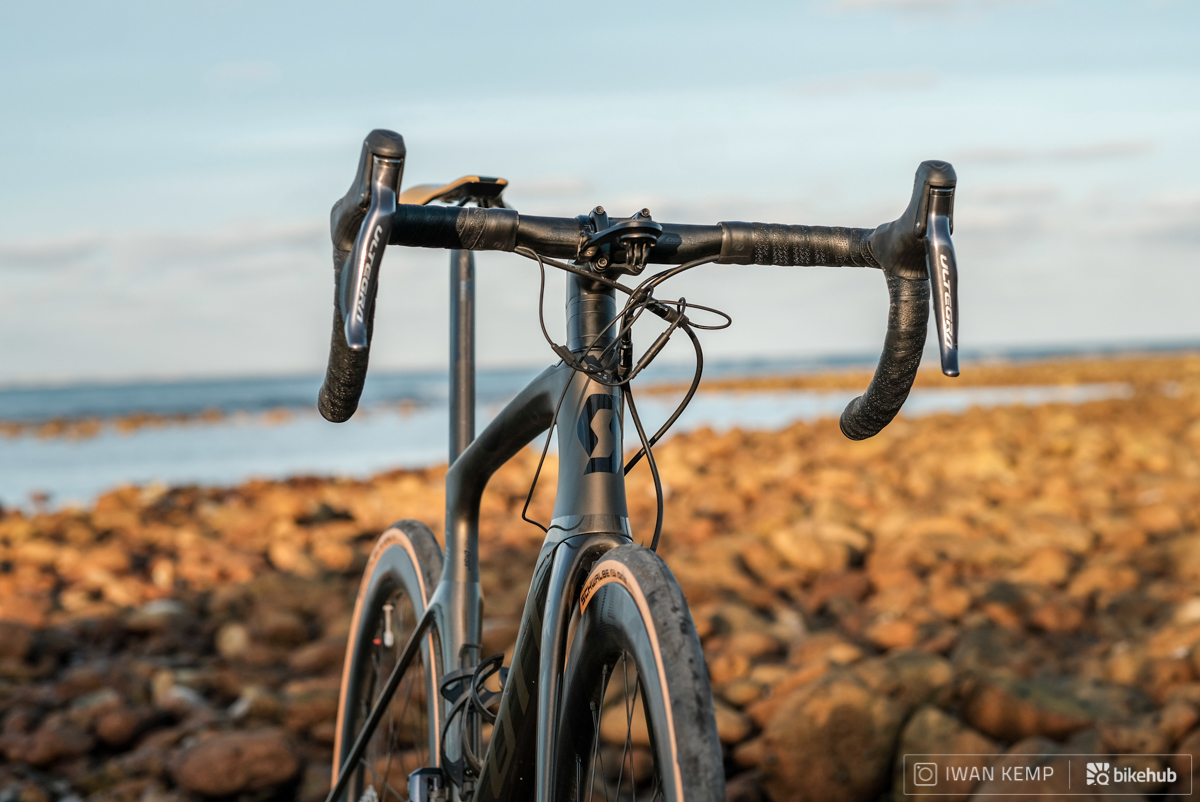

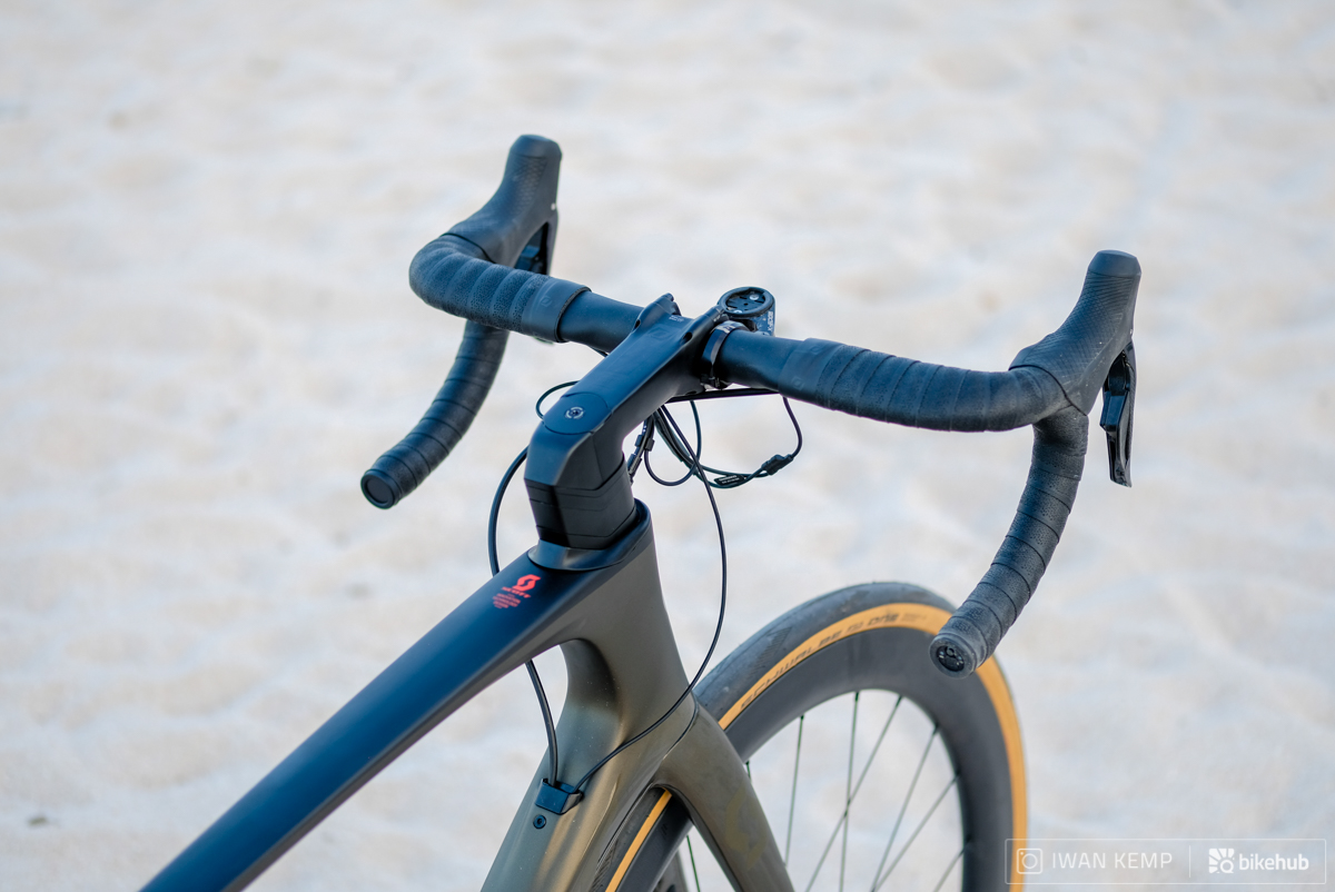

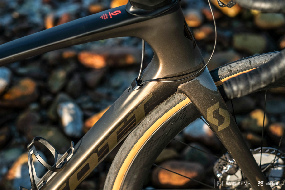

The down tube employs a Kammtail (a teardrop shape with the tail removed) aero profile for maximum wind-cheating properties while maintaining a practical shape for stiffness and strength. Higher up, closer to the front wheel the down tube also has a narrower profile to cut through the wind as effectively as possible. It has become an industry trend for the head tube, fork, stem, and (to an extent) the handlebar to form one front-facing profile. In this case, it’s worth mentioning that Scott has done a commendable job getting rid of “joints” with even the headset spacers and the shape of the stem clamp area forming part of the smooth design. The cables are routed around the front of the bike, disappearing into a single port on top of the downtube.

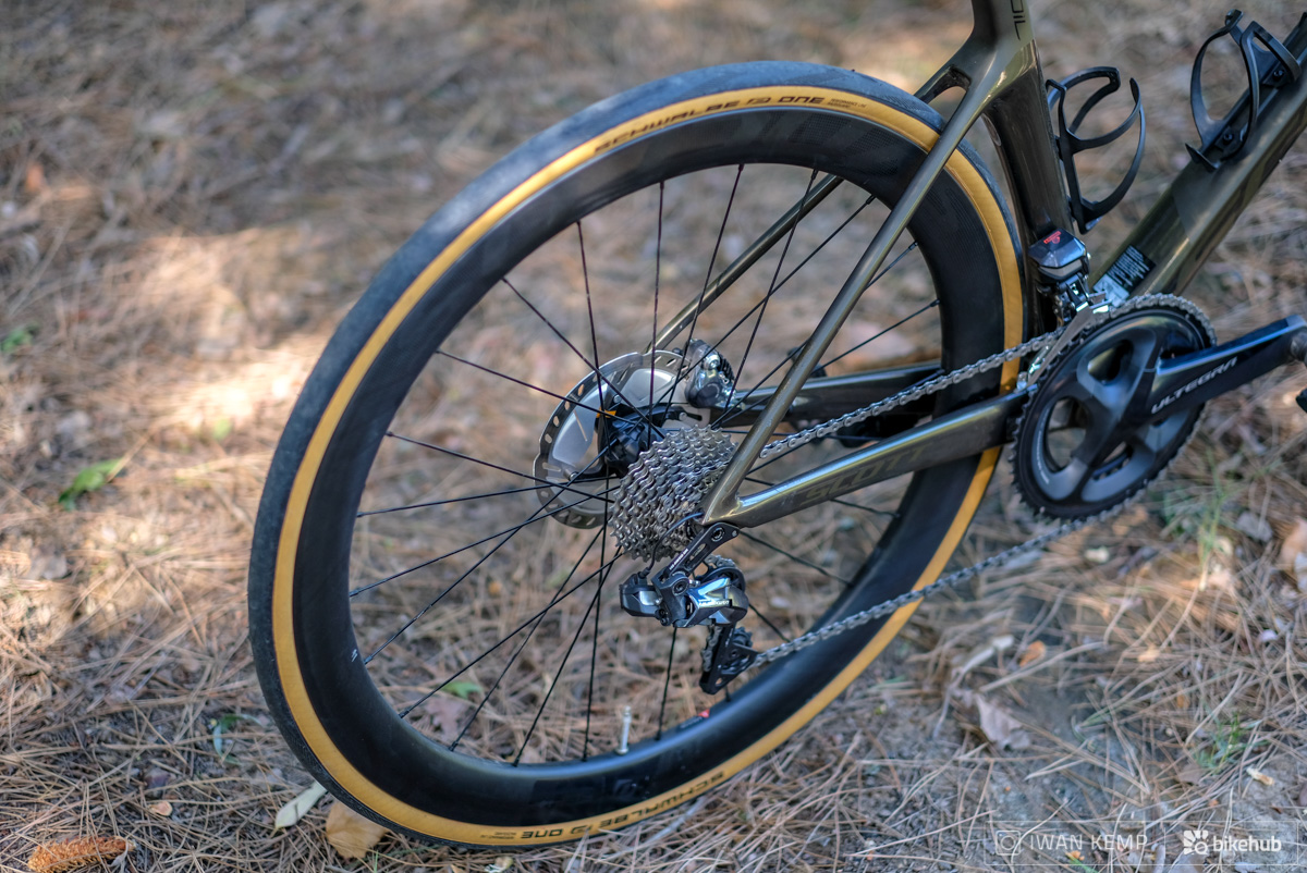

The rear dropouts feature wheel positioning guides to make fitting a wheel quick and easy, removing some risk of scratching or chipping the paintwork. The Foil also accepts both a standard derailleur hanger and a Shimano Direct Mount hanger to make it more versatile should you ever need a new derailleur hanger. The direct mount hanger provides extra room to make wheel changes faster and easier.
The Scott Foil 10 Disc arrives with a 52/36 semi-compact chainset and 11-30 range cassette, meant to give you more top end without losing the climbing potential of a low bottom gear. A separate bar and stem combination adds some adjustability over the top of the line’s one piece bar and stem, yet keeps a flat aero top that is comfortable in the hands. The Di2 junction box is tucked away at the end of the bar.

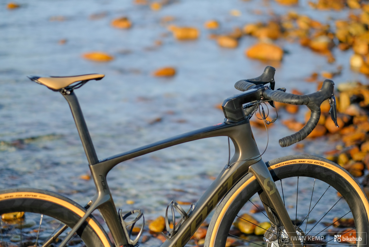

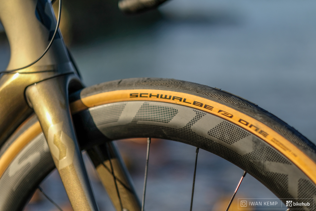

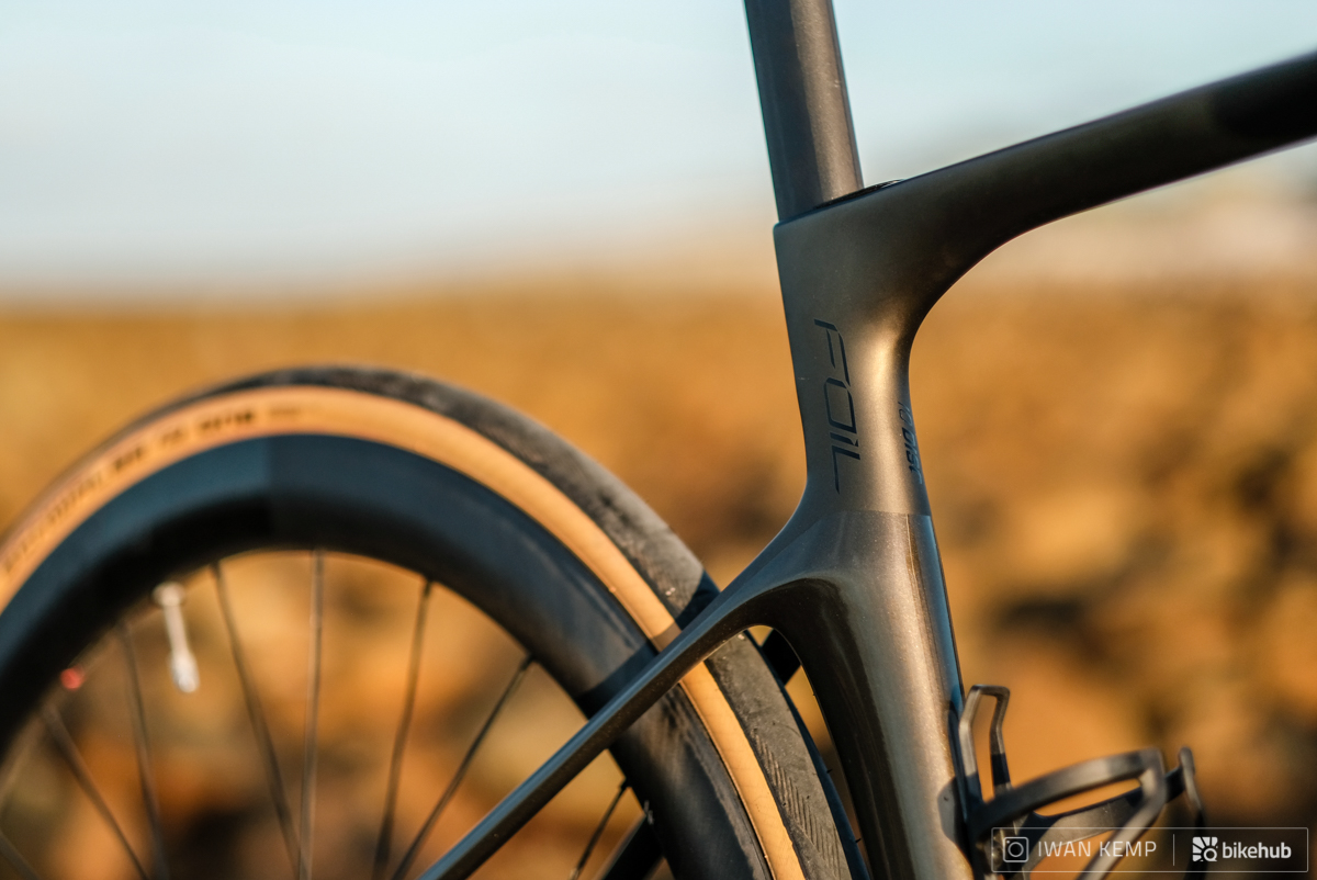

Tyre clearance has been bumped to a healthy 30 mm with the bike fitted with 28 mm skin-walled Schwalbe ONE Race-Guard as standard. The wide tyres are only part of the effort that has gone into making the bike more comfortable on longer rides and rougher roads (like ours). The lowered seat stays are flattened, and the top tube and seat tube shapes both allow for a certain amount of vertical flex to soak up road vibrations. Scott says the focused approach to improving comfort on the new Foil resulted in an increase in vertical compliance by 86% of the seat tube area compared to its predecessor and an 11% increase in fork compliance compared to the first edition of the Foil.
A note on the sizing: On the 54cm I tested my saddle height of 77cm ran the seat post to just above the minimum insert line. Keep that in mind when you are size shopping.

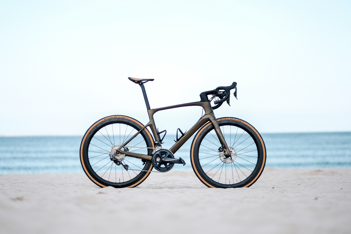

The metallic brown paintwork, paired with the tan sidewall tyres and brown saddle makes for a stunning bike. Everyone who saw it commented on what a great job Scott did with the paint and finishing touches of the bike. Very classy.

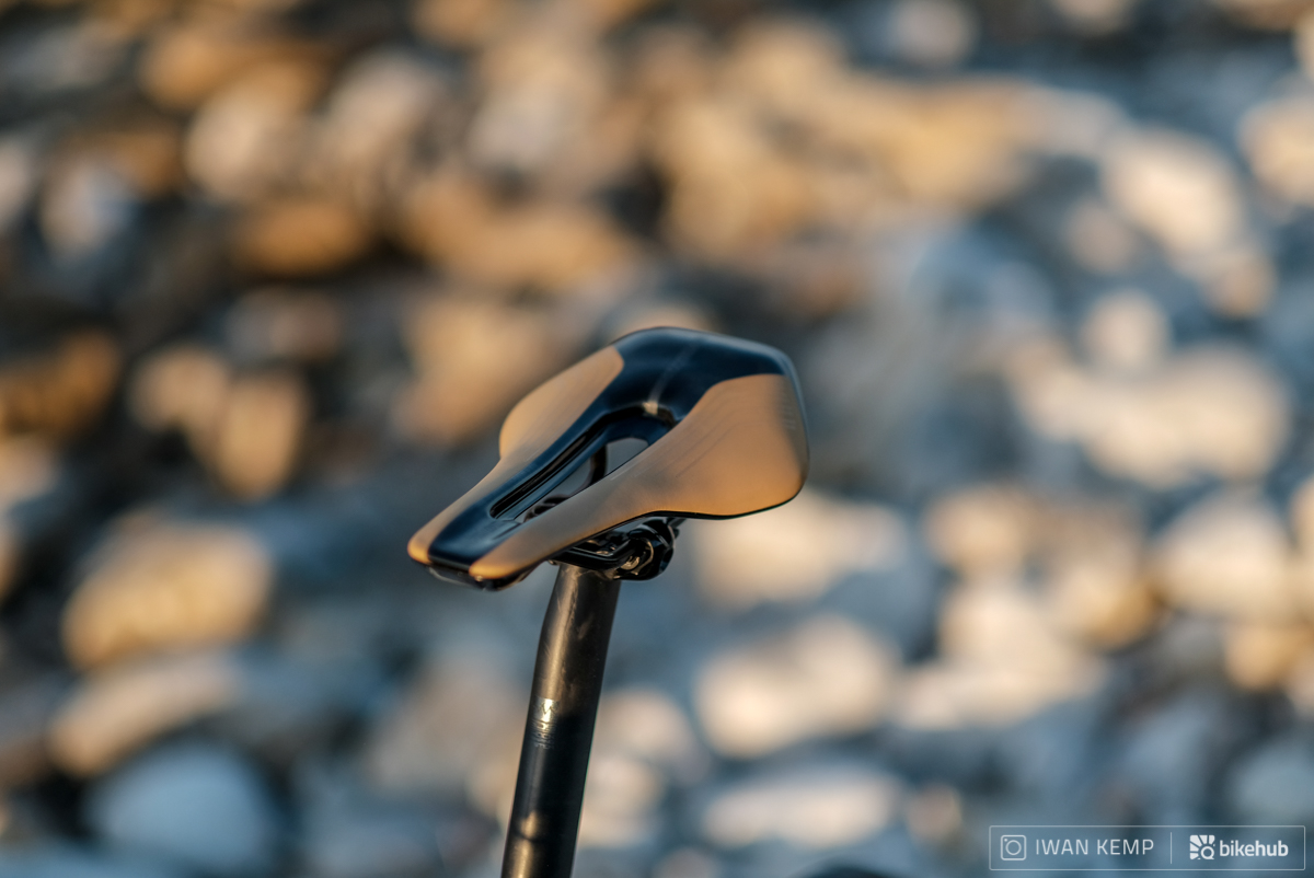

The Syncros Belcarra 2.0 saddle was the first Syncros saddle I did not find unbearable to ride. I found it quite comfortable and managed to complete the review period with it still mounted to the seat post.
