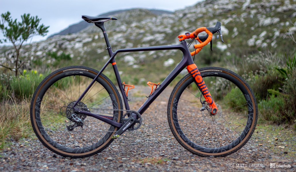

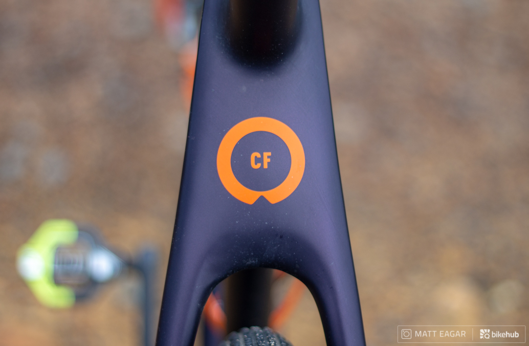

The Rondo Ruut frameset is available in a safe but stealthy black-on-black or the outspoken aubergine and orange eyegasm pictured in the review. Both options look great and will suit most personalities on the spectrum.

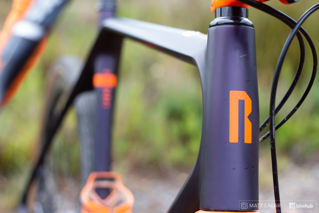

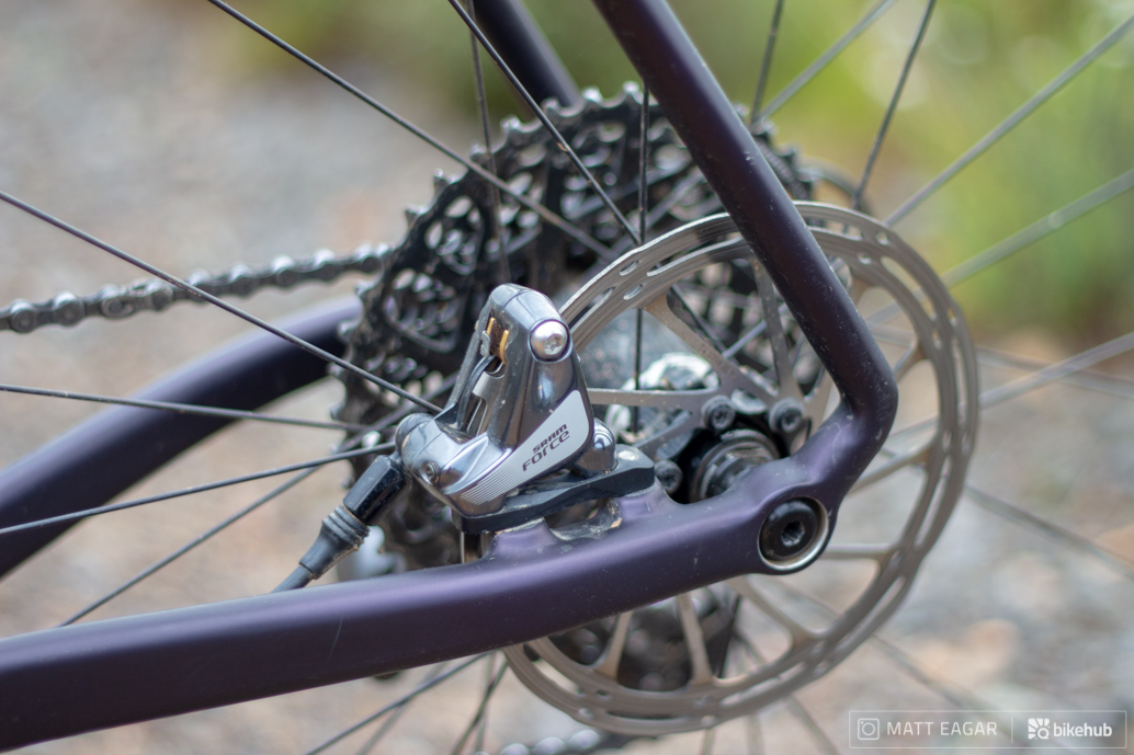

The Ruut is a carbon fibre frame with specific points that flex to provide relief to the rider. These flex points include: a) the sharp kink in the top tube before the seat tube, b) the seat tube and seatpost, and c) the bend in the seat stays that is set behind the rear wheel axle so that the forces do not travel directly up the seatstay into the seatpost.

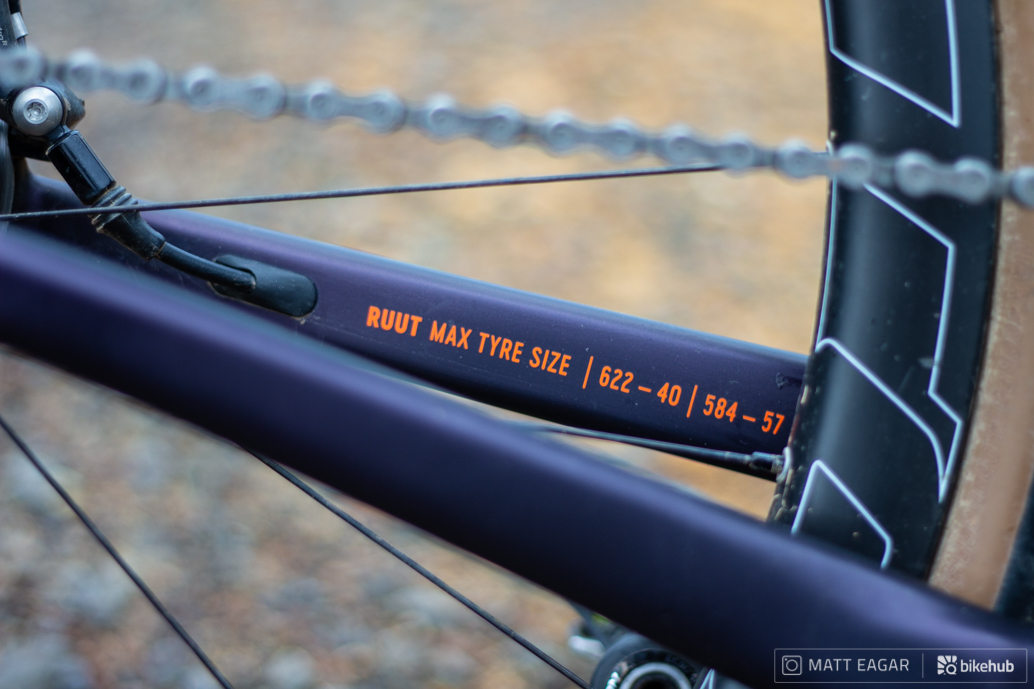

The Ruut can support both single and double chainring driver systems with internal routing for the cabling. Rondo specifies that the Ruut has clearance up to 700 x 40c and 650b x 2.1” tyres, although I reckon you could squeeze in a tyre size or two bigger. For those looking to do bike packing missions, all the necessary mounts are included to fit mudguards and rack mounts on the front and back. The Ruut is available in four frame sizes.

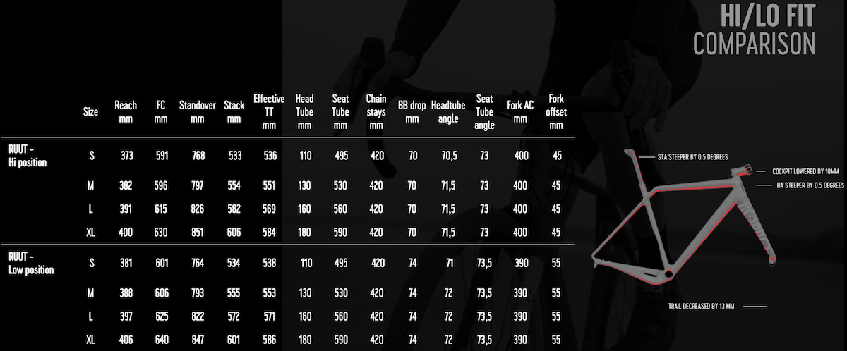

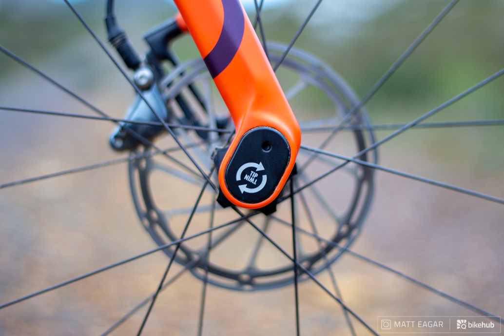

The Ruut has the option of two geometry settings: HI and LO fit. In the LO setting the bike is best suited for race performance with a low cockpit height, steeper head and seatpost angles, and a shorter fork trail. In the HI setting, the head and seatpost angles slacken by half a degree, the cockpit rises higher, and the trail grows by 13mm. The geometry is modified by changing the height and position of the fork axle.
Small changes in geometry can make a difference and it is noticeable when switching the chip on the Ruut. The LO mode is great for grinding miles of gravel and riding on tar or even a CX race (should such things ever catch on in SA). In HI mode, a more upright riding position creates better comfort and confidence with a noticeable improvement in rollover ability through roots and rocks. Personally, I was happy with the racier LO fit for most of the test period.
Switching the chip between LO and HI modes is a straightforward process requiring loosening the front brake bolts and apply or removing a brake adapter (which is supplied by Rondo). It took me roughly 10 minutes to make the switch. Although a simple enough task, I would not recommend it as a trailside procedure. All you need is the correct sized hex keys and the confidence to realign the brake caliper.

The parts build on the demo Rondo Ruut is completely custom. It is the bike of Switchback Sports owner Charles Keey and shows off a number of products from his distribution company’s catalogue including Easton and Panaracer.

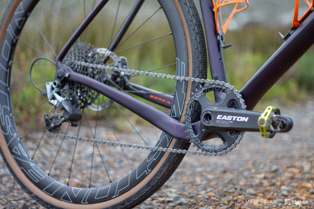

The RUUT features a SRAM Force drivetrain with a single 38 tooth Easton chainring up front with a SRAM 10-42T cassette. I found the spread adequate with good climbing range on steeper mountain bike type trails while providing enough high-speed drive on gravel roads and even out on my morning Chappies peninsula loops (granted, I was not trying to hold a wheel down the hills at race pace). The Easton EC90 SL with CINCH Power Meter was a nice touch with the power meter component fitting neatly in the crank axle.

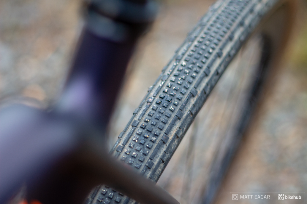

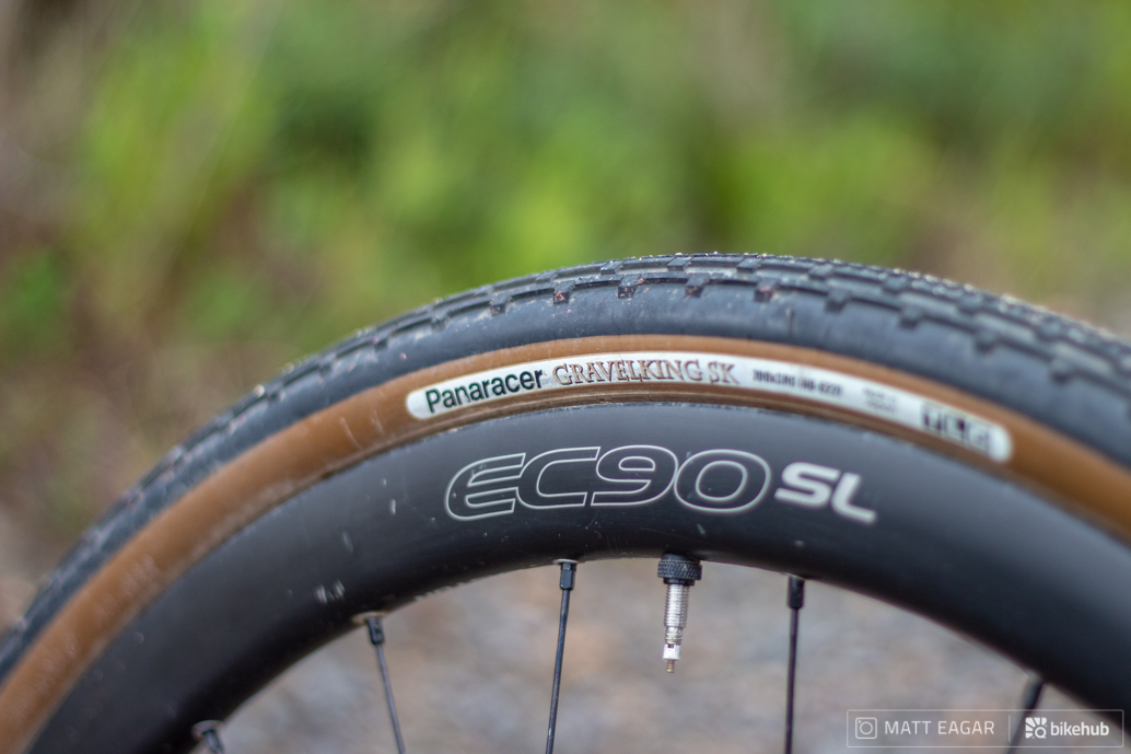

The carbon Easton EC90 SL wheelset is solid but light, offering confidence when hurtling down gravel roads and holding a line when picking your way through rock and roots. The Panaracer SK GravelKing tread design impressed with excellent grip in dry loose turns while rolling supremely well. I did manage to mortally wound my front tyre by smashing into a spearhead-shaped rock while hurtling blindly down a gravel road at the back of the pack. Even a mountain bike would have struggled to keep from spilling its sealant guts in that incident, so there’s no blaming Panaracer for the pit stop.

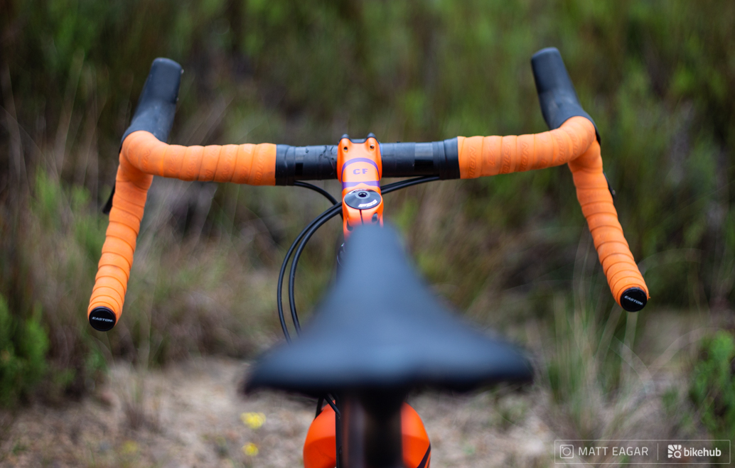

The cockpit features more Easton carbon bits with the highlight being a flared handlebars providing additional steering control and comfortable position in the drops. The Ruut frame arrives standard with an Easton carbon seat post and a Rondo own-branded stem.
In this dress up, the extra large frame Ruut weighs a frisky 8.4 kilograms. Throw on some road tyres for race days and you’ll be knocking on the door of many well-specced road bikes, especially in the smaller frame sizes.
