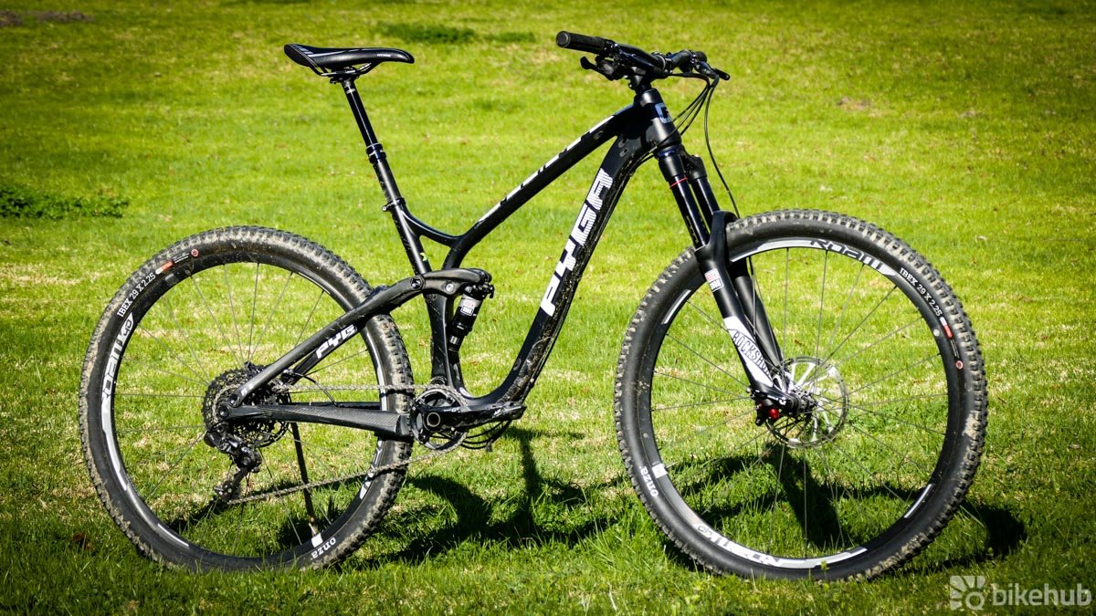

The Pyga Stage Max is the bigger brother of the Stage marathon/ cross-country bike. With the Stage already adding some spice to the race bike category, we were keen to put the Stage Max to the test to see what it has up its sleeve.
The Frame

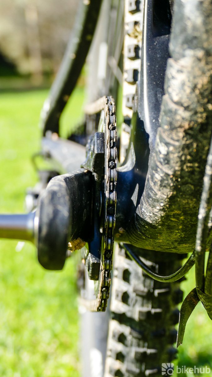

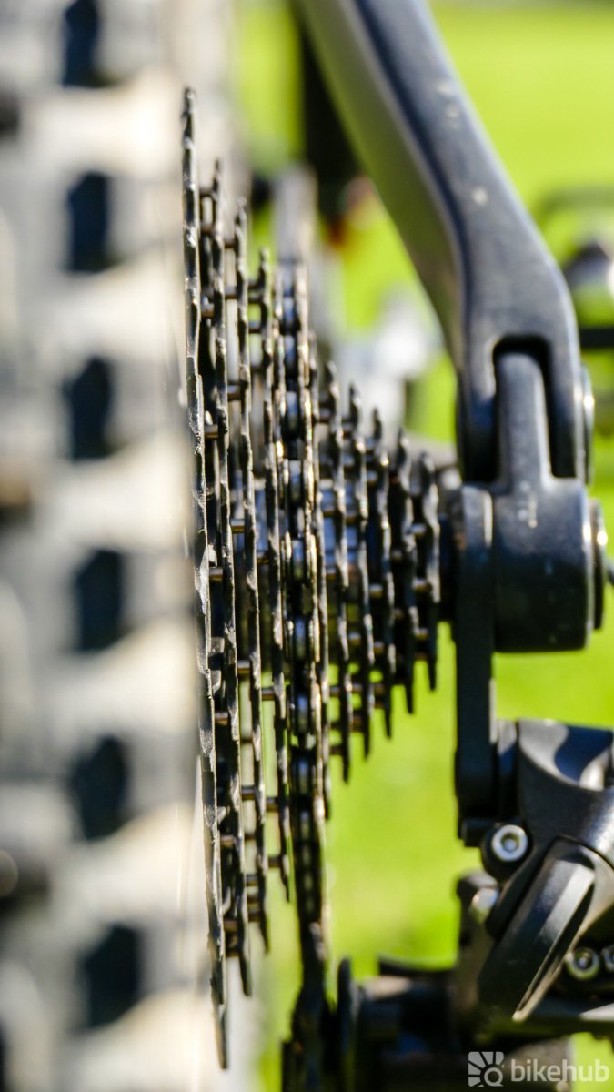

The biggest deviation from conventional design is what Pyga are calling Plus Five. A re-engineering of the rear end to correct what they believe is a huge flaw in bikes, the chainline offset. What they have done is offset the whole rear end of the Stage Max by 5mm on the drive side and in doing so reducing the chainline offset from 49mm to 44mm.
Why the change? Patrick Morewood explained that when the 49mm chainline offset was introduced mountain bikes were using 8-speed cassettes. The measurements then meant that the chainline was centred but as 9, 10 and 11-speed cassettes were introduced the centre chainline has shifted. The result on an 11-speed drivetrain with a 49mm offset is that the centre chainline is out by two gears. No need to worry about a new standard though, Pyga have emphasized that Plus Five is not a new standard, as all they have changed is their frames. The hubs, axle width, and wheels (aside from a change to the dishing) all remain unchanged.
What are the advantages of the Plus Five chainline offset?

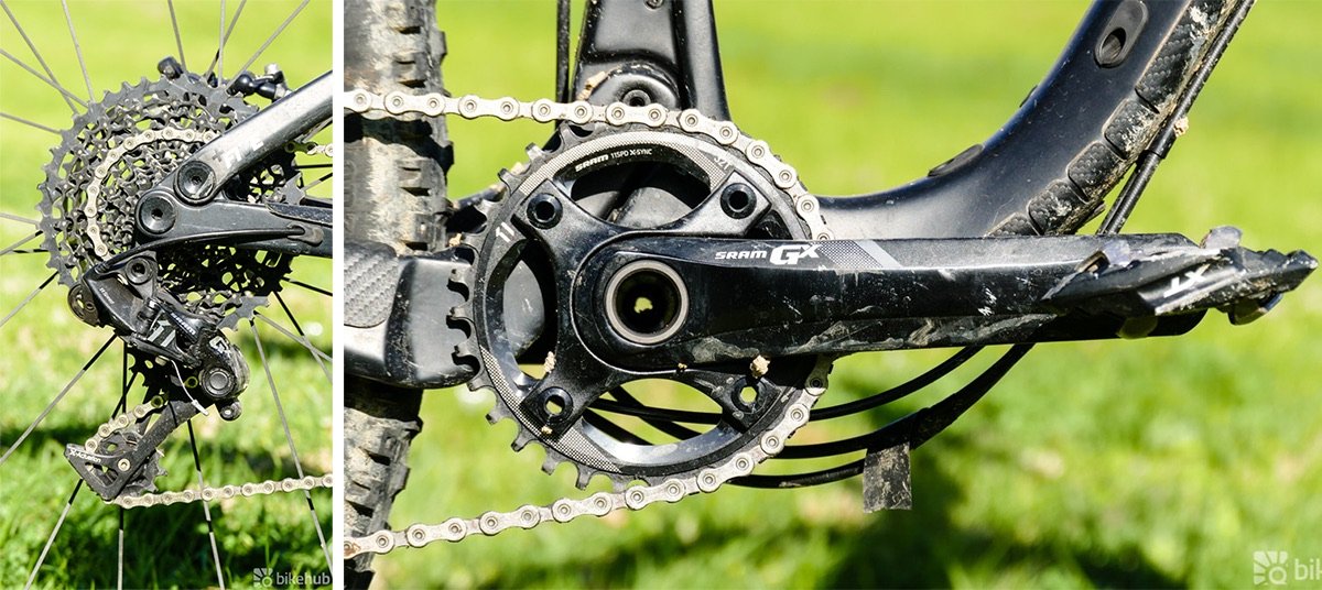

Better shifting: The centred chainline and less harsh chain angles improve shifting. Poor shifting is often blamed on the drive train manufacturers, when Pyga feel that as frame designers and engineers they should take responsibility by improving the frame design.
Less component wear: They were also concerned about excessive wear when riding on the 11th gear (the “granny”) on a 1×11 system. When riding the Stage Max in your 11th gear the chainline is equivalent to being in your 9th gear on other bikes sporting a 49mm chainline. This significantly decreases the angle at which the chain engages the front ring in the top gear.
Improved rear wheel strength: Plus Five also means that the rear wheel is no longer dished, with spoke length being equal on either side of the wheel leading to improved wheel strength.

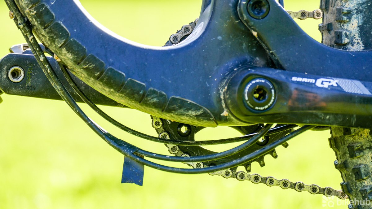

The only thing I would like to see tidied up is the routing of the cables on the underside of the bottom bracket. They seem to be quite exposed and it looks a bit untidy, especially considering the clean lines of the rest of the bike.

Pyga have really nailed the component choice of the Stage Max “GX PIKE RC” build on our test bike. It features a full SRAM GX 11-speed drivetrain with a 32T chainring. The only personal change I would make is to swap out the fairly thin Race Face Half Nelson grips for something with a bit more squish. Other than that, every piece of kit deserves its place on the bike. Shifting was good and the impact of the Pyga’s +FIVE chainline offset was noticeable, with less cross chain when in granny gear. The fork is a Rockshox Pike RC with a 140mm travel and, as one would expect from a Pike, its performance was top notch.

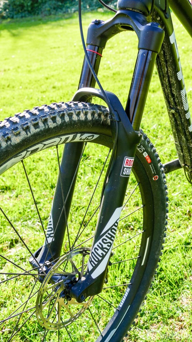

  • ForkPike RC 29 140mm

  • Rear DerailleurSRAM GX 1×11
  • ShiftersSRAM GX 1×11 Trigger
  • CranksetSRAM GX 1400 175 32T
  • Bottom BracketSRAM BB Pressfit 89.5mm
  • CassetteSRAM XG 1175 10-42

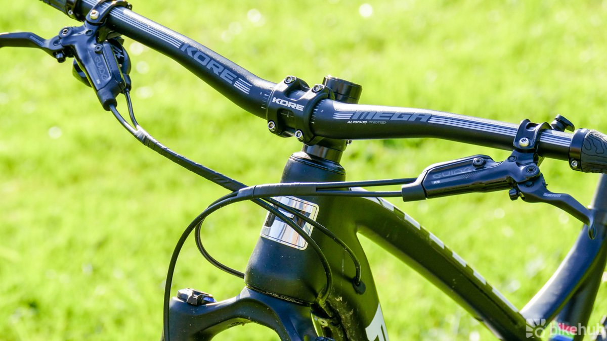

  • HandlebarKORE Mega riser 760mm
  • StemKORE Cubix 50mm

The 760mm handlebar and 50mm stem places the rider in a commanding position and, thanks to the healthy reach, there is enough breathing space to move around. Climbing is good with little to no sign of bob or any pedalling inefficiency, which allowed me to keep the shock fully open for most of my rides. The more enthusiastic marathon riders may opt to run some form of pedalling platform as it does firm the rear up and, perhaps more importantly, makes the bike sit a little higher in its travel.

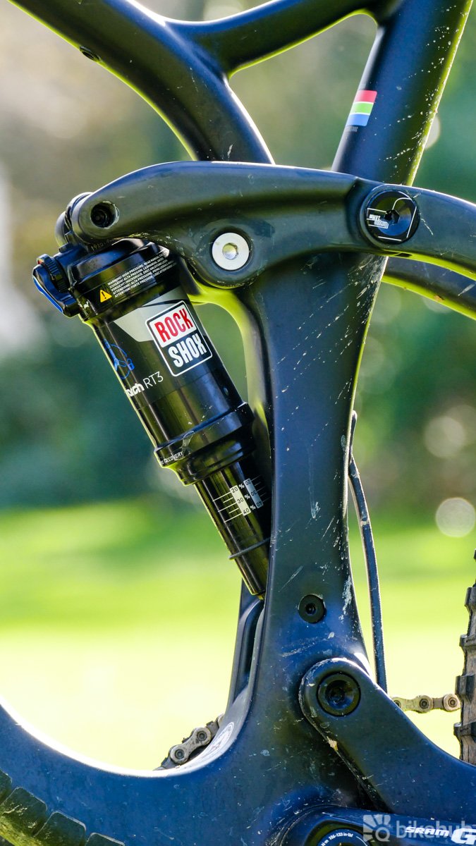

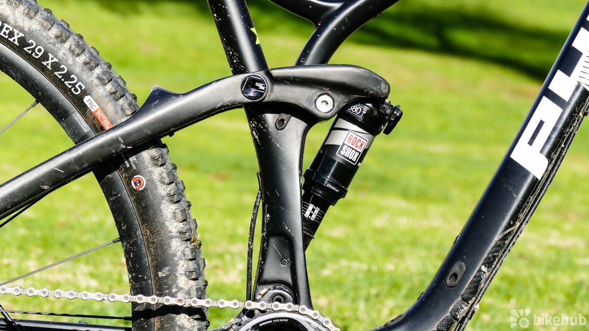

On less manicured trails, the Stage Max continues to impress. With the pivot placed near the rear axle, the Pyga Stage Max comes as close to a split pivot as it could and in doing so does an excellent job of keeping the rear suspension active under braking through the rough stuff, helping the rear wheel to stay in contact with the trail.

Grips can be fixed, anyone sorted that very untidy cable routing?
Thing is with the routing as is you will need a bit of slack as it would need that extra length when at full travel. Some brands recommend ±25mm around the BB. Not a huge issue, or issue at all really. Just doesn't sit well with my OCD

Cable routing on mine after close on 4000 kay's.  No issues or damage.

So the cable routing under the BB looks scrappy.....but the internal routing wasn't used?
